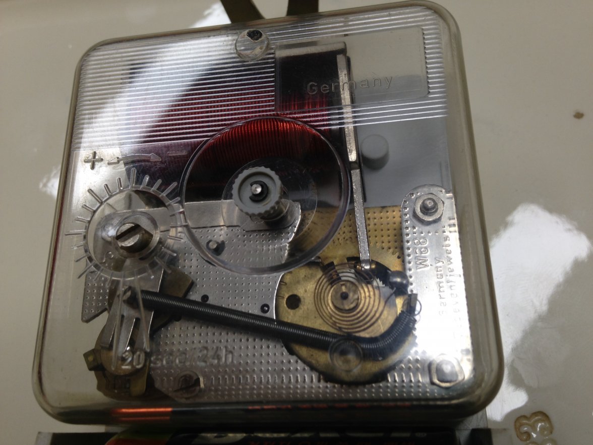

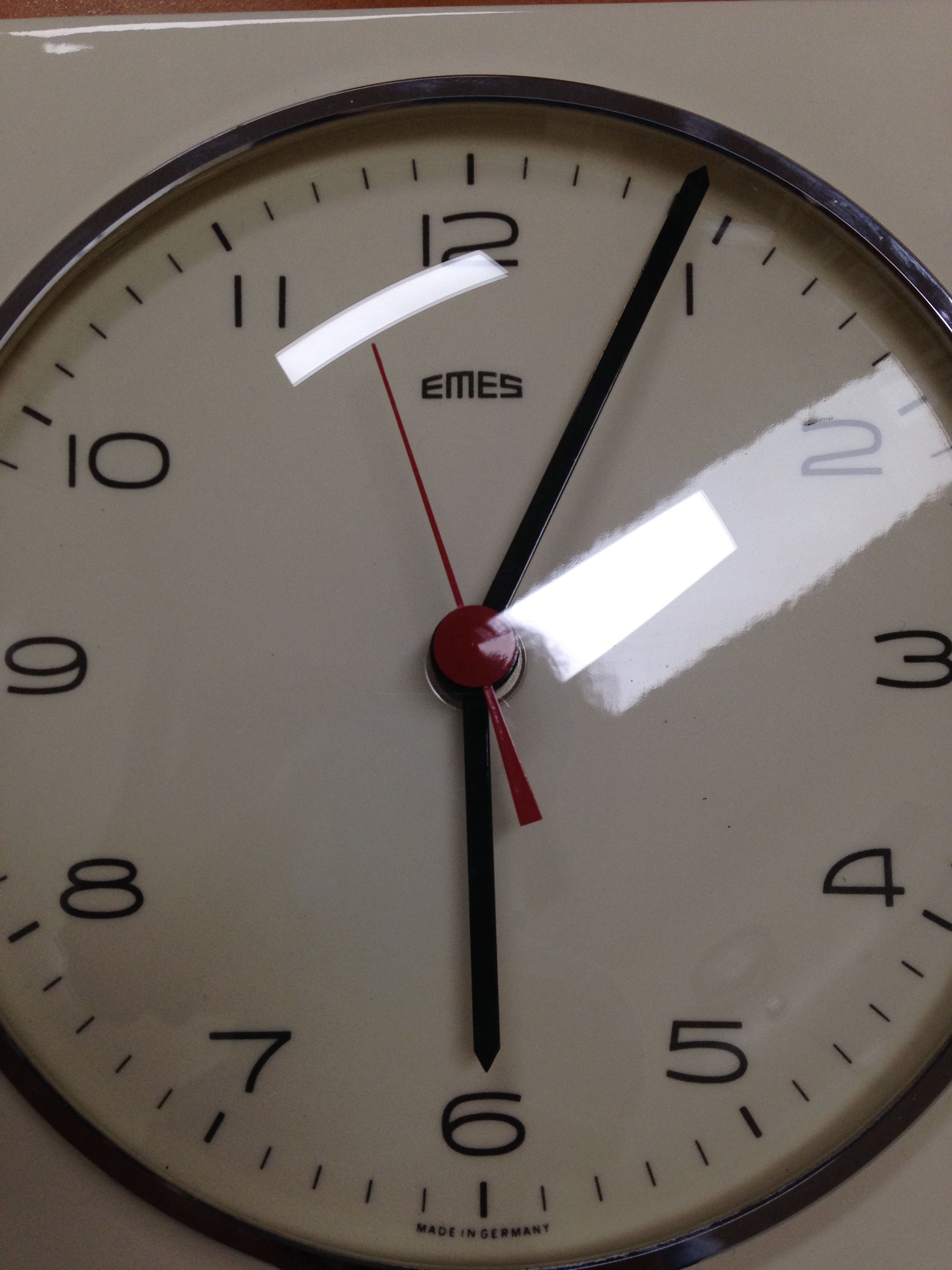

    Hi Guys,
    I purchased a 60's beautiful wall clock. It is made by EMES, Germany.
    Everything is going perfectly. Time keeps on accurately.
    Only thing I don't like is an annoying TIKing sound every 2-3 minutes.
    What I found is that a yellow toothed wheel (having spiral spring on it) in right lower corner in 2nd picture
    slowly rotates clockwise until some point on the wheel meets with long white vertical bar connected up to
    top red coils.
    Then, it suddenly rotate back counterclockwise about 60 degree.
    At this point, annoying TIK sound comes.
    Then, the wheel slowly rotates again to repeat this process.
    This clock must work in this way????
    What is the role of this process?
    This clock is run by battery, which is not shown in 2nd picture. Battery is just located below movement.
    You guys have any idea?
    This annoying sound can be fixed?

    It's an old "kick" wind electric movement. Every now and again the solenoid kicks the lever which "winds" against the long spring which unwinds until the next kick.
    You would be better off replacing the movement with a modern quartz silent running sweep movement.
