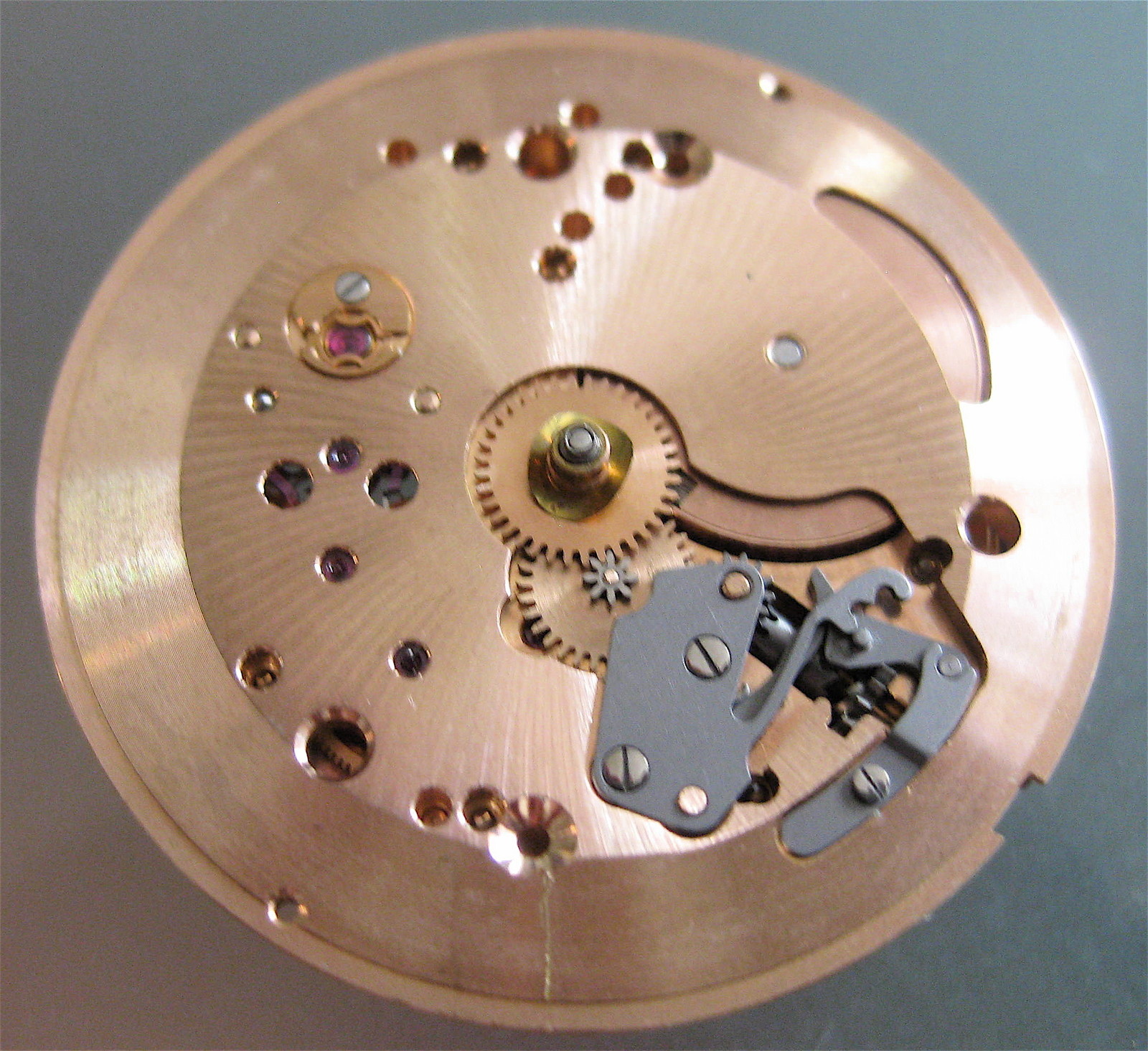

    Does his omega hands come with the bolt to put them into the caliber?

    Nope, it's just the hands. I know because I bought a pair from them last month.

    the piece that connects the hands to the caliber.
    Thanks Chiko, any idea where to get that piece?

    I'm not sure what that parts actually called but I would bet Ofrei has it, just separate from the hands

    Do you mean the pinion?

    $(KGrHqNHJCkFCbQvSgBRBQ)NL(Vrqg~~60_57.JPG Does this have the pinon already?

    Both cannon pinion (minute hand) and hour wheel (hour hand) are present.

    Thanks trim, so all i would need is the sub second pinion

    Sub second pinion is there as well. If not you'd be stripping the movement to replace the whole 4th wheel.
