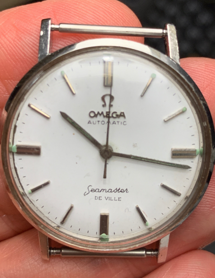

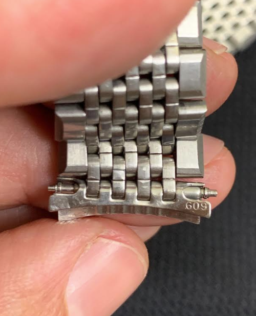

Does a chart exist that corresponds the numbers on the curved end of an Omega Beads of Rice Bracelet and the Seamaster De Ville model that it will fit? I have a 1962 Seamaster De Ville and am attempting to find a matching size curved end piece that will fit my late father's watch. The watch reference number is 14765-2 SC, the serial number begins with 19612... I purchased this bracelet, pictured below, only to find the curved end piece is too 'high' for my model watch. I am also attempting to find a replacement dial but Omega tells me they do not have one in stock. Any good sources to search?

#70 is the most common and I believe the #570 also works.
Star searching eBay for a dial.

Thanks! Any suggestions on where to purchase #70 end links?
