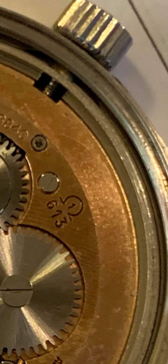

Posts 1,011 Likes 427 rogart ·Mar 14, 2020 What does the number meaning inside the Omega mark. In this 613 movement. Curious.
Posts 18,837 Likes 39,177 JimInOz ·Mar 14, 2020·Melbourne Australia Discussed many times here on the forum. I can't remember exactly, but think it indicated centre pinion height.
Posts 1,011 Likes 427 rogart ·Mar 14, 2020 JimInOz Discussed many times here on the forum. I can't remember exactly, but think it indicated centre pinion height. I thought so to. But didn't know what to search for. I will check.
Posts 16,918 Likes 48,150 STANDY ·Mar 14, 2020 Yep longer thingy the hands go on so they reach over higher markers ( like onyx inserts )
Posts 15,995 Likes 48,111 Canuck ·Mar 14, 2020 “Thingy”, often defined as centre wheel arbor, cannon pinion, and hour wheel. 😀
Posts 30,276 Likes 78,129 Archer ·Mar 14, 2020 This number denotes the "hand height" of the movement. This in turn tells you how long (tall) the hour wheel, cannon pinion, and sweep seconds pinion will be. Center wheel stays the same... Cheers, Al
