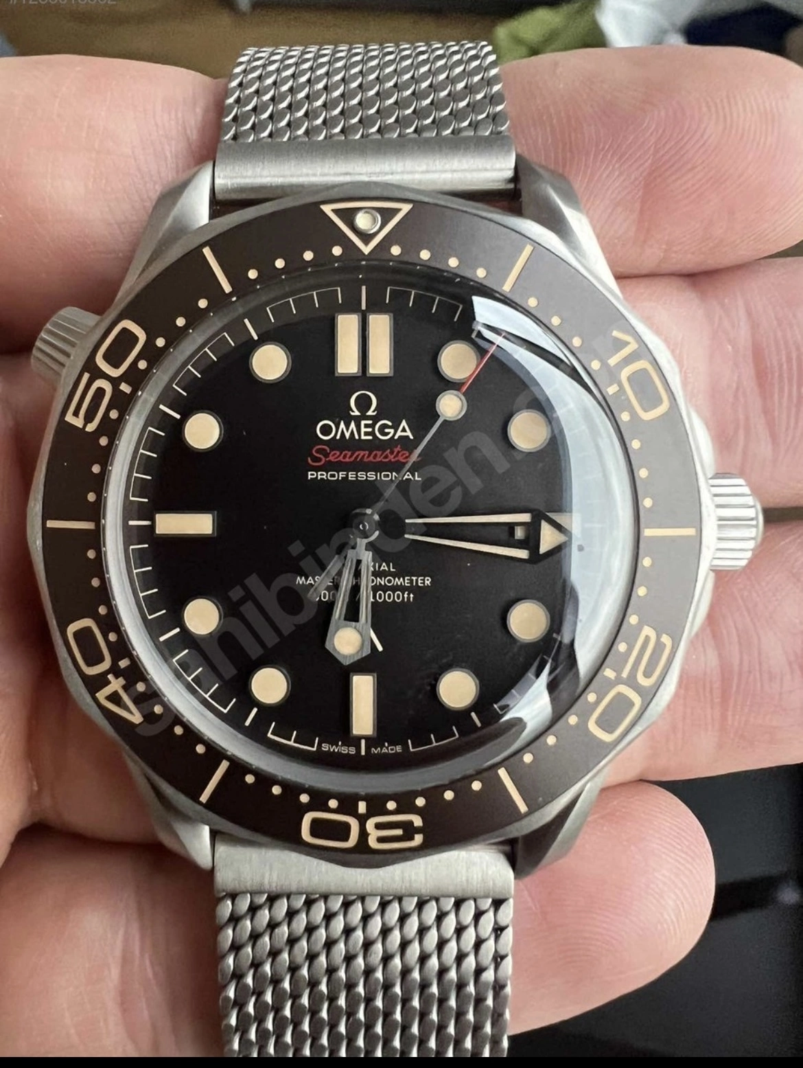

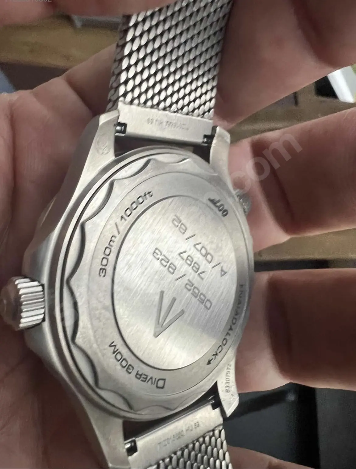

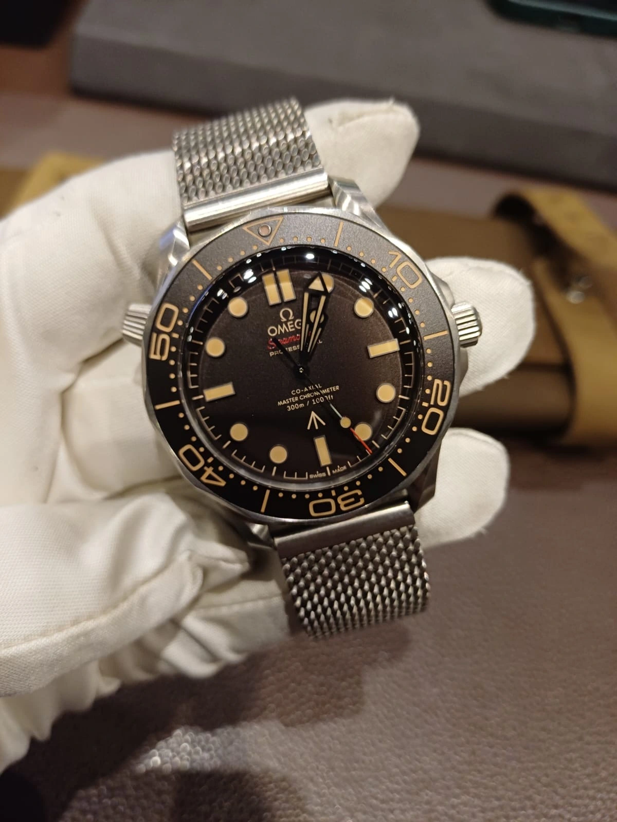

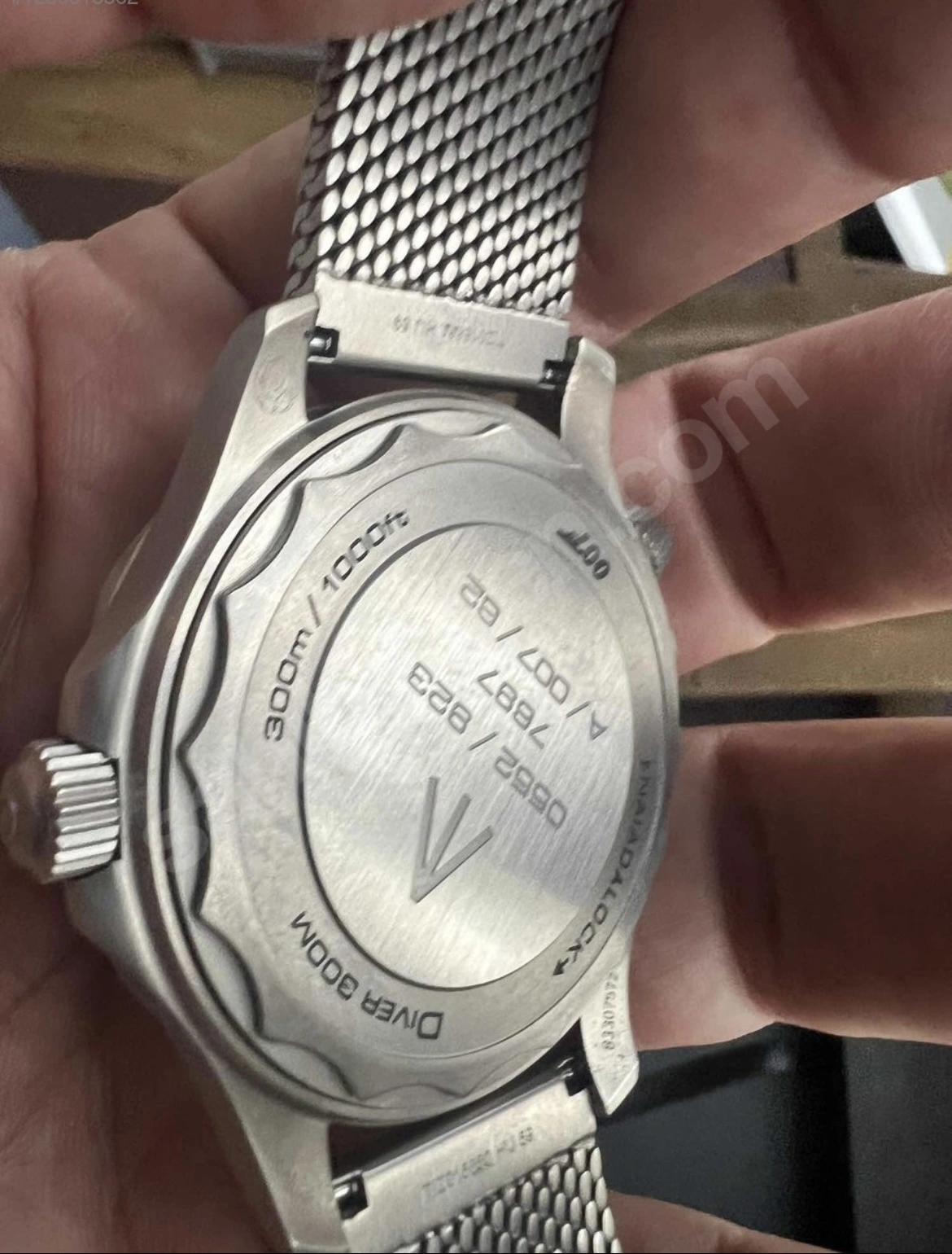

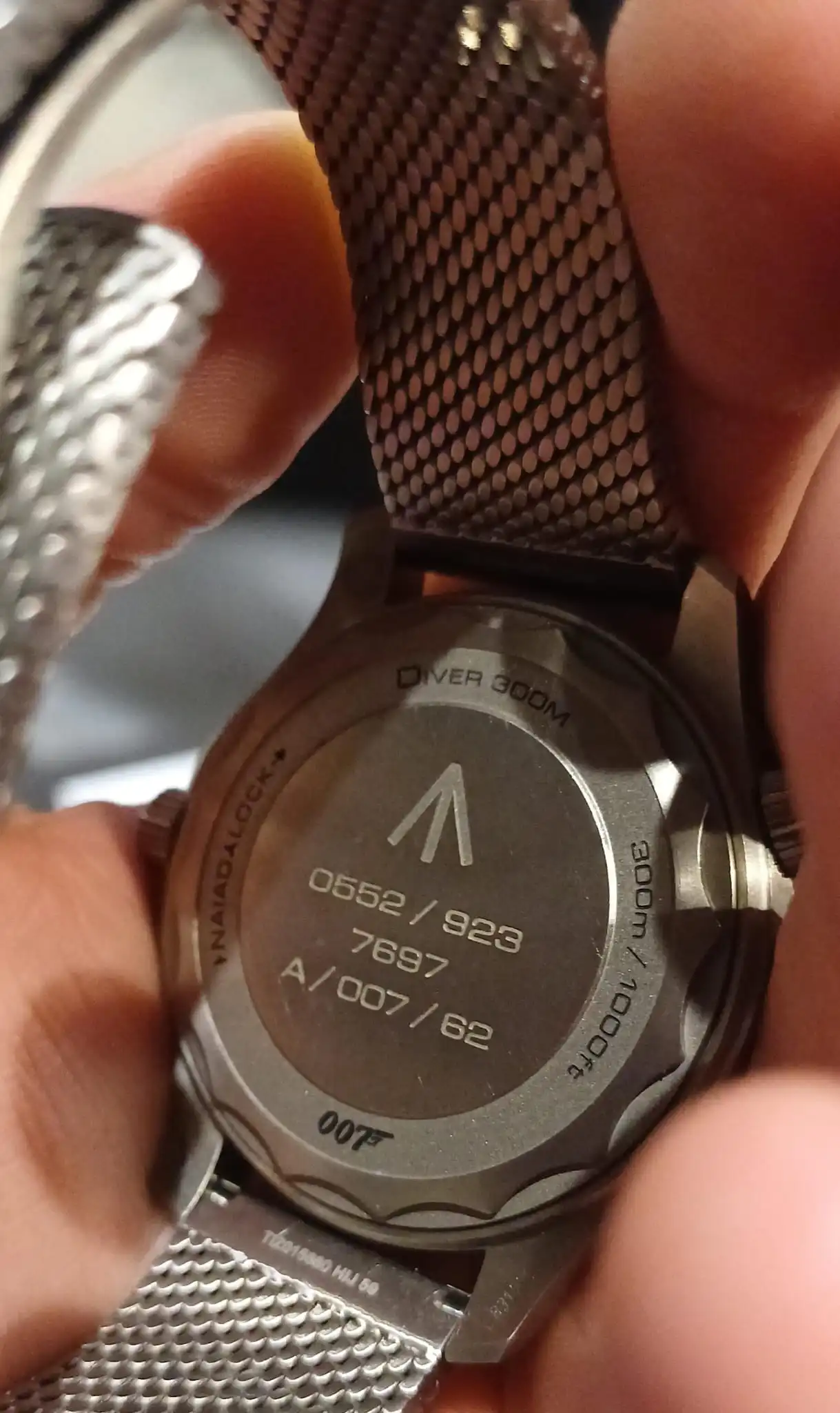

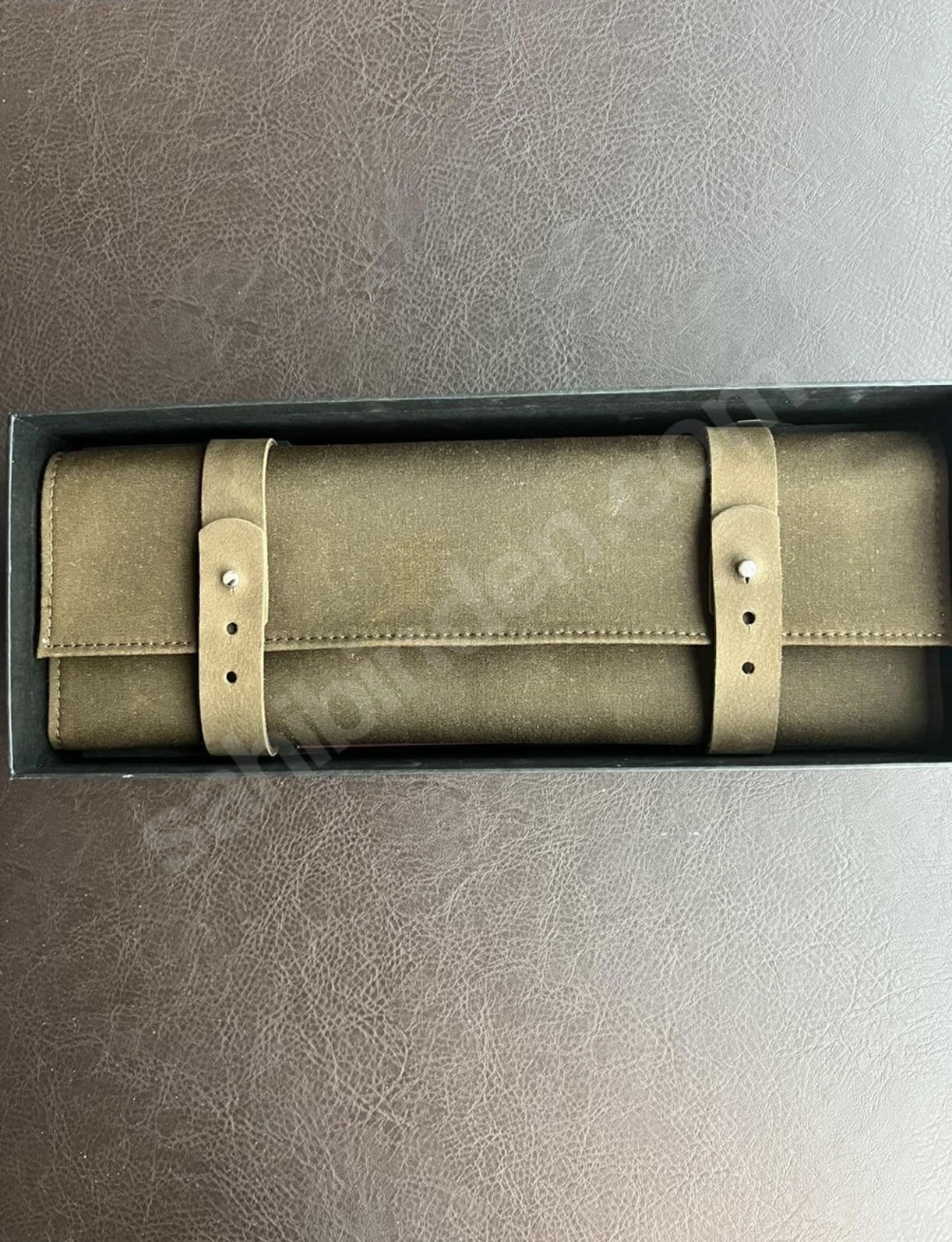

Hello everyone, I couldn’t get an answer in the main thread, so I wanted to post here.
Is this NTTD real? I want to buy from this seller but the misaligned caseback annoys me.
18
23

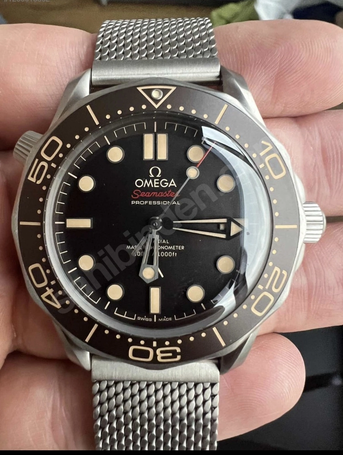

Based on the other thread and this one, there are enough red flags to leave it well alone. You've pointed out the incorrect canvas bag, the odd caseback, and there are a couple of other things I'm far from thrilled with in the pictures you've shared on this and the other thread. Fakes of popular models in China are getting exceptionally good now, to the extent even very good close up photos (and these aren't that good) can be very hard to spot. It makes me very wary parting with cash.
The NTTD calibre also beats at 3.5hz, though, which very few non-Omega calibres do - including super clones. The finishing still - as far as I'm aware - on the movements isn't going to fool anyone under a loupe, but since this is a solid caseback, it's a harder tell (and people who knowingly sell fakes aren't beyond sending you images of real calibres/timegrapher results). I'd walk away.

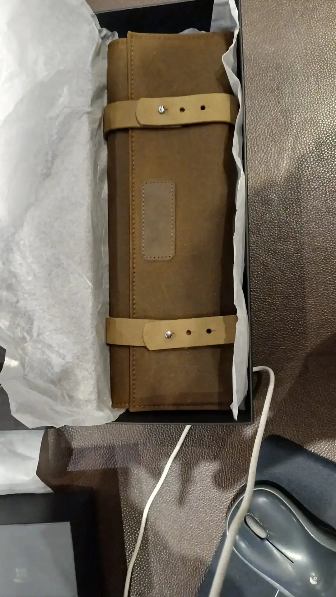

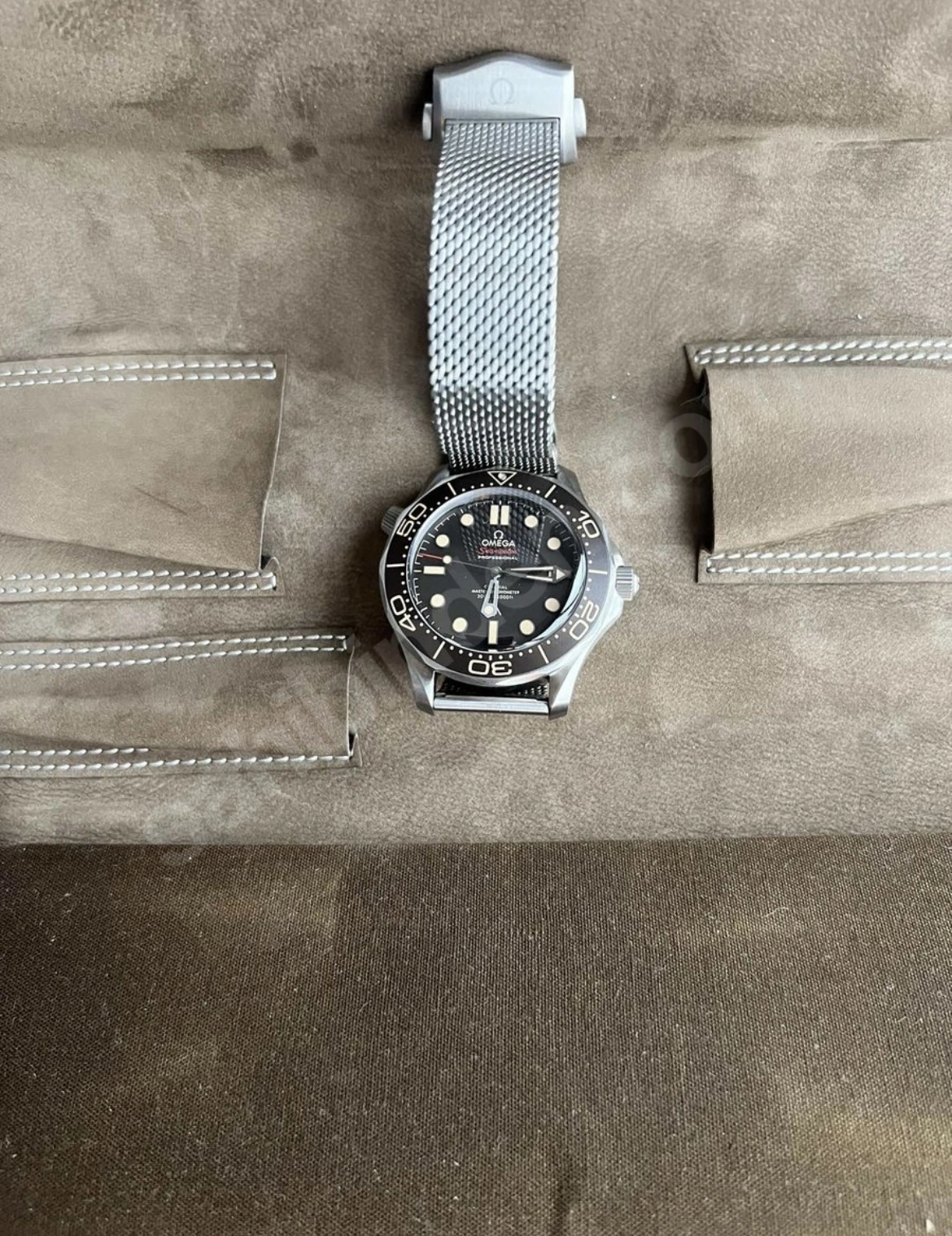

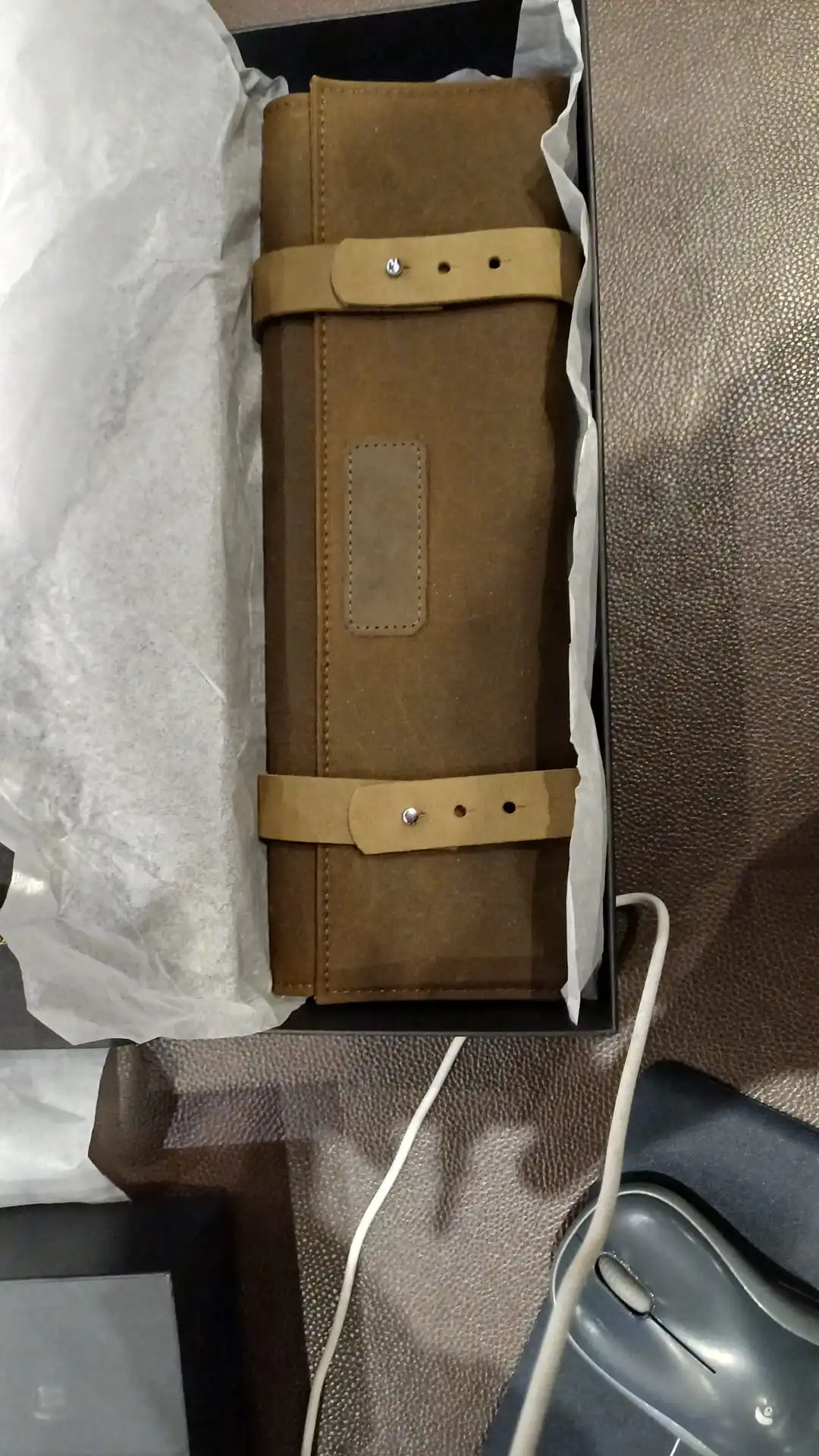

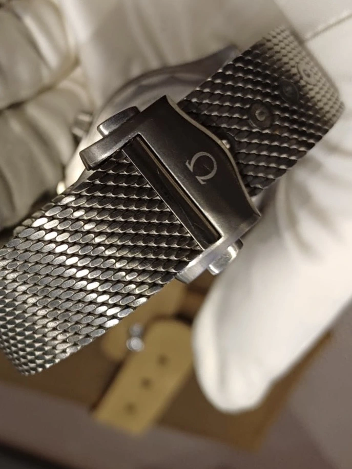

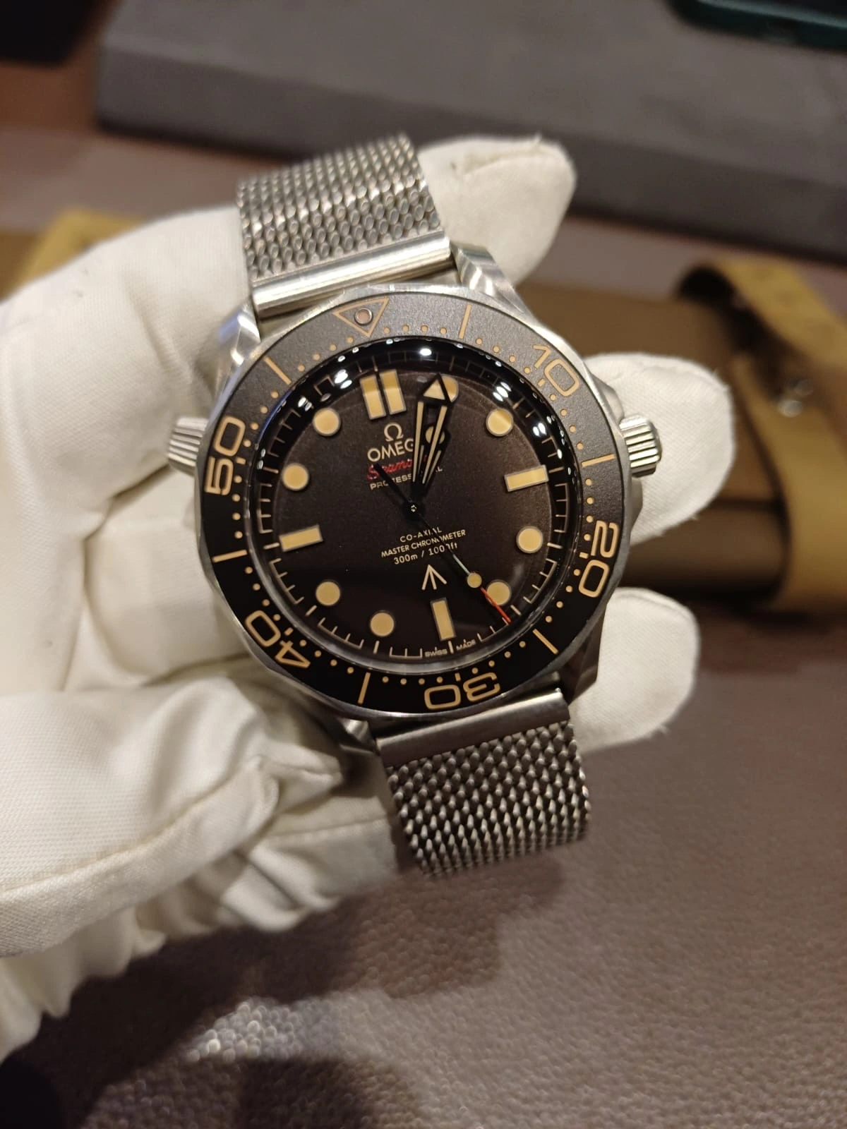

Thank you for the response. I got pics from another seller, everything seems perfect, but the pouch markings seem to be erased, is this a thing?
1,987
8,482
The bag for mine had nothing on that tag either. Did you get a springbar tool? some came with and some didn't.
no springbar, I can kinda see the outlines of the omega and 007 markings on the pouch but, do they get erased with time, I didn’t know
1,987
8,482
I didn't keep mine long enough to find out. Great watch, kinda sorry I sold it but the bracelet just didn't fit me, and I hate straps, so i sold it to pay for the FOIS.

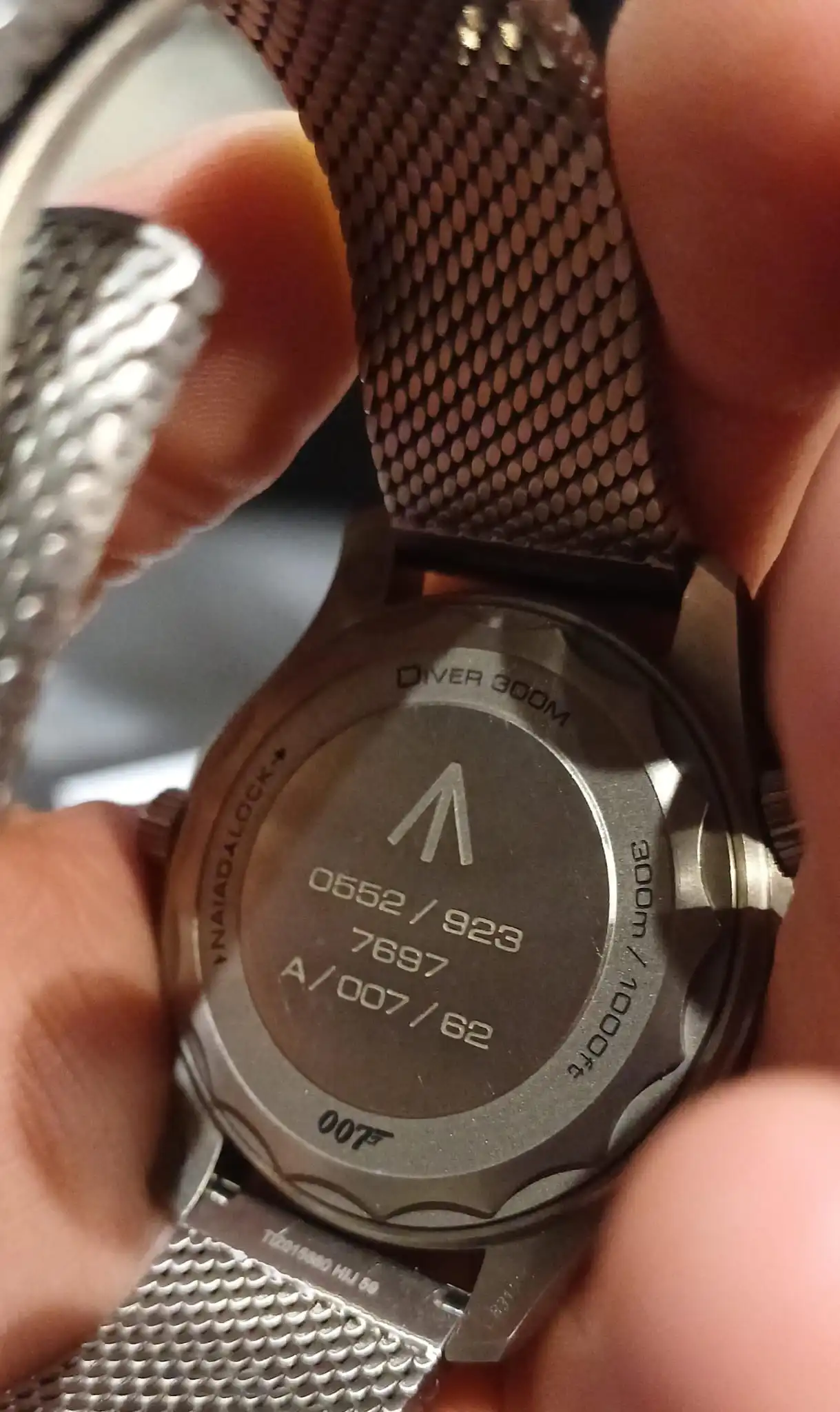

The case back has NAIAD Lock, so it should be aligned properly with all the 007 markings on the back in proper orientation.
That being said, the NTTD is very easily faked and the fakes are getting better and better, so if you have any doubts, just walk away and buy from a trusted seller. My $0.02
2,979
8,731
Oh yes I forgot about the naiad lock. The case back is crooked on the first one. There is something about the colour too, it seems to be too black.
