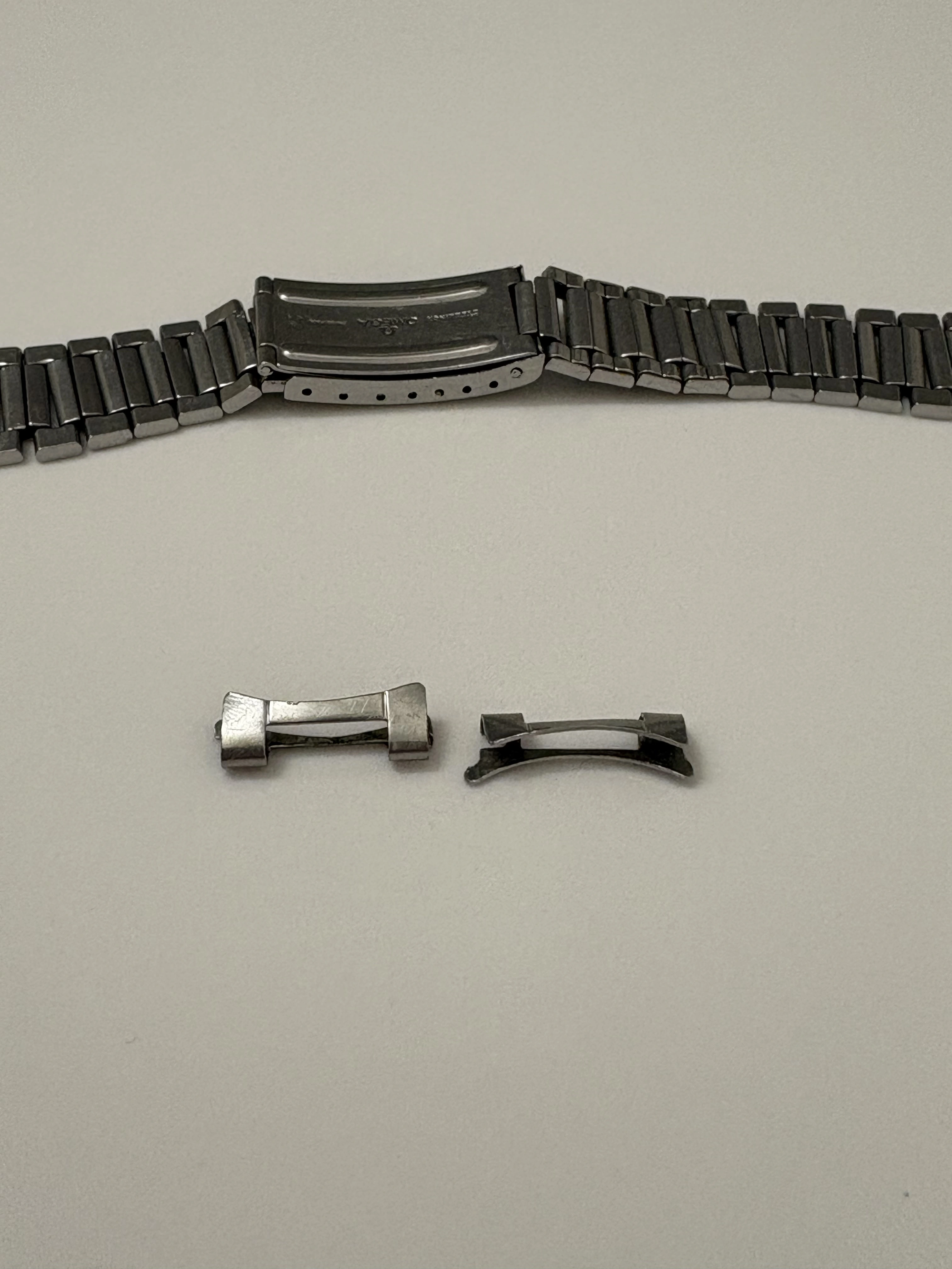

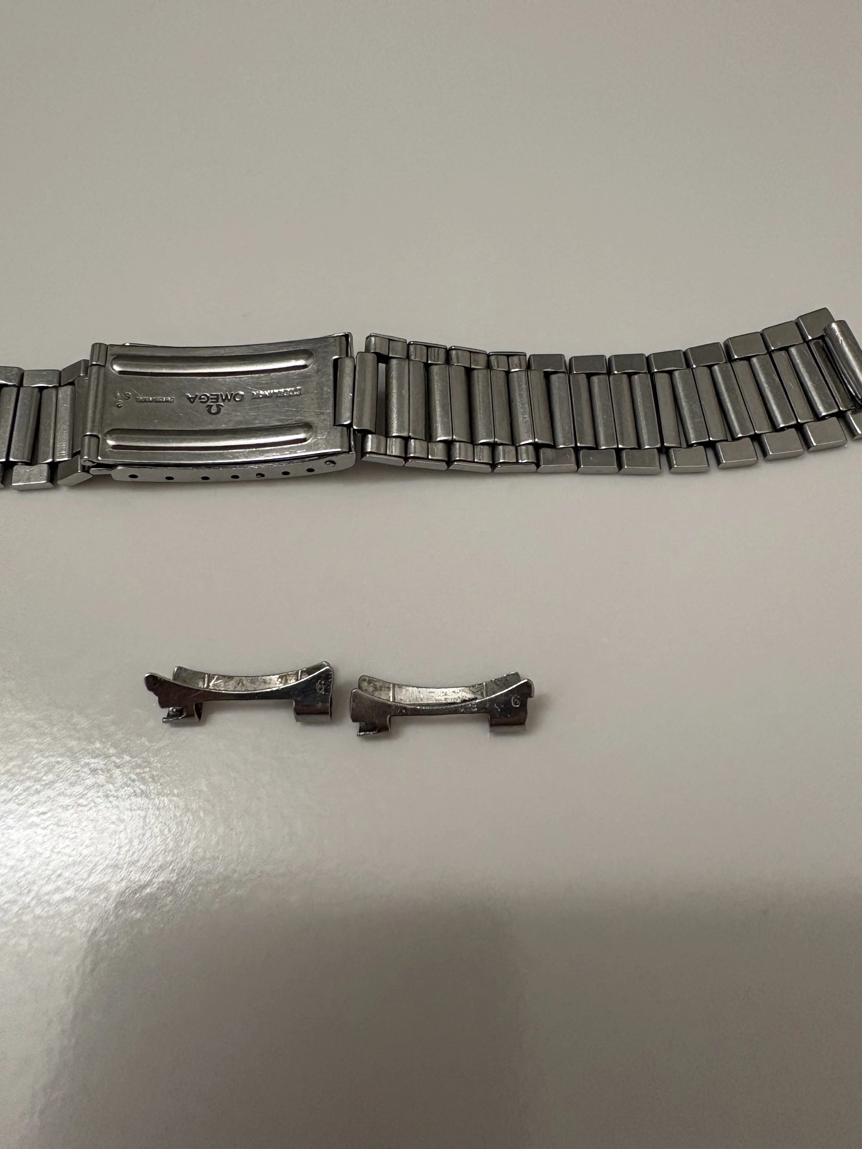

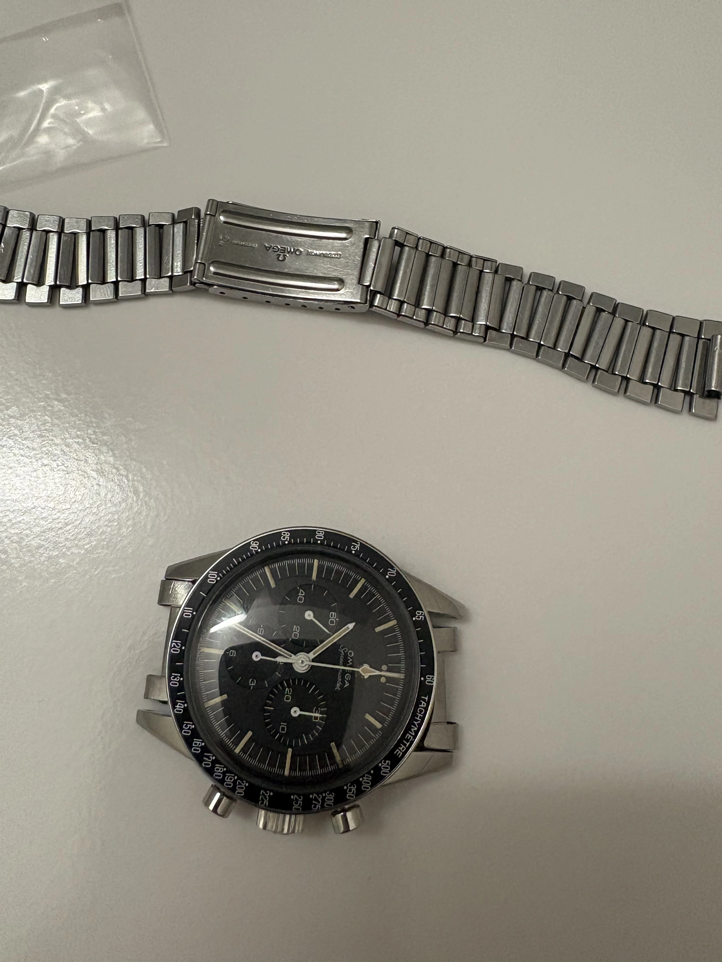

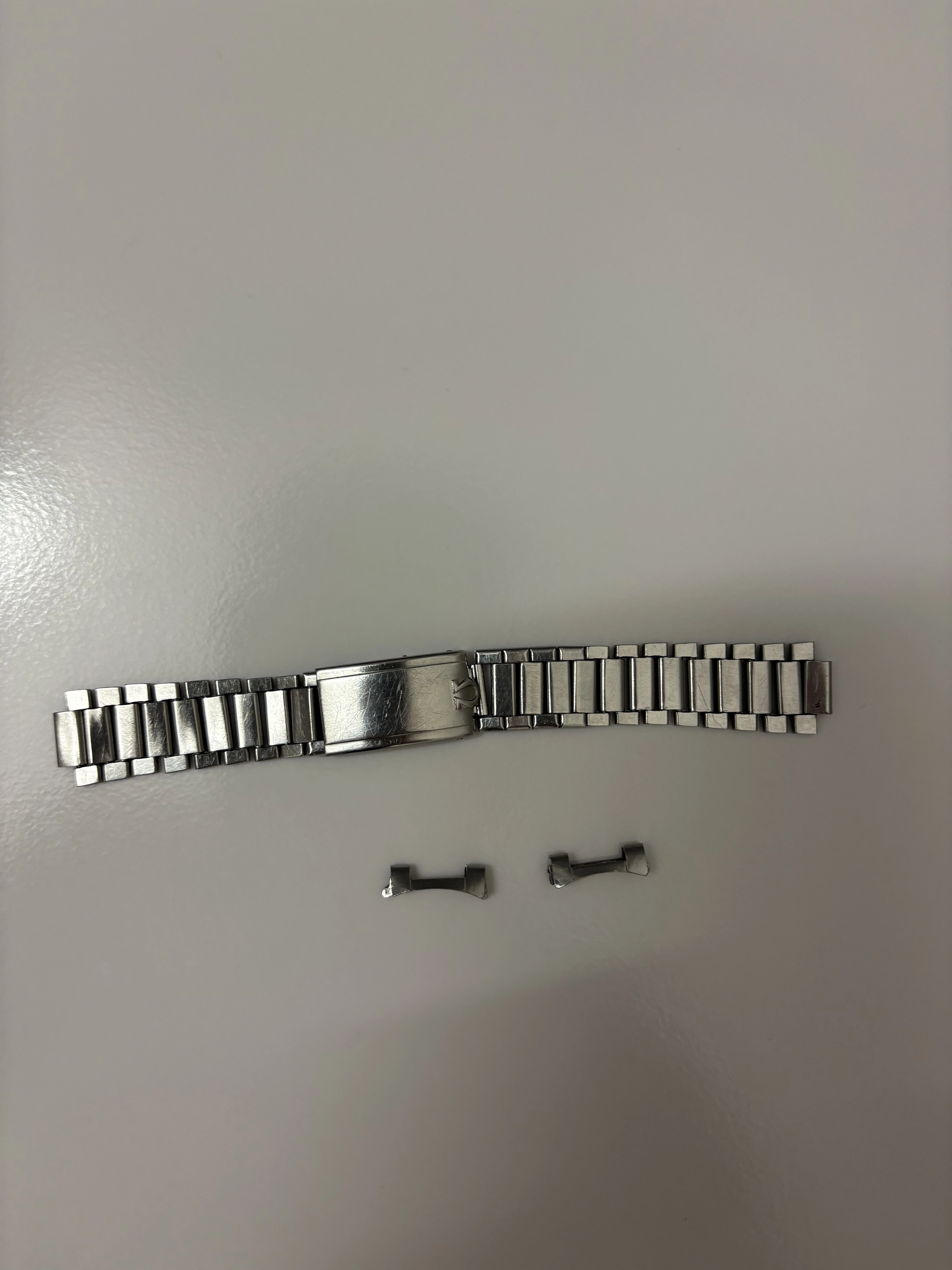

A watchmaker has sell me 2 nr 6 endlinks and a 7077 bracelet but the endlinks does not fit my 105.003
Its look like the end links are older i think probaly for a 2998 but why its does not fit my ed white ?

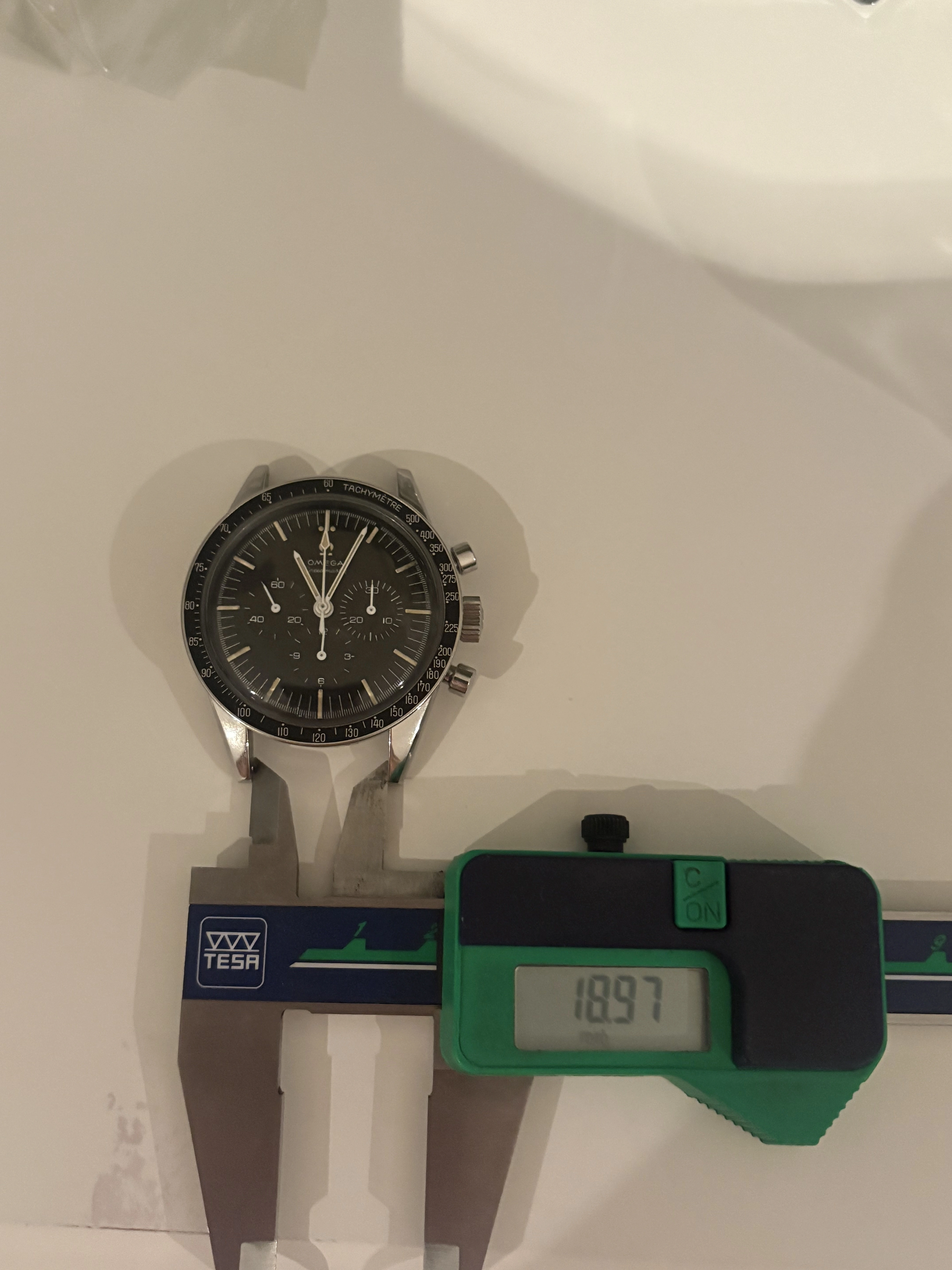

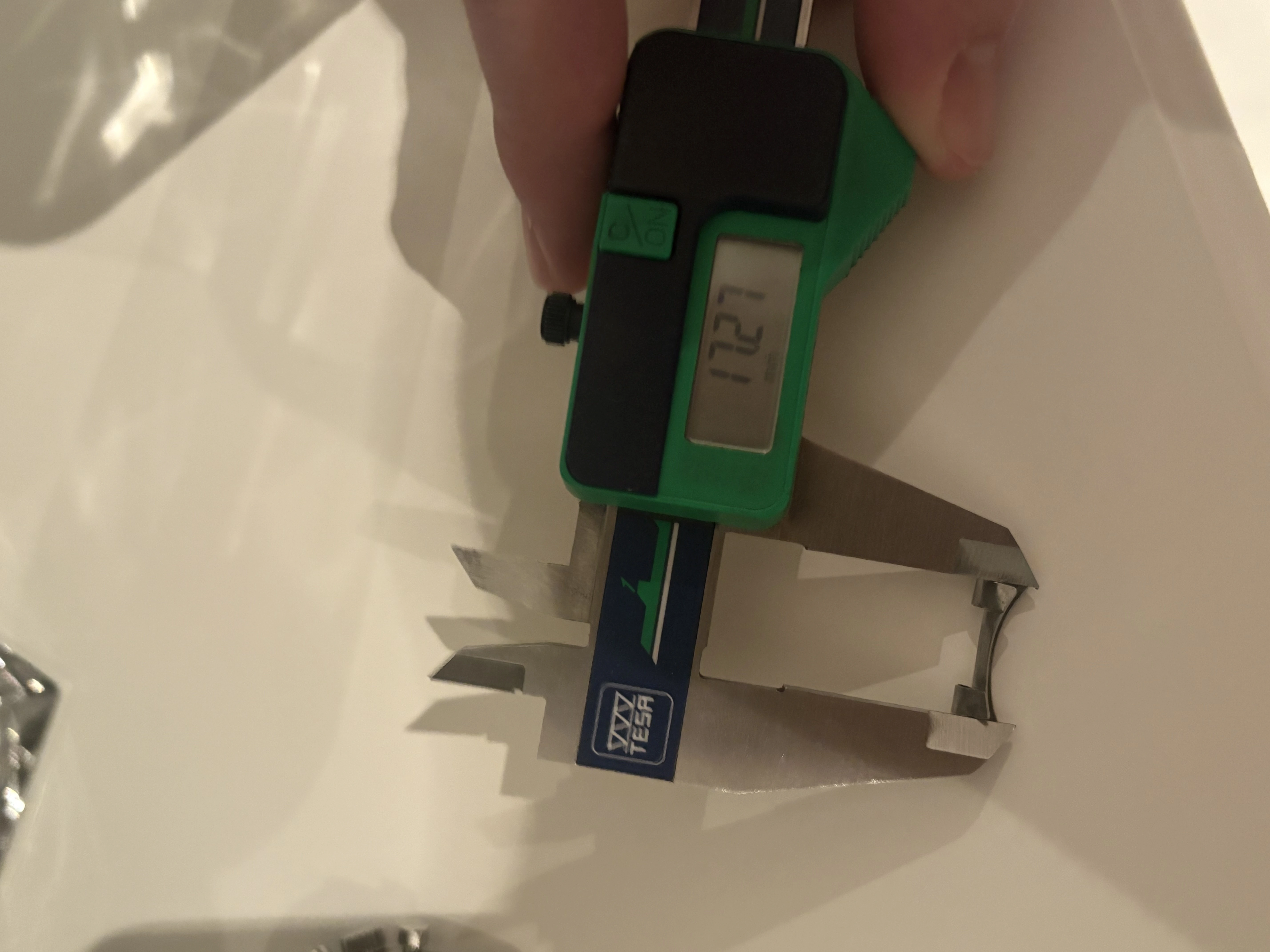

Perhaps someone modified the endlinks to make them narrower. To clarify everything, please post some measurements. How wide are the endlinks and what is the distance between the lugs of your watch?

Yes, as noted above, your end-links should be around 18.7mm and have likely been modified to fit an 18mm lug watch.

What can i make to bring this endlinks in his original form?
You would have to add 0.8mm to each side of both endlinks. In general, I would say that it's really not plausible. You should get your money back.

These wouldn't even be a good fit for an 18mm watch.
2,317
5,712
These have been butchered and unfortunately have no more value than a paperclip.
216
151
Such a shame. Hard to find as they were originally single cut No. 6's.
1,785
5,586
it's not original older open 6, which should also match the open 6 (ie 1506) on the bracelet.
509
1,063
Looks like they did not just shave off the sides of the end-links but from the top as well (watch side, if that makes more sense)
