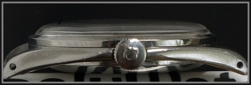

    Constellation 14381, 551, 17.7mil movement. Bezel and lugs look sharp, crown could be correct and BOR is a bonus. Currently at $900.
    Concerns -
    1. cant see and omega symbol on the crystal
    2. star seems a bit off skew or the bottom left point is broken.
    Anyone else see anything........

    Looks alright to me. Note the absence of a case back gasket, and thus you should ask if it has been replaced. May or may not be an original crown, depending on the origins of the watch, but don't bank on the crown offering much protection against dust and wrist moisture. Crystal issue is minor really and its hard to tell if the symbol was originally there because crystals get polished. Still some chamfer on the bezel and the lugs dont look overly rounded. Hands would seem to be correct as some of these early 81s did have hands that overreached the chapter ring a little more than in pie pans. BOR is a bonus.

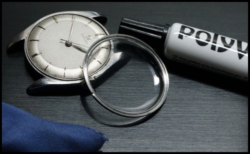

    img63955157.jpg Some replacement crystals are high domed and destroy the design of old omega watches, in my eyes. Polishing the crystal from both sides could help a lot.
