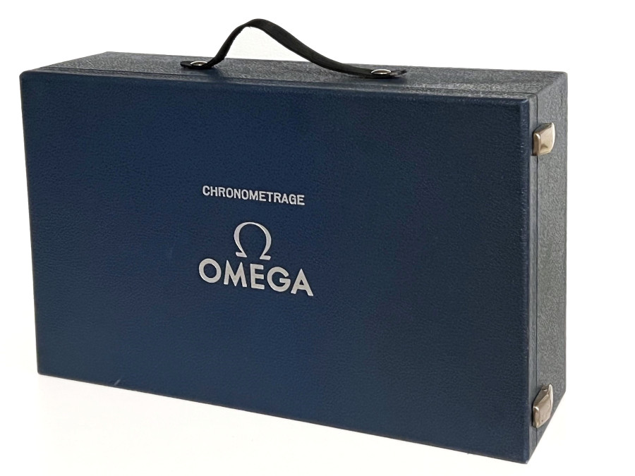

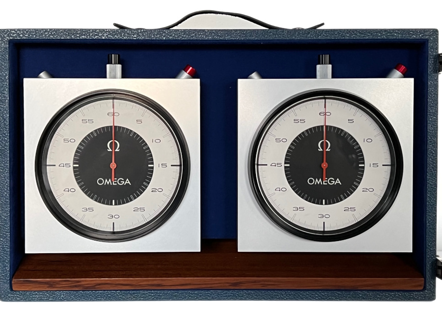

Please let me introduce you this rare Omega suitcase:
As you may guess, this is not your ordinary Omega suitcase. "Chronometrage Omega" may sound familiar to some of you: this is the name of the entity that was responsible for the timekeeping of many sport events, including most of the Olympic Games since 1932. It was merged later in the 1970s when the Federation of the Swiss Watch Industry encouraged Omega and Longines to join their forces under one entity named "Swiss Timing", which is still part of the Swatch group.

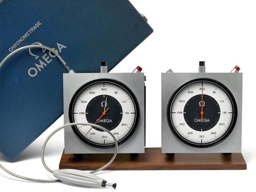

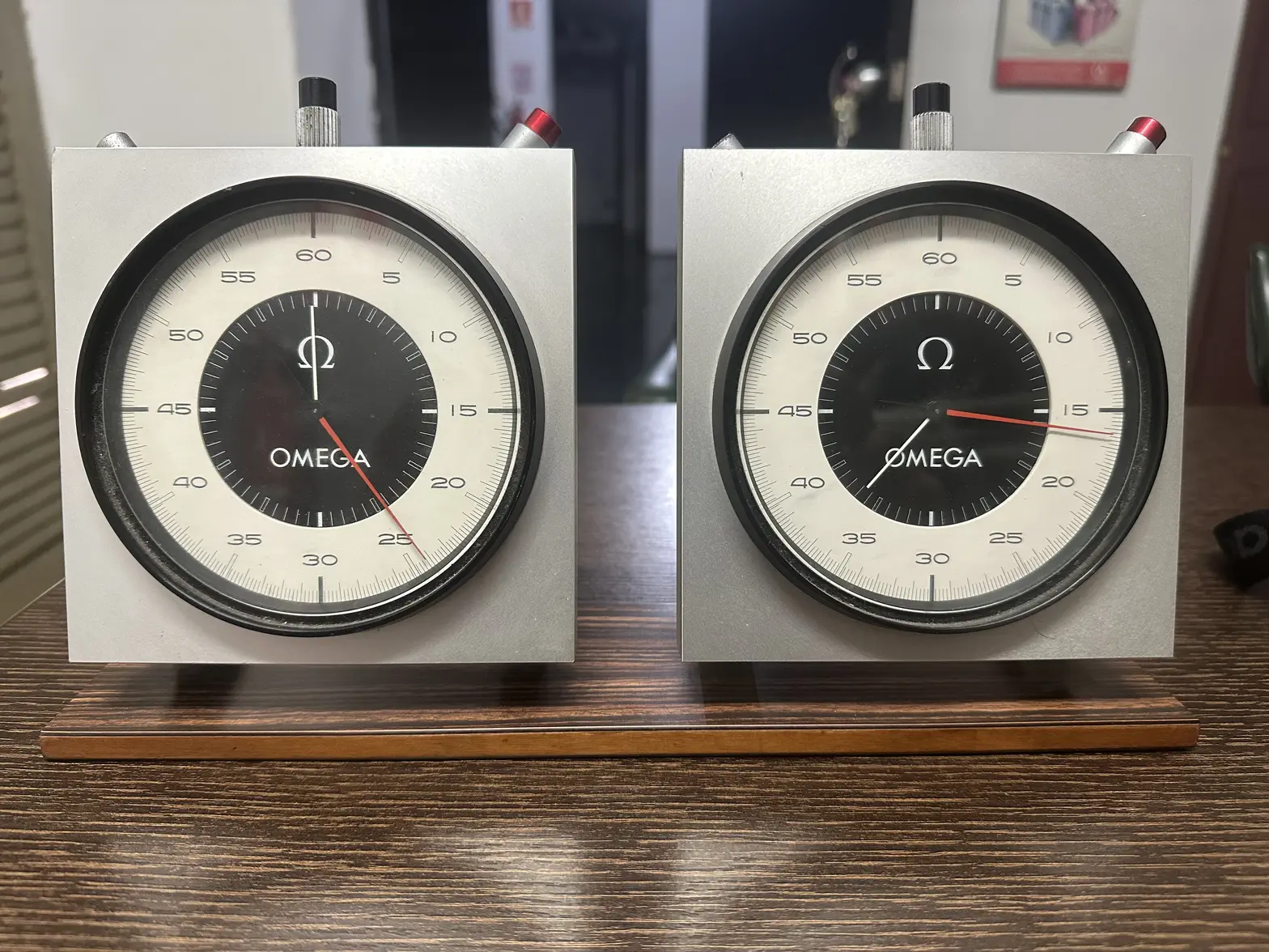

When you open the suicase, you find an interesting time-piece made of 2 clock timers on pedestal:

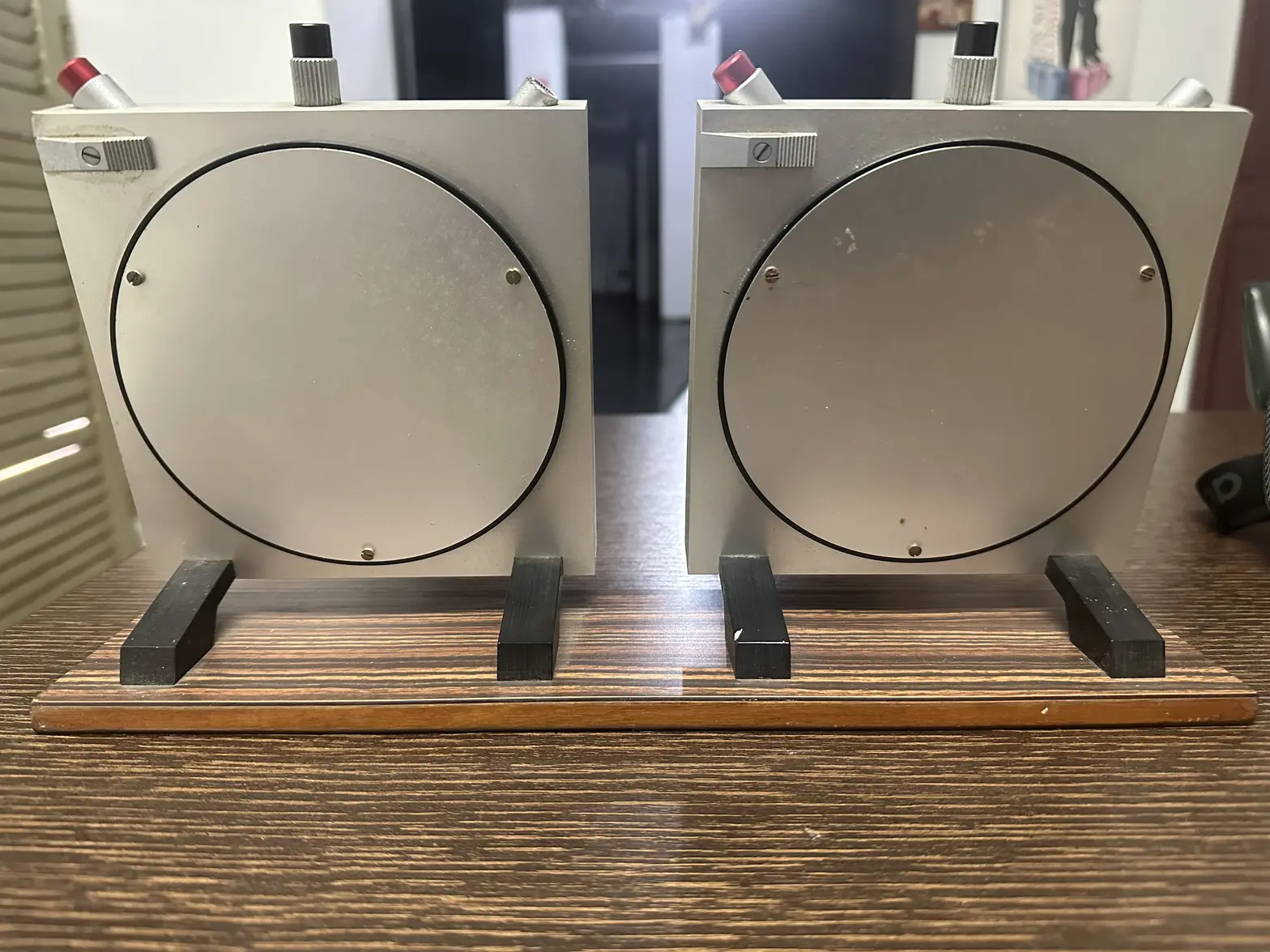

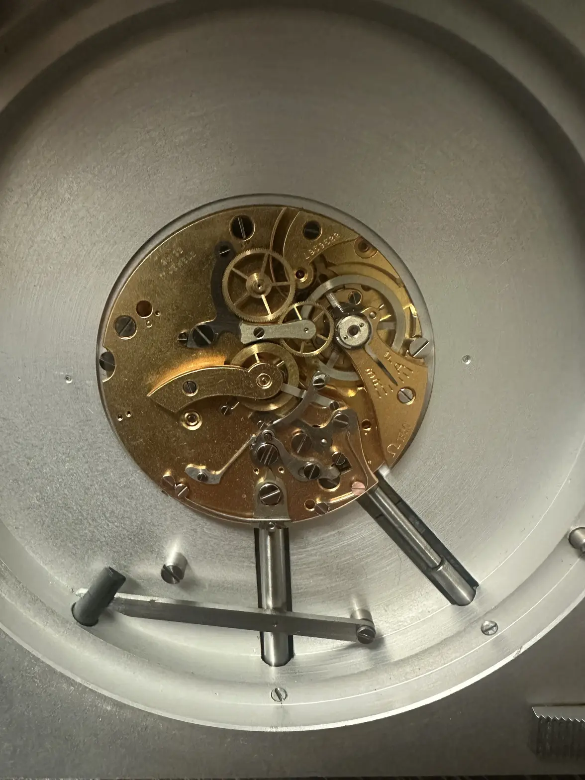

Both are 1/5th second 60 minutes clock timers, powered by the Omega Lemania-based 1350. Interestingly, the serial numbers are consecutive and can be dated from 1966.
In the suitcase, hiden in small holes located behind the timers, can be found a pair of remote control cables, that could be plugged into the left button, with similar action (start/stop) to the central black pusher.

Its possible that these are Lemania Serial numbers and not Omega, so dating by serial may not be conclusive, have you looked at others to get a feel of the serial range?
Indeed, these are definitely Lemania serial numbers.
