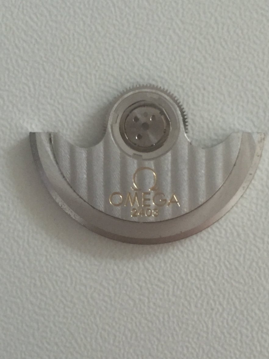

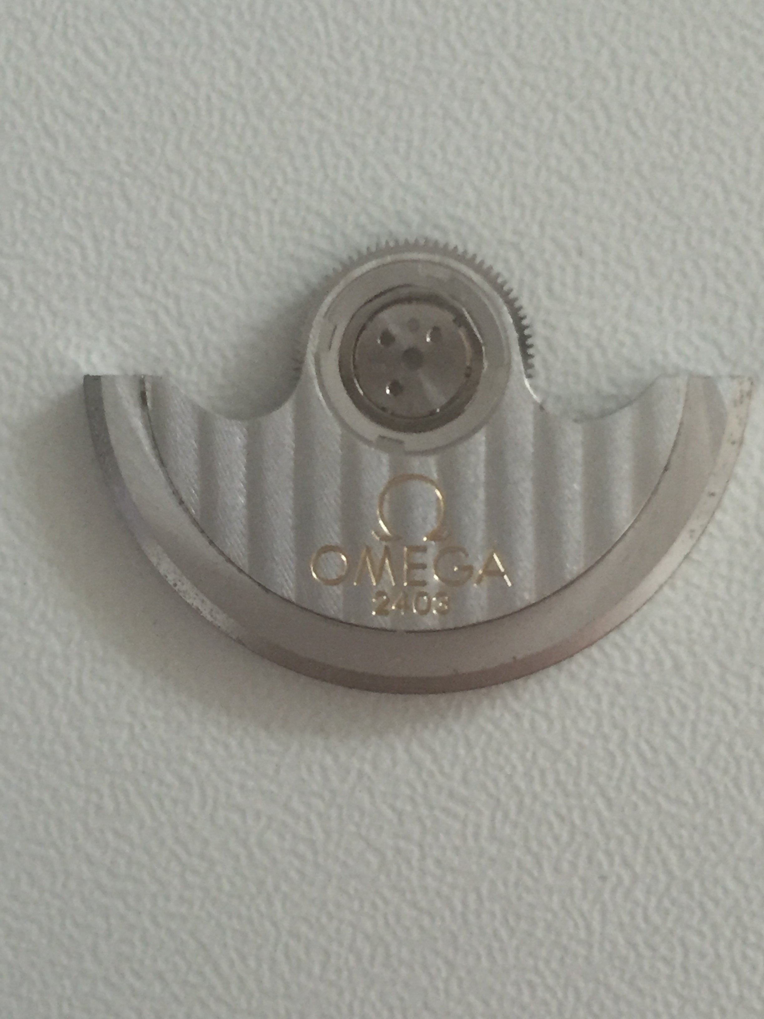

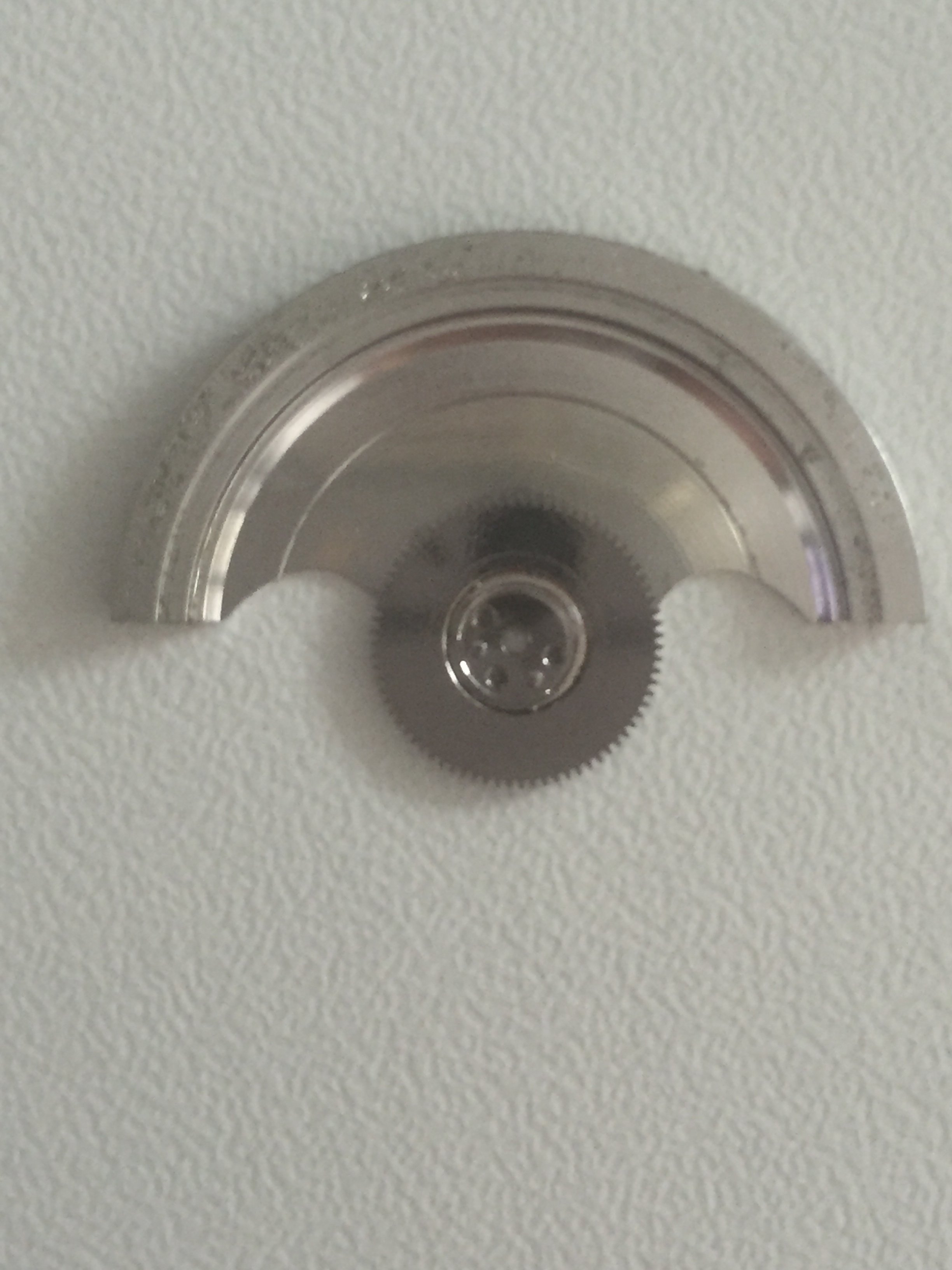

OK, I finally got the watch back. Everyone at the Omega service centre was at home for the past few months. Here's the weight pics. I don't see anything wrong with it myself, but I'm not an expert either...

The plating appears to be flaking off, so that looks like why they replaced it.

Curious, is it common for the plating to flake off without moisture or something else entering the watch?
No, not common at all...
