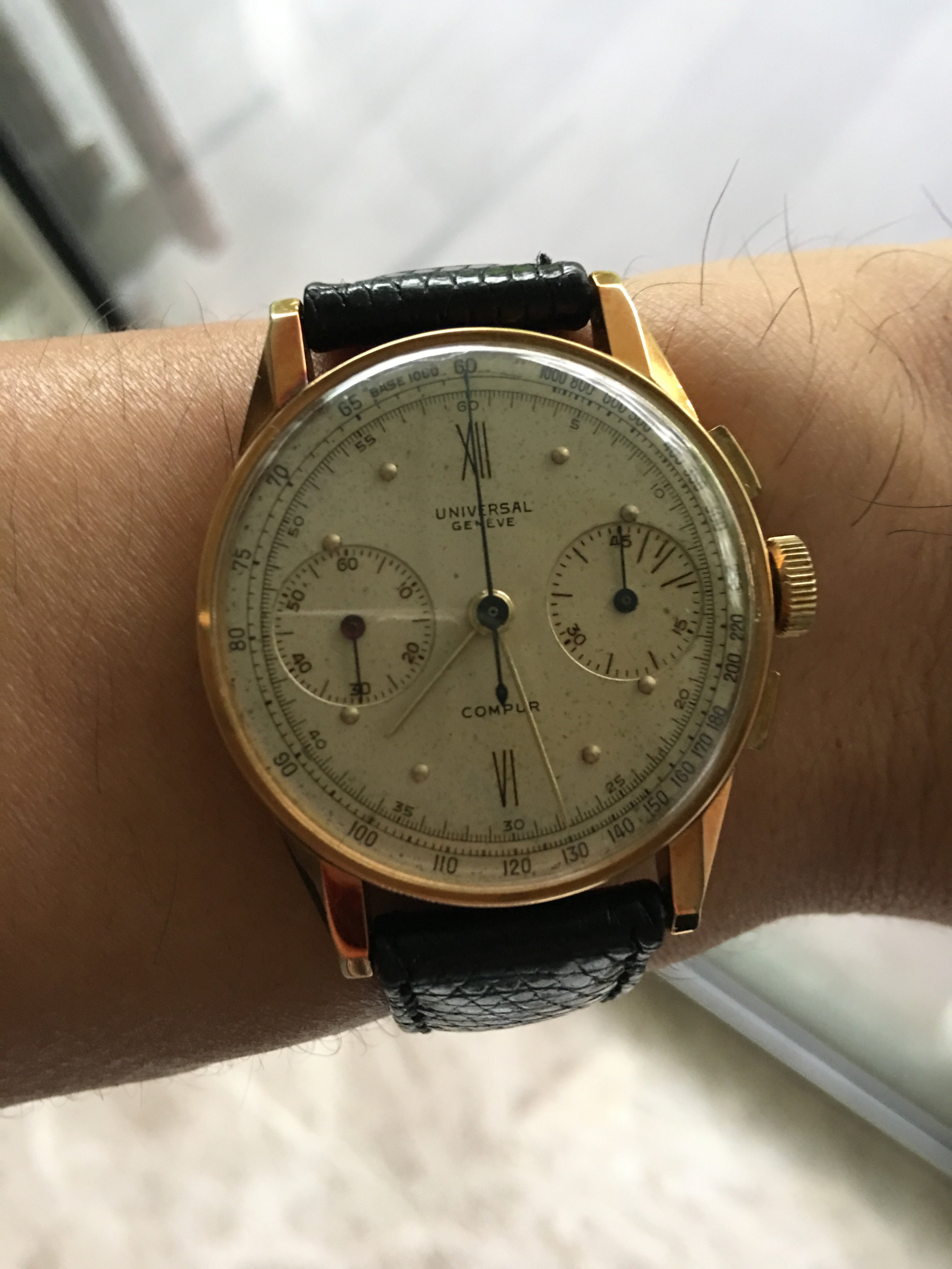

Hey guys,
I've seen this ad on chronocentric today, and it peaked my interest. Unfortunately it is really too small for me at 34mm, but the dial looks awesome.
The seller says that it is a prototype since it has no reference number and since the dial is unseen on other examples (but looks kosher overall).
I've created this thread because I've seen a couple of claimed "prototype" dials on Universal Geneves, and I wonder if someone knows wether UG tested watches this way or not.
I've exchanged a couple of emails with the seller and he told me that he hasn't found another one like it in Sala's book, but he's sure the dial is legit.
To be clear: I'm not looking to buy it, I'm just really curious to get a clue of the originality of these random UG prototypes.

Apart from the obvious issues (hands, crown, mis-matched pushers), there are a lot of other peculiarities that do not stack up. I would like a frontal of dial before airing my reservations. However, one thing to i would like to point out is that just because it does not have a serial number on it does not necessarily make it a prototype.

I would like a full frontal as it is difficult to tell but the register hands seem mismatched. I would have expected leaf rather than straight baton hands as although there are no hard and fast rules, baton hands seem to be popular in late 30s early 40s when bespoke requests were frequent not on what looks like a late 40 early 50s dial.
Additionally, looking through archives, it does seem that silver hands would normally be used on a dark dial, while lighter dials adopted dark hands (contrast to ease reading position I presume).
The square batons on dial is very unusual. However, UG started experimenting with different dial designs around that time. It is specified as a prototype; any further information or proof? . Difficult to ascertain if it is correct but font looks good and . Bottom line is that I am unsure and would rather keep away from a reference that there is little info . ...

Also raises the possibility that an excess of caution can cause one to pass opportunities by. In my view, this watch is correct but for the wonky pusher, and is not a prototype (ridiculous, overused word that it is). Dial fonts are fine, as Diabolik observes, and the sticks seem well within the realm of possibility. You'd certainly have a hard time disproving their plausibility given UG's florid inconsistency. The case is documented in Sala.

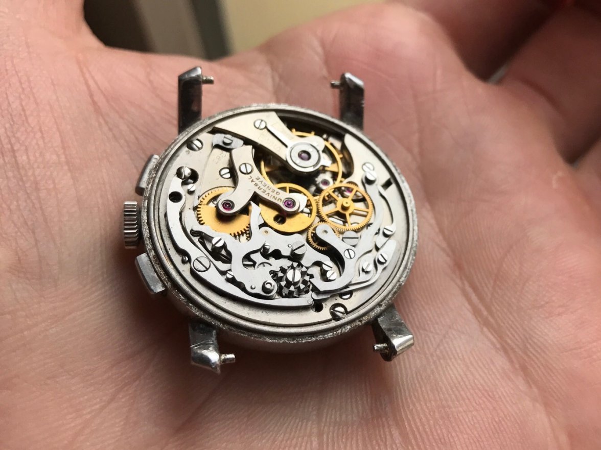

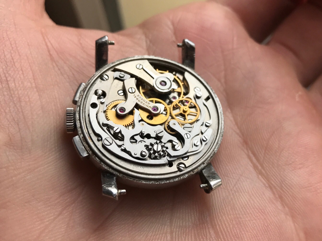

I am actually considering this purchase and I was about to create a post to ask about this watch until I saw that OP has started it.
The seller provided me with photos of the photos and there is no serial number on it as well.
Are there any other explanations as to why it wouldn't have a serial number on movement/case if it is not a prototype? It is a calibre 283 on the photo he sent me.
I'm not sure if I will be violating any copyright or privacy laws if I post the photo he sent me? lmk if I can post it and I'll happily do so.
