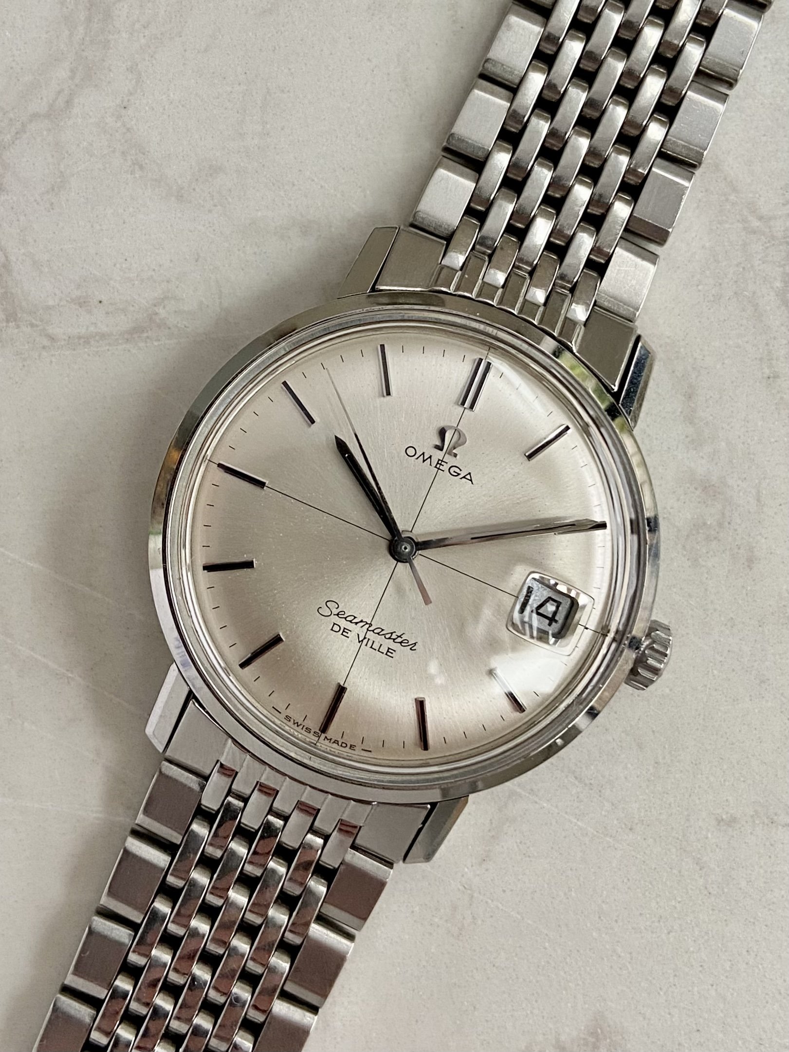

Thanks David, What does the beads of rice one for that watch look like and do you think its best for it? Cheers
13,518
23,452
This is the beads of rice. I adore flat links but a DeVille ok BoR is always a great option.

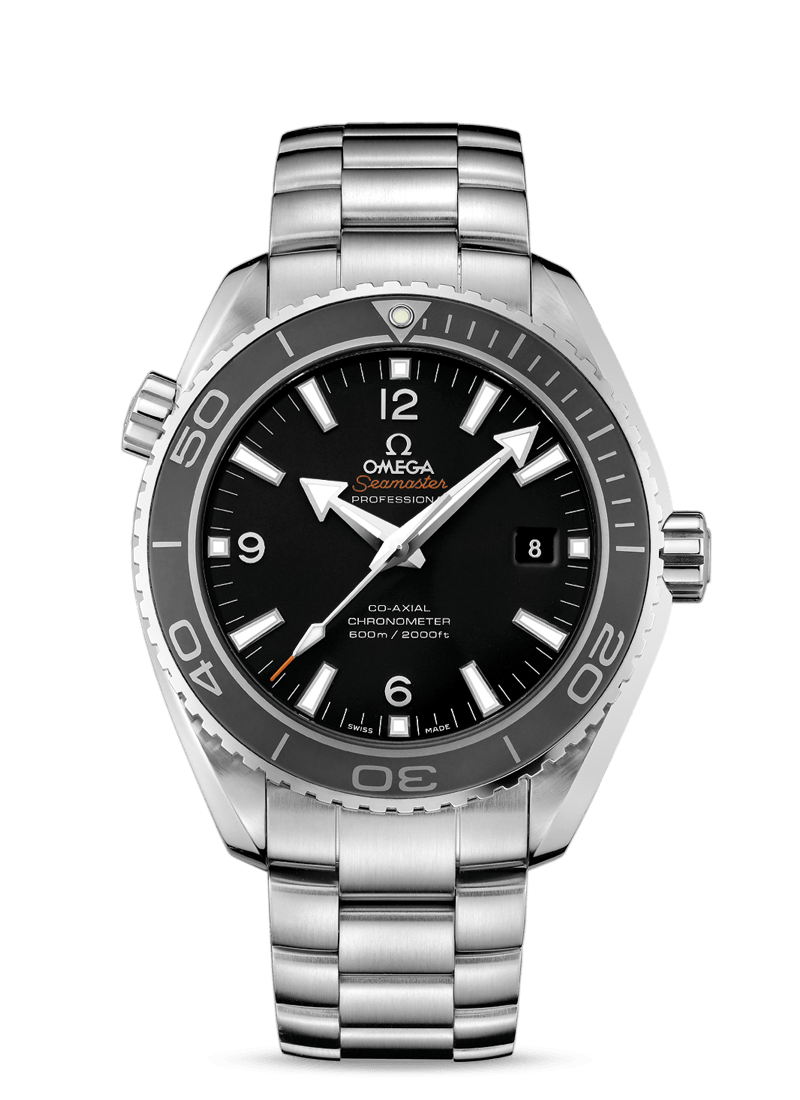

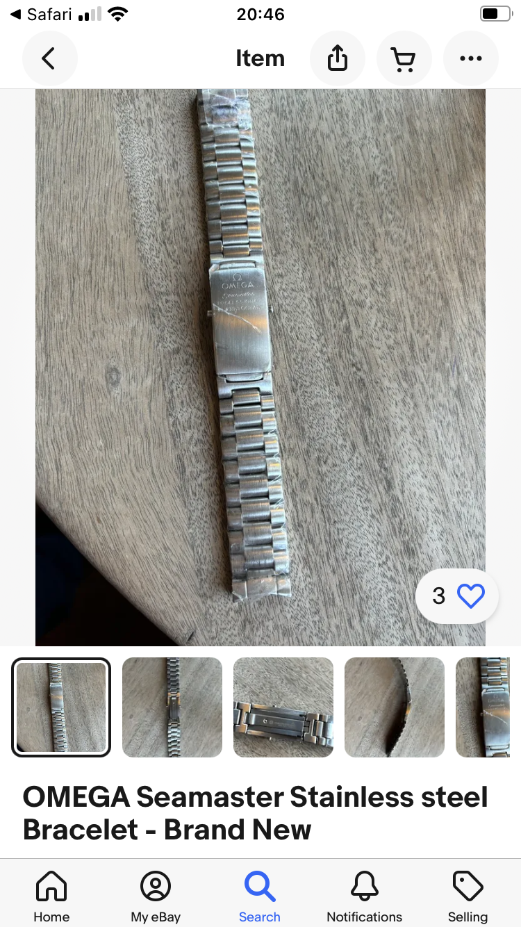

No the original was flatlink. I am looking at pictures and when my Dad had it it was the same as the pics of flatlink. It was from the 60s or very early 70s. I wondered if this bracelet would fit or is it fake?
6,609
26,776
No, not at all. That bracelet is modern (and may even be as thick as your watch head) and looks to be for the Seamaster Planet Ocean line.
13,518
23,452
That bracelet will look atrocious on your watch. In fact it won’t even fit as it’s likely 21-22mm and your watch has 18mm lugs.
13,518
23,452
All the info you need has been posted in this thread.
If you just try and pick random Omega bracelets like the one above you’re likely to run into an expensive mistake.

Yep. Or just get a nice 18mm generic leather strap.
The beads of rice should be the 7 row variety with 70 or 570 Endlinks.
