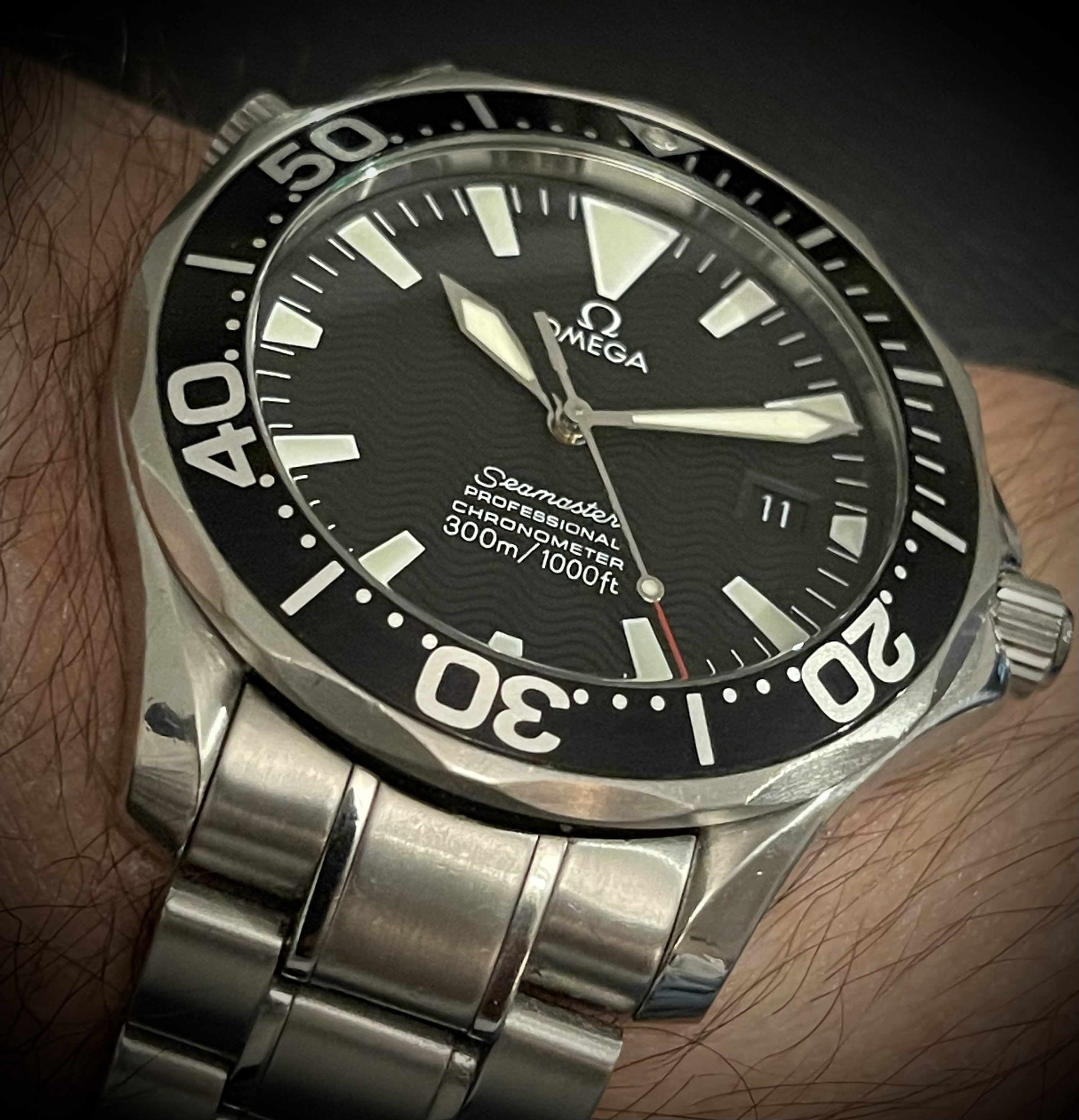

Hi, my lately daily driver is an astonishing SMP 2254.50 “Peter Blake” on OEM ss bracelet. I consider putting it on an OEM newer SMP300 rubber band with deployment clasp. Both cases’ between the lugs distance is 20 mm, but the newer SMP case diameter is 42 mm (thickness 13.6 mm) while the 2254.50’s is 41 mm (thickness 11.5 mm). Will appreciate input from those who did this if possible at all. Thx. In advance for advice.

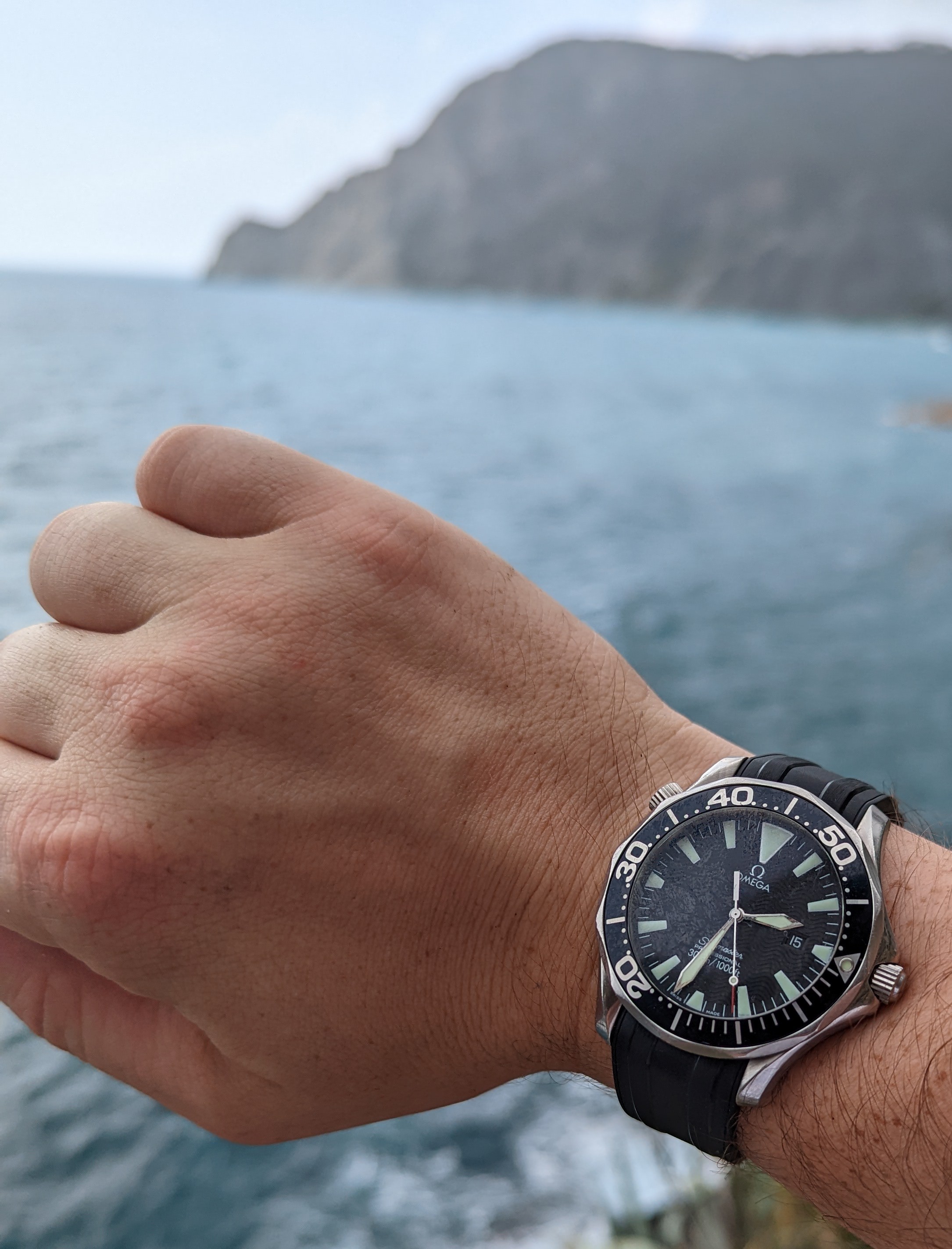

Here is my 2264.50 on the current gen OEM rubber (standard buckle version).
Others are correct, the spring bars do not line up perfectly, so I really had to work to get the spring bars in place. I attempted this after seeing it on another forum member (I will link that thread when I find it).
Makes for a really good travel companion.

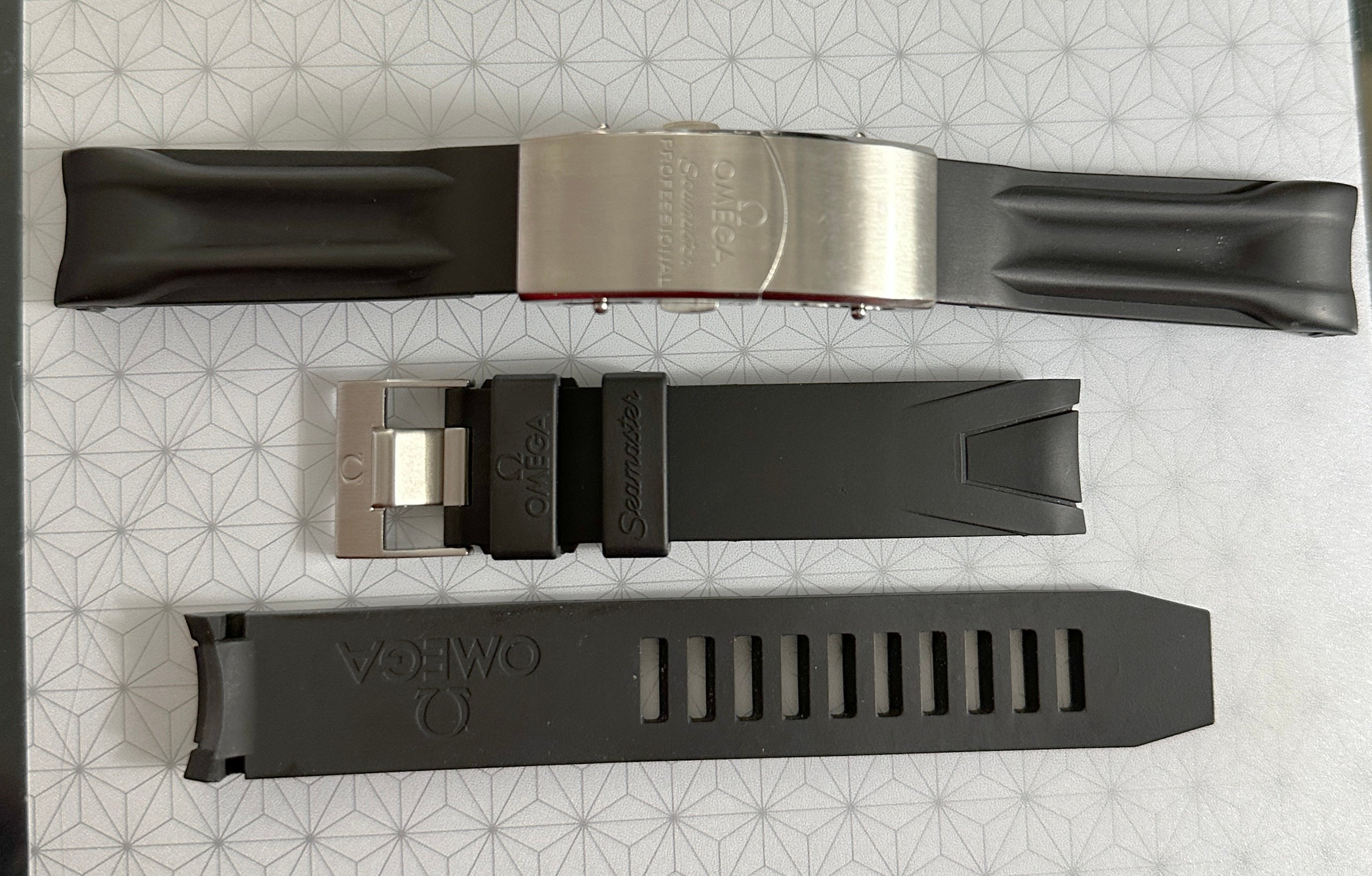

You can still get rubber straps for these.
The top strap is the "sports strap", the rubber piece's part number is O97996082 and the clasp is 94531803. The bottom one is 98000085. It was intended for the GMT but it fits.
The other rubber strap for the 2254.50 is basically junk.
You will find straps looking like the lower one on eBay but most of them are bad copies. Do not buy them!
You will get the best prices on new from Omega directly. I had to replace the rubber part of the sports strap and that was $250. I don't remember what the other pieces cost but of course they are not pocket change.
