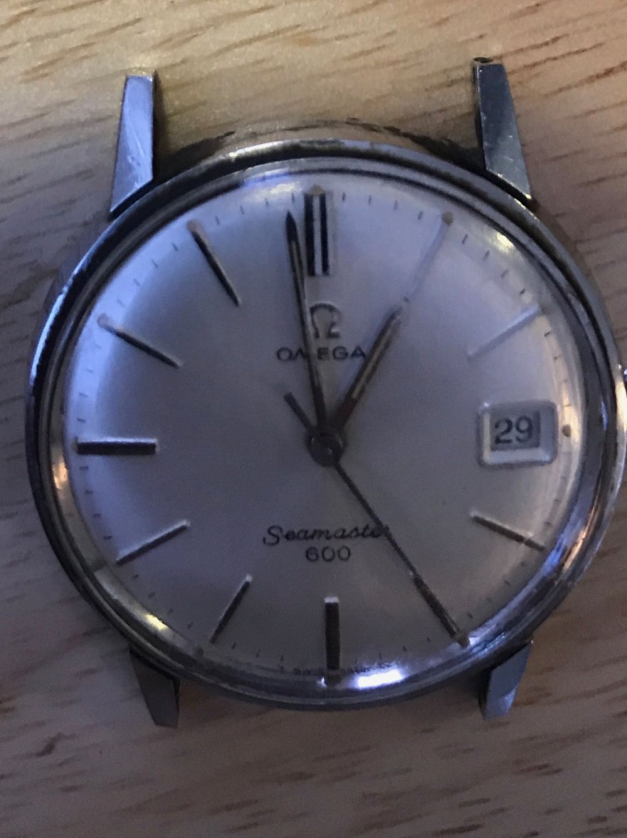

    Picked this up this past weekend at a Church yard sale. It was in a bag with a bunch of watch junk. Is this
    really what it seams to be. Thanks in advance Chasg

    Yep, it sure seems to be a watch. I hope that was what you were thinking, too.

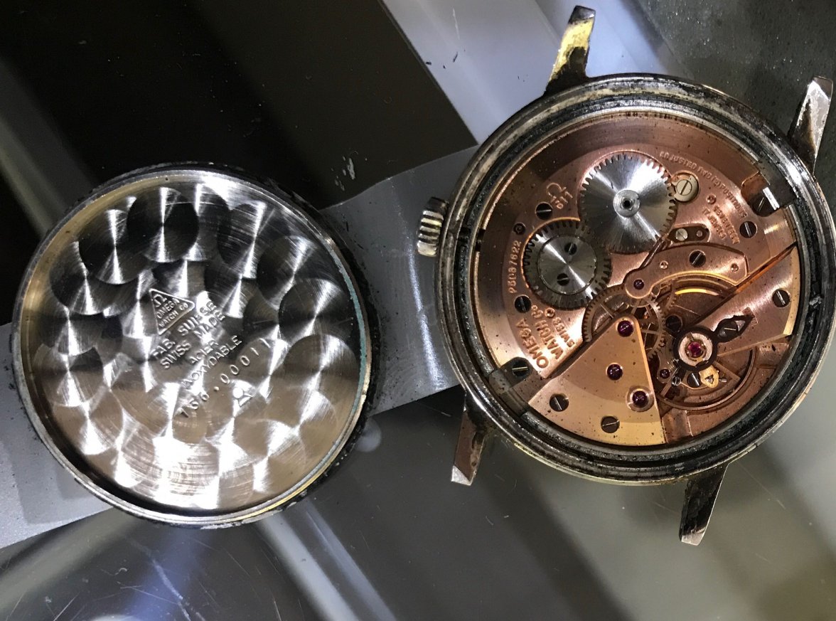

    Okay, I'm totally new, but I'll take a stab at it.
    1964 Omega Seamaster 600, reference 136.001, caliber 611.
    To my relatively untrained eye it looks good. It's got the Ts next to "Swiss Made" along with the corresponding lume on the hands. No obvious signs of a redial to me. Fonts look good. Doesn't look like it has been polished. Some corrosion inside, but doesn't look too bad.
    Now an actual expert can chime in and tell us how I did.:D
  4. JimInOz Melbourne Australia Oct 16, 2018
    15,398
    32,153
    Dial may have been re painted at some stage (based on my observation of the photos provided).
    Movement is missing a screw of the ratchet wheel, shouldn't be too hard to find a replacement when you get it serviced.
    A good catch.

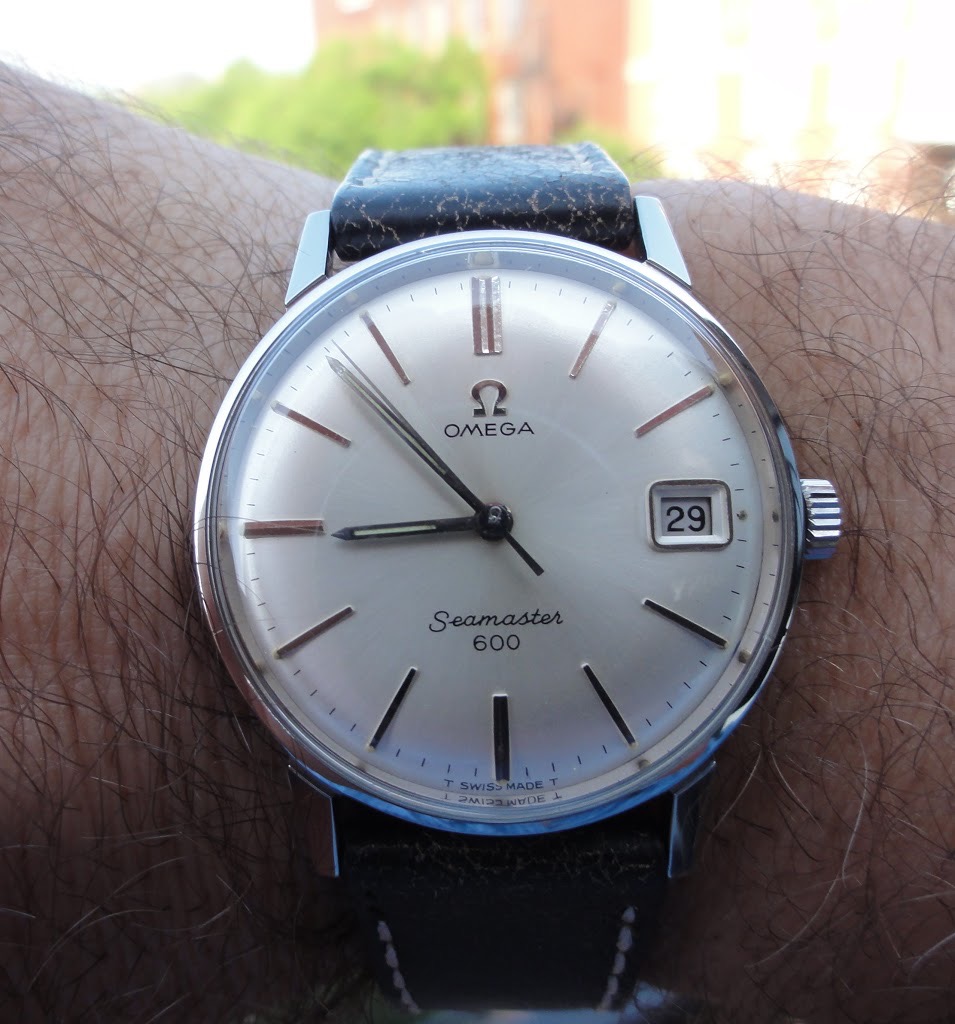

    A better picture in good natural light would help determine dial originality. Here is an original dial for comparison...
