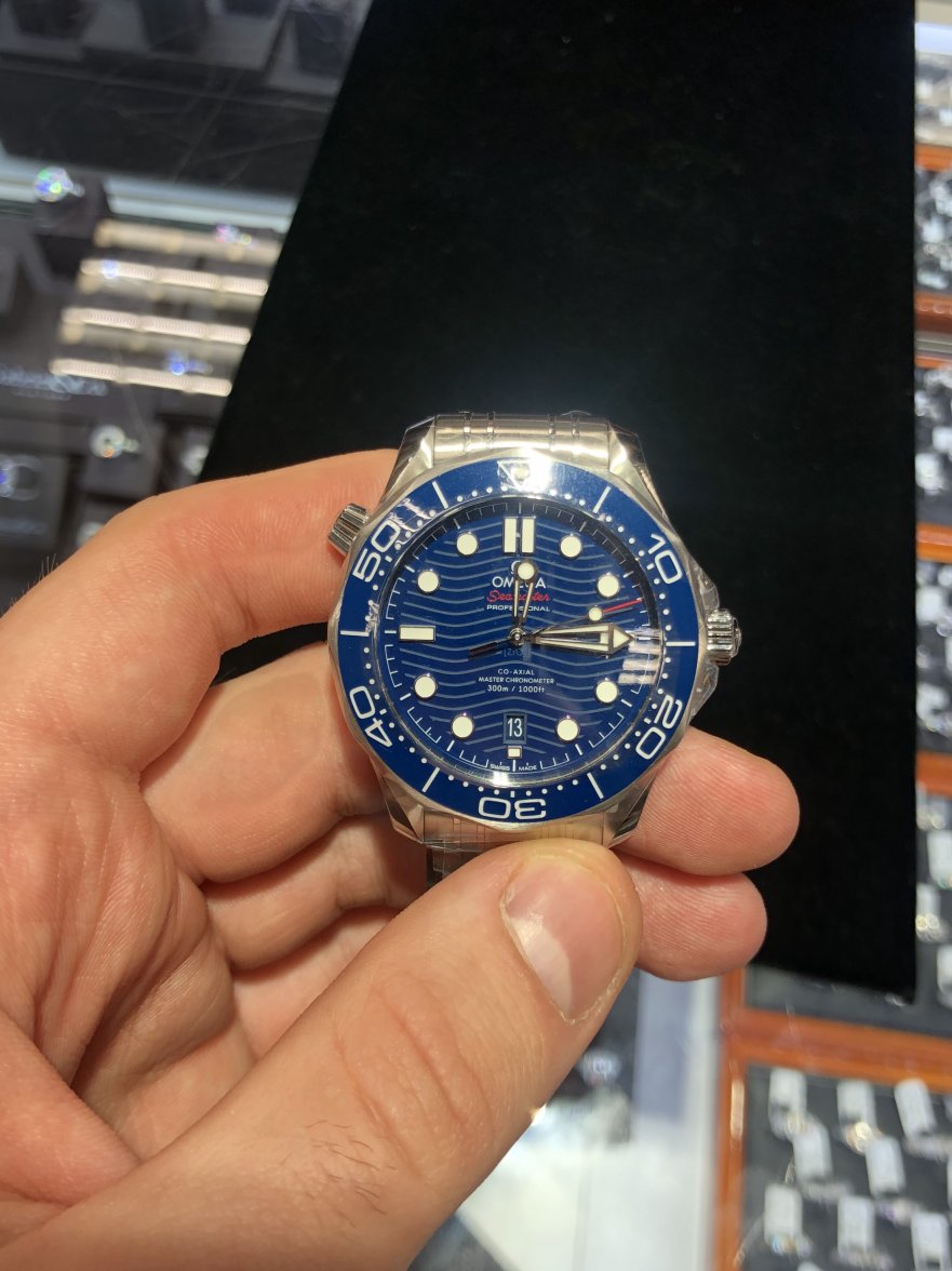

Hi guys,
I just bought a new seamaster and on the first day I got it it was +4. How accurate is it supposed to be? I’ve seen people saying their metas movements lose less than a second a day over many weeks so I’m just concerned. Thanks

+4 is nothing to worry about. My METAS Deep Black is at about +3-4 seconds per day as well. Well within specifications. Keep in mind that a new watch will often take some time to "settle in". A couple of my 8500 series PO's were a touch fast when I first got them and now they're both about +1-1.5 a day. In the grand scheme of things +4 in insanely accurate.

+4 is fine, you can fiddle around with positioning at night and might tighten the rate a bit. But too much effort for me.

+4 is accurate. As mentioned above if you can fine some position that is minus rate and you place your watch in that position your watch will be more accurate. For example my watch has daily worn(random position) rate is +5s/d but I know that my watch in crown up position is -5s/d so I wear it all day and place it in crown up at night so my watch accuracy for 1 month is 0.1s/d very accurate. (Mechanical watch accuracy cannot be found in 1 day.)
