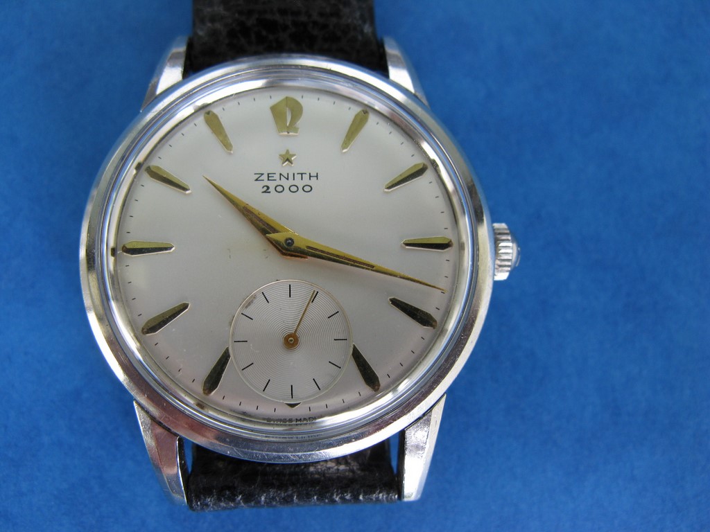

    Hello
    I know that the vintage Zenith with cal 135 is pretty expensive.
    At lest those one that has the chronometer label in the dial , and has the big case , 37mm ex crown I think.
    But what about the Zenith 2000 serie , with 35mm case. That also run the cal 135 chronometer movement.
    What is a fair market value for exempel this one, I guess I pretty big difference ?
    Best regards / M
  2. Tony C. Ωf Jury member Feb 24, 2020
    7,348
    24,044
    The 2000 typically trade for significantly lower prices. More importantly, I believe the dial on the one you show to be a fake, with a crude "2000" added to a dial that was not a chronometer.
  3. CaptainWinsor Feb 24, 2020
    1,826
    3,366
    That dial is totally bogus. Looks like something off a cal 40
    MacRulez4Ever likes this.
  4. MacRulez4Ever Feb 25, 2020
    659
    466
    Ok damn good to know , I got an offer to buy 4 zenith 2000. Maybe the other 3 watches are incorrect to.

  13. CaptainWinsor Feb 25, 2020
    1,826
    3,366
    the first 2 the 2 in 2000 looks to thick and is not in line. The last one looks right but I’d stay away. Here’s one that’s been around the block a few times but no takers.
