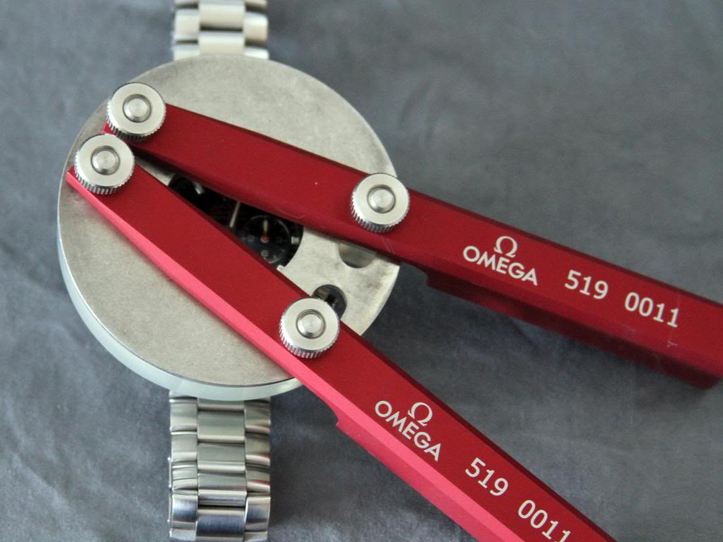

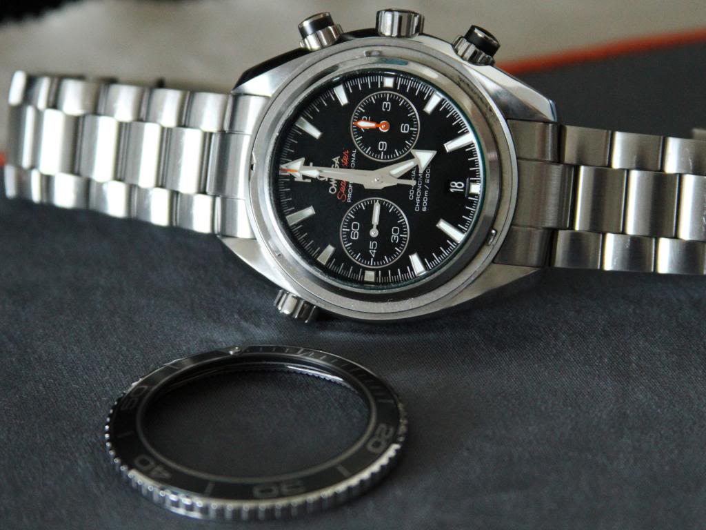

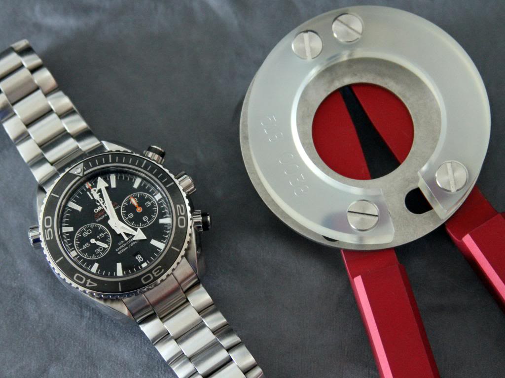

  10. YurRomeo1 Oct 11, 2015
    124
    135
    Here are some pictures of the bezel assembly and how it comes together with the watch... There is a spring underneath the bezel assembly that makes it turn in one direction only so having a little bit of play is OK since the bezel in these models doesn't seal against the watch. Also, don't go prying the bezel off, without the right tools you'll only end up damaging the case :) 1.jpg 2.jpg 3.jpg 4.jpg
