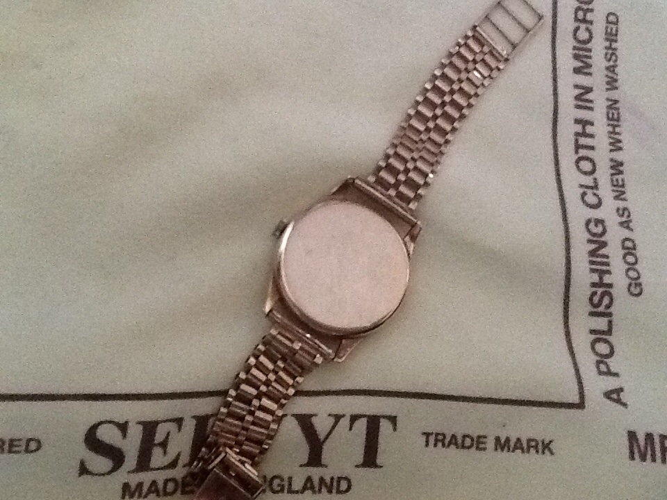

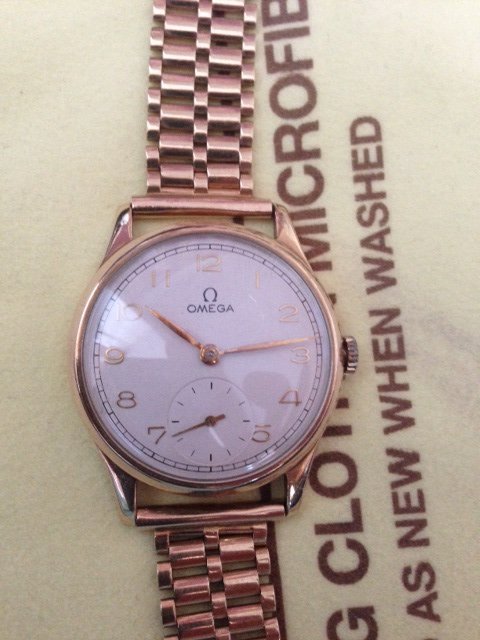

  20. lexusislee Dec 31, 2014
    22
    Hi
    You seem to know a lot lot more then me about watches, can you help me with what omega this is please? I have have it 10 years it's what got me into watches as it was my dads for many years
    Cheers lee
