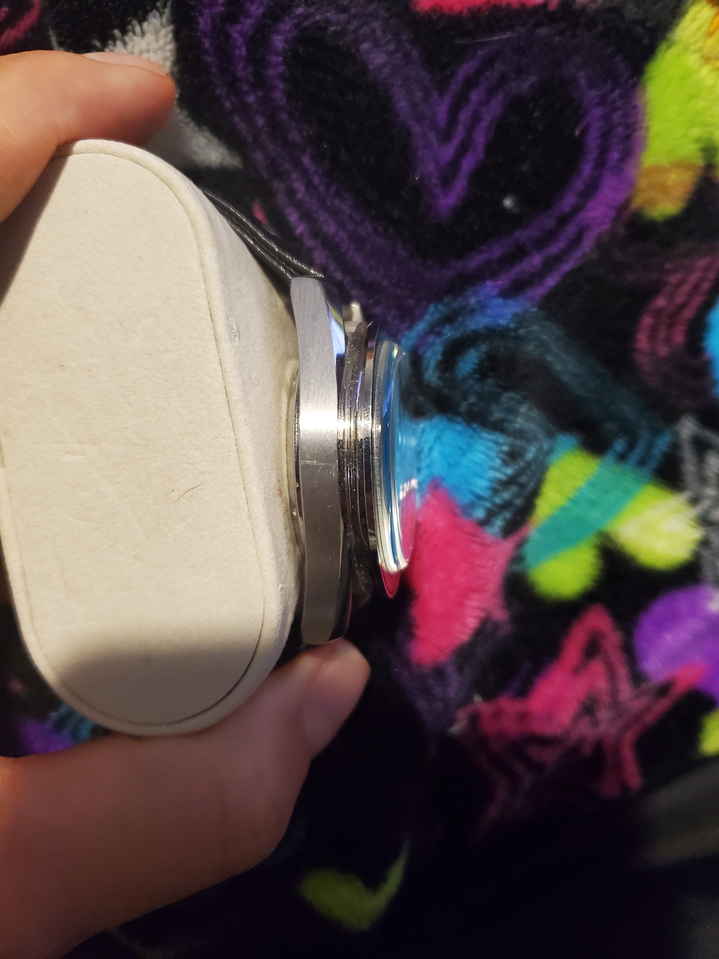

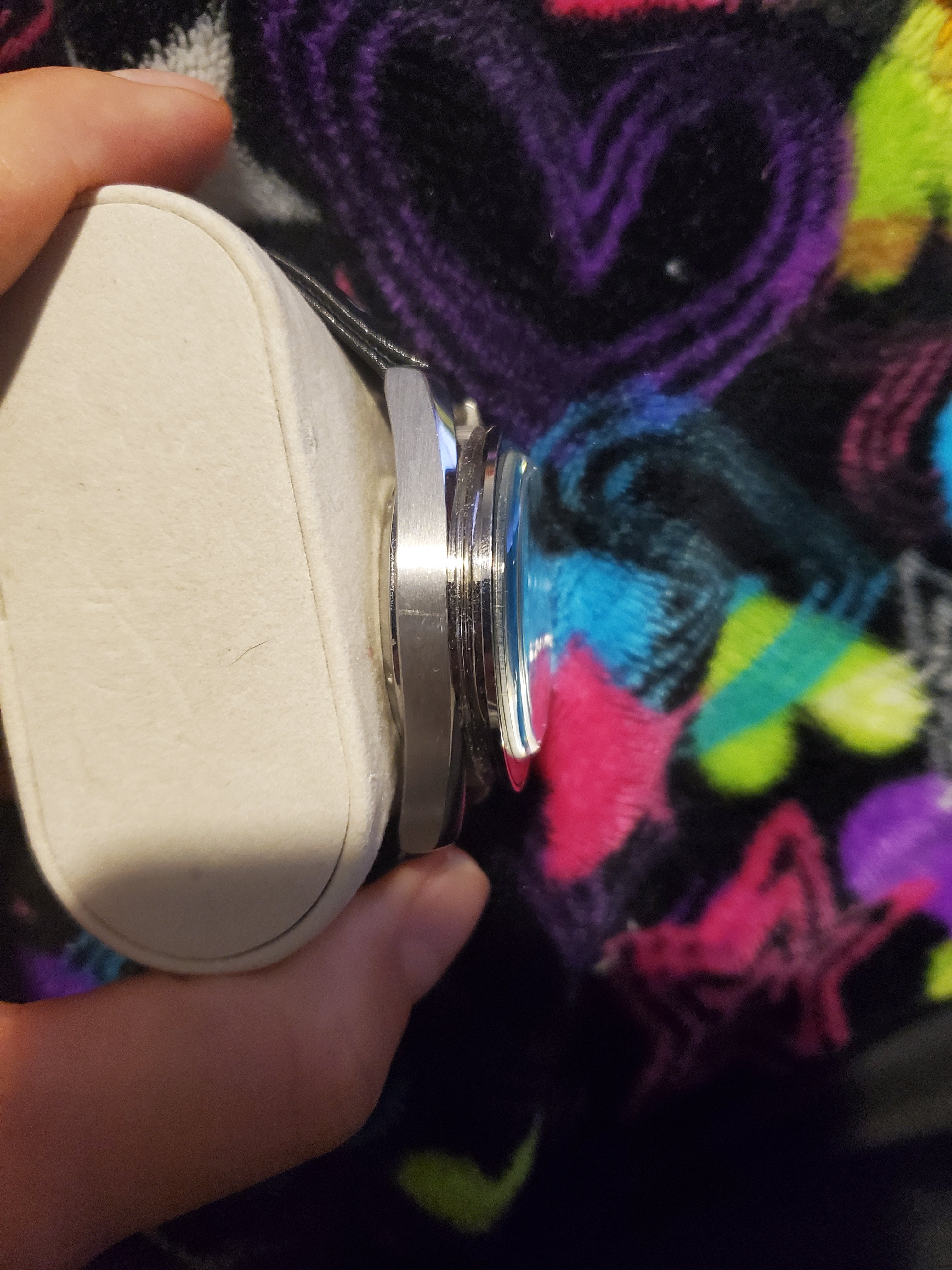

Can you just compress the crystal to pull out the movement?
340
4,198
I tried and that is why I used a dremmel

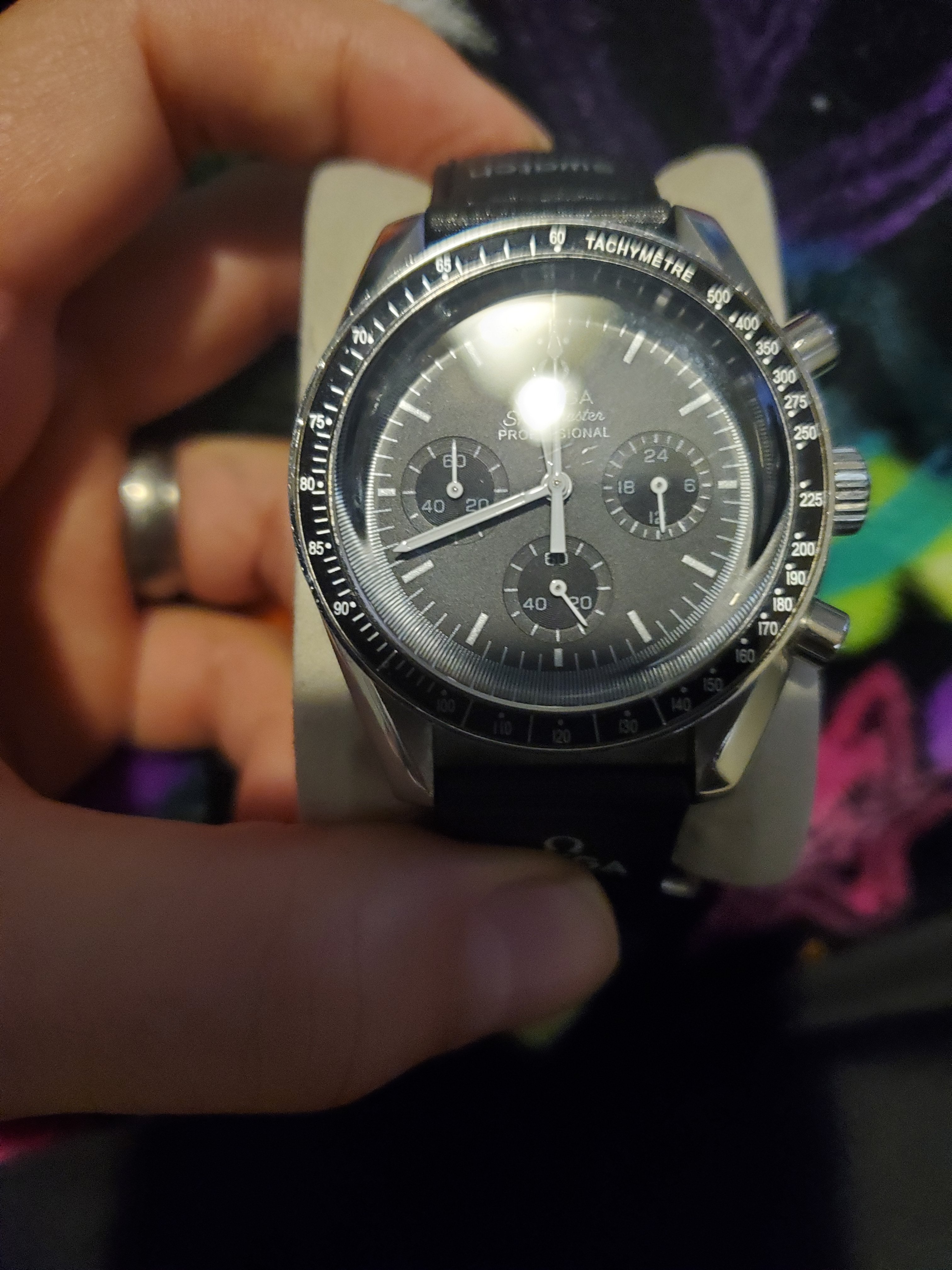

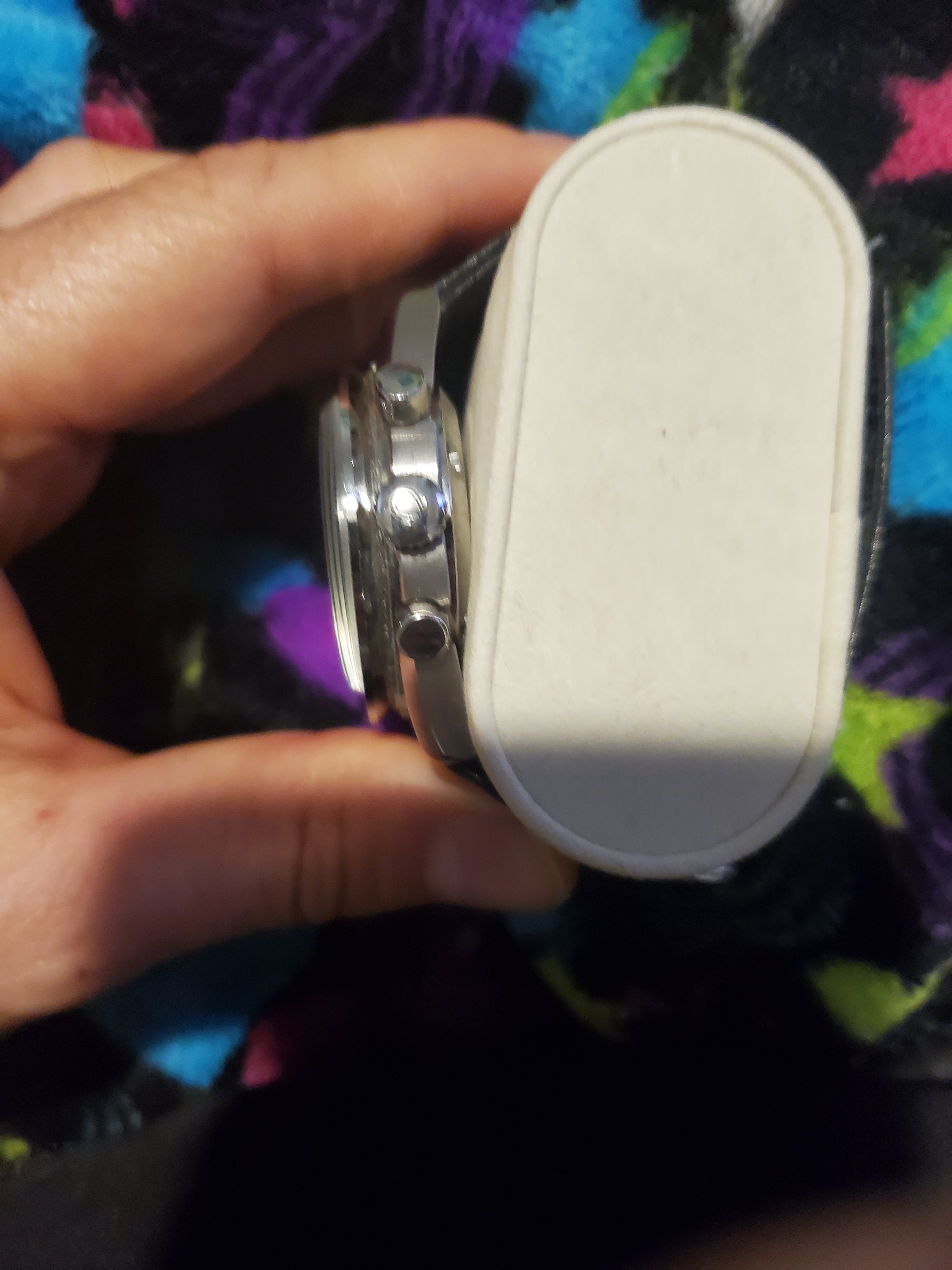

Update: I finally received my watch from ebay and it turns out that it is a speedmaster quartz replica. So I am still going to use it but I am going to have to do a dial swap. Hopefully when I start it will work may have to remove the dial feet and use dial dots. We'll see.......

I don't believe so,haven't really thought about it. This is the watch from ebay i will start breaking it down tonight

Well after taking this one apart the Swatch dial won't fit because the spacing between the subdials is different, back to the drawing board...
