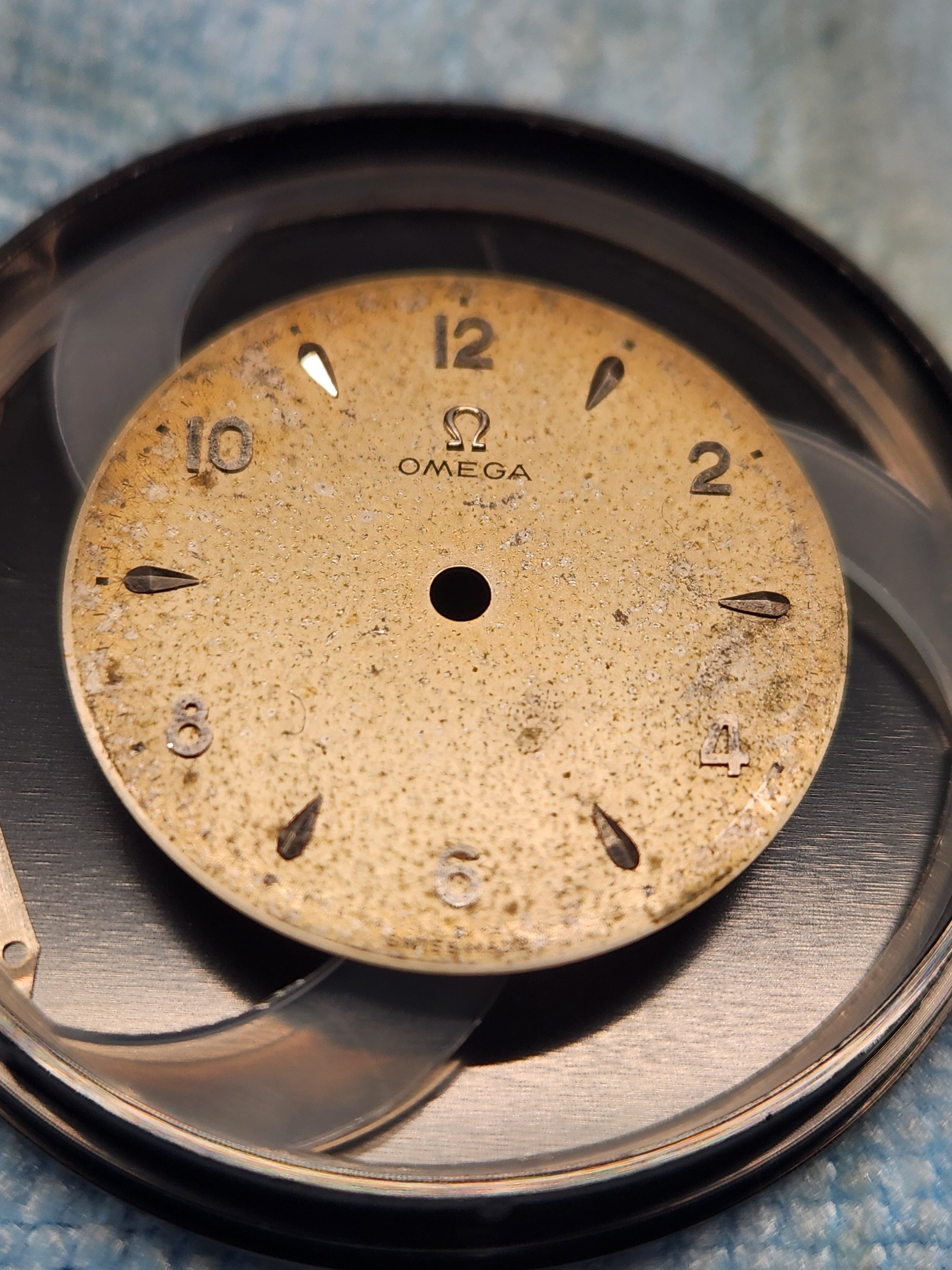

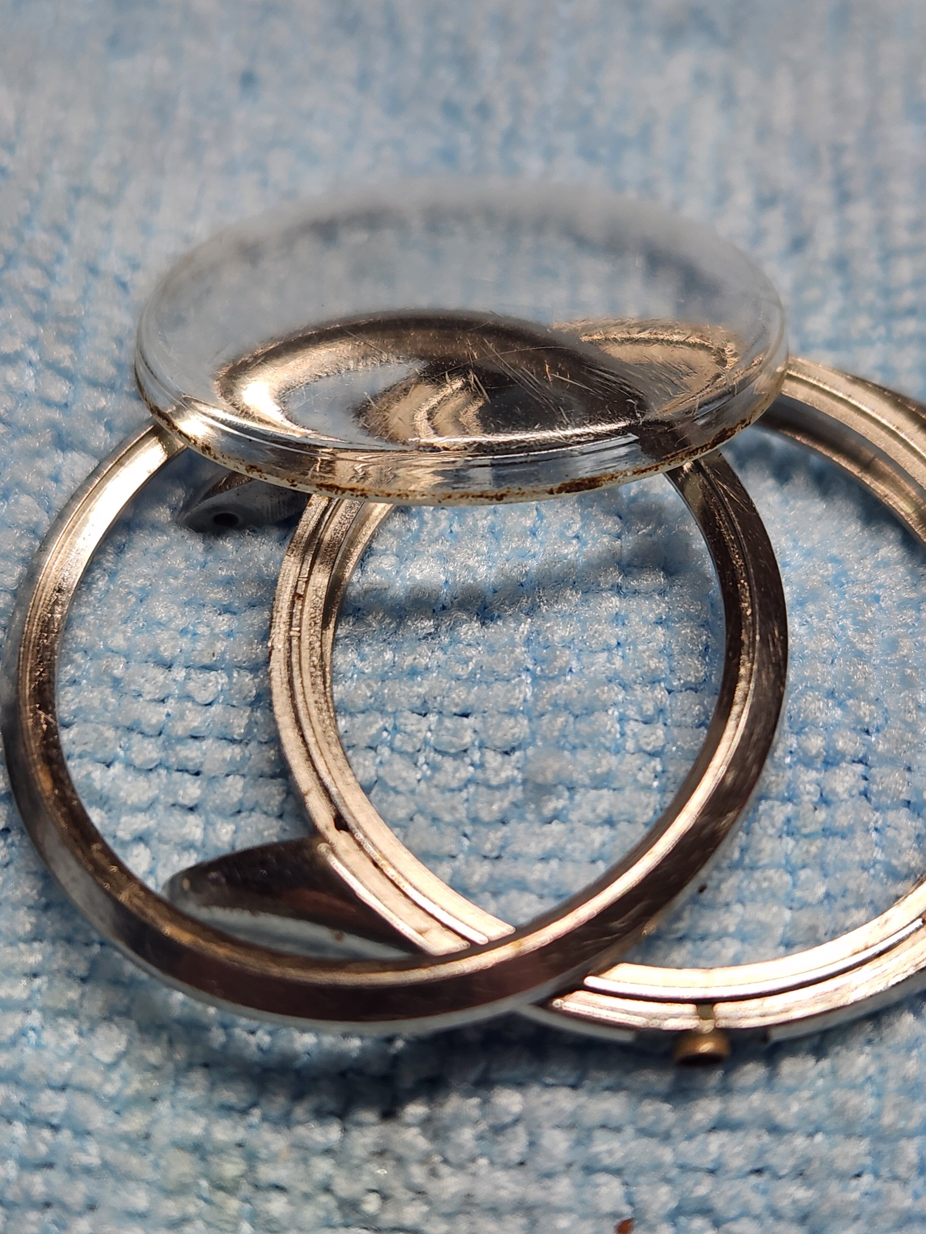

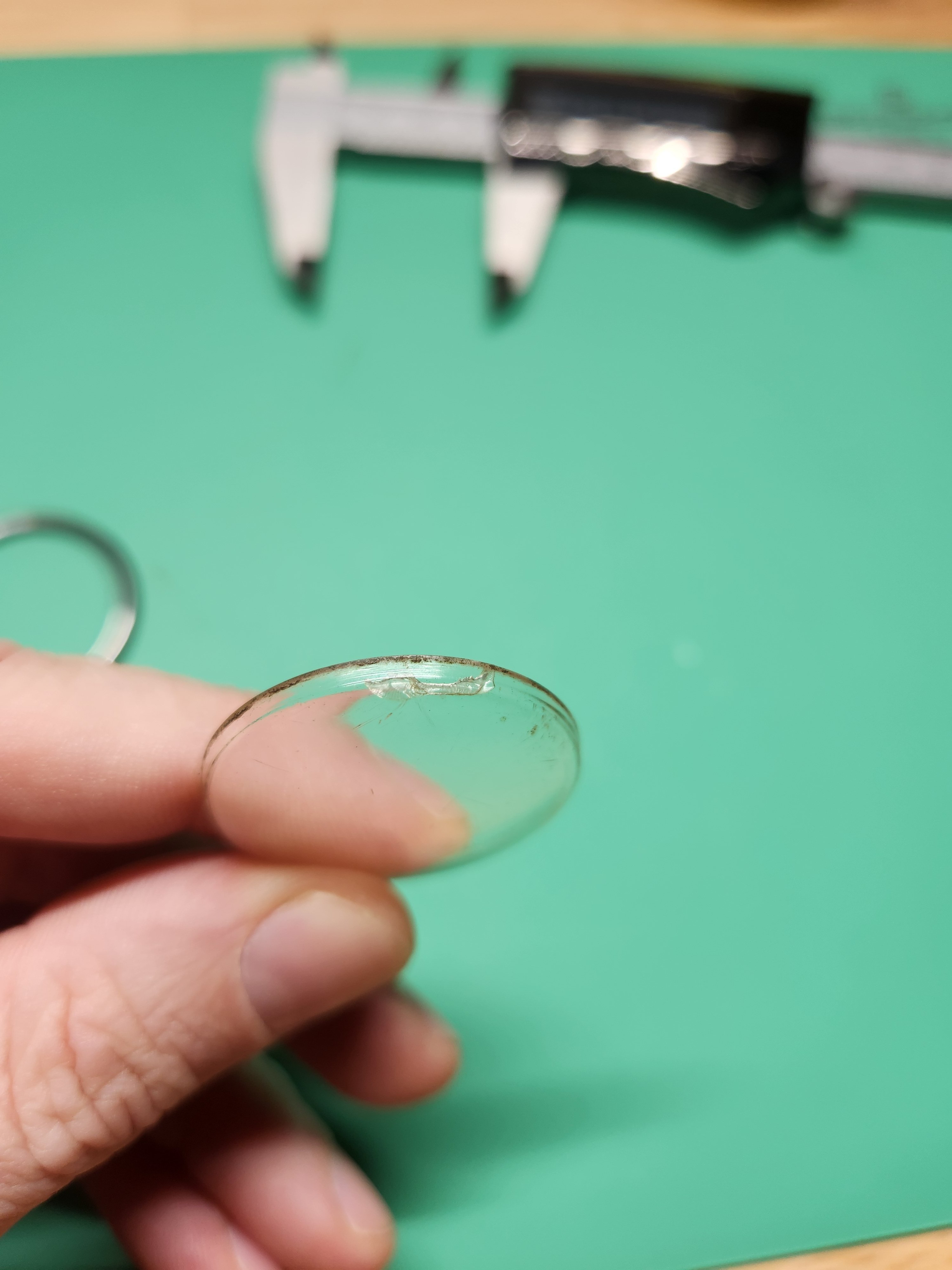

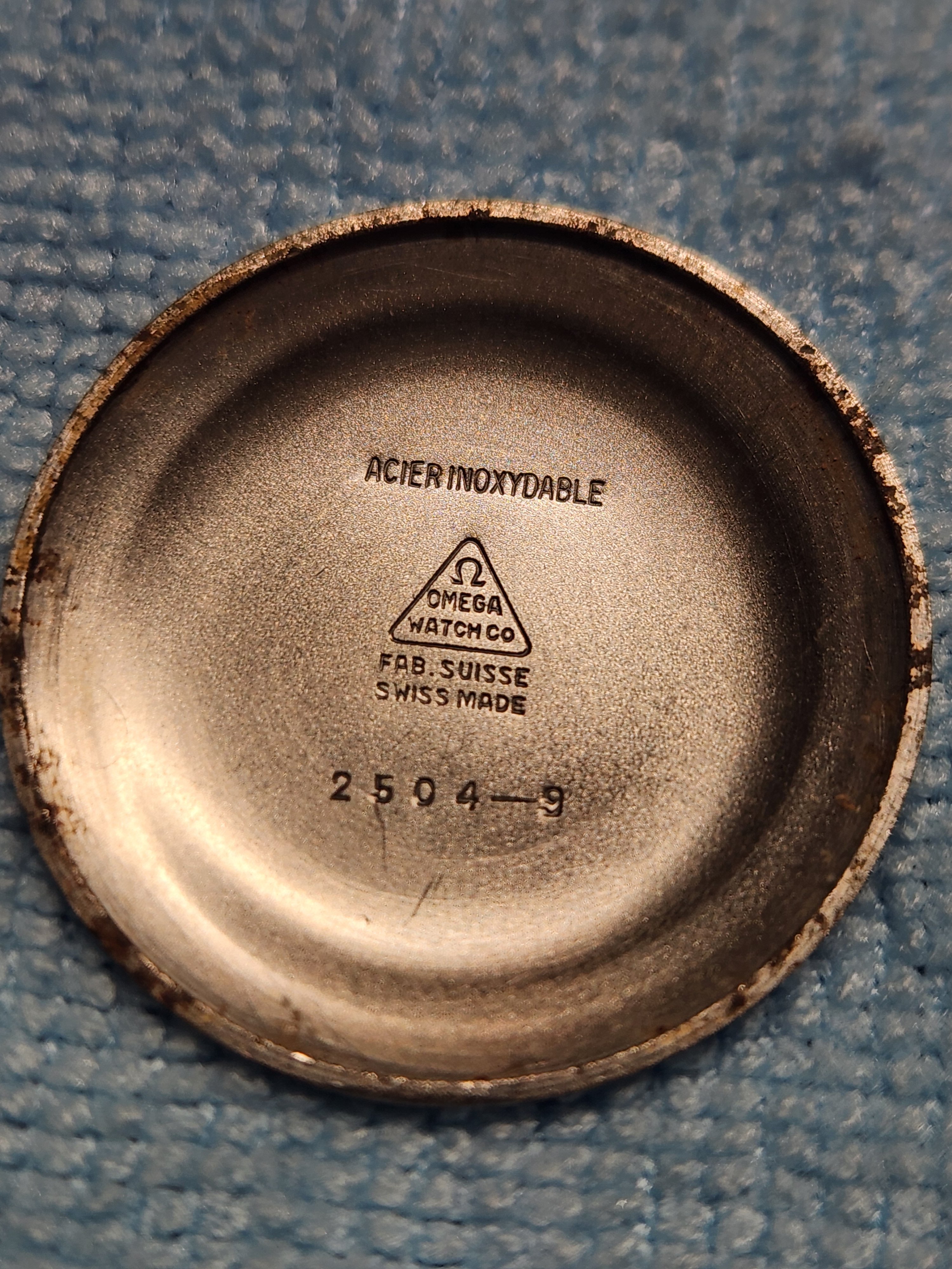

I have a 1950s Omega cal 283 with case number 2504-9. I would just like this beautiful dial to see the light of day. I dont believe the crystal pictured is original, just hoping to find the best option for this case

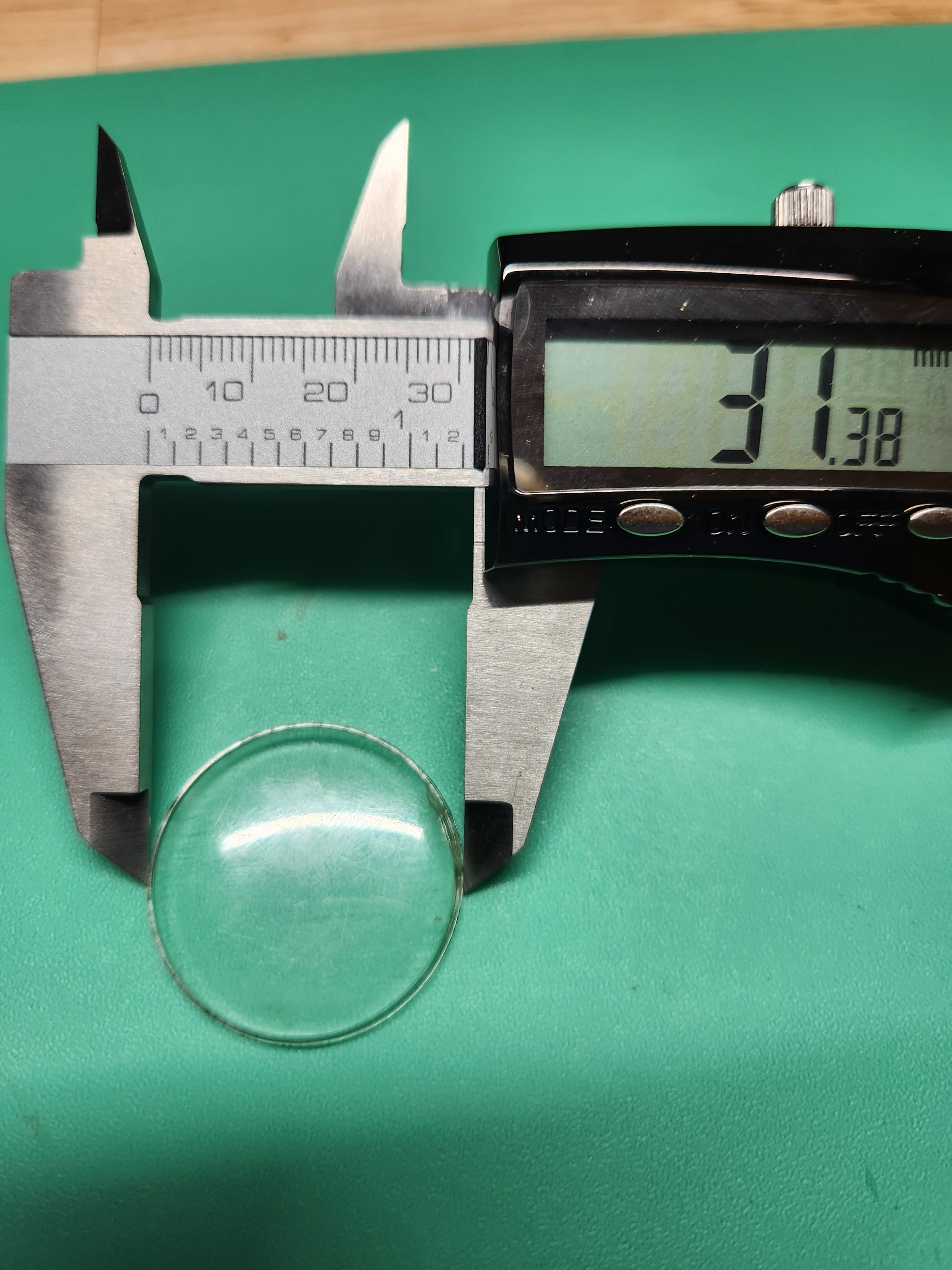

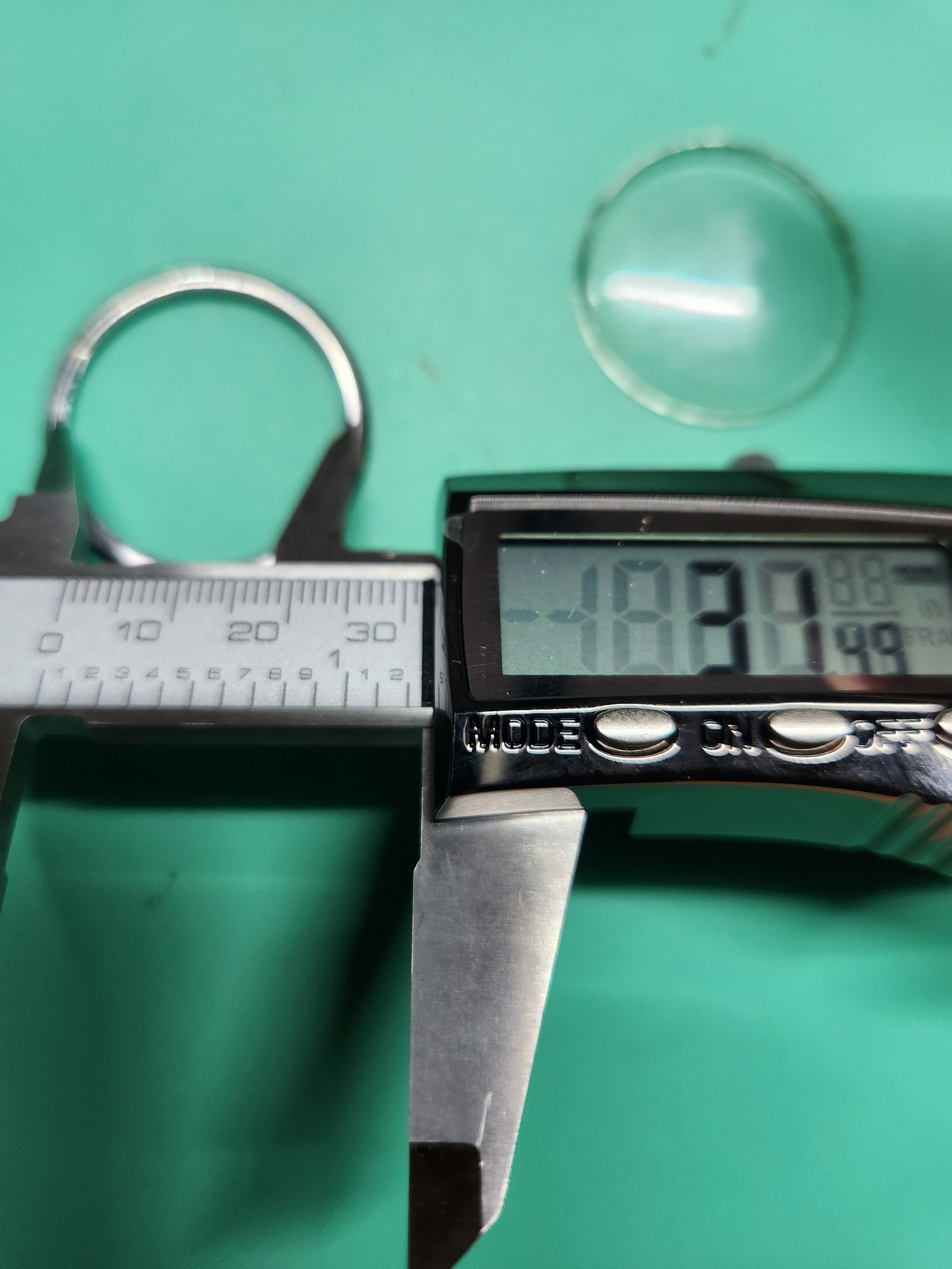

31.47mm wide
4.23mm tall
Thank you in advance!

Original part is PN1055. There's no tension ring. You should find a equivalent such as a
ST Sternkreuz 31.5x29.9 or a little larger
check the dial opening to see id 29,9 fits.

the size you gave is the size of the crystal or opening of the case?

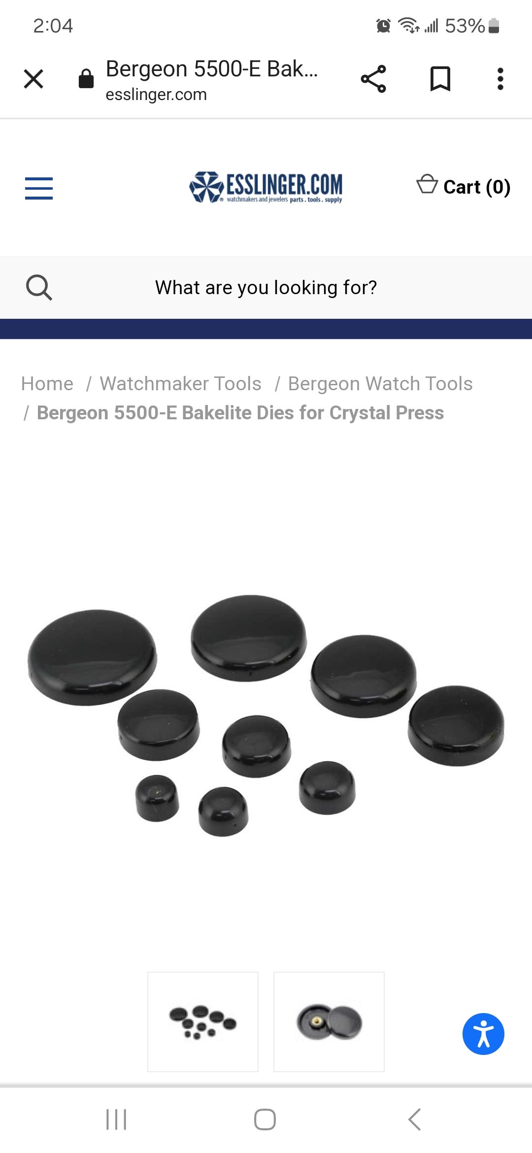

Thank you for the write up and taking the time Archer. Having the bergeon 5500e lower dies and the correct upper die would be enough to compress the outside edges enough to fit the crystal.
Im just getting started into hobby watchmaking and really appreciate the help in the journey
30,290
78,193
Ah yes - those are the same style that are used on top of the crystal cabinet I have. That will work - not the dies originally shown in your first photo.
Excellent. Thank you again for the help!
