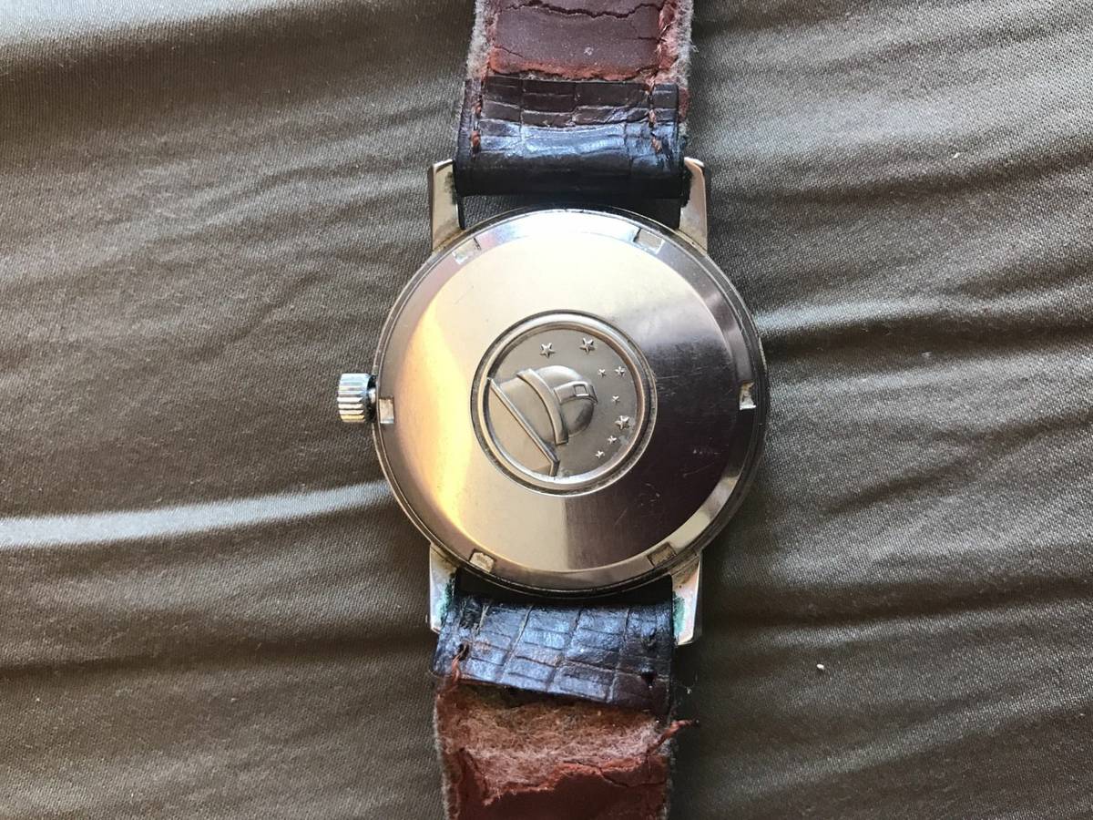

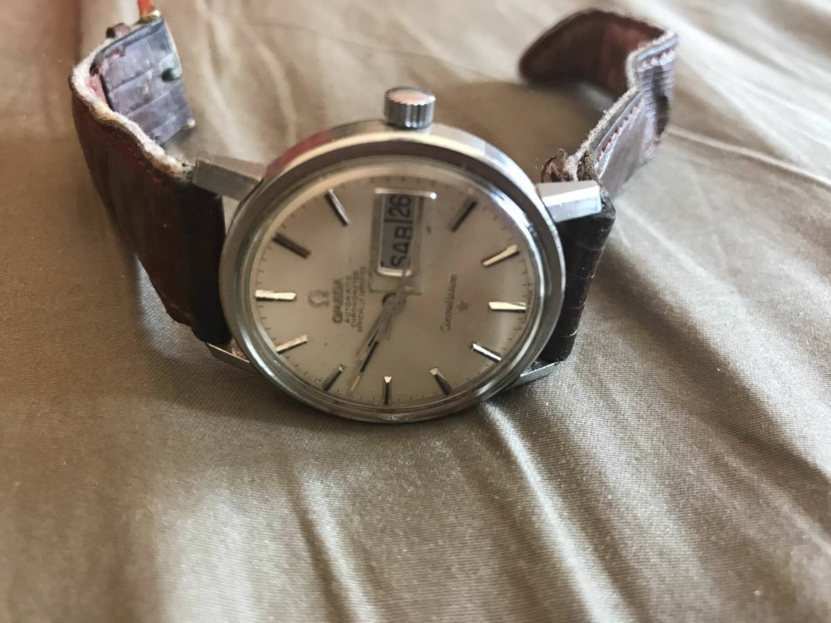

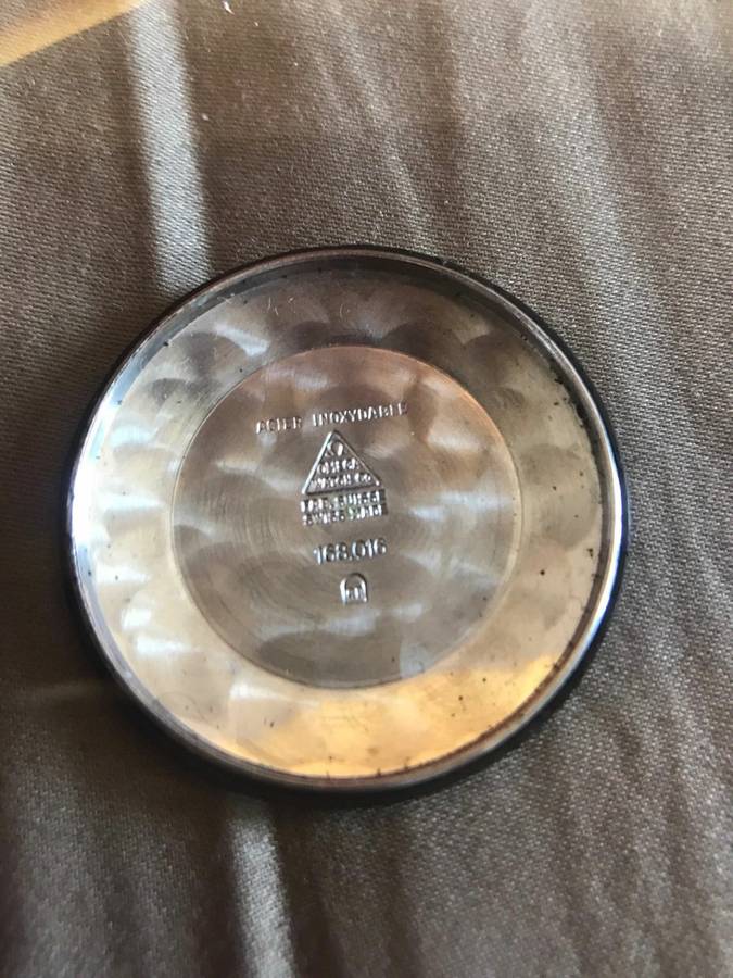

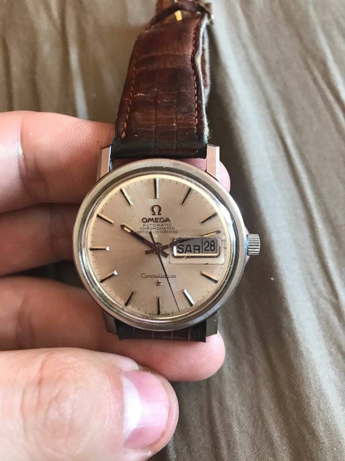

    I typically just wear a basic Tissot manual (1965) or my daily SKX009 (but I am repairing a nifty 1972 Seiko 6139 blue dial Chrono)...anyway I am considering another Omega and found what seems to be a mid-late 60's Constellation and wanted the groups opinion on it.
    I have read through the stickys and also the thread about spotting a fake that I should NEVER ask questions in and have concerns.
    The watch I am considering has a 751 with the day & date, I understand this is not as popular as the date only models.
    I think the hands may be wrong, they have lume, but the dial does not, but the dial does have a "T". And I cant tell if the back is correct for this era (no bricks). Also, the movement looks like it has some issue with the weight, like a tar substance? Is the movement correct otherwise? The seller states it was serviced 6 months ago but it looks kinda dirty to me? I am thinking the crown should have the logo, if I interview it I would like to know if it should be signed. It's offered at under $400 and I am tempted, but I thought I would get a few votes from this knowledge trust.

    29
    64
    I am a newbie so you'll want to wait for the experts, but, to my untrained eyes, the dial does appear to have lume at at least some of the hour markers. The hands and dial look correct to me, and the case looks pretty sharp. The crown does appear to be a replacement. Again, I'm a newbie so I'm sure people with more expertise will be able to tell you more about it and the value.

  3. 77deluxe Jan 18, 2018
    2,058
    4,613
    Looks decent to me. Replacement crown, but case and dial look ok. Better pics would help.
  4. Foo2rama Keeps his worms in a ball instead of a can. Jan 18, 2018
    17,087
    25,329
    I see no issues save the crown.
    Needs a service and check the movement vs the caseback to be sure.
  5. doog Jan 19, 2018
    94
    59
    Other than needing a bit of TLC, looks like a decent buy for under $400 to me. Two concerns though. How much of the black gloop (probably the old case back seal) has crept into the movement, and is that a crack on the left hand arm of the rotor, or just more gloop? Not keen on the cyclops on the crystal, but that can always be changed. Factor in $400 for a service and a decent new strap and it still looks an attractive deal.

  6. Peemacgee Purrrr-veyor of luxury cat box loungers Jan 19, 2018
    5,148
    7,863
    Nice Connie.
    +1 for all of the above.
    Rotor rubbing on movt so needs a service. Get a new crown at the same time.
    Day not in English if that’s ok with you.
    Bit of a steal for under $400

  7. albertob Jan 19, 2018
    836
    2,446
    Seems ok
  8. Caliber561 Jan 19, 2018
    1,474
    2,512
    Seems like a good deal if you can get it under 400. Like others have said, it really just needs a new crown and a service/clean up.
