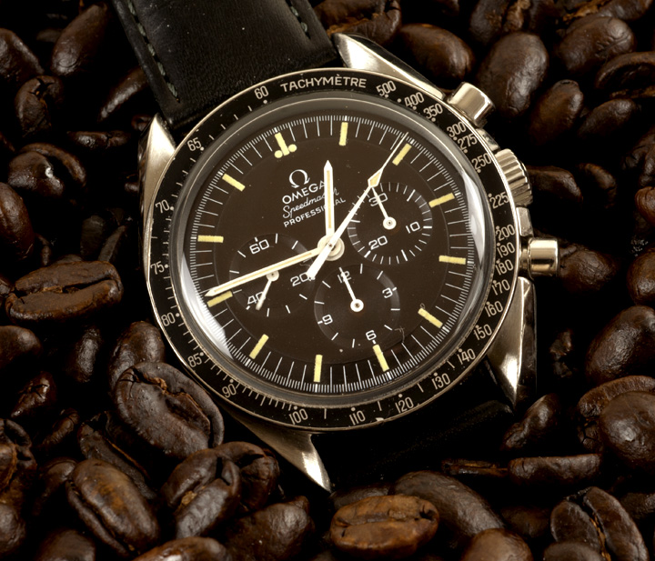

    You have a beautiful watch. You do need someone to look at it and probably service it. It'll run you ~$600 for the service. Where are you located? There are a number of options for where you have it serviced, but you need to be careful. Watchmakers like to make the watch like new when they service it and will replace vintage parts with current ones and you want to avoid that if possible. I guess we all have our favorite watchmaker. I use one who is local and it's great to be able to drive there and not have to deal the the hassle of shipping.
