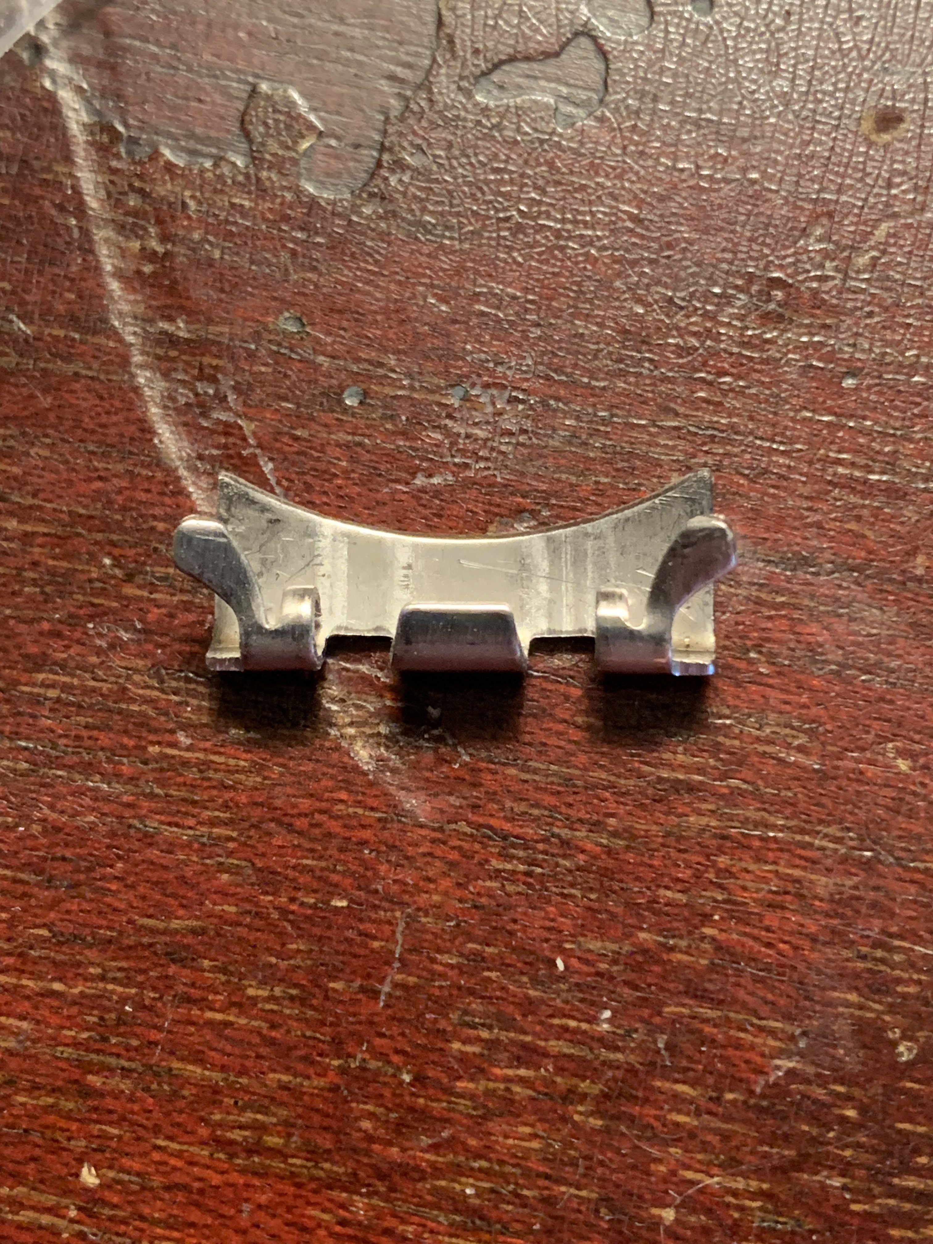

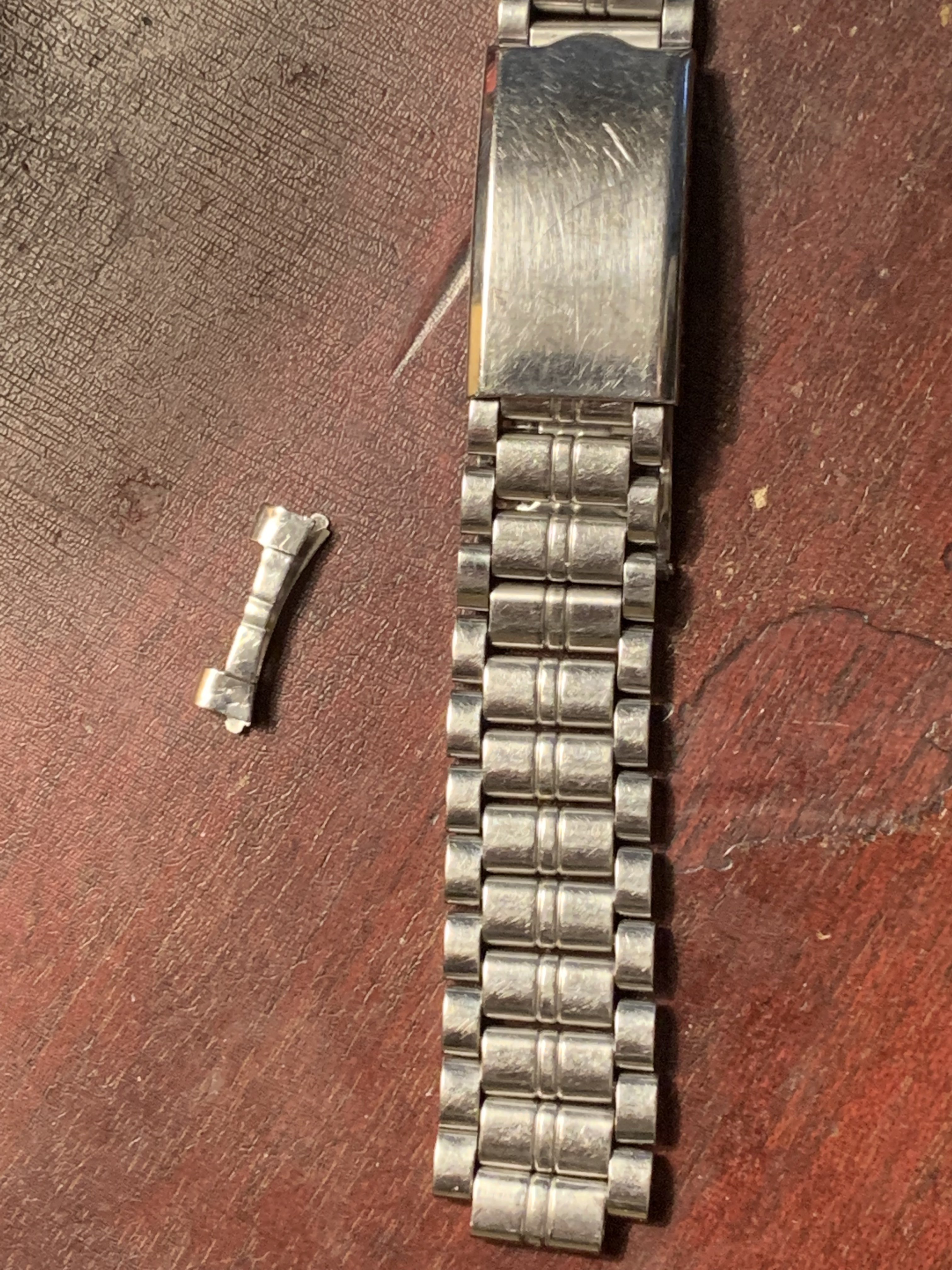

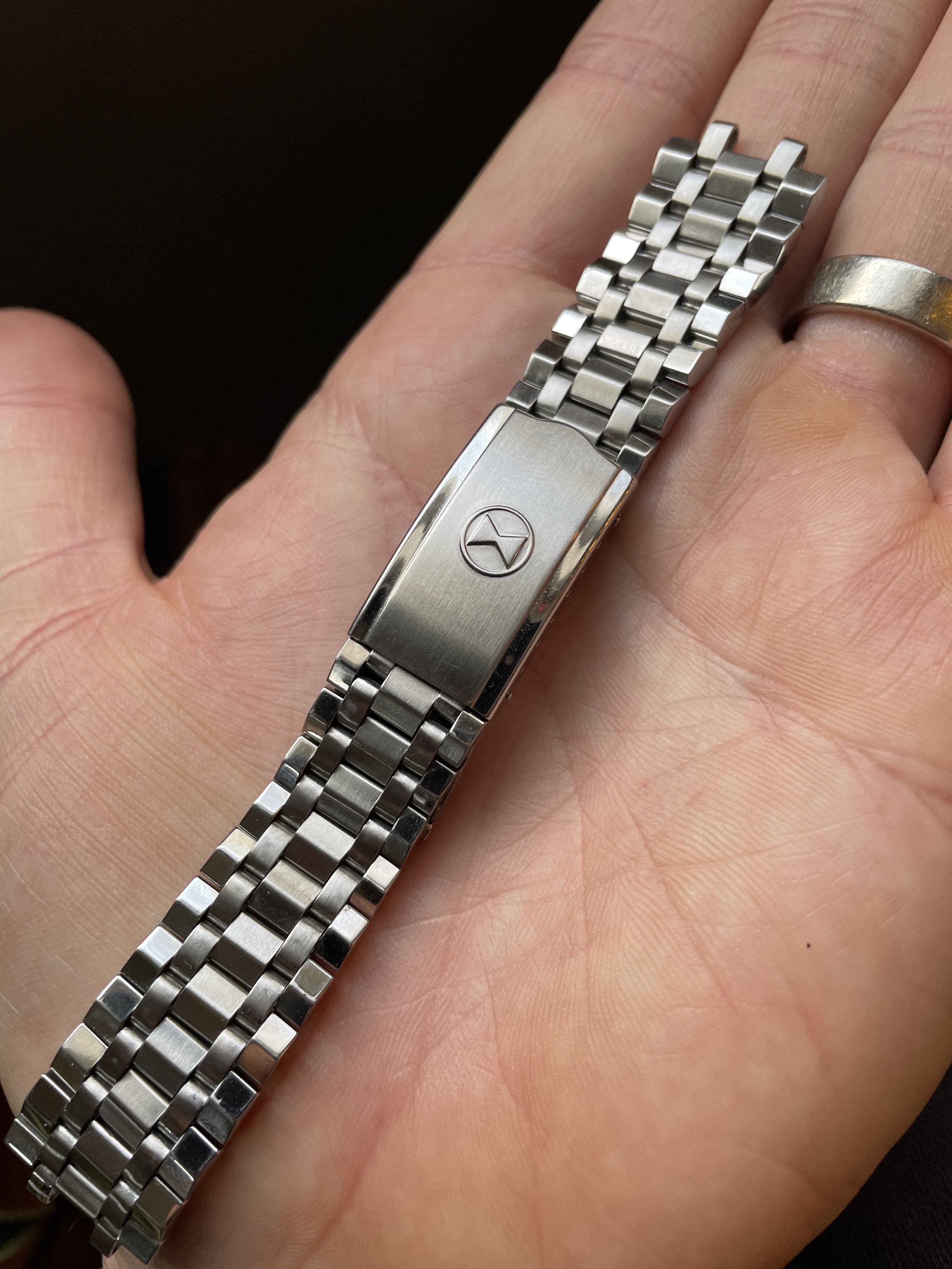

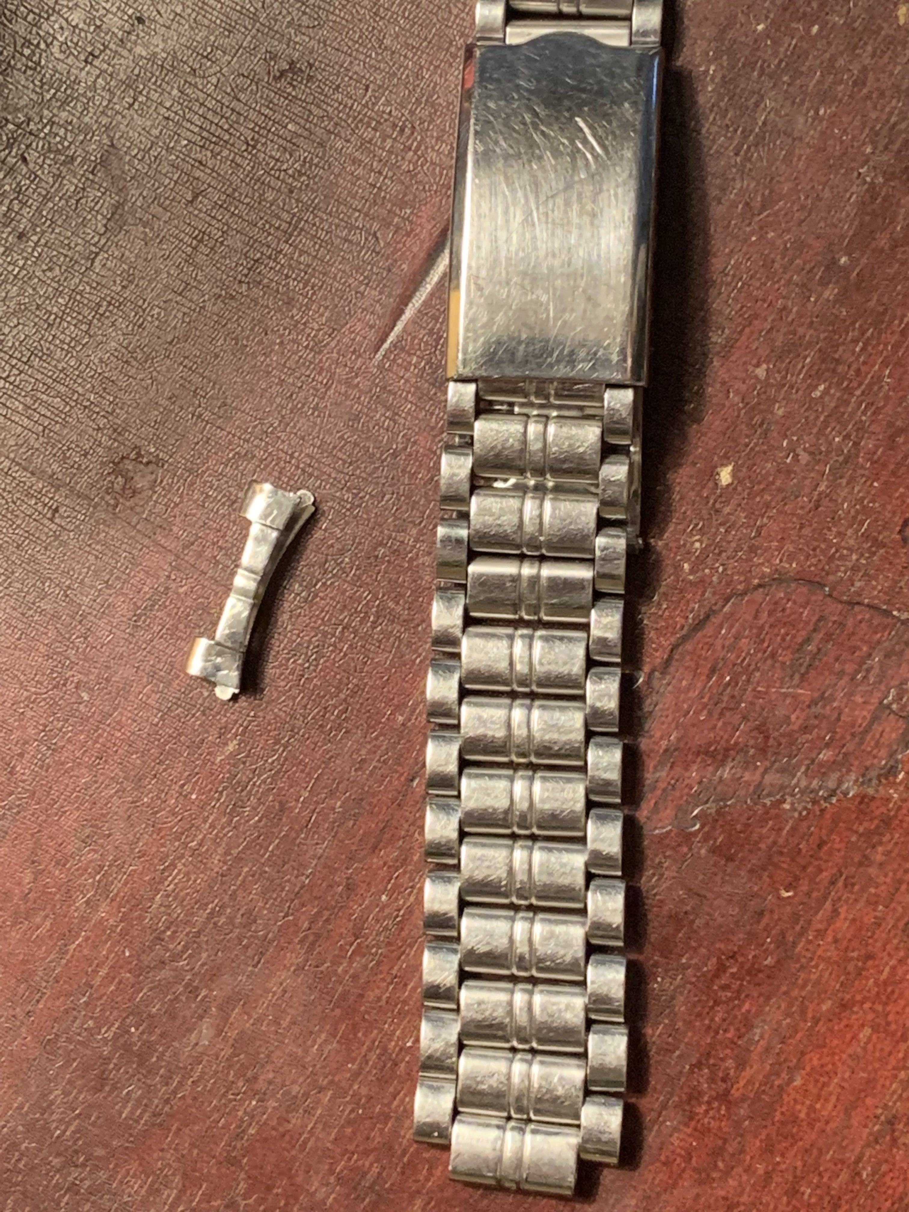

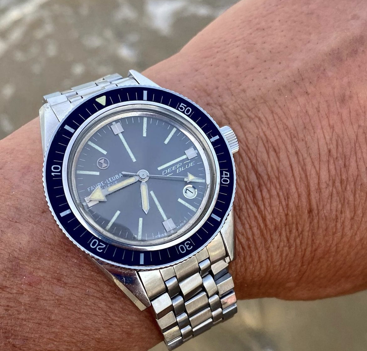

I have a Favre-Leuba bracelet here that doesn’t have the original 19mm end links. Finding these will be a crapshoot, but I’m trying. In the meantime I’m looking for an aftermarket set that will get me by until originals are sourced.

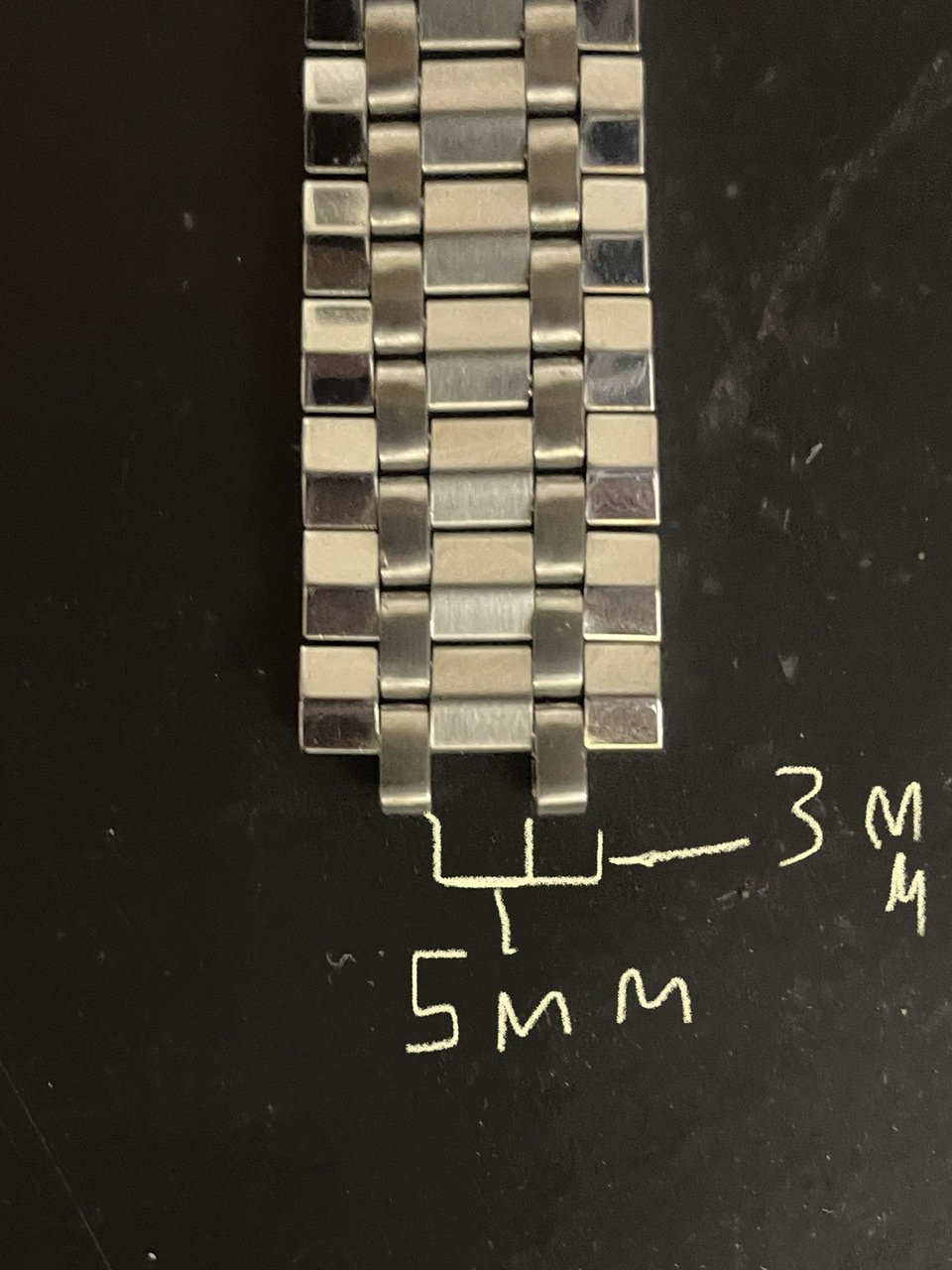

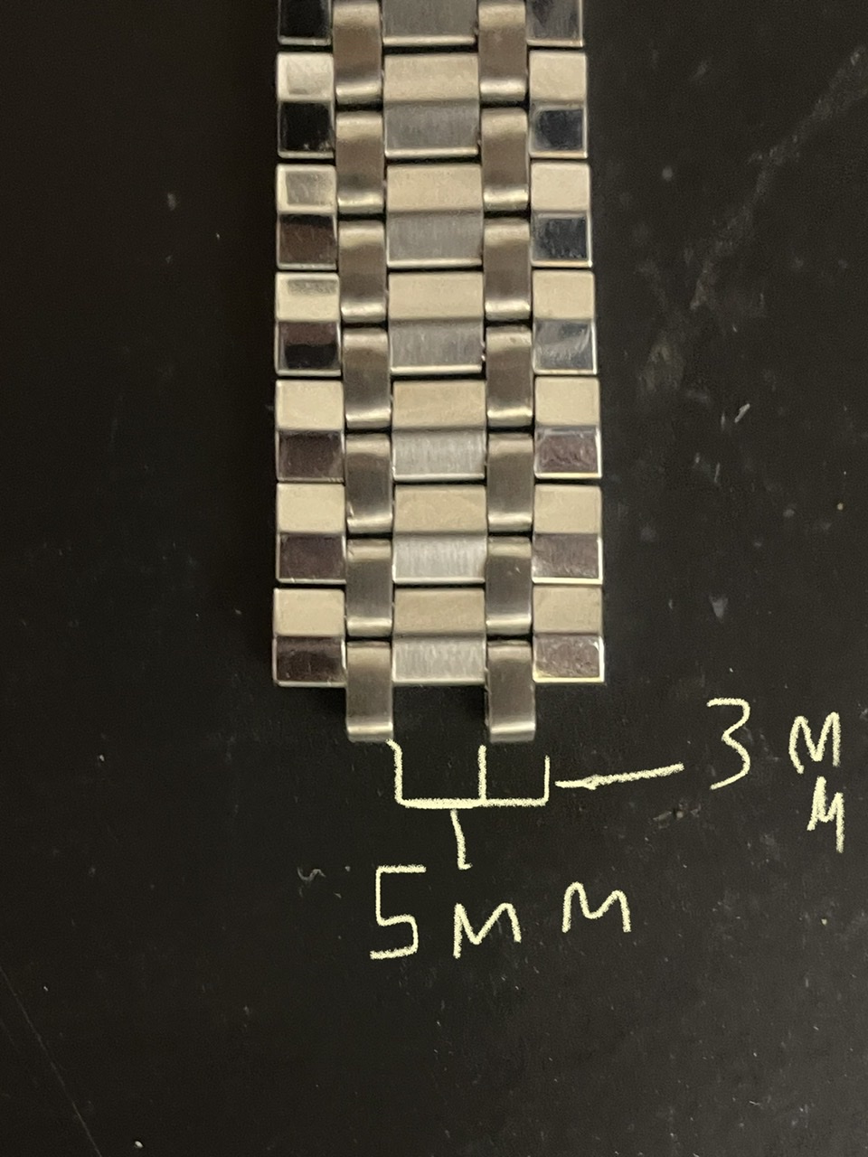

Some key measurements that I have taken is the spacing between the spring bar links and then the width of them. I know that side profile of the end links should match the lug profile of the watch as well. Any help would be be appreciated.

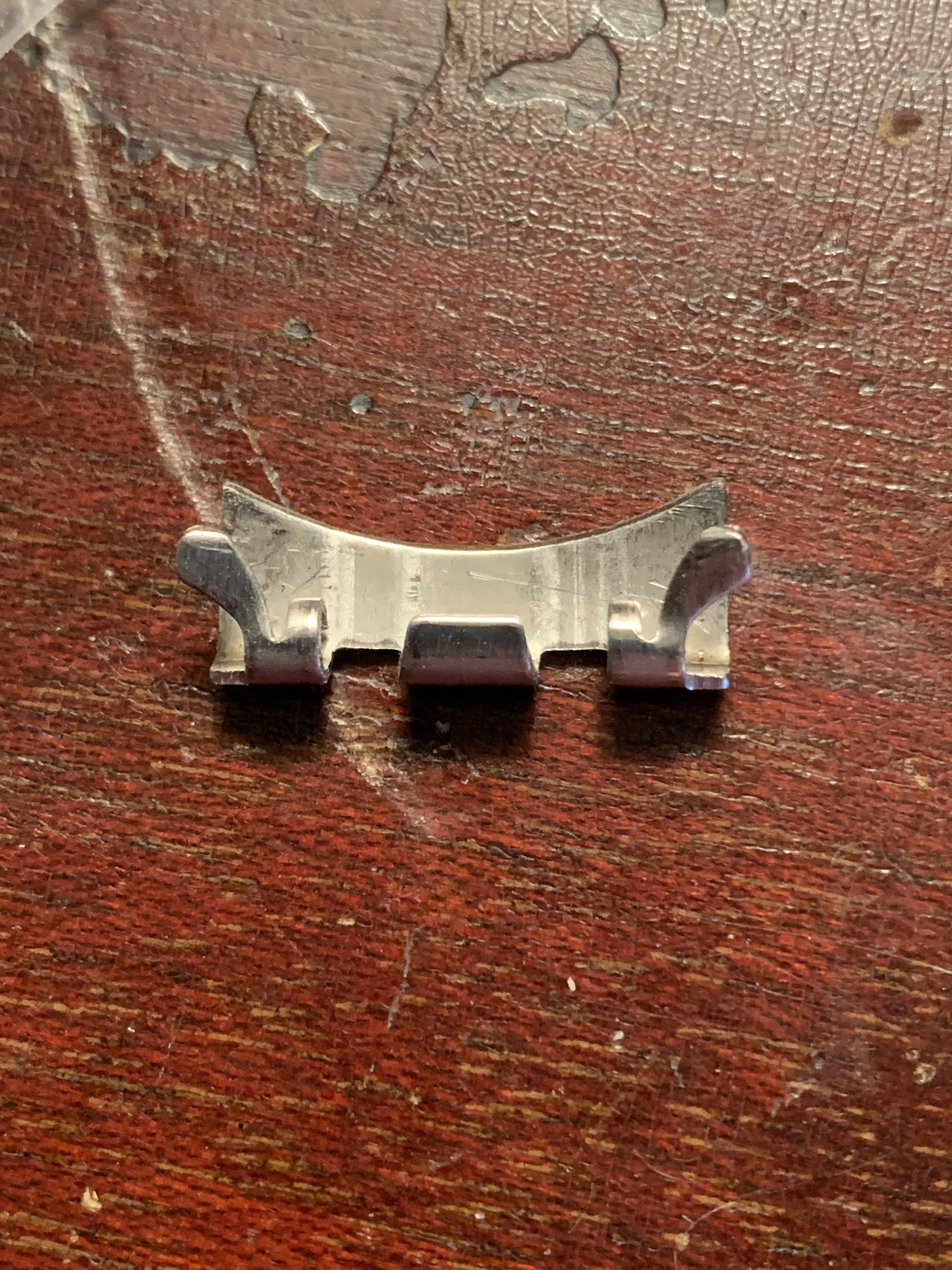

Here is the bracelet (it’s for a first execution Favre-Leuba Ref 59603 “Deep Blue”) the end links I currently have force these two inner band links outward as they are about 0.5mm too wide for the openings in the endlinks. This causes a bit of binding and too tight a fit.

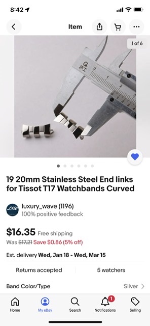

Example:

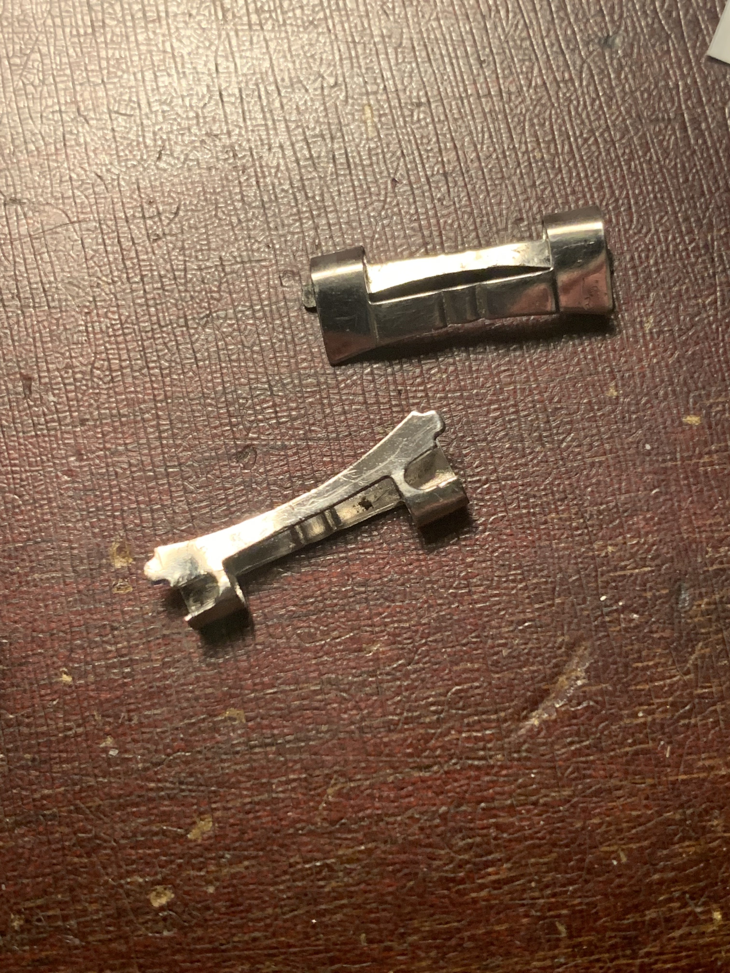

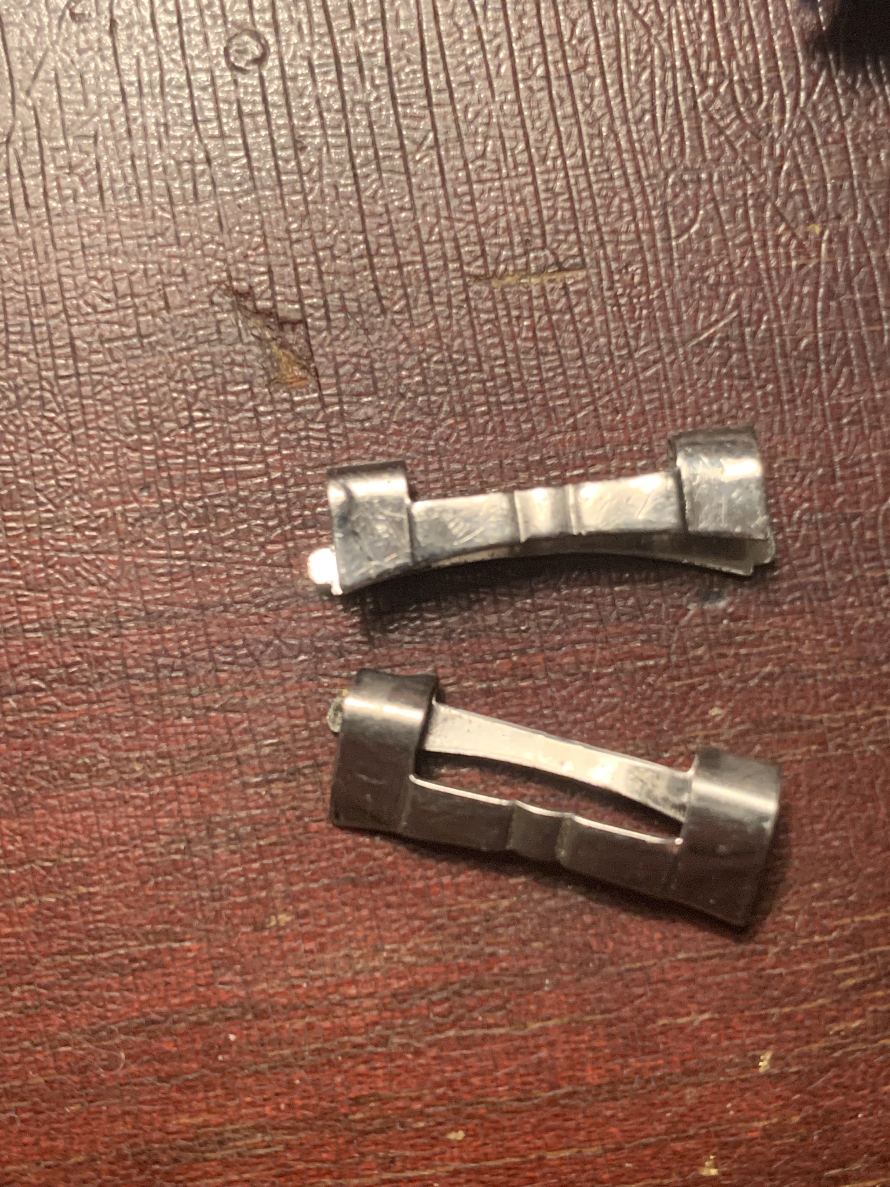

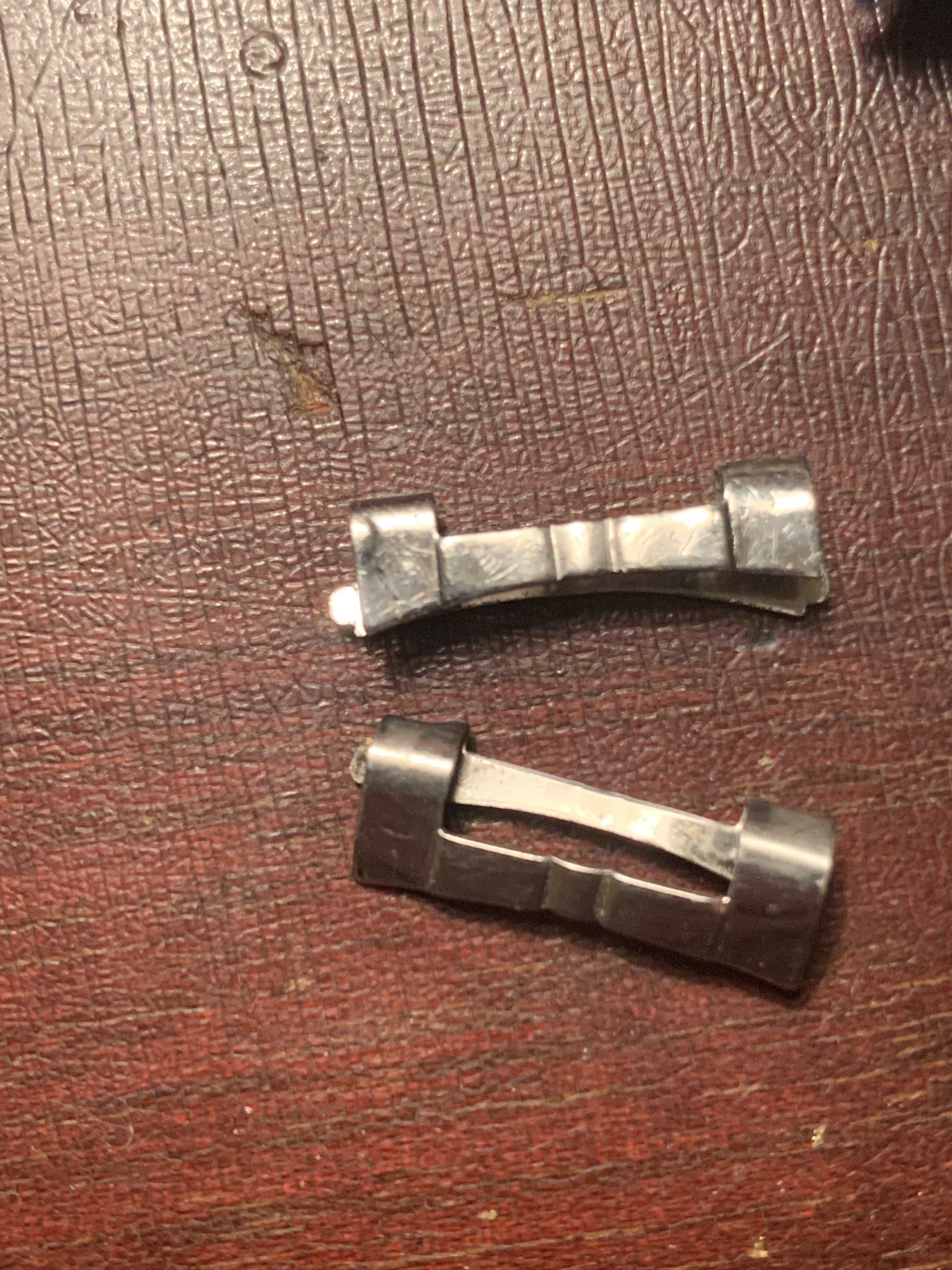

You previously pictured a pair that, if I remember correctly, you said were too tight? A lot can be done with metal, and since they were a close approximation already, you might look into finding a talented laser welder and metal finisher to make them fit as you need.

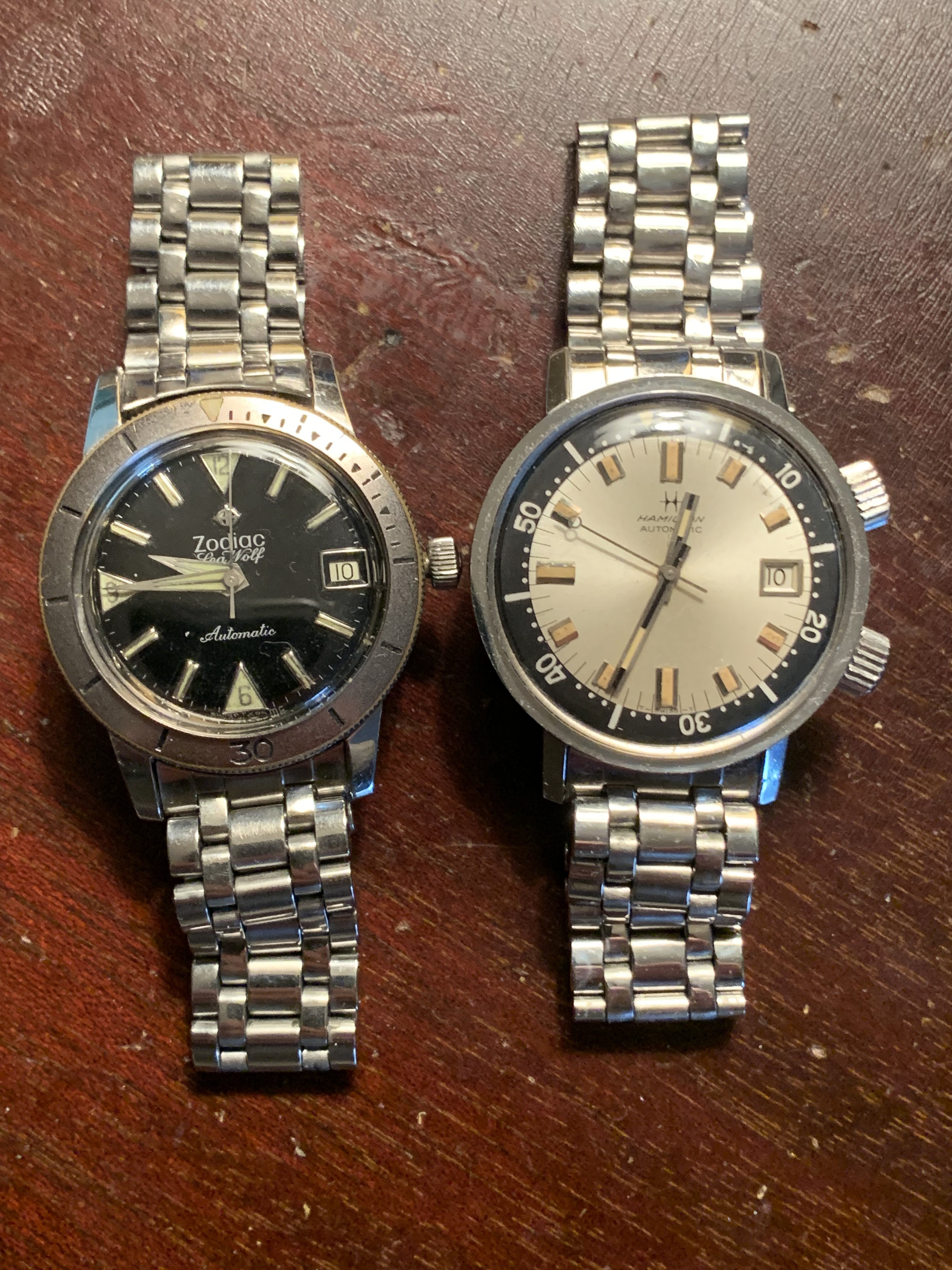

Agreed. The Uncle Seiko Holzer is very similar to this and he sells just the endlinks if you only want those. If the spacing is similar, they may be able to be customized
460
1,107
I actually emailed the Uncle before making this thread. I wonder if what I currently have are Holzer endlinks, they look very similar. We’ll see what he says.

File the openings in the current endlinks a tiny bit, which is a very standard approach.

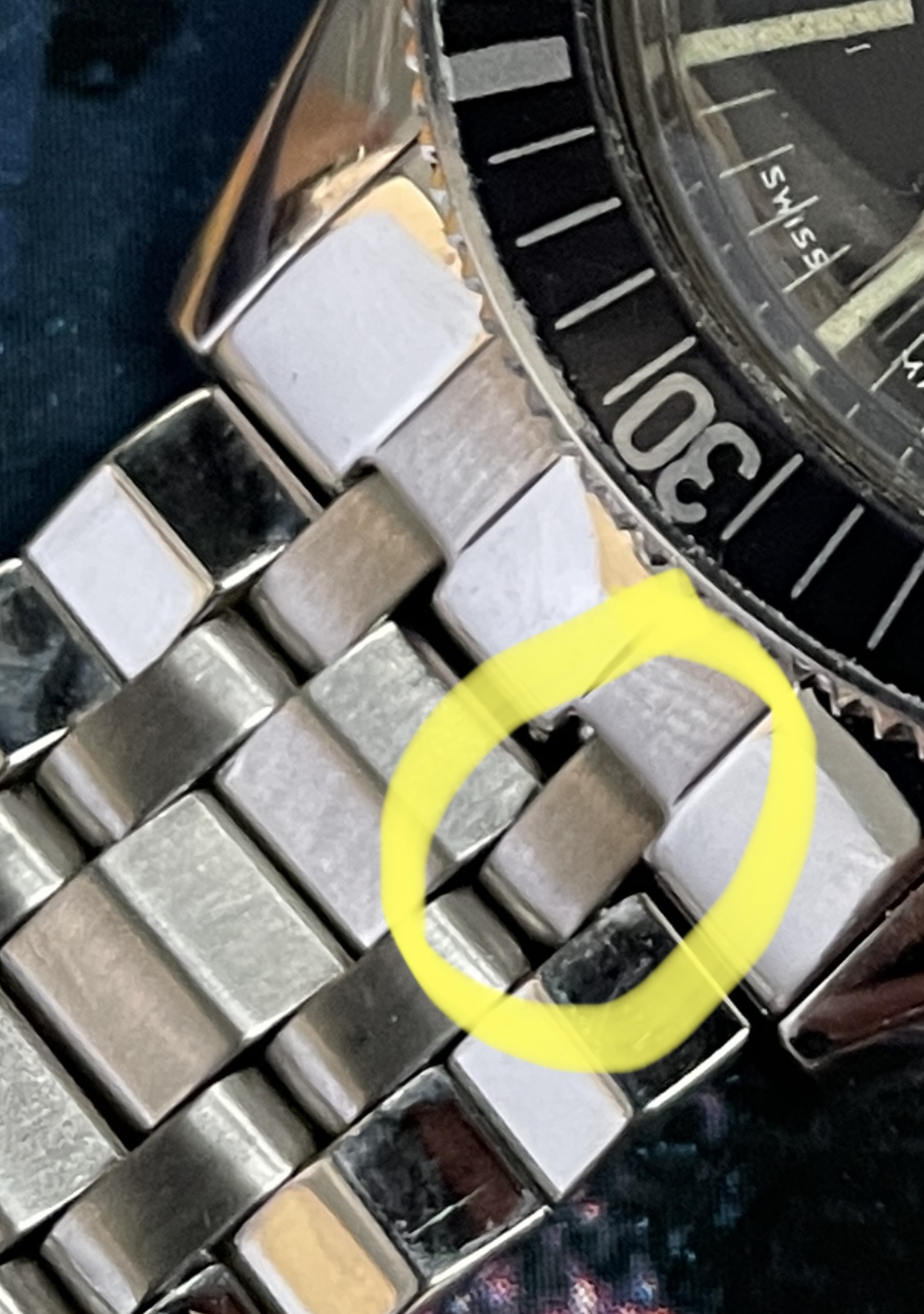

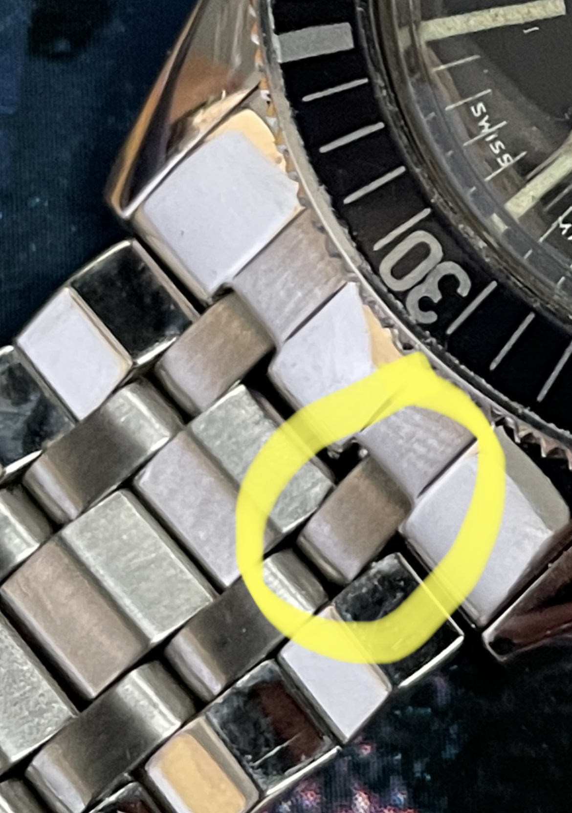

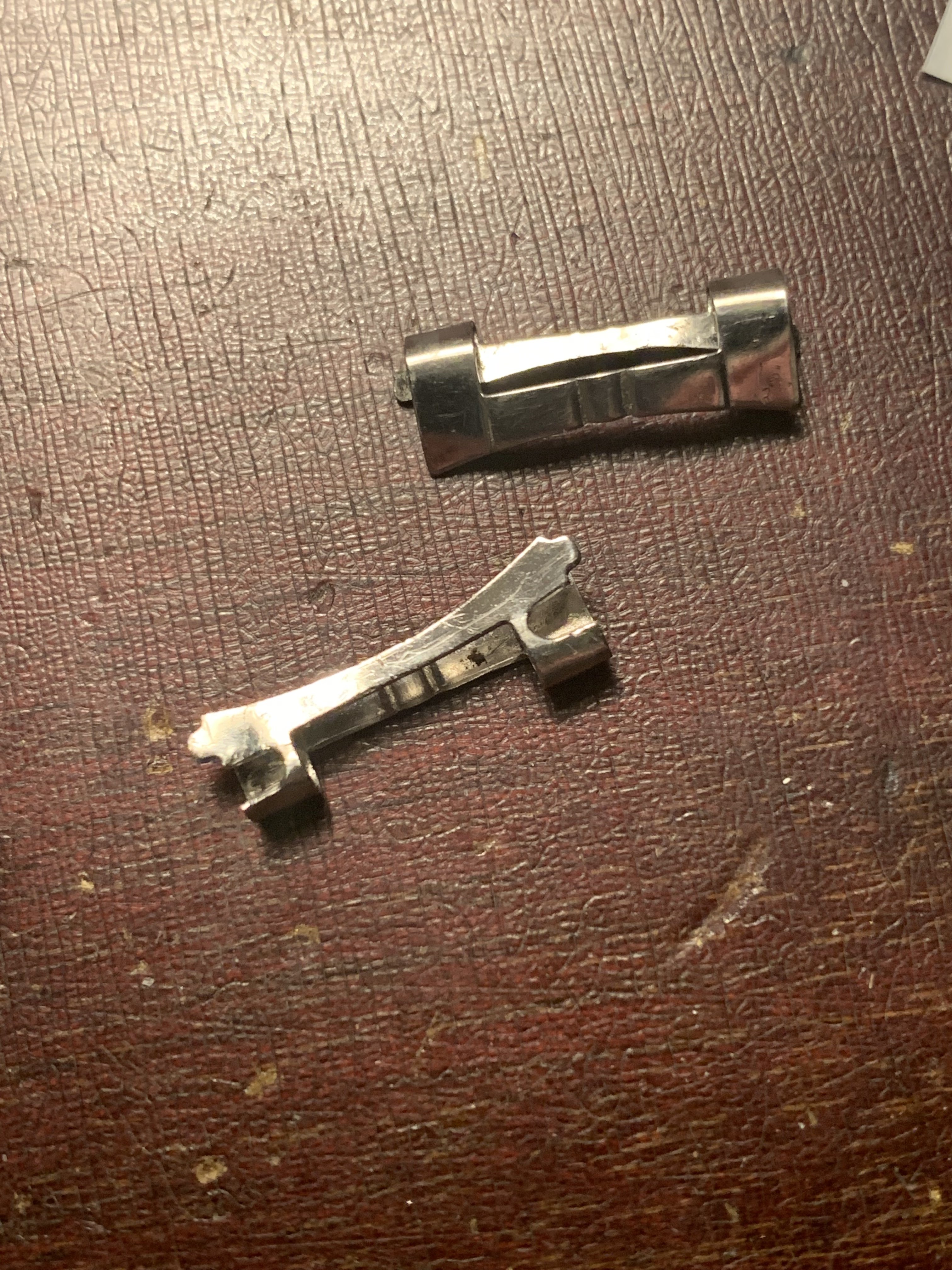

That helps. I have been doing a bit of filing. The problem with these current endlinks is that they sit very high between the lugs and there is noticeable a gap on the top side of the link. I have tried to reduce the height of the links but then it’s impossible to get them to fit. I’m tired of trying to make these work.

I do the same with stamped endlinks on many watches- tweak, fit, tweak, fit, bend and squeeze- by the end you are lucky if they don’t snap (and I have had a very rare old one do that 🤦)
not sure what method you are using but I use two pair of small precision pliers with the teeth wrapped in electrical tape. I have also found it easier to do micro tweaking with them mounted to the bracelet with a spring bar as it gives the endlinks some support. But using a pair to hold and a pair to bend makes it much easier than one pliers and your fingers.
Not sure what other methods people are using to manipulate endlink- I would love to hear others methods.

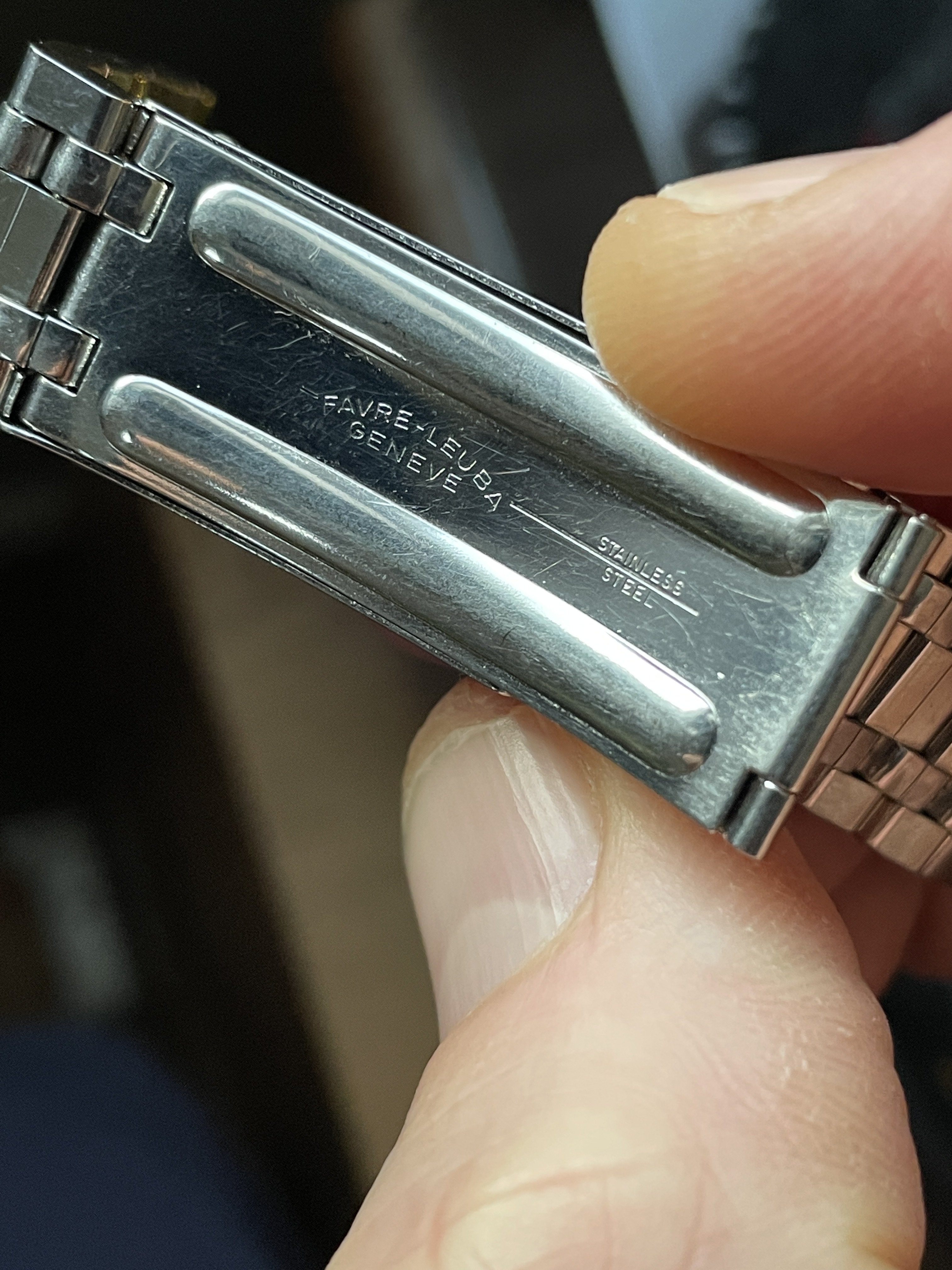

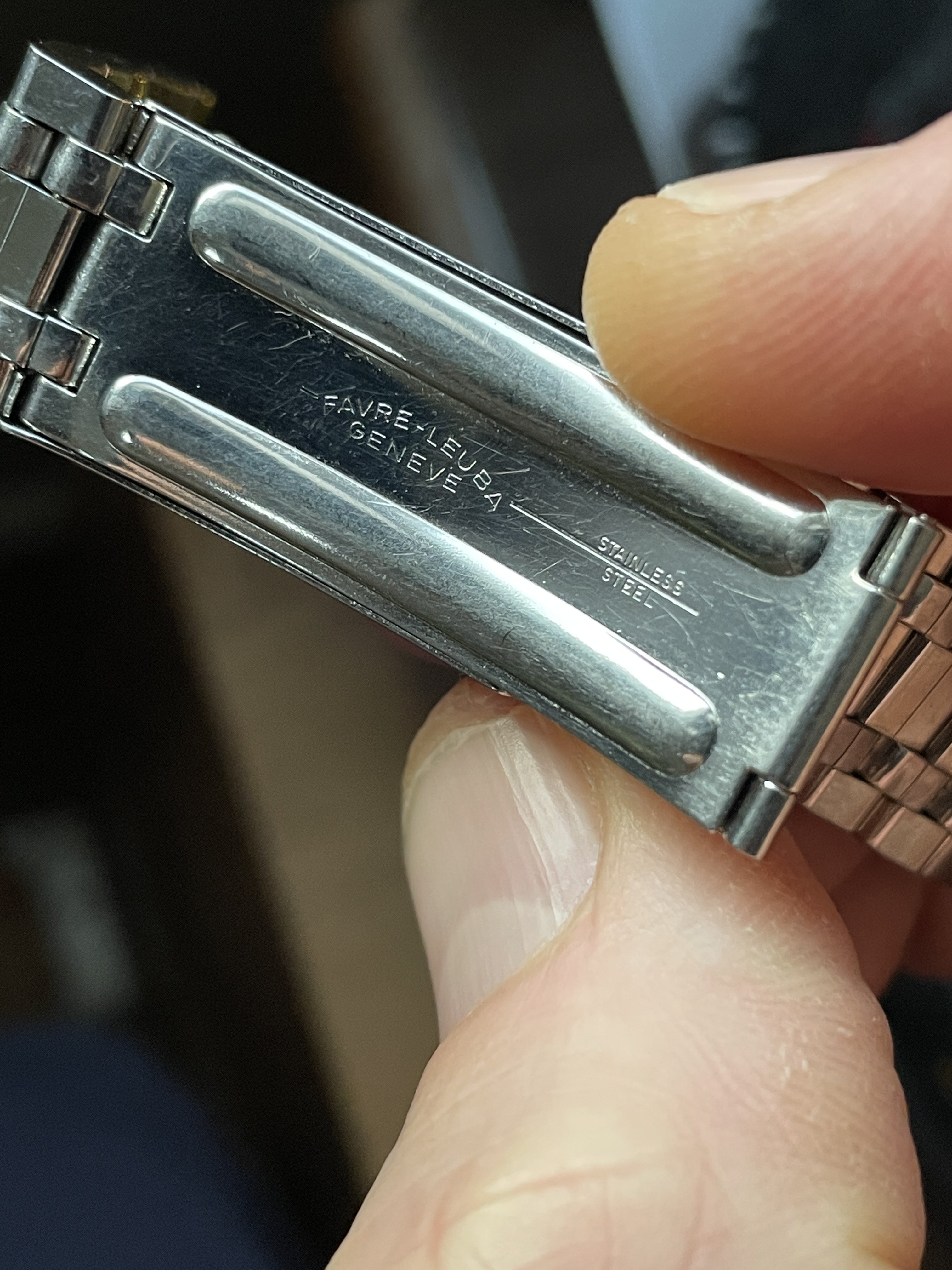

What would be interesting to find our is who made the bracelet. There were only a handful of OEM bracelet manufacturers back then and many made cross brand bracelets. Any identifiers in the clasp as to a maker? If you have that, you may be able to find another from a different brand but with the same fit
460
1,107
I might give the uncle Seiko Holzer links a try. Just waiting to hear back on some spacing measurements between the windows where the watch links feed into. Bracelet is signed Favre-Leuba, and Stainless Steel. I have confirmed with FL enthusiasts that this is the original bracelet. I have also been told “good luck” in locating the original endlinks. Damn the person who lost those!

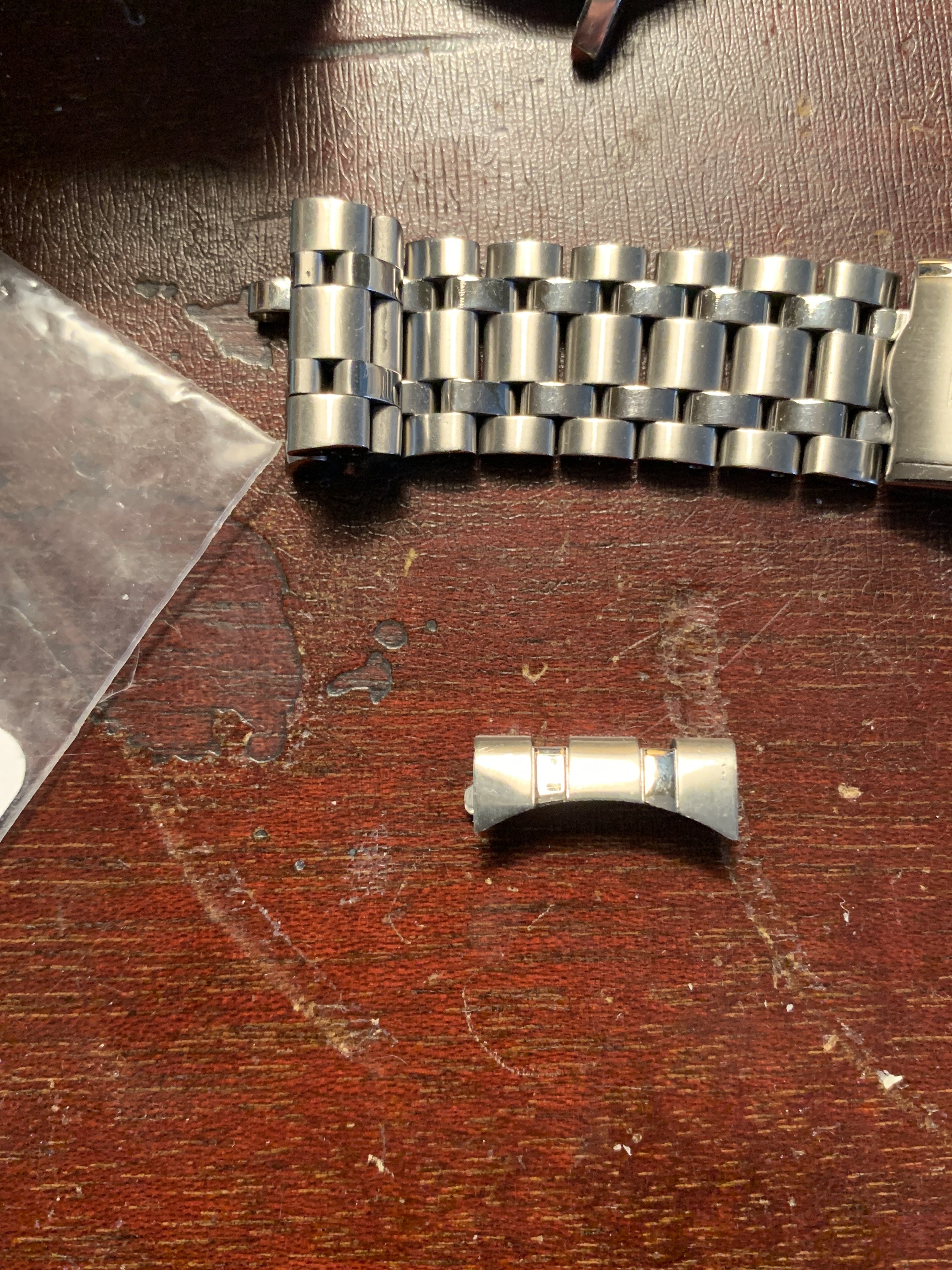

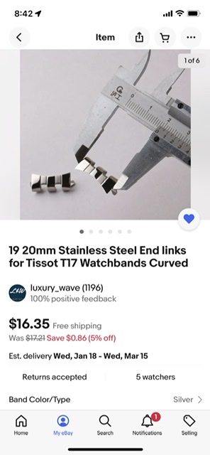

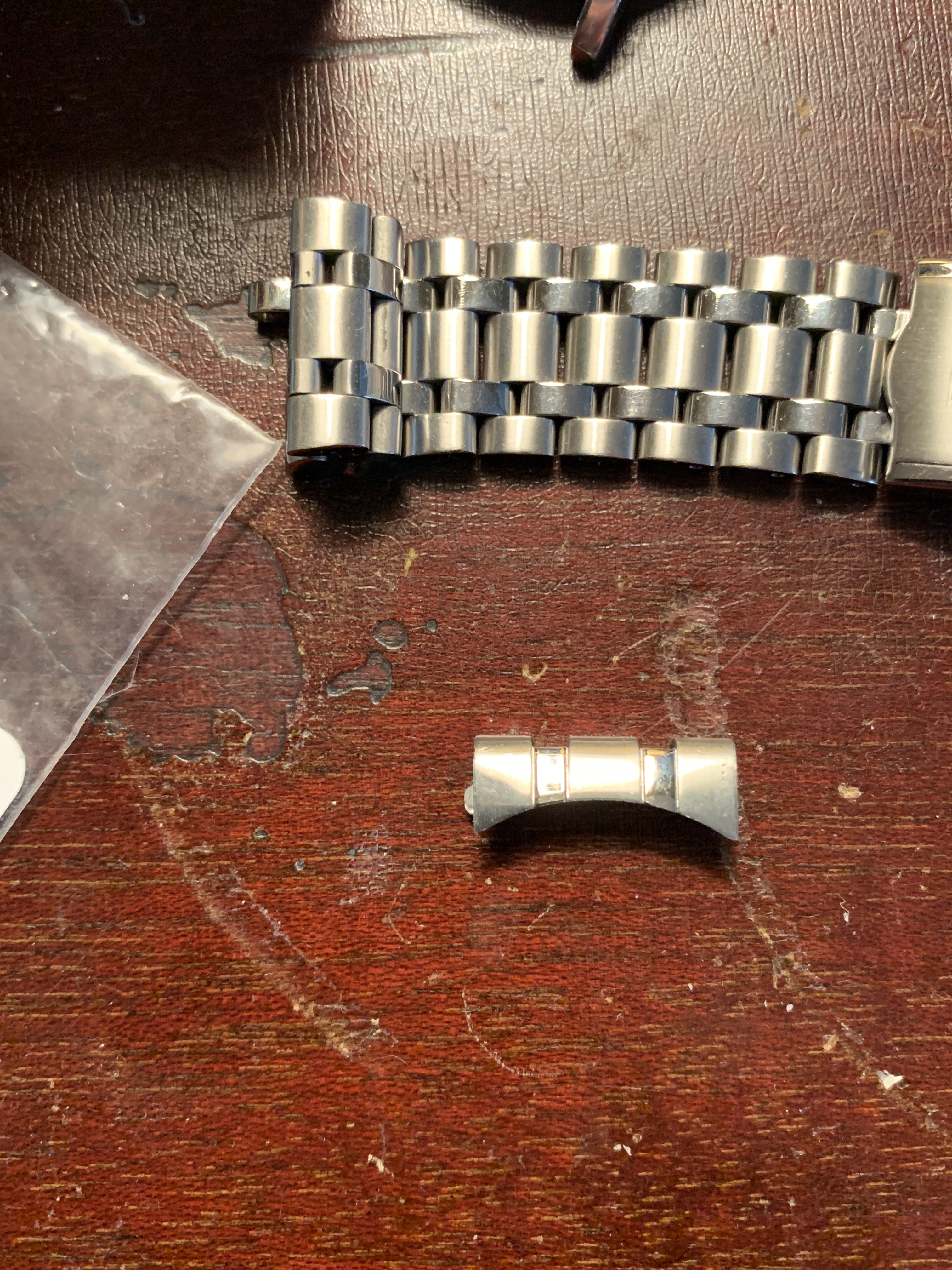

I have located what I believe to be the endlinks that came with the bracelet. They look identical.
16,305
45,025
Probably new repro pieces but who cares! Worth a shot and I would buy 2 or 3 pairs in case they need to be modified and get mangled.
I have been on the hunt for a couple sets like these for about a year
You take what you can get when it comes to vintage endlinks.

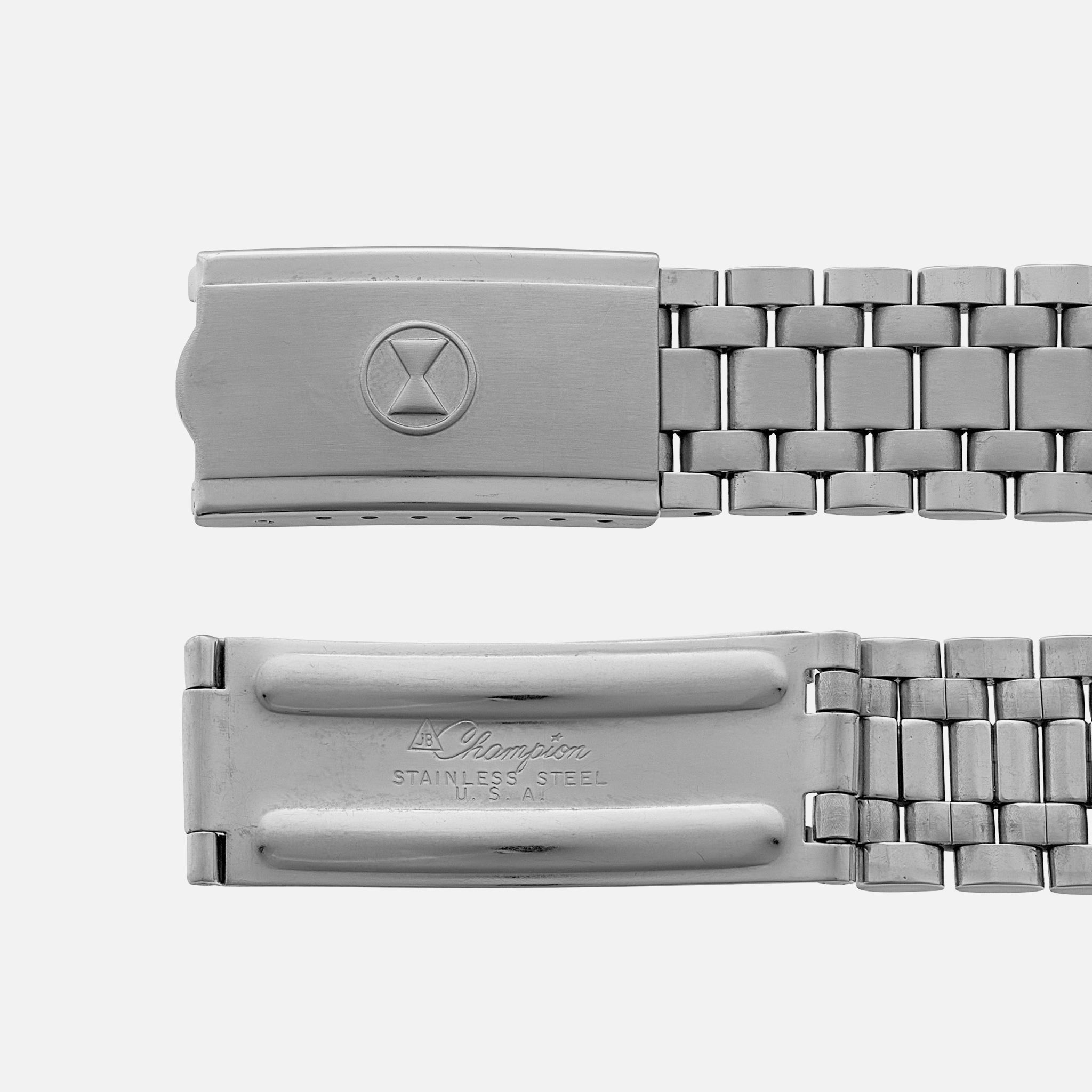

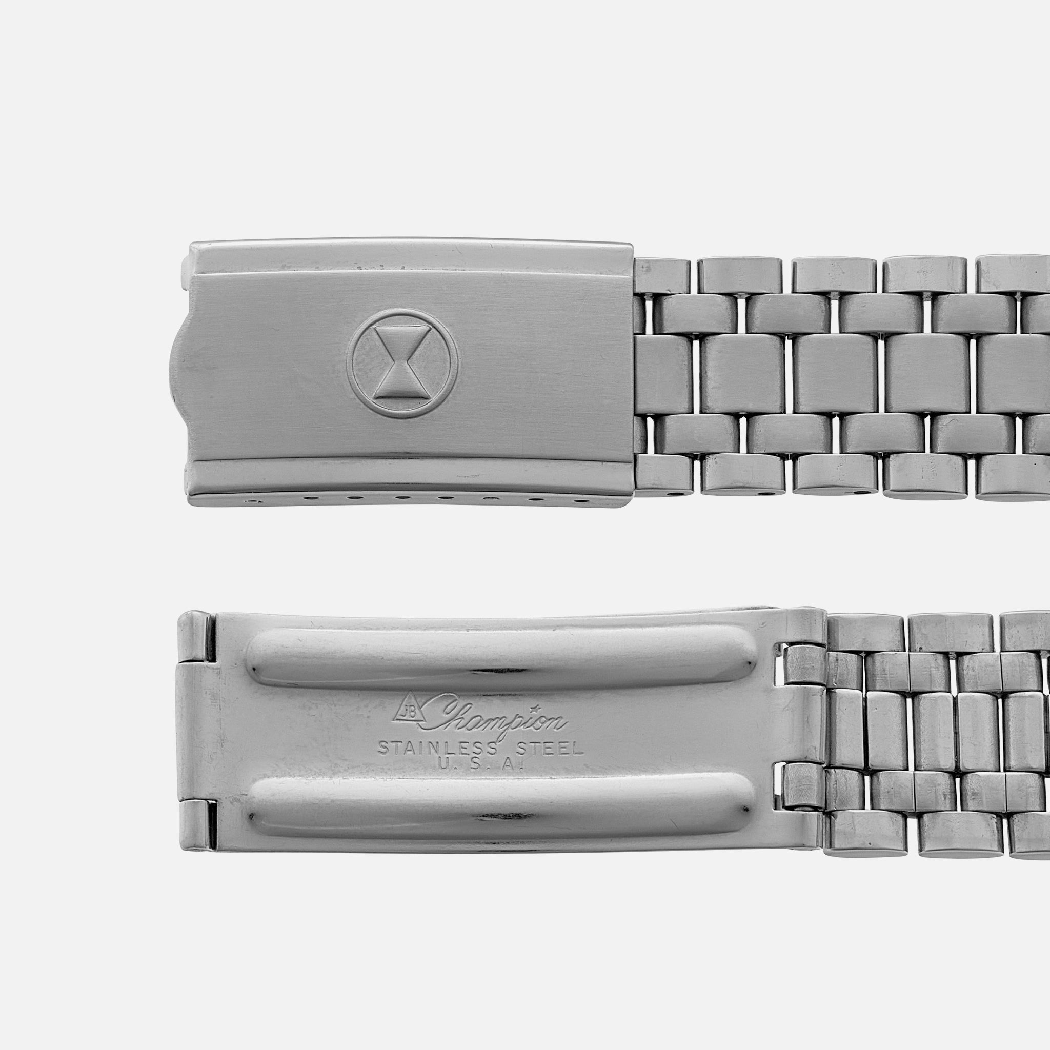

i think that might be a jb champion bracelet
460
1,107

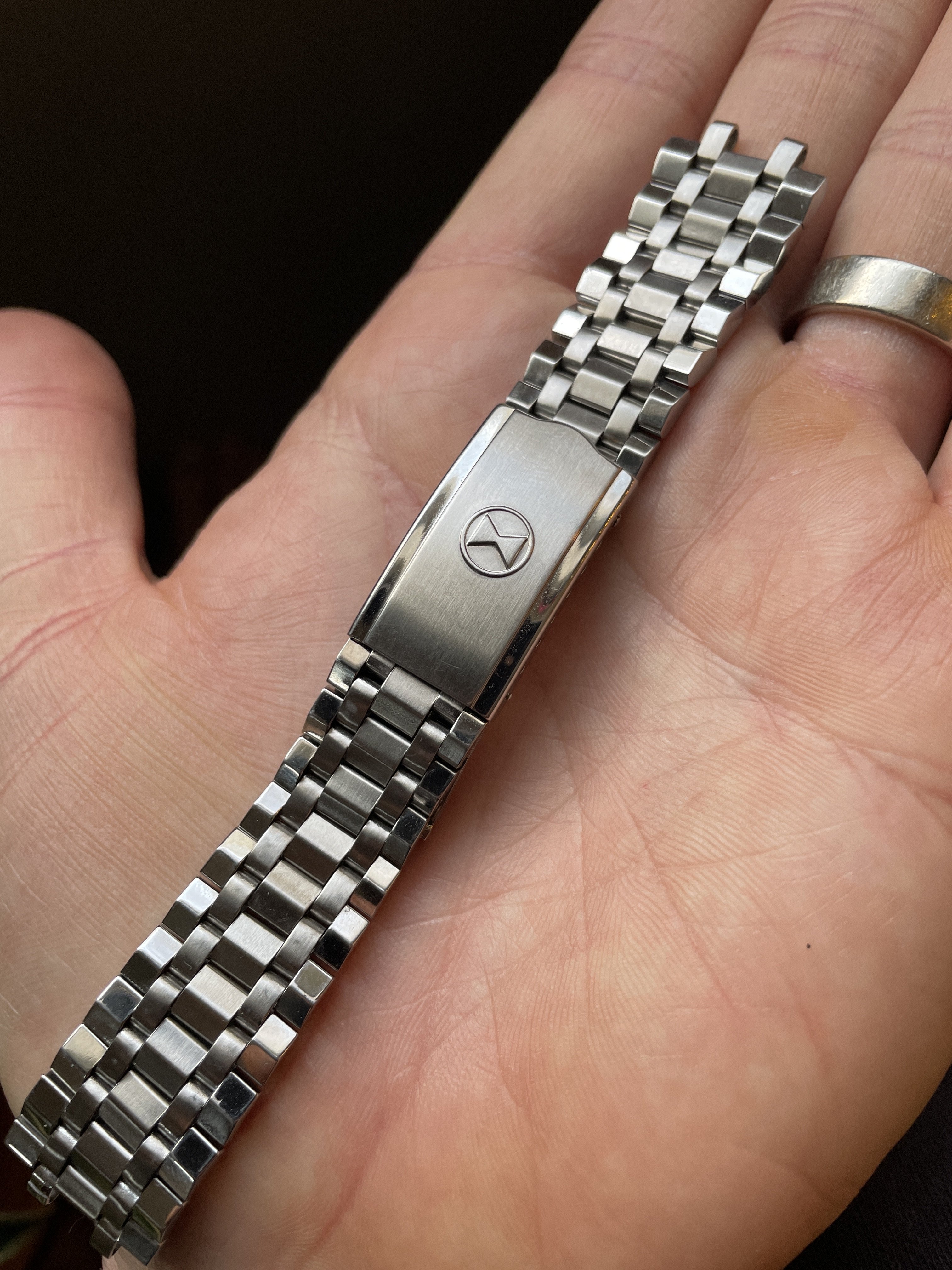

this is helpful, thank you. A quick Google search reveals that JB Champion did in fact supply bracelets to FL. The clasp on my bracelet looks identical to this one, even though mine is not signed JB
16,305
45,025
What you are looking at it this one
The links on yours are more angular. Not to say it may not be made by JBC, but it’s not quite the same bracelet.
