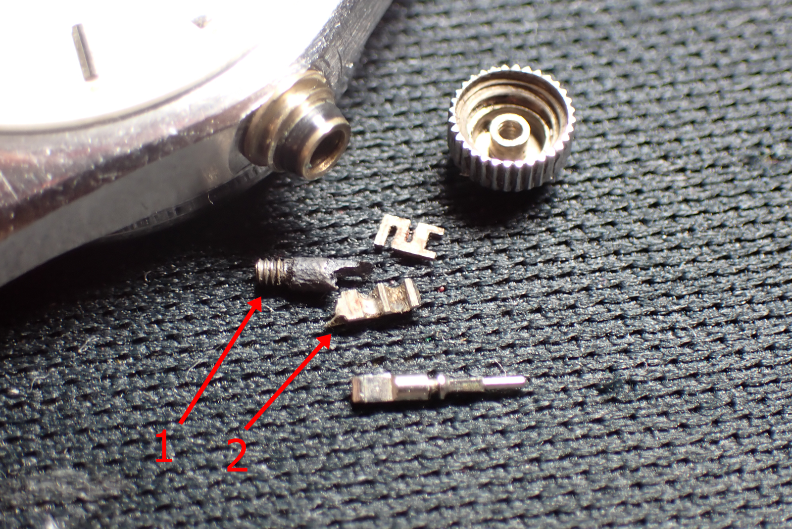

Does anyone have an idea where a vintage style crown post for screw down crowns could be aquired? I have been searching for so long, and just can't find anything similar. Mine broke, and i am trying to find a replacement, but just can't . The first picture is how it should look. The second two is my broken post. I don't necessary need the original, just one that's compatible.

These will not work. Because the crown is of a screw-down style, if i were to install a post from esslinger, there won't be any give needed when you're screwing down the crown. The post this polerouter has is what was used prior to spring loaded posts we currently see on diver/screw-down watches. If you look at the post in my first picture, you'll notice that there's two slots for the stem to click/slide through. That's why i've been searching for so long 🙁Just can't find them.

So, if I get this assembly correctly, part 1 and 2 used to be a single part and is now broken? Can't the two be brazed together?

You're correct. That post looked like a fork. The part that looks like an S, was placed in the middle of the post (not sure what it served for, tho). Can't be brazed together because a part of piece #1 rusted off and missing. Since the crown is not spring loaded, there's no way to crew it down into the case with a standard stem extension.
