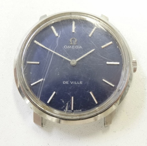

Hi there,
need some advise on a blue dial DeVille.
real? Fake?
If real, about time of production would be interesting!
Worth to buy for repair/ov or better I ask for how much they go usually.

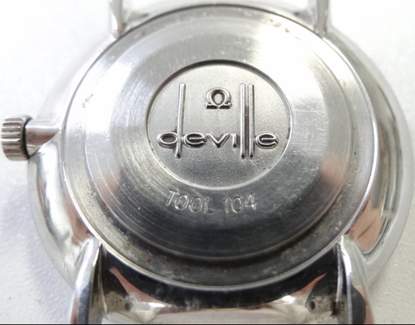

I did some search on the net, haven’t found this model with blue dial, the back I am also uncertain about the Tunnel for the crown ... tool 104 ?
Is it an manual wind, auto or quartz ?
thank You very much for input!

Hello fellow Japan auction hunter 😀
At this price just avoid this watch, The COSMIC / Tool 104/107 etc. watches are cancer - their crystals break easily when being removed, you can't access the movement yourself, you need an expert to remove / re-install the crystal, you could push air inside etc. - but it requires you to force pull the crown etc.
All in all, it's too expensive for too much trouble - The dial doesn't matter actually, since because of this complication, I don't think these watches are much in demand - It probably has a small handwind movement inside, I'd guess 625, but I have no idea, maybe it has an 600 series larger handwind movement, as I don't know how the unique latch type stem would work with a small 625 movement

Yes, did you get the watch by the way?
I guess it's prob. not a re-dial since there are more of them: https://www.catawiki.com/l/33684113-omega-deville-tool-104-blue-dial-men-1970-1979
And with some research, it indeed has an 625 movement, which is a beautiful small movement that is cheap and reliable, you can easily buy a new one
I couldn't find the model number tho, probably because no one has the balls to open one of these and look for the number

I don't necessarily agree. This is exactly the condition I like to find my watches in. I of course don't know the price of this but if the OP likes it I see no red flags. Dial is original IMO and there is no need to replace that crystal - some polywatch and that would be good to go. Tool 104 is the crystal lift tool, but any ol crystal lift will work - and this is an easy job for a watchmaker should the watch need a service. I too would suspect a small 600 series movement. In total, it depends on price but if you like it I would go for it.

Maybe I'm bad at polywatch but will those deep scratches hold?
Probably better to use UV resin instead 😁

Bottom of the watch also has what looks like it could be a crack, if the crystal is cracked, it might not make a re-entry or even removal
I had a cosmic Seamaster with a cracked crystal, I was able to remove the crystal with a chinese tool, fix the basic issue with it, then re-install the crystal by hand, with a lot of pressing work, and then, reinforce the crack with some uv resin, it looked great and resin probably made it waterproof too - but never again, now whenever I see a crystal locked watch, I run away
Selling my 56 KS for this reason too, I just don't want crystal locked watches
Tako Yaki, you can certainly do better and I don't think the price of the same watch in better condition can exceed $300 - this was too expensive at $260 - since you are in Japan, you could just get an 625 movement for $25 from a junk Ladies Omega, the movements inside are usually pristine
If not polywatch then some sandpaper and Brasso will.
At 208 euro (assuming that this was an eBay listing and there are no auction fees) I personally believe this was an ok price. Good luck in your hunt OP.
Not sure if you ar speaking from experience or not, but I work on these sorts of cases often, and they are not a problem typically. If you have the right tools and know what you are doing, they are easy to work on.
