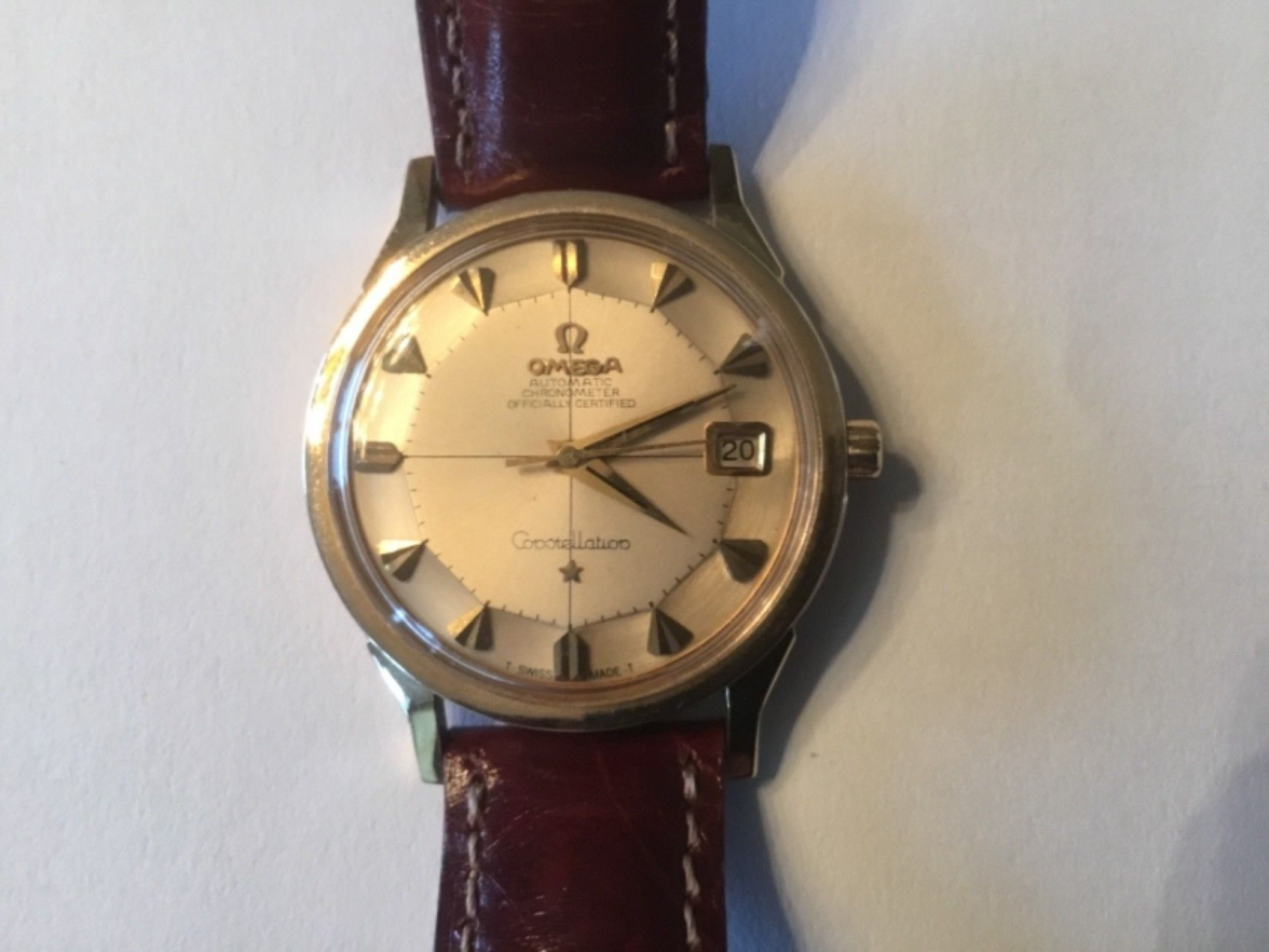

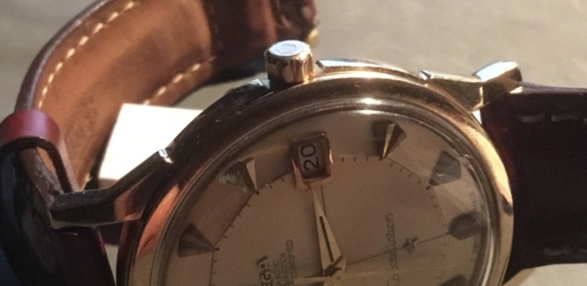

    Usual trawling through listings and I come across this:
    [​IMG]
    Now usually the ones I see with dog legs aren't arrow head markings, is this a redial? And what is up with the yellow tint, is that aging patina?
    More pics:
    [​IMG]
    [​IMG]
    [​IMG]
    [​IMG]
    [​IMG]
    Seems to be a 167.005 case.
    I've been waiting for a dog leg arrowhead dial, but I wasn't sure if it was possible - is this the real deal?
  2. Peemacgee Purrrr-veyor of luxury cat box loungers Apr 20, 2018
    5,159
    7,890
    The pics aren’t good enough to tell if the dial is the real deal.
    167.005 should be too late for an arrowhead.
    But perhaps in your excitement at finding an arrowhead dogleg , you’ve missed the obvious tell-tale.
    The 167.005 is a no date Connie.
    I think that answers your question.
    jumpingsecond, felsby, Anj and 2 others like this.
  3. ulackfocus Apr 20, 2018
    25,983
    26,974
    Franken.
    167.005 is a no date case. That has a date so it should be a 168.005 reference number.
    I think you're only chance to get a Pie Pan dial with Arrowhead markers and a date window and dog leg lugs would be inside a 14.902 case - IF (and that's a BIG "if") that combination exists. That combination might have a caliber 50x (501 or 504) or a caliber 561.
    Edited Apr 21, 2018
    watchknut, Anj, chanbar and 1 other person like this.

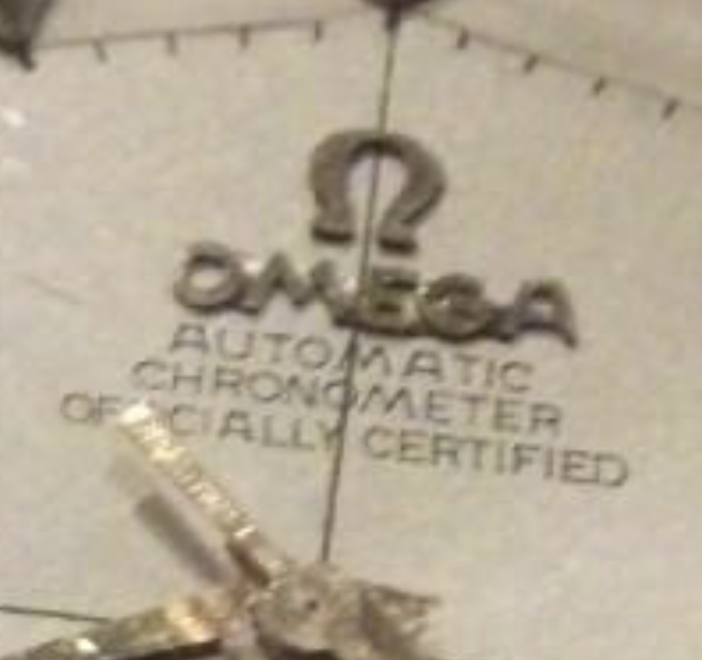

  4. Thatguy Apr 20, 2018
    141
    115
    Fake dial... Franken as well...
    Check out the font closely, and MOY aren't aligned with how it's supposed to be ..

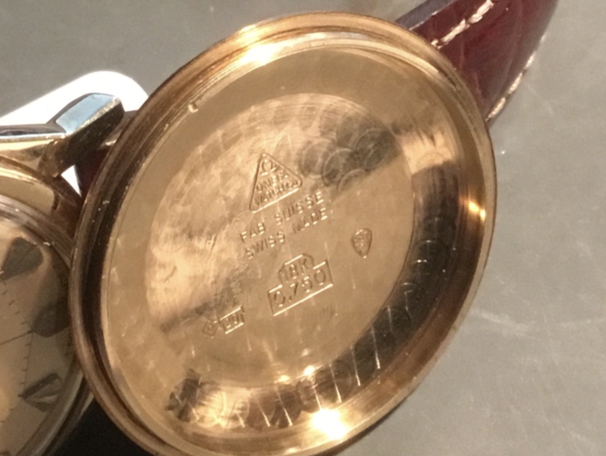

  5. Noddyman Apr 21, 2018
    1,116
    1,774
    There’s something wrong with the case back, it should be flat on the outside not dished.
  6. Thatguy Apr 21, 2018
    141
    115
    Yep, for styling like this, it should be the 14900 or constellation series with 14xxx reference, for the bowl style it's the 16x.xxx

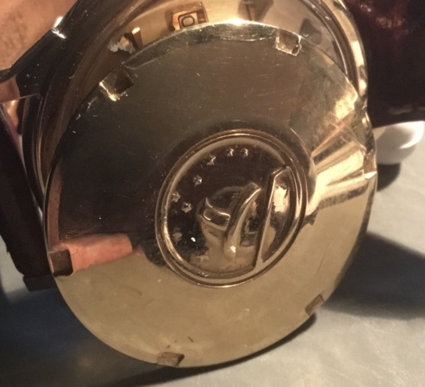

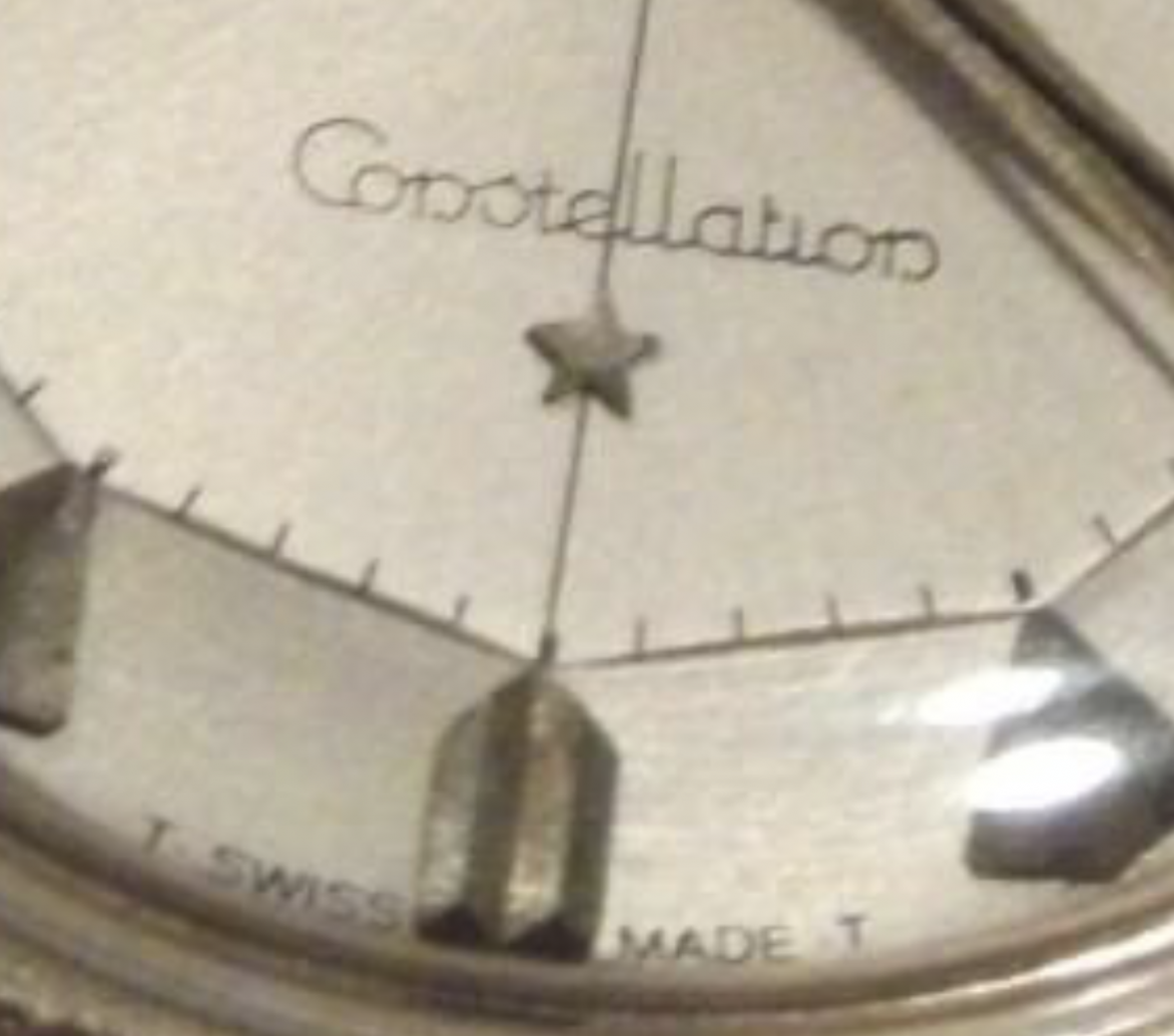

    there's something very wrong with that watch
    I'll rephrase that - there are a lot of things very wrong with that watch
    Screen Shot 2018-04-21 at 22.22.19.png Screen Shot 2018-04-21 at 22.22.33.png Screen Shot 2018-04-21 at 22.23.24.png Screen Shot 2018-04-21 at 22.23.46.png
    Mark020, cristos71 and felsby like this.
  12. felsby I don't see any option in settings or profile Apr 21, 2018
    1,439
    5,303
  13. Peemacgee Purrrr-veyor of luxury cat box loungers Apr 21, 2018
    5,159
    7,890
    Dodgy dial
    No case reference
    Observatory without brickwork
    Odd crown
    Photos not good enough to be certain but possibly a complete fake.
    felsby likes this.
  14. ulackfocus Apr 21, 2018
    25,983
    26,974
    Fake.

    And some poor sucker paid $2,850 for it.

    Oof, there was so many wrong things on that dial - the star alone is messed up. How did someone end up paying $2,850 for that? That must be one of the highest priced bamboozles I've ever seen. Caseback says 18k, did they think it was white gold?
