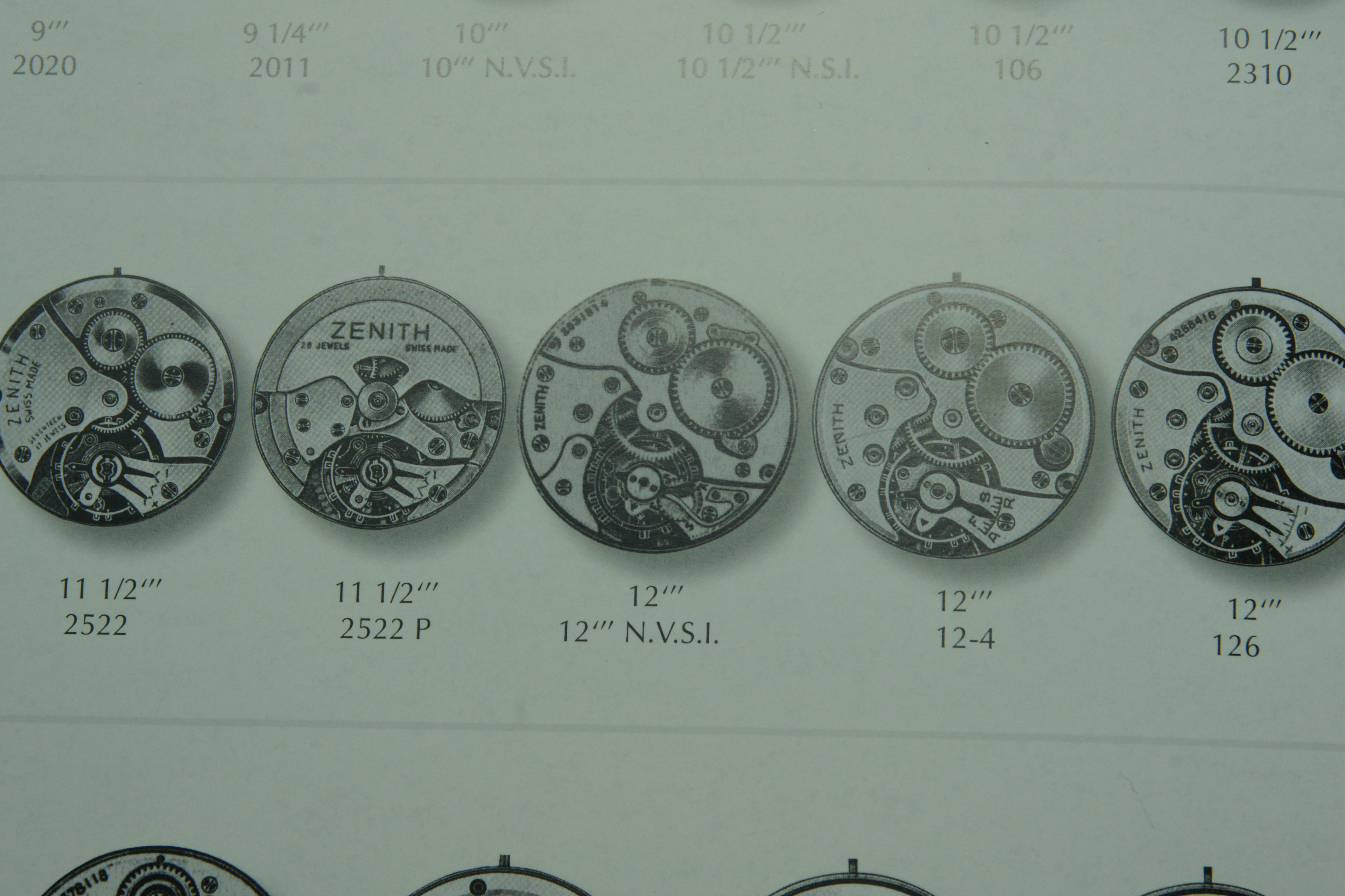

    Actually, I have just checked Rossler's sketches of the movement and it looks like a N.V.S.I. The actual model is preceded by the ligne size so if it is 12'" then the model is 12'" N.V.S.I.
    Nobody actually knows what N.V.S.I stands for as the records were lost eons ago. You might have to go down an alternative route and buy a pocket watch from which you could take the balance or you might strike lucky and find one on a European eBay site. Failing that, you could try contacting Elizabeth (a French eBay seller who finds a lot of old Zenith parts from, God knows where) Her web site is kalyanediffusion89.com)

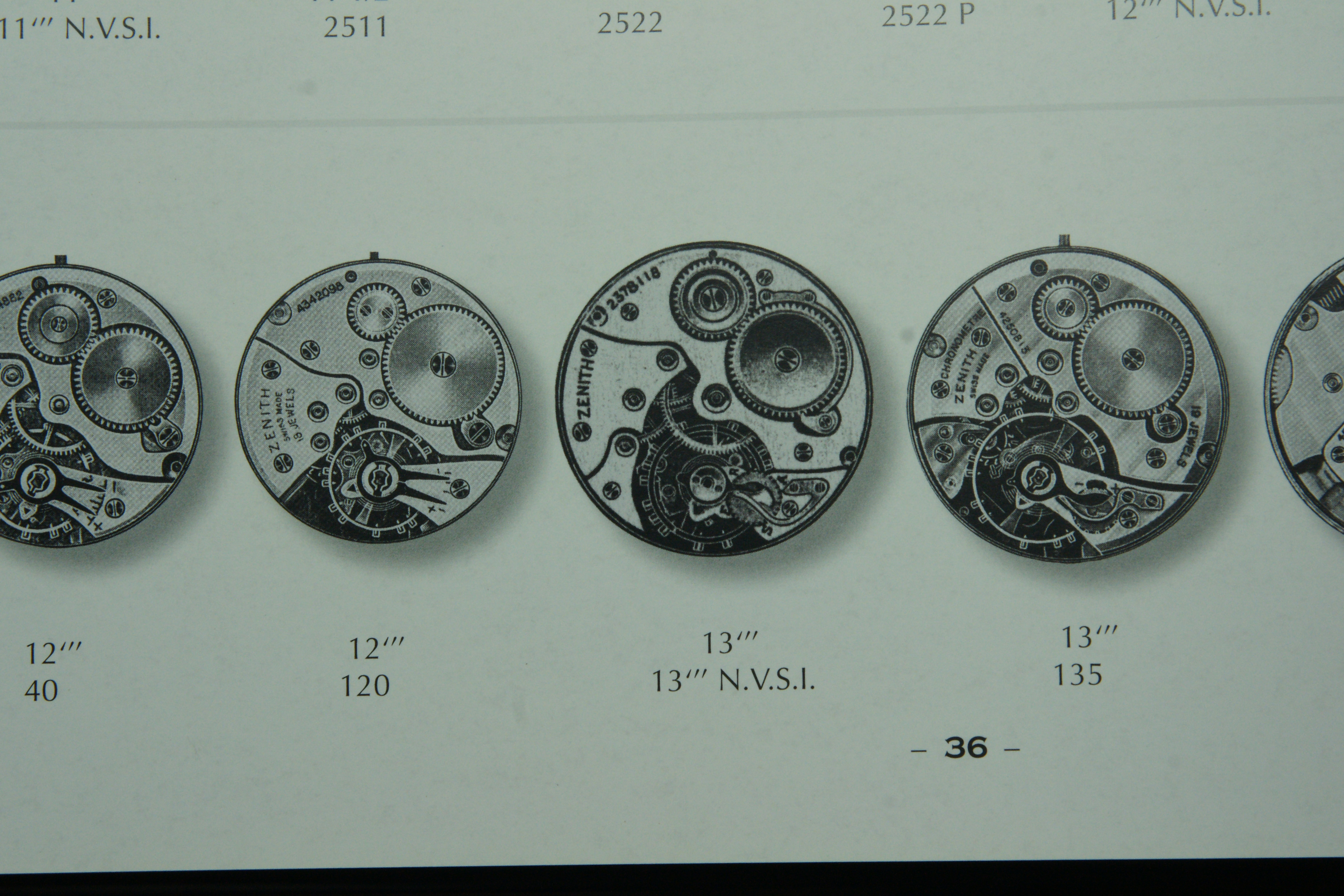

    I don't know if you have a copy of Rossler, but the movement is definitely a N.V.S.I - I'll try to photograph the picture.
    If it is 12'" then the movement was made between 1906 and 1910 (70,200 made) The serial number would put yours at 1929 so should not be 12'". The N.V.S.I.s made that correspond with 1929 would be 10 1/2'" which is a 10 1/2-2, 13'" (13-1 for a Lepine and 13-2T for a savonette [which I don't think it will be because the "T" means a mobile stud on later models, so I presume does on the older ones too]) 15'" (15-1 for a Lepine and 15-2 for a savonette) or 16'" (16-1 for a Lepine and 16-2 for a savonette)
    I think the chances of a 12-4 being the same are quite slim but I would be happy for you if they are the same item

    Hopefully, these two photos from Rossler show what you might have and the difference between the 12-4 and the 12'" N.V.S.I.

    Once I know what to look for...Bingo!
    http://www.ebay.com/itm/Zenith-12-NVS-balance-staff-watch-movement-part-/271219119287Purchases made through these links may earn this site a commission from the eBay Partner Network
    http://www.ebay.com/itm/Zenith-ligne-13-cal-NVS-1-balance-staff-watch-part-/230424770102Purchases made through these links may earn this site a commission from the eBay Partner Network
    Now I need to check with the watchmaker next week. In the meantime, I think I'm going to pick it up anyway to do the measurement just in case.
