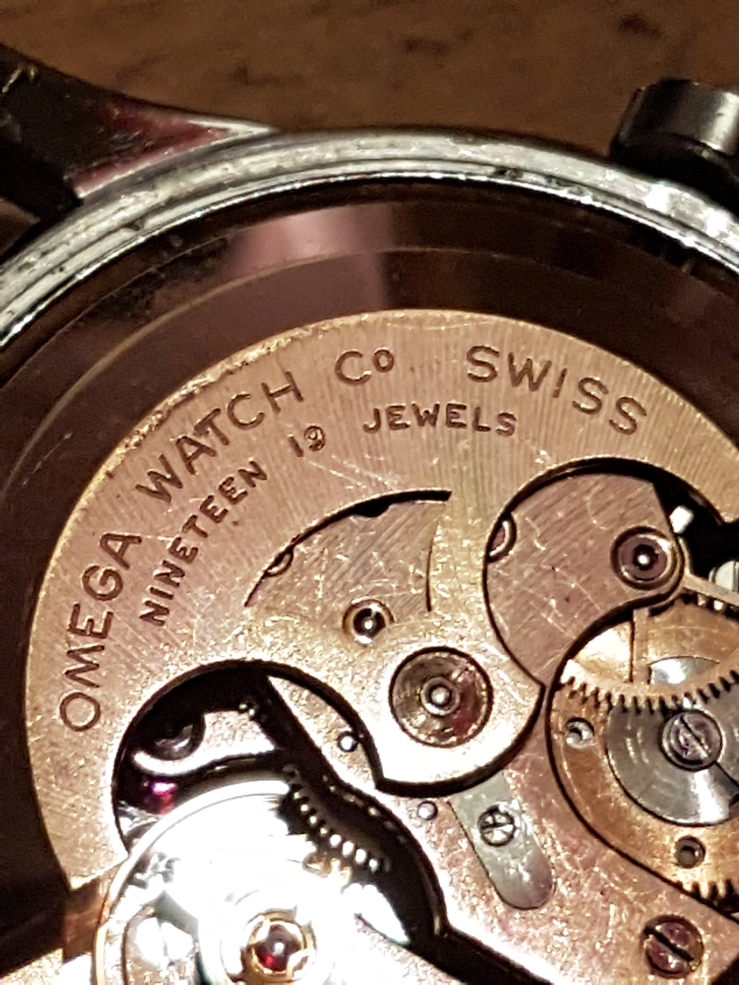

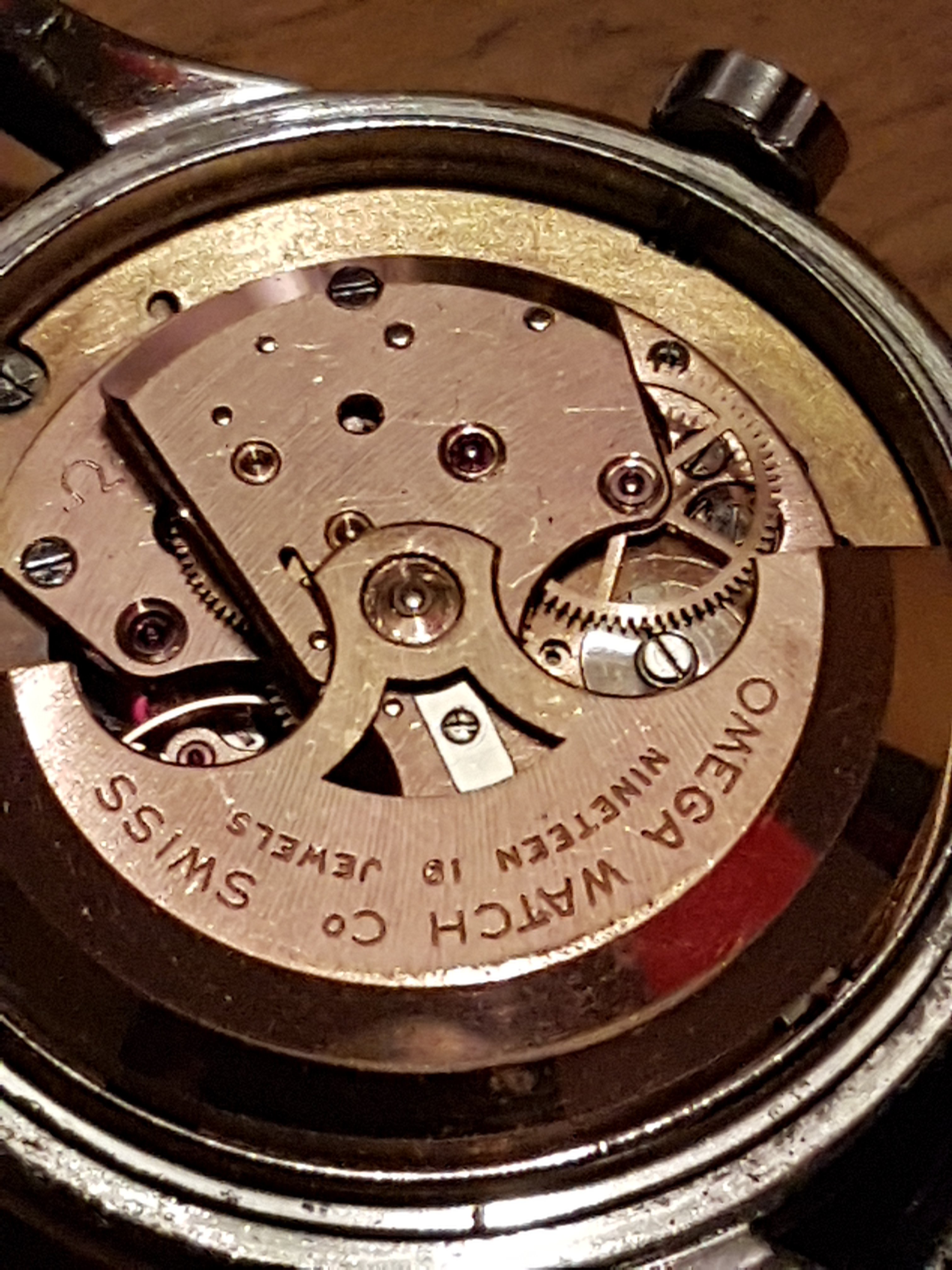

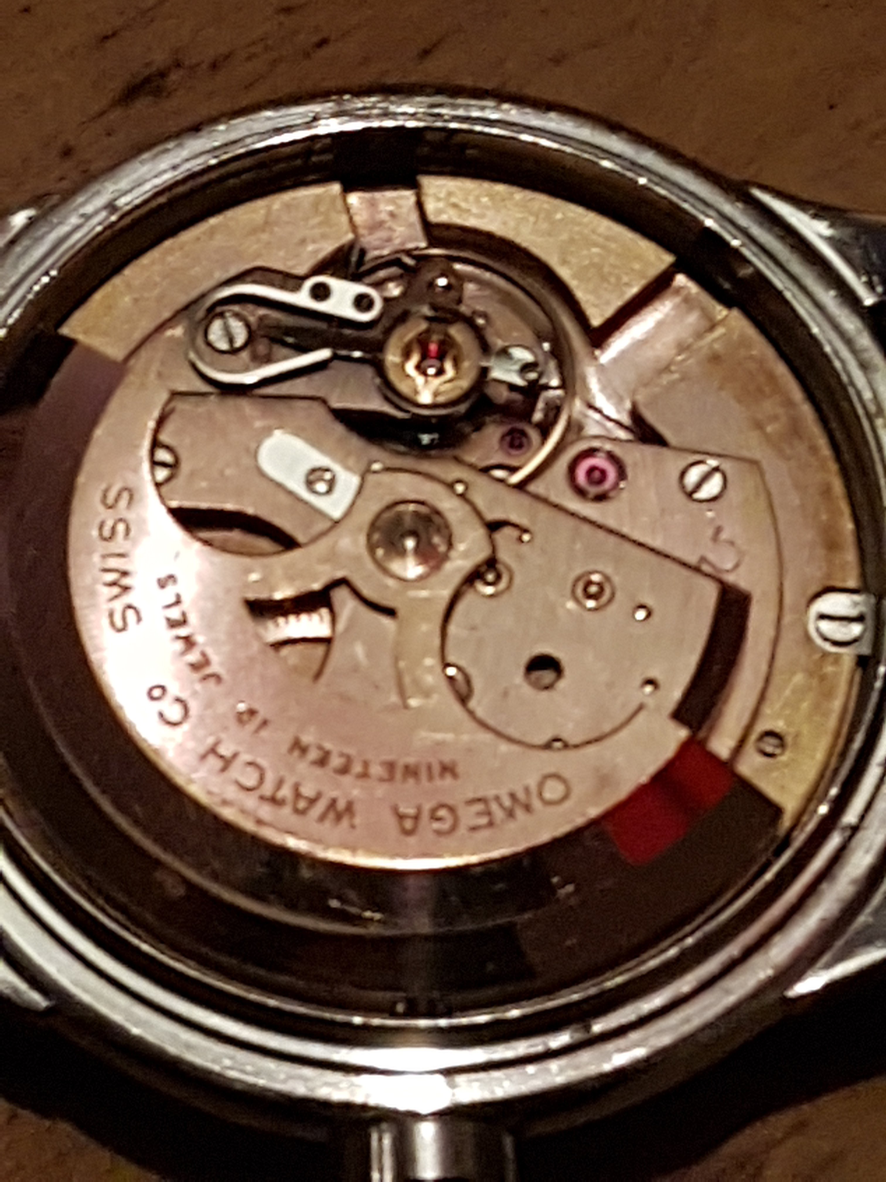

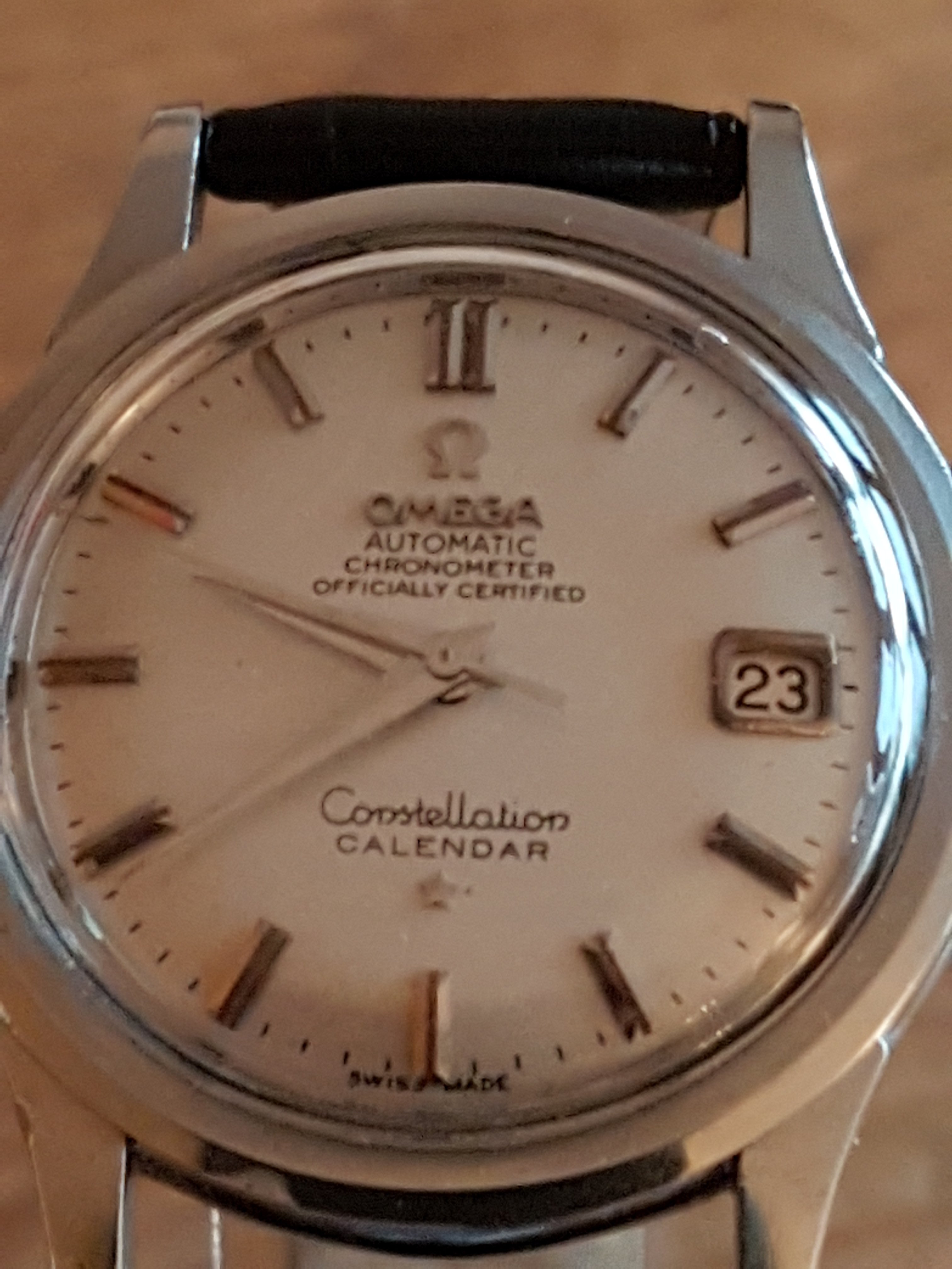

    People,
    I need help with a constellation calendar 2943 cal 504. Tomorrow I will post pictures of the watch in daylight.
    I have several problems with the watch.
    1. The dial does not seem to pass the MOY test.
    2. The text is off. Automatic is to big.
    3. The movement does not mention cal 504 and it says 19 jewels while the cal 504 is a 24 jewel.
    4. The hands dont look original.
    Did the cal 504 had a 19 jewel movement?
    Seller is saying that his father bought the watch in 1959 in Singapore and as far he knows nothing was replaced or repainted.
    Thanks for your time and expertise! I enjoy reading the threads!
    20171115_184412.jpg 20171115_184348.jpg 20171115_184318.jpg 20171115_184419.jpg 20171115_184209.jpg 20171115_183505.jpg 20171115_183501.jpg

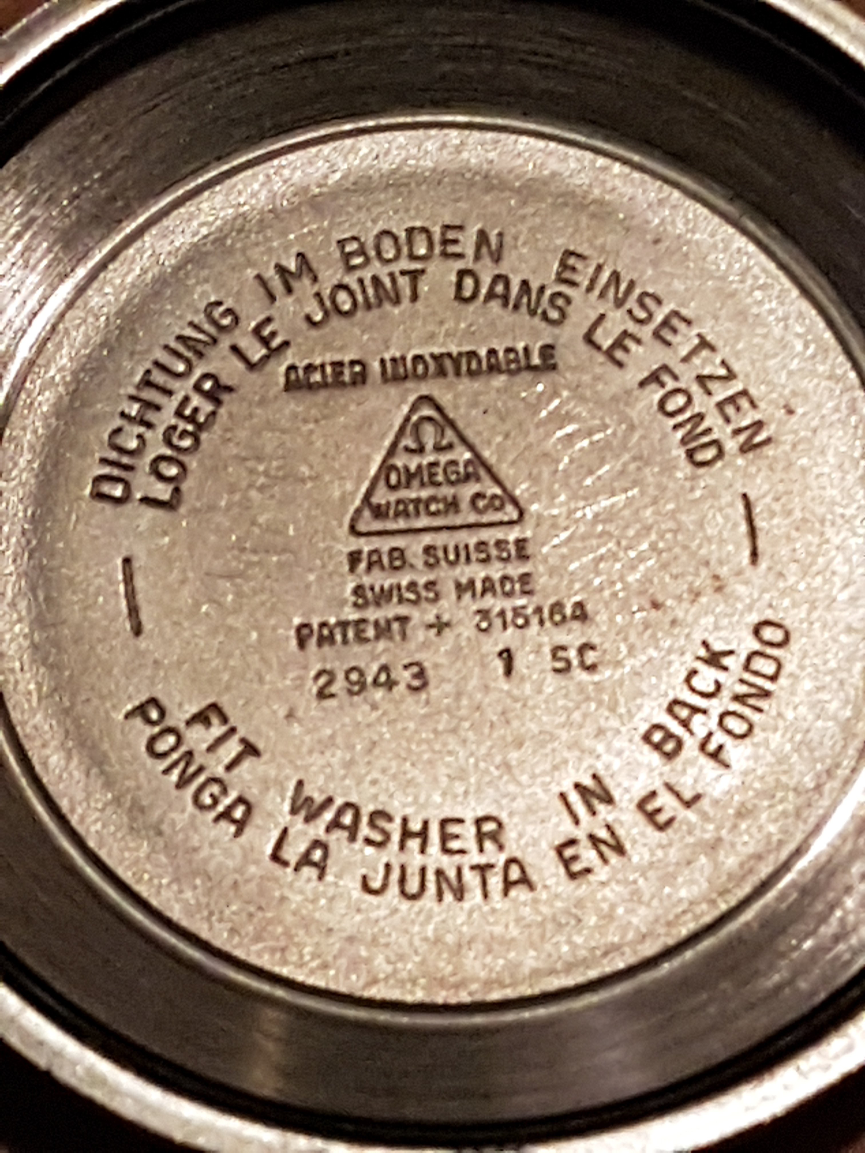

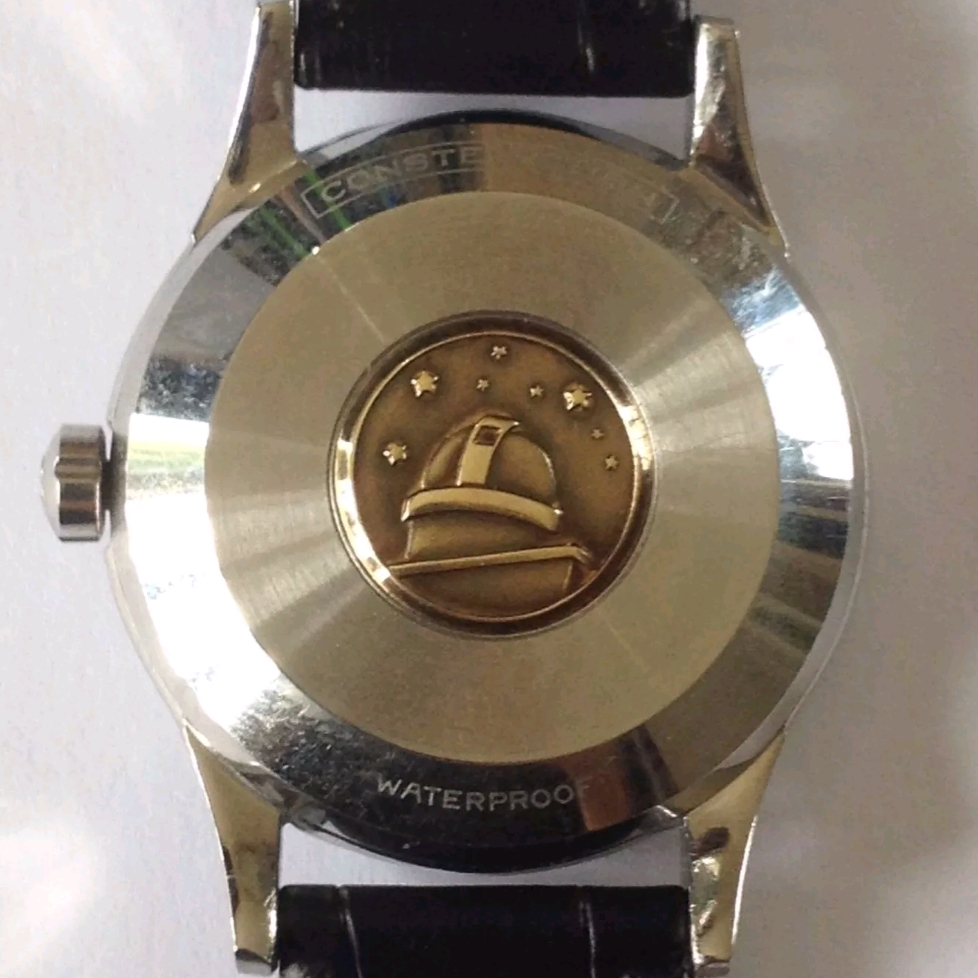

  3. Shabbaz Nov 15, 2017
    4,900
    17,865
    Caseback:
  4. BlackTalon This Space for Rent Nov 15, 2017
    5,181
    8,388
    Dial text does look pretty questionable, but better photos tomorrow will help.
    Do you see a movement number? I see the Omega logo in the movement pics, but none seem to show the movement number. The chronos usually have an "adjusted to x positions", at least on later ones; I need to dig out AJTT to check this (which I cannot do for a couple of hours).
    Looks like the rotor has rubbed quite a bit on the caseback.

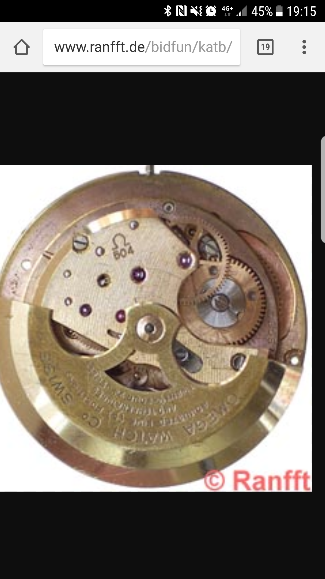

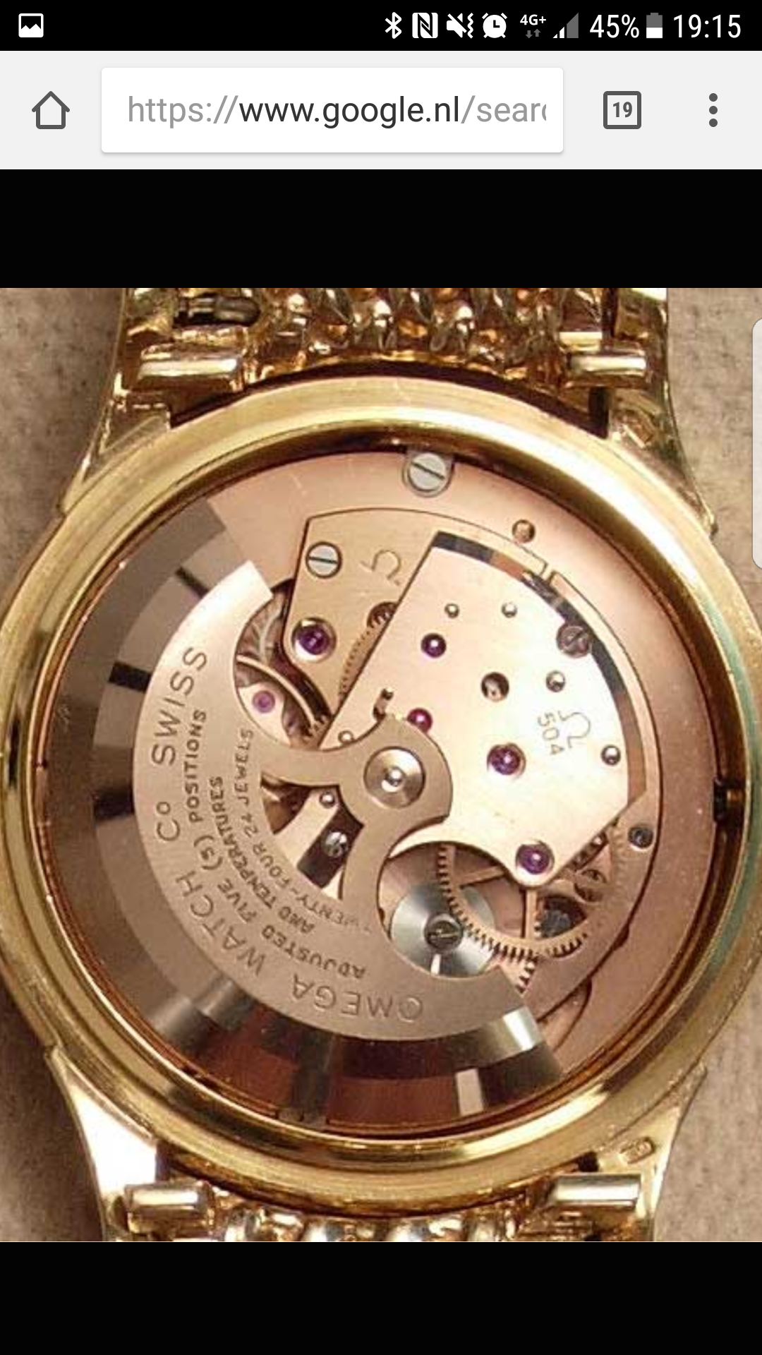

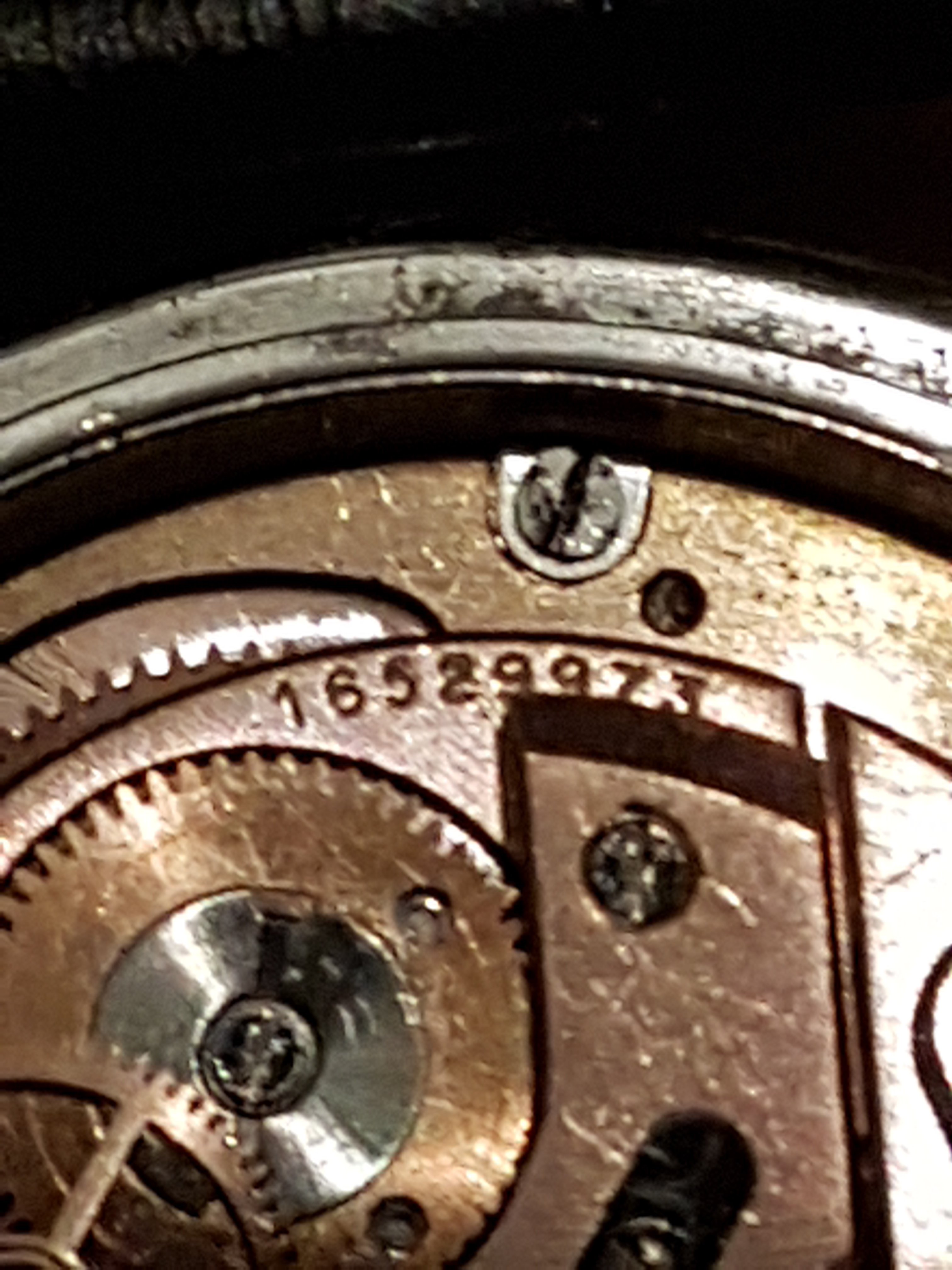

  5. Shabbaz Nov 15, 2017
    4,900
    17,865
    That's the problem. There is no movement number so something was changed during service. But it looks like a cal 504.

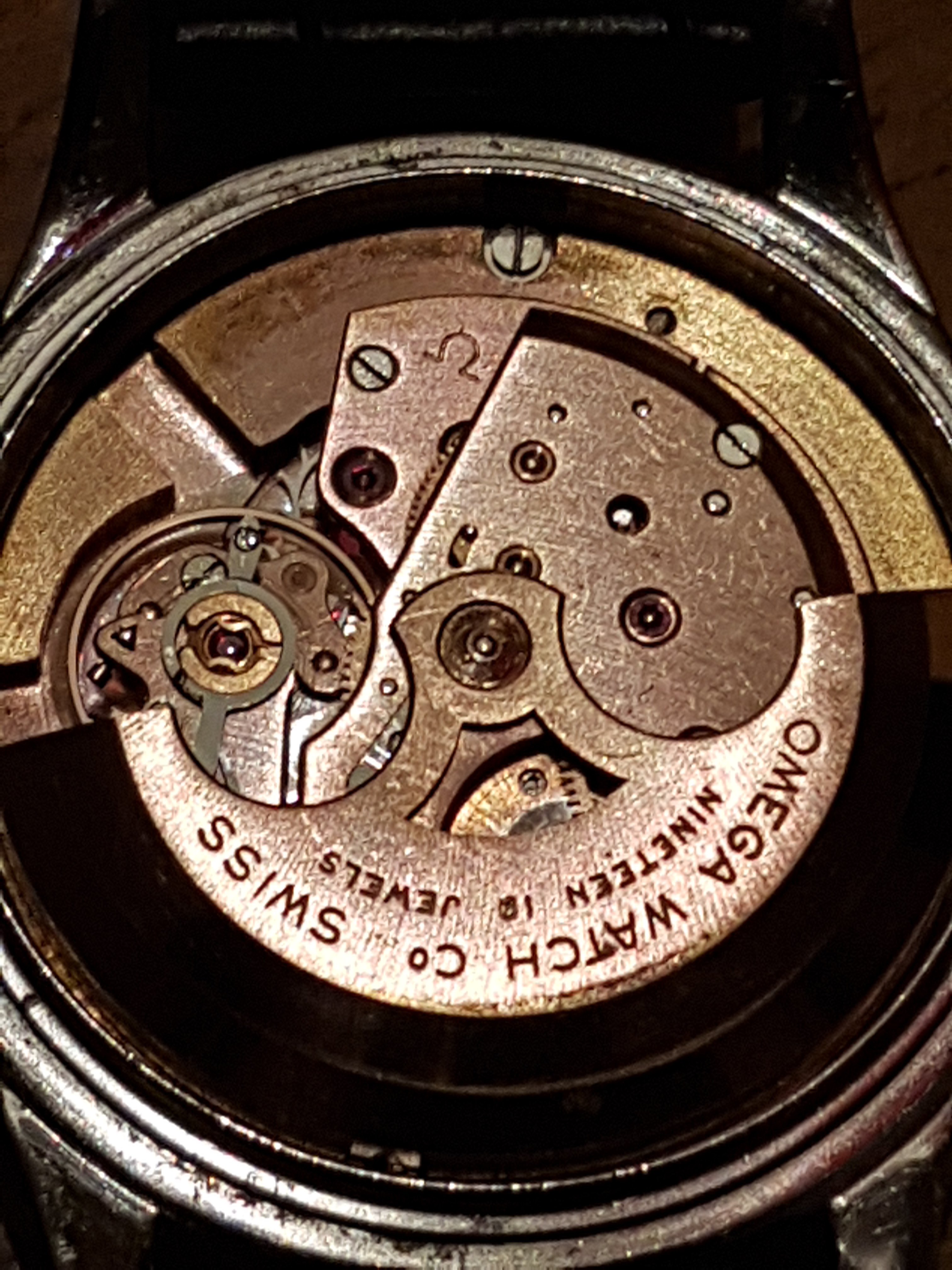

  7. François Pépin Nov 15, 2017
    1,531
    1,081
    It looks like a 470-490-500 series movement, which do not always have the caliber number written in the movement - I do not know why. Yours looks like a 503 (non chronometer, 19 jewels, calendar). Unless the rotor has been changed from a chronometer to a non chronometer one, this movement is not a chronometer and thus does not originally belong to a Constellation. Be careful because there are many Frankens using 50X regular movements to make up connies.
    As usual, Mondodec's blog is a (very) good lecture:
    http://users.tpg.com.au/mondodec/movement2.pdf
    Edited Nov 15, 2017
  8. TNTwatch Nov 15, 2017
    2,876
    1,950
    Calibre 503 would have that number engraved on the auto bridge.
    This was supposedly a one owner watch, so the movement just had the auto wind bridge changed out to a generic replacement bridge for the 50x series along with the rotor.
    Dial is definitely refinished. Hands are not fully clear but appear incorrect for the hour and minute.

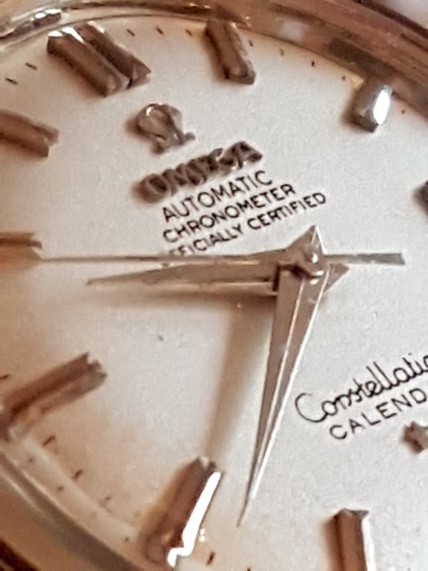

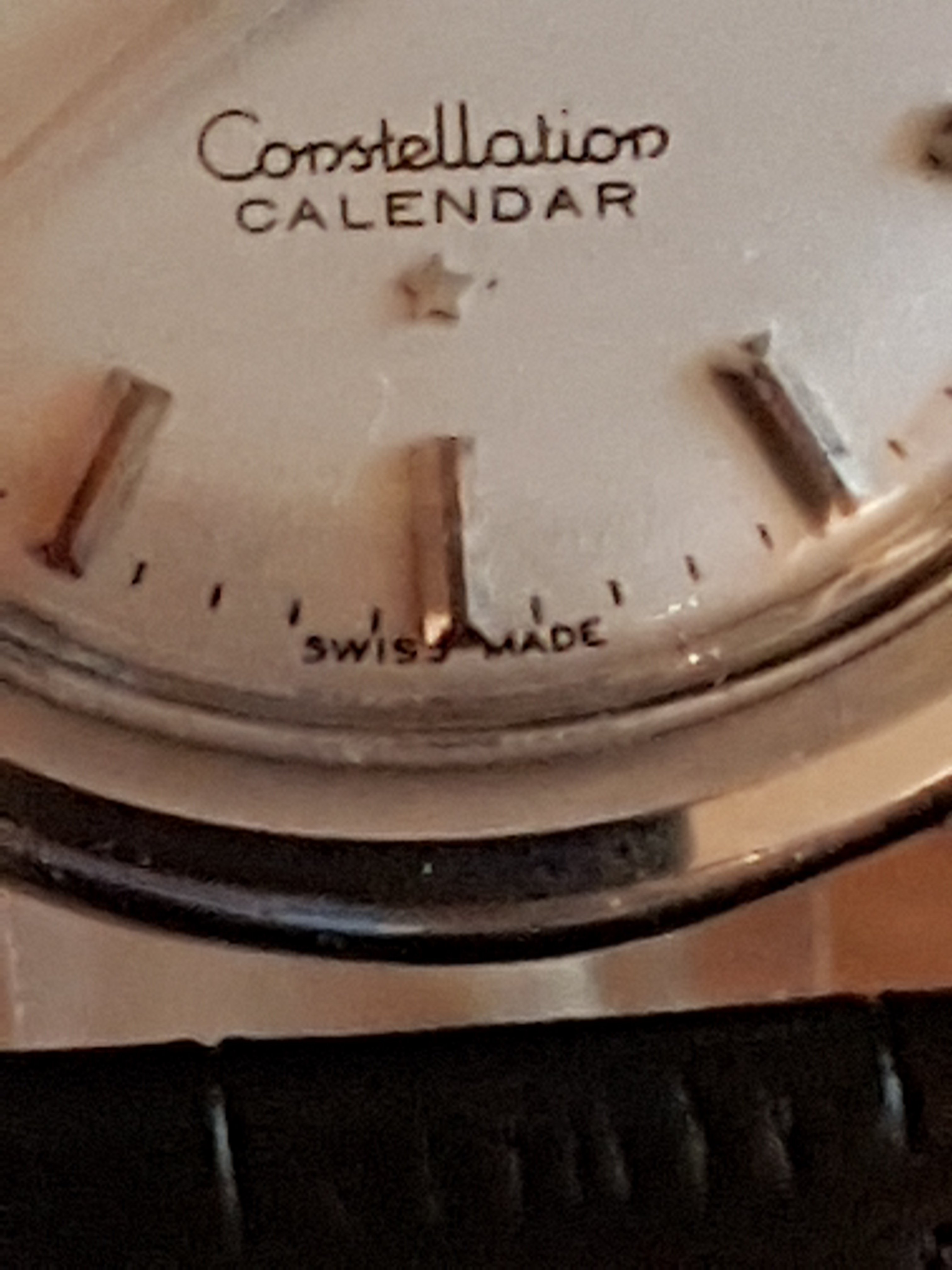

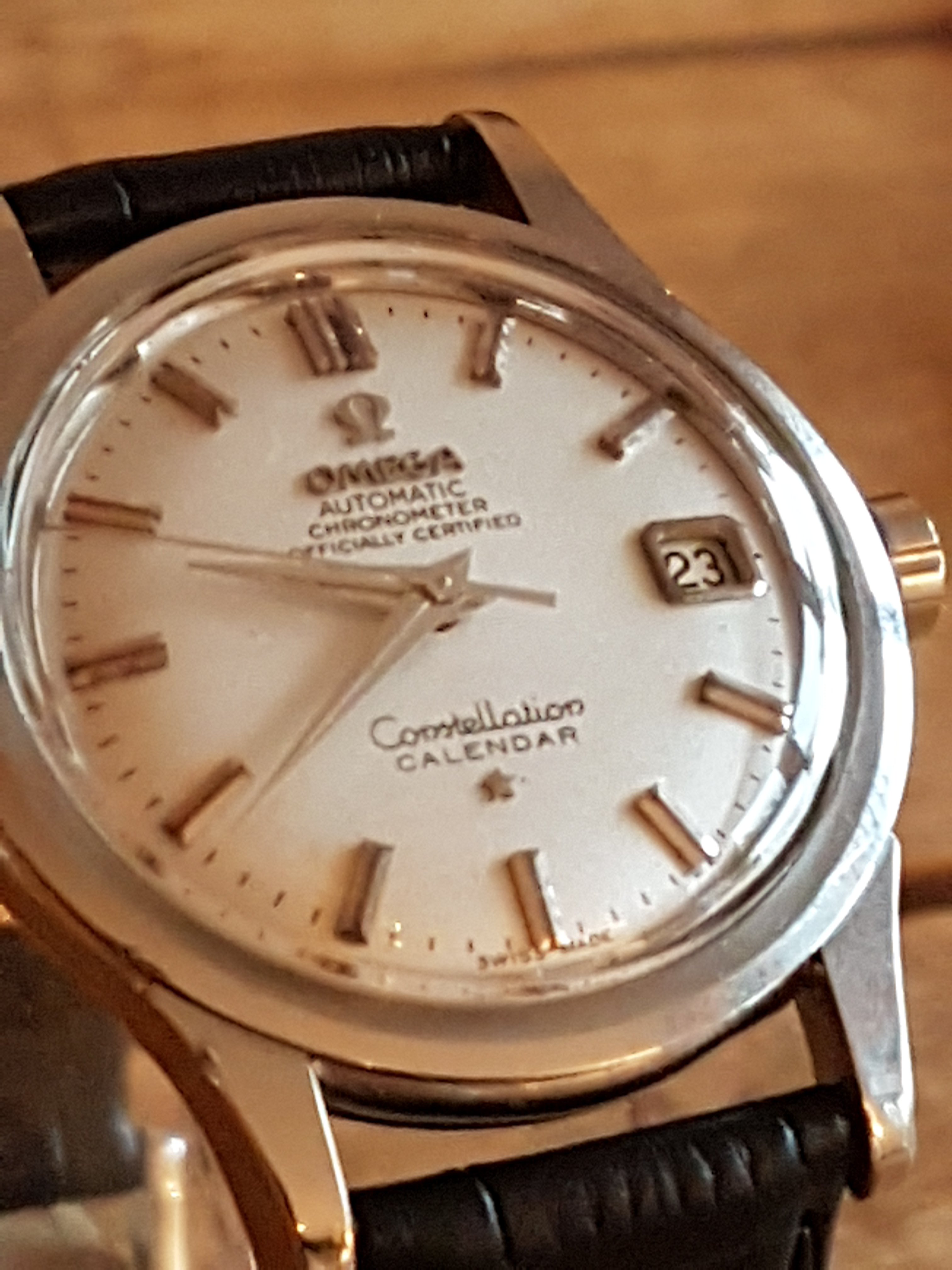

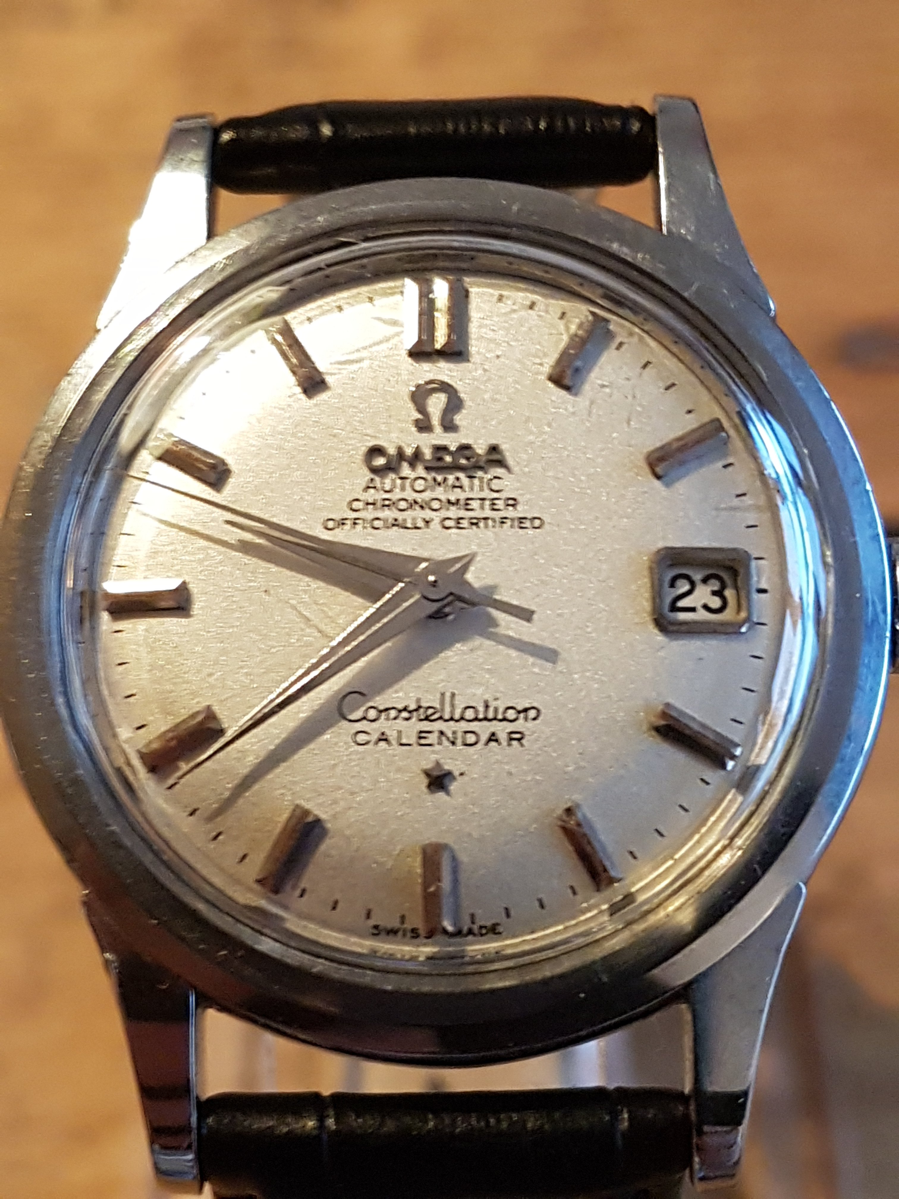

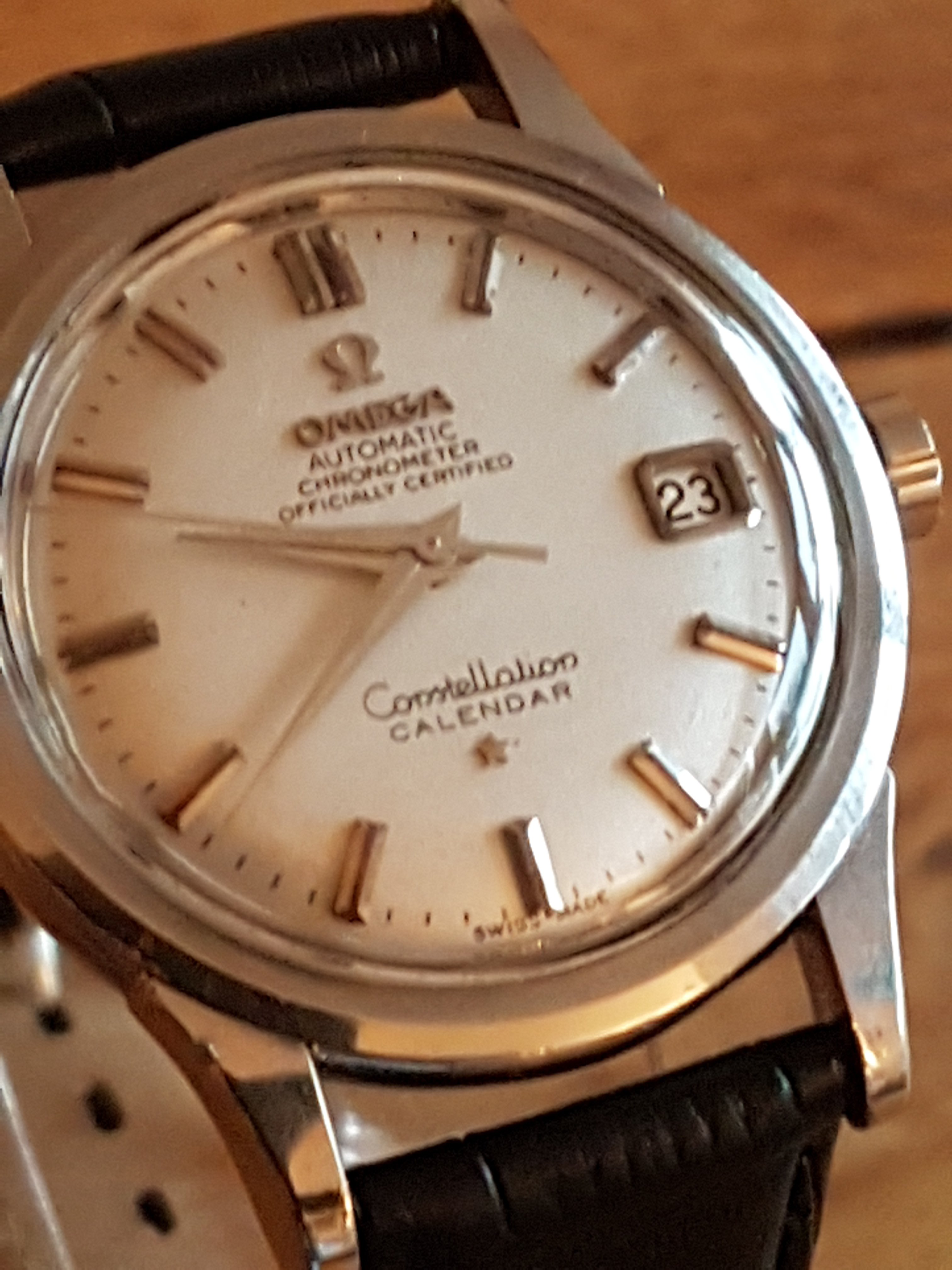

  11. Shabbaz Nov 16, 2017
    4,900
    17,865
    Here comes the pain!
    20171116_085038.jpg 20171116_085124.jpg 20171116_085211.jpg 20171116_085417.jpg 20171116_085355.jpg 20171116_084916.jpg

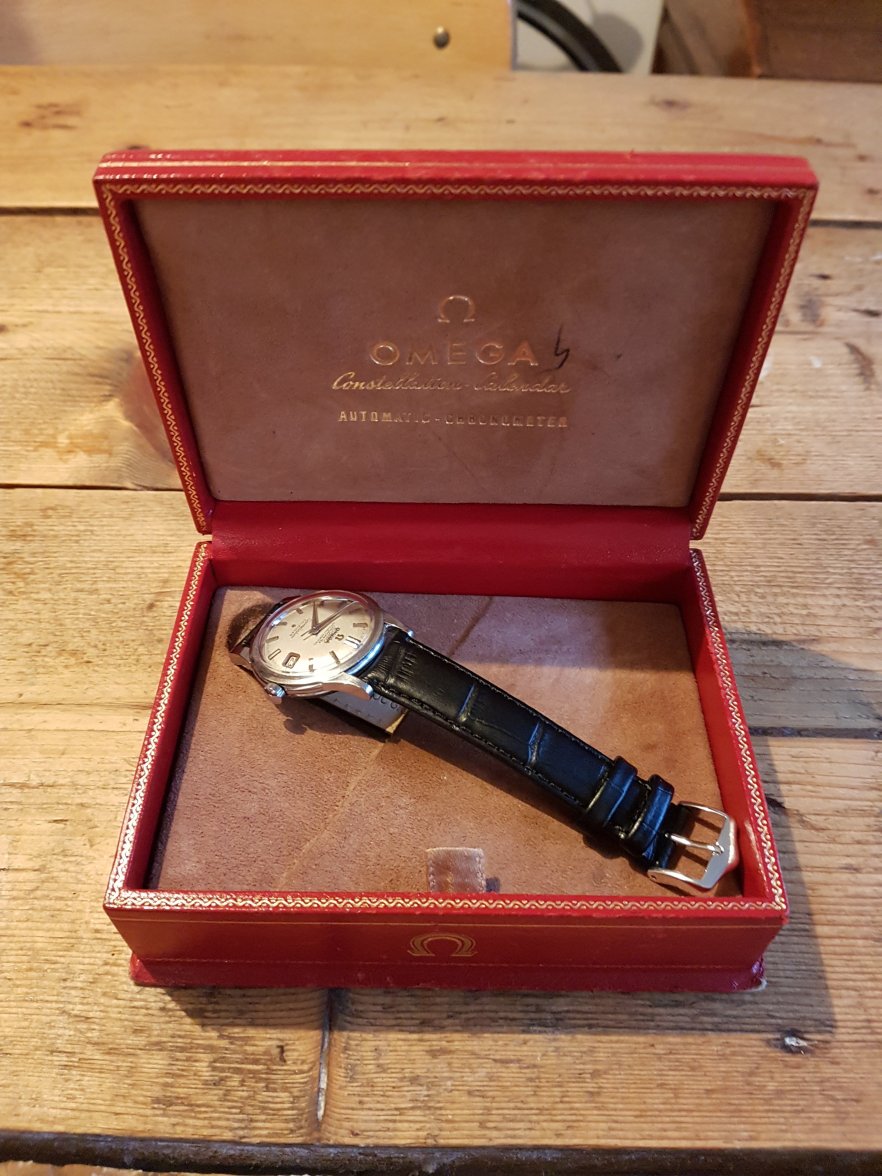

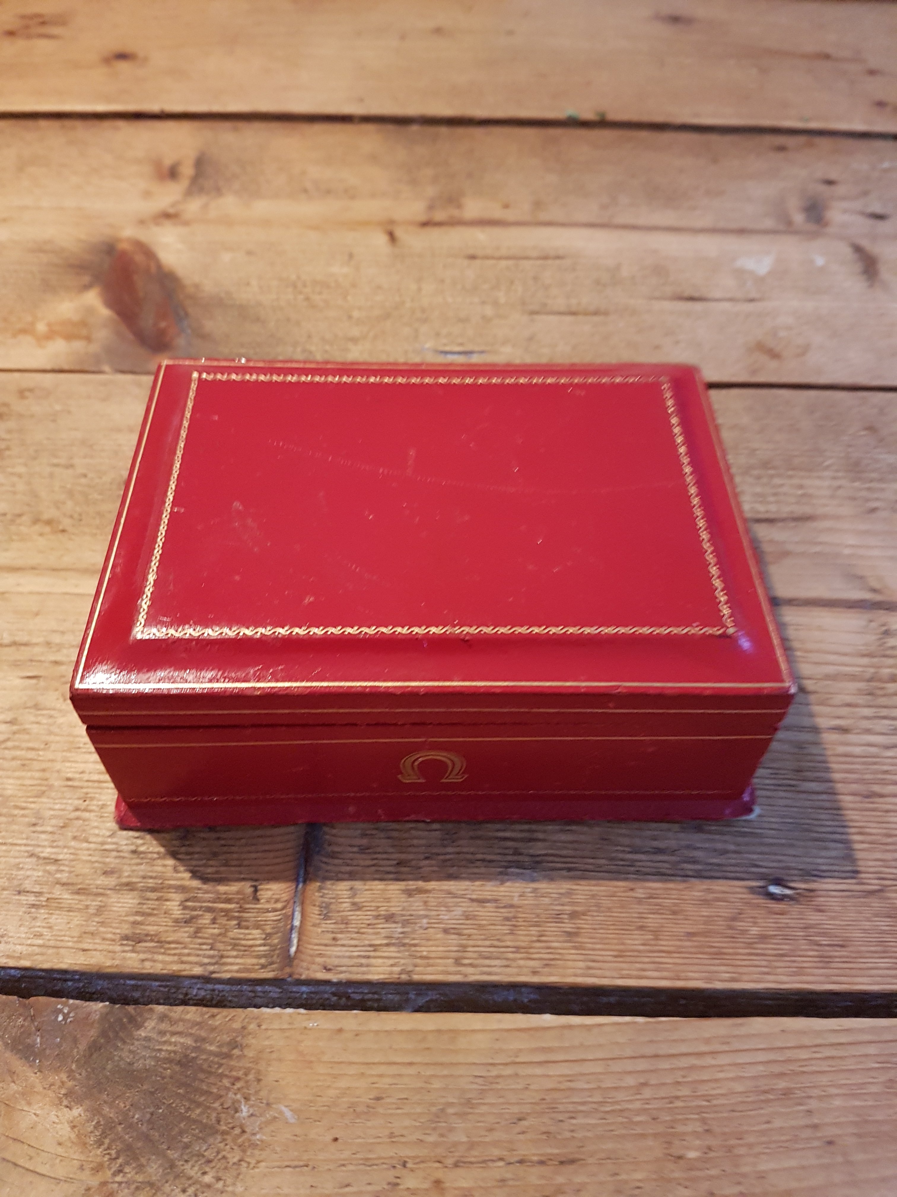

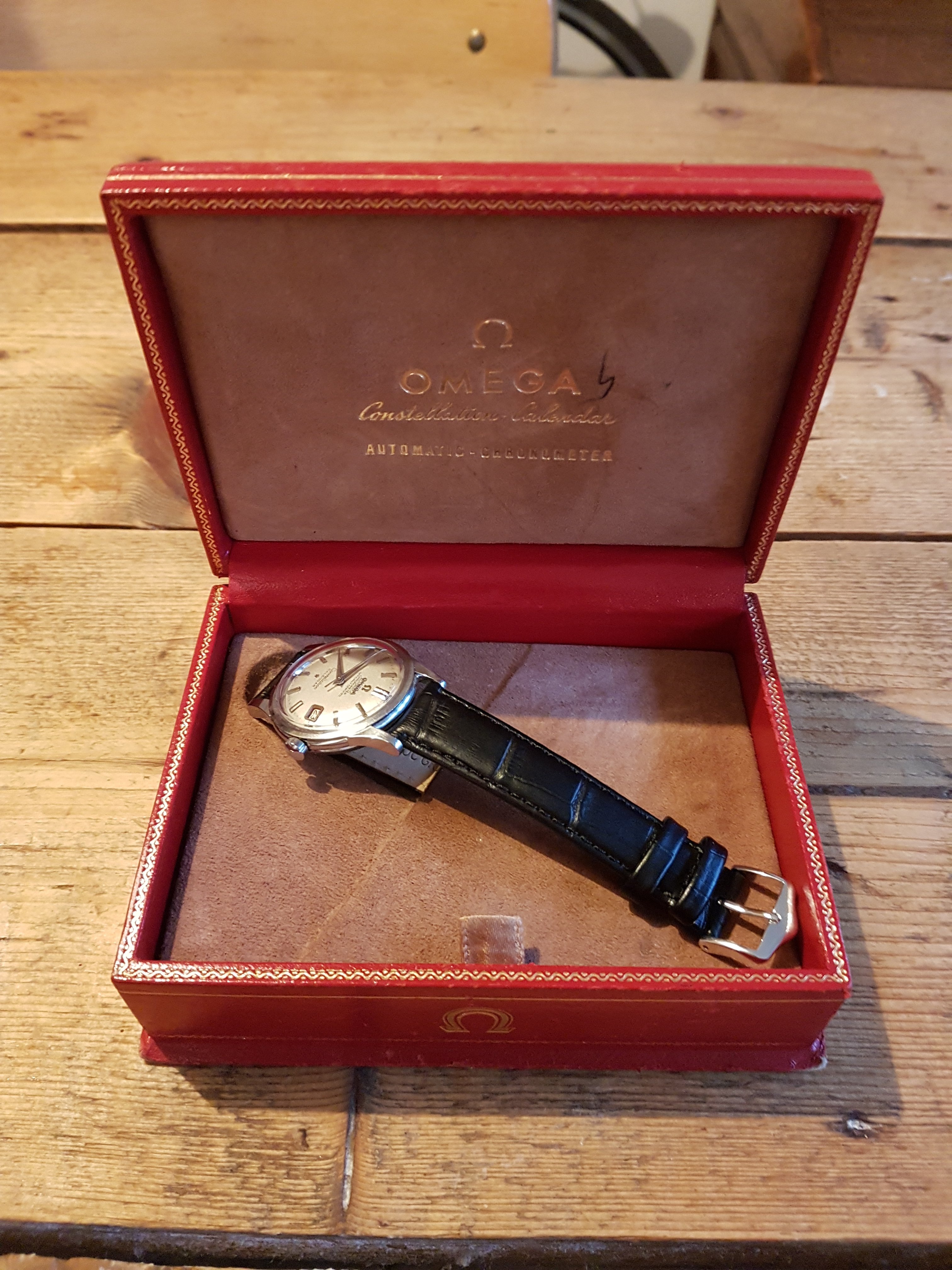

  12. Shabbaz Nov 16, 2017
    4,900
    17,865
    Box:

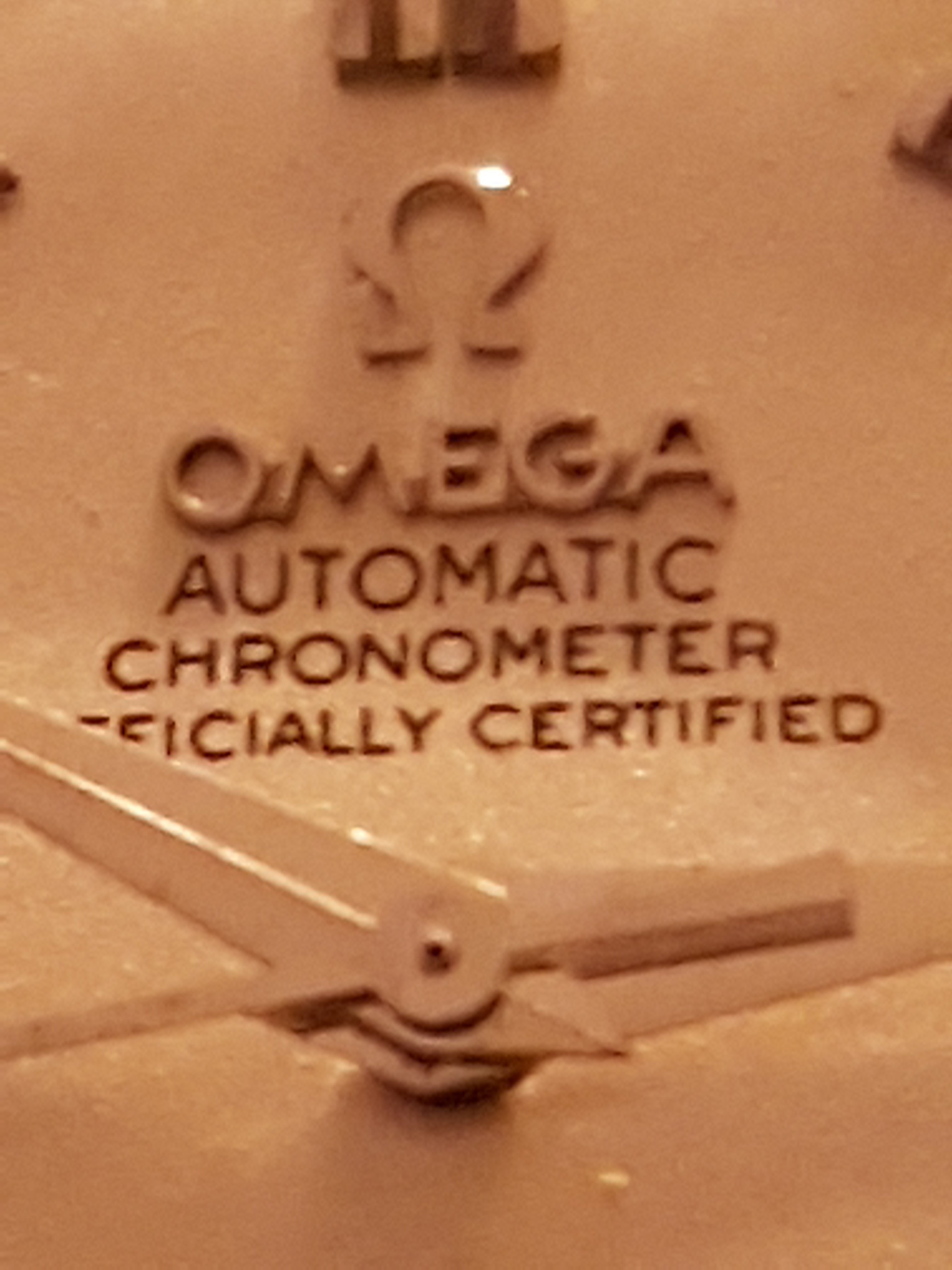

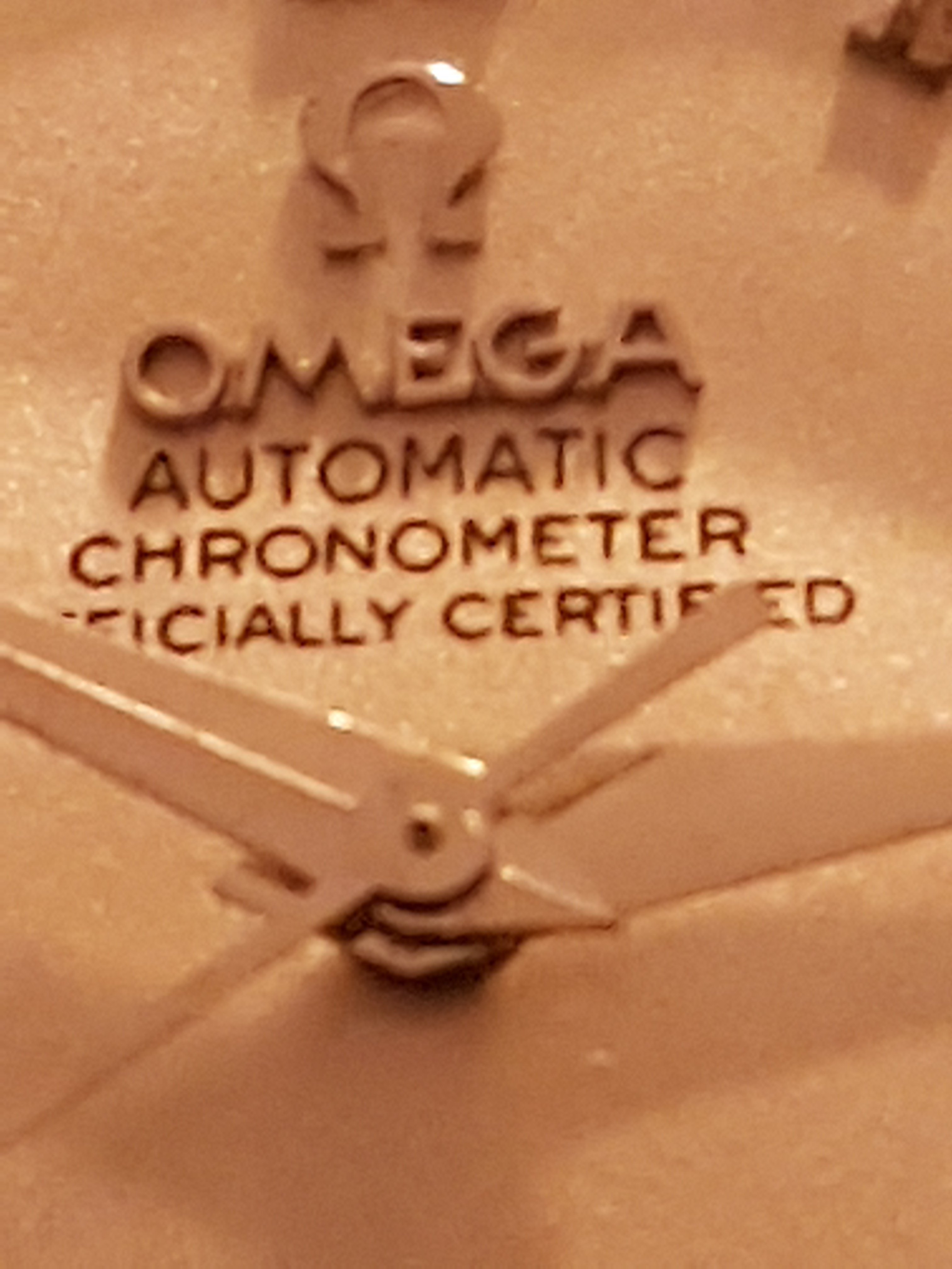

  13. Shabbaz Nov 16, 2017
    4,900
    17,865
    Dont you think the lettering of AUTOMATIC is to big?
  14. tdn-dk Nov 16, 2017
    1,717
    14,548
    Omega will never put an index over the text SWISS MADE so its a redone imho
  15. Passover Nov 16, 2017
    1,854
    2,528
    Hi, I nearly bought this one three weeks ago but got suspicious.
    Seller made an honest impression but was "not able" to post better pictures for obscure reasons when I contacted him. No movement pictures at all in the listing.
    I spent some time looking at the dial and comparing it and came to the conlusion
    that it is definetly a redial. "Calendar" is far to large, A of Automatic isn't boxed at all,
    fails MOY, "M" in Automatic is wrong ....
    Redial IMO, sorry Shabbaz
    I hope the seller is an honest man but I'm not shure about that :-(

  16. Shabbaz Nov 16, 2017
    4,900
    17,865
    That's interesting. Smart move by the way. I should have done the same (unless somebody has some good arguments why this 2943 is good). This is the second time I got crashed and burned...
    Well... A lot of dials in the Asian part of the world had problems with moisture, etc., because of the climate. So redial in that perspective is not strange. But the father claims that under him the dial was not replaced. Hmmmm.
