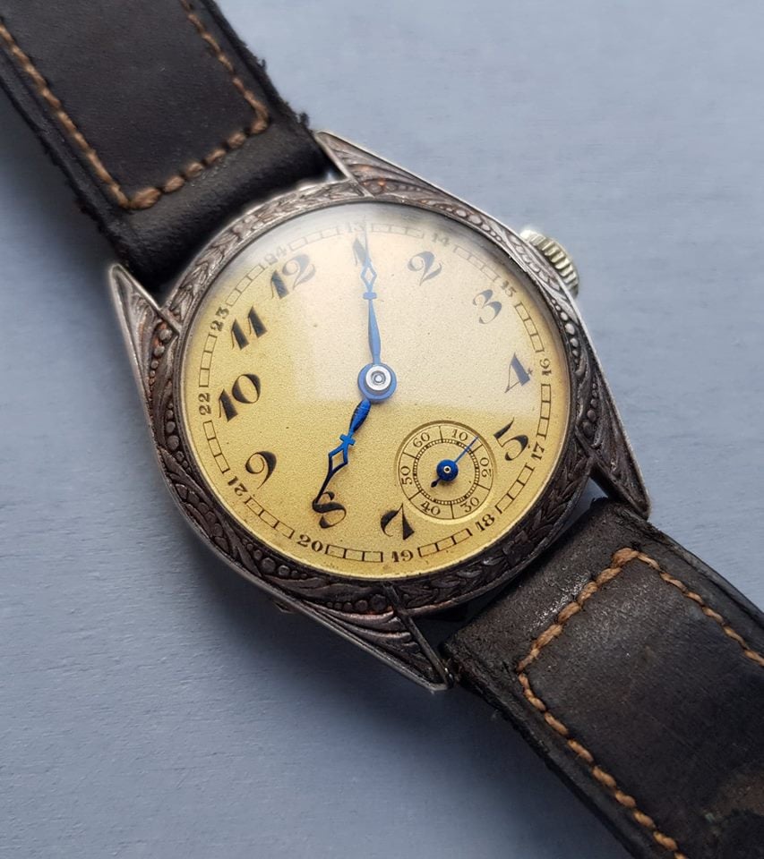

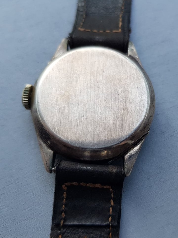

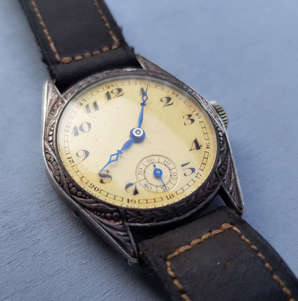

I picked this up at a flea market today.
I dont know much about, and are counting on you guys.

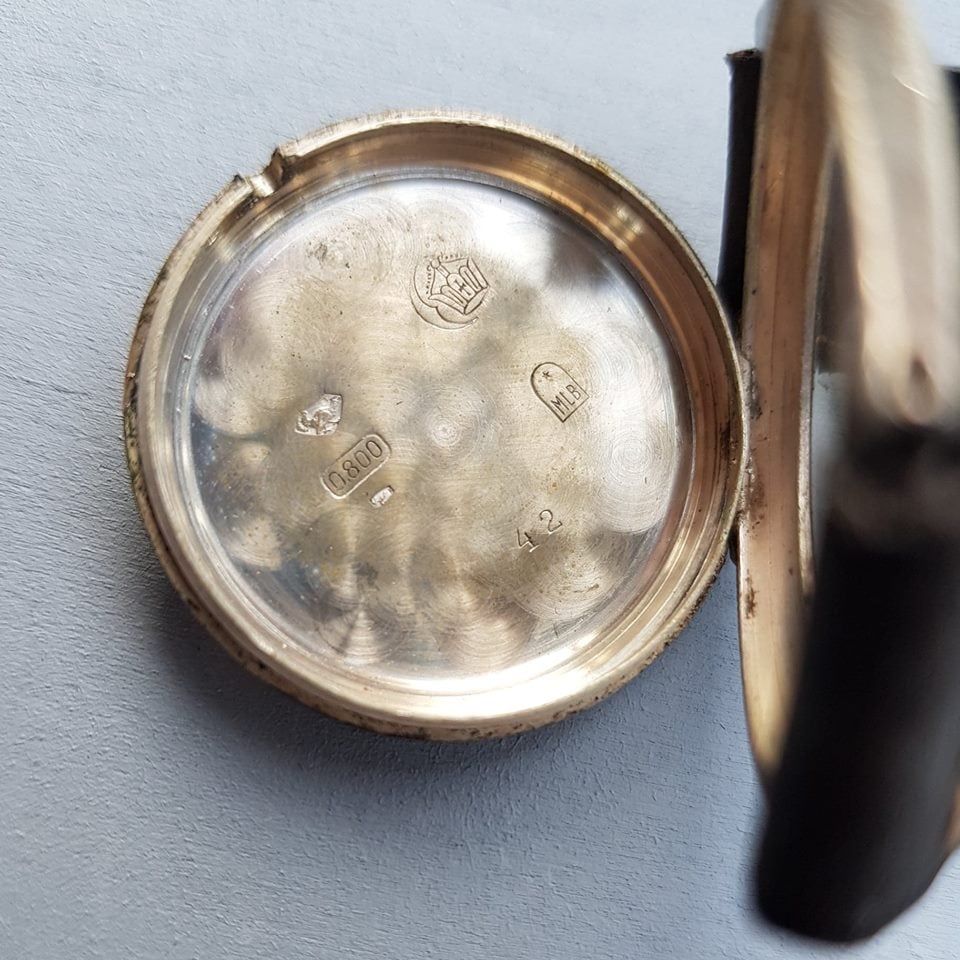

As seen from the photos all the hallmarks are swiss and other than the "MLB" in the caseback the watch is unmarked.
The case is ca. 32mm and Im guessing the engraving isnt original to the watch?

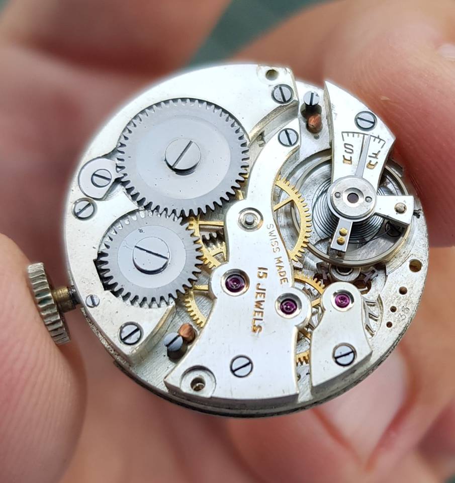

There is a number on the movement (30-something?) but it doesnt tell me much.
Thats about all I know.

Mikrolisk indicates that the manufacture of the case was Maeder-Leschot SA. It also gives a date of 1927 for the registration of the trademark. Though this information may be incomplete, it gives you a possible terminus post quem. By 1934 this responsibility mark would have been replaced by more standardised Poin莽ons de Ma卯tre of a numbered hammer silhouette, so that gives you a terminus ante quem.
If there is no manufacturers' mark under the balance, there may well be one on the dial side of the movement.

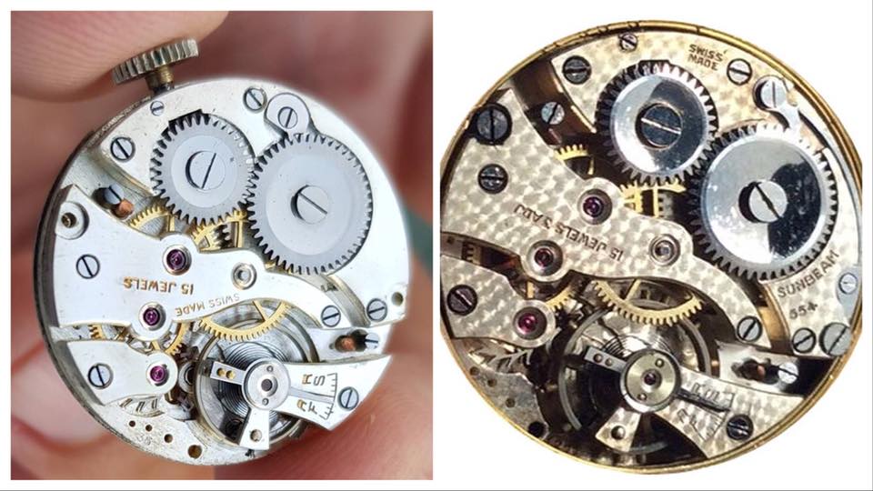

For those who are curious this is what I found:
- As already stated by @Fialetti the case was produced by Maeder-Leschot SA in the late 20s/ealry 30s.
- The movement looks to be a A. Schild 168-movement (see picture for comparison).
Thats about all i know 馃榾
