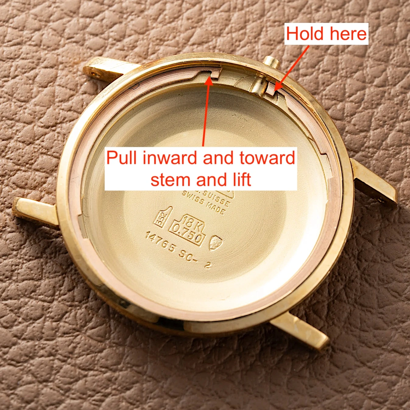

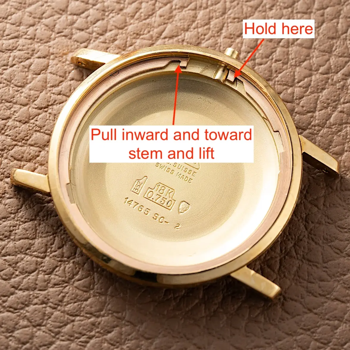

Posts 22 Likes 2 Plymouth ·2:19pm yesterday Hey guys, I am about to plop the case into the ultrasonic, I was wondering how I can separate the movement ring from the case? Thank you for your help in advance
Posts 17,992 Likes 37,590 JimInOz ·Today at 3:06am·Melbourne Australia I haven't done one of these, but just looking at it, this would be my approach. PS: Also moved to Watchmaking.
