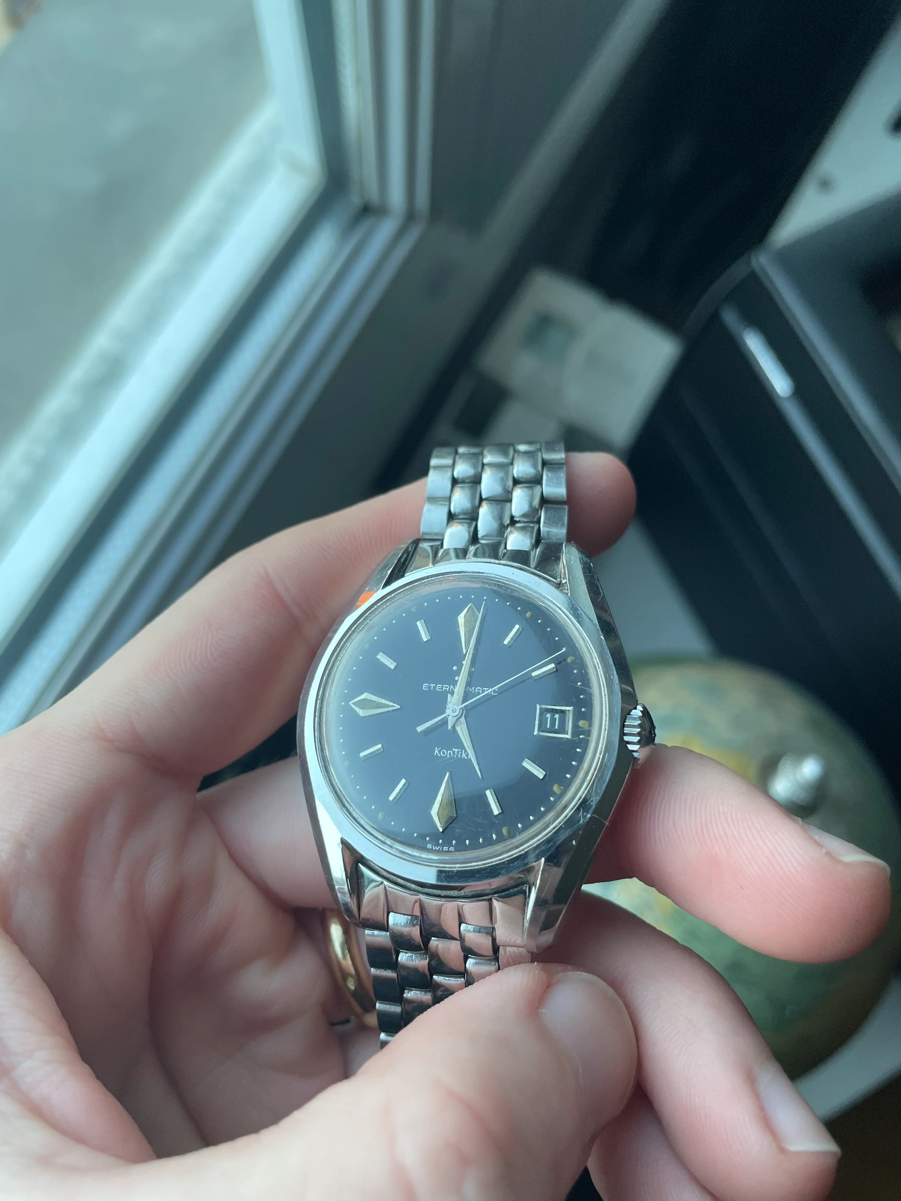

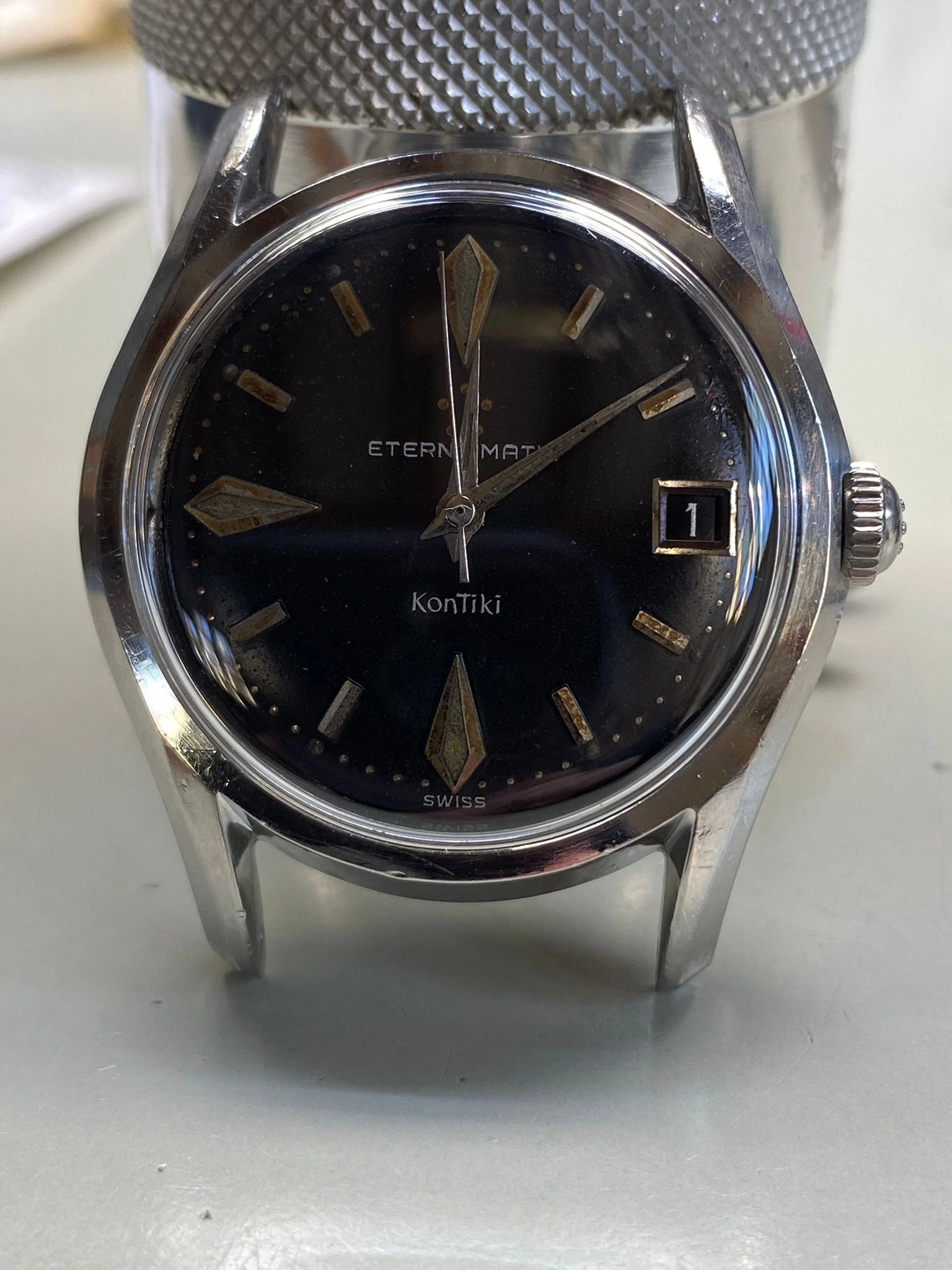

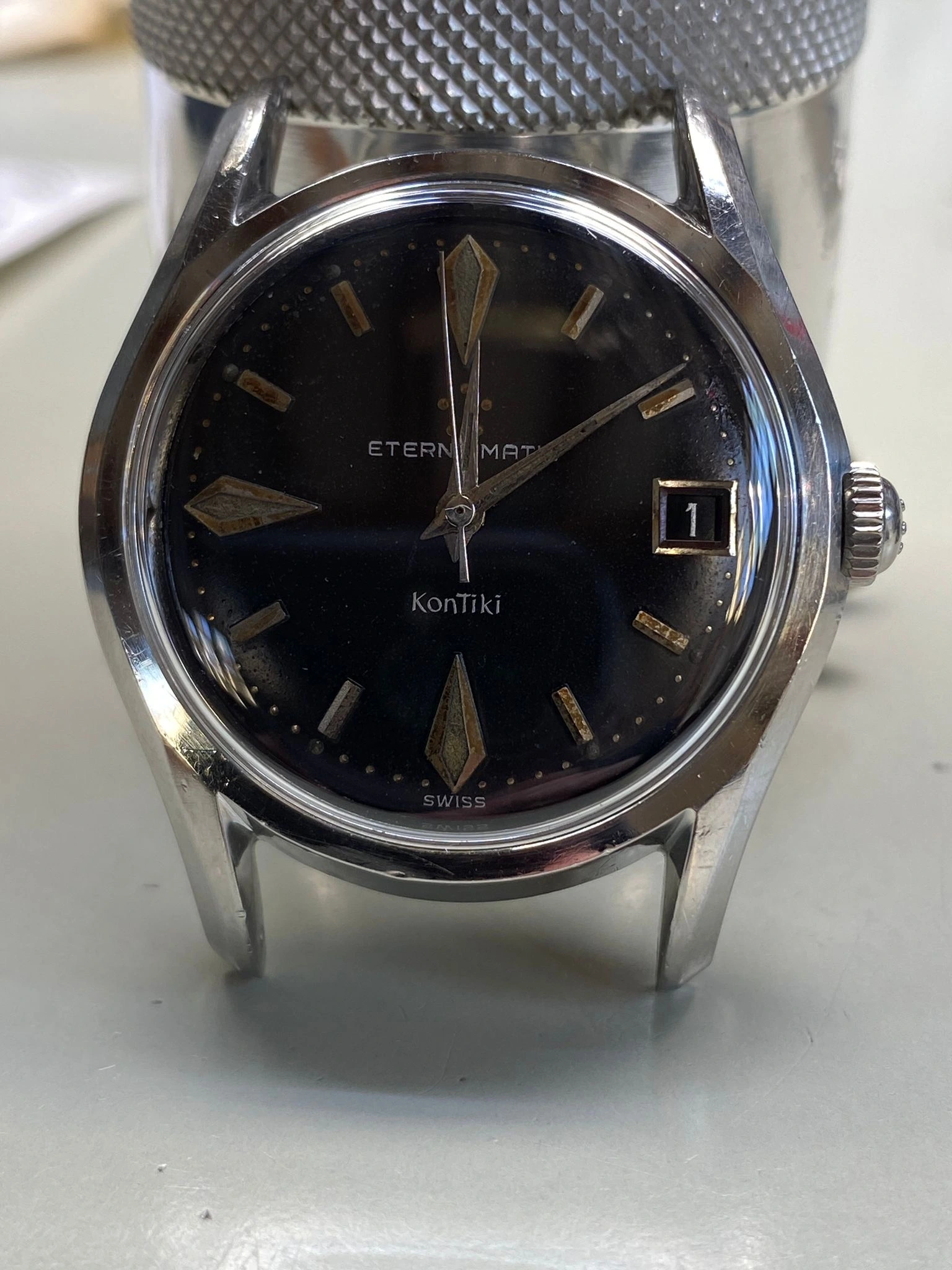

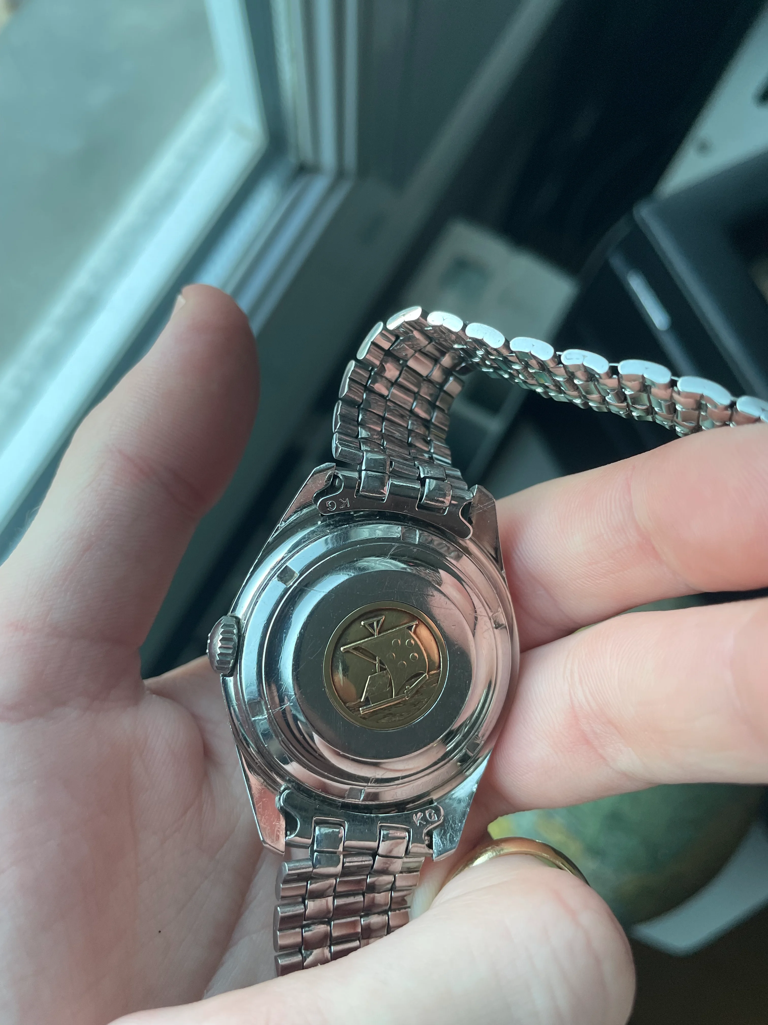

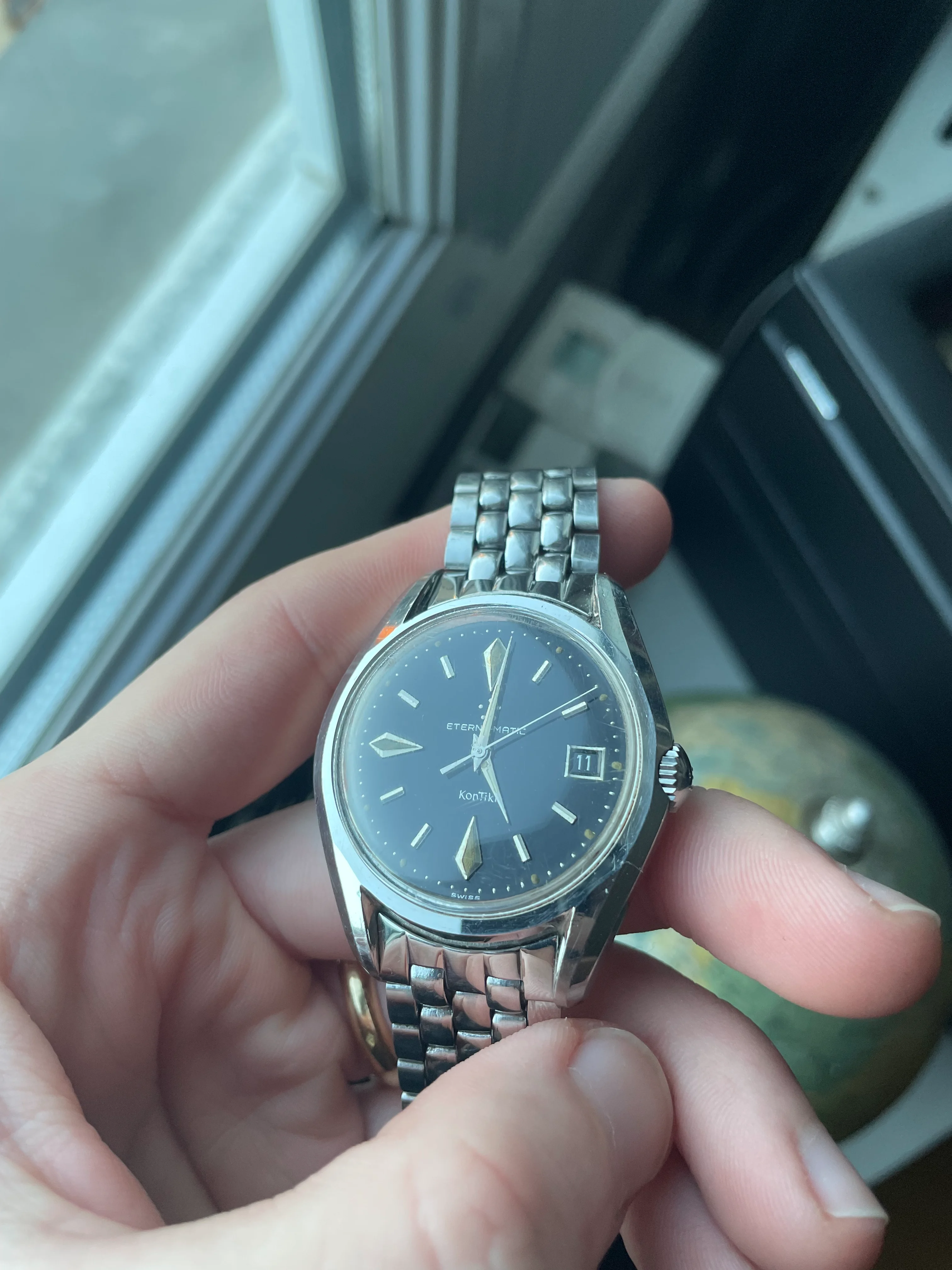

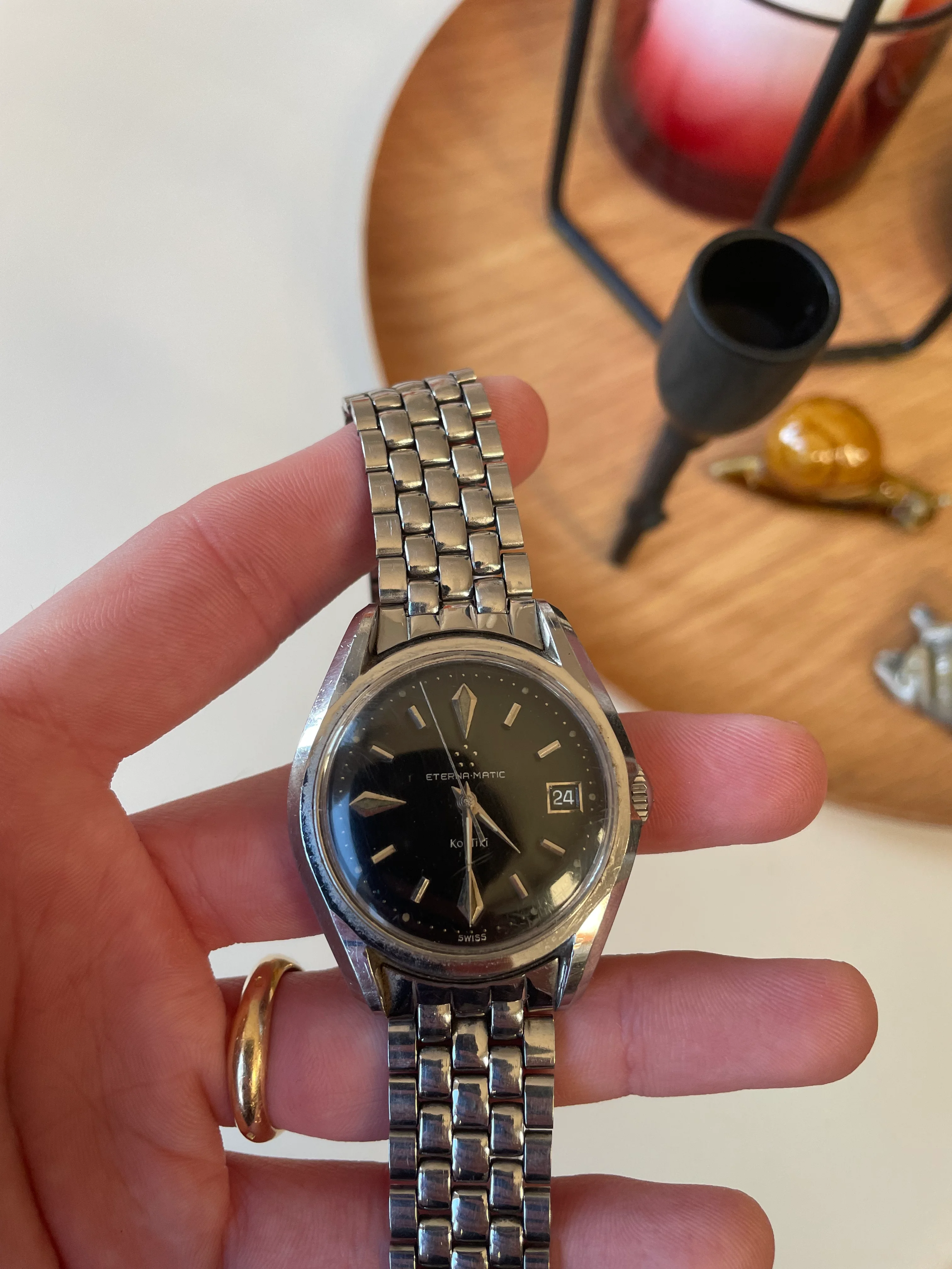

Hi all,
I recently bought this black dial Kontiki. I suppose that it came from the early 60' but I can't find the very same dial on internet. Do you have any infos (particularly the year) on this specific watch/dial?
Thank you very much by advance!

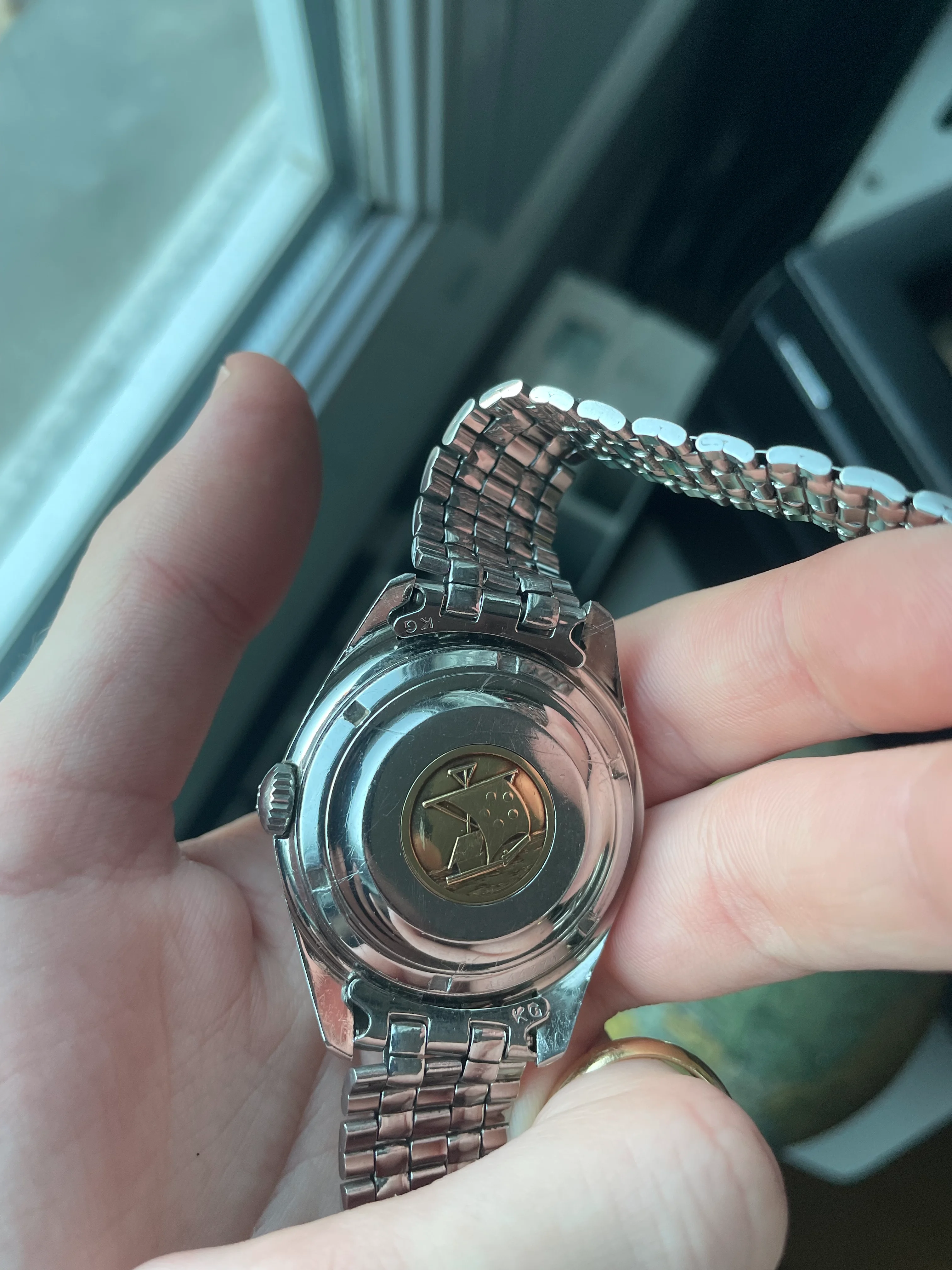

The production year could be estimated from the style, but we would need the case or movement serial number to give you a firm number. Look closely on the back.

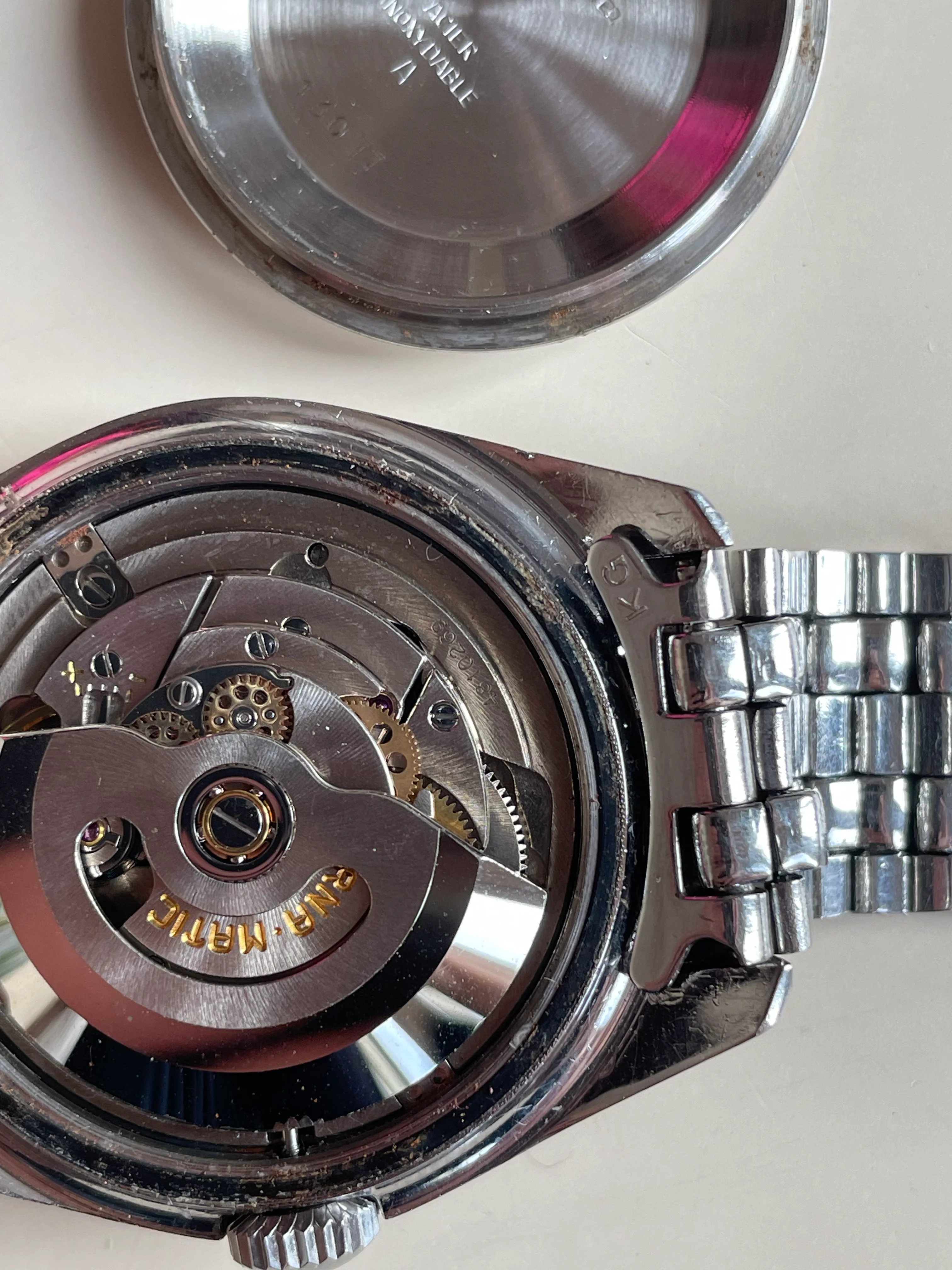

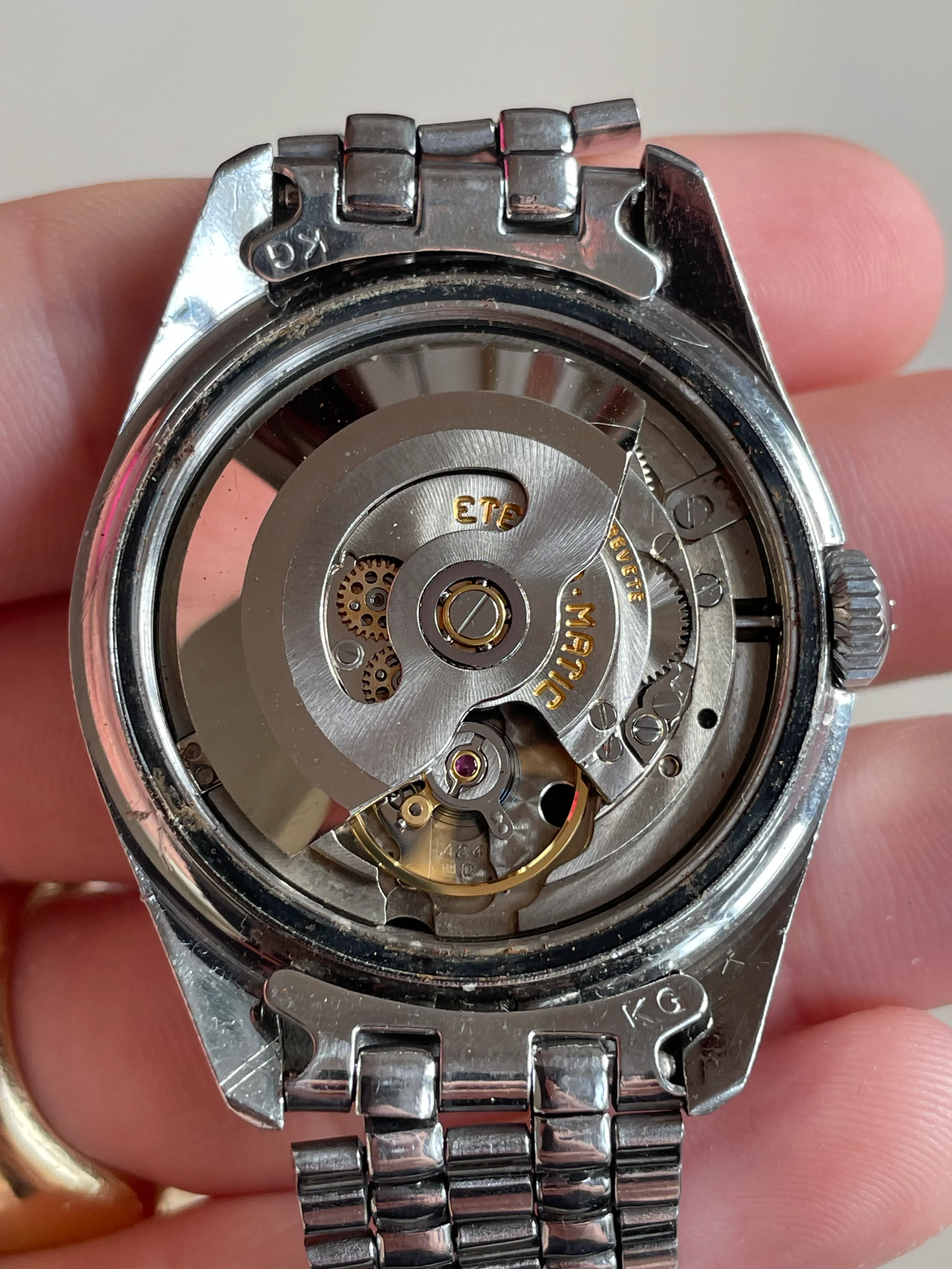

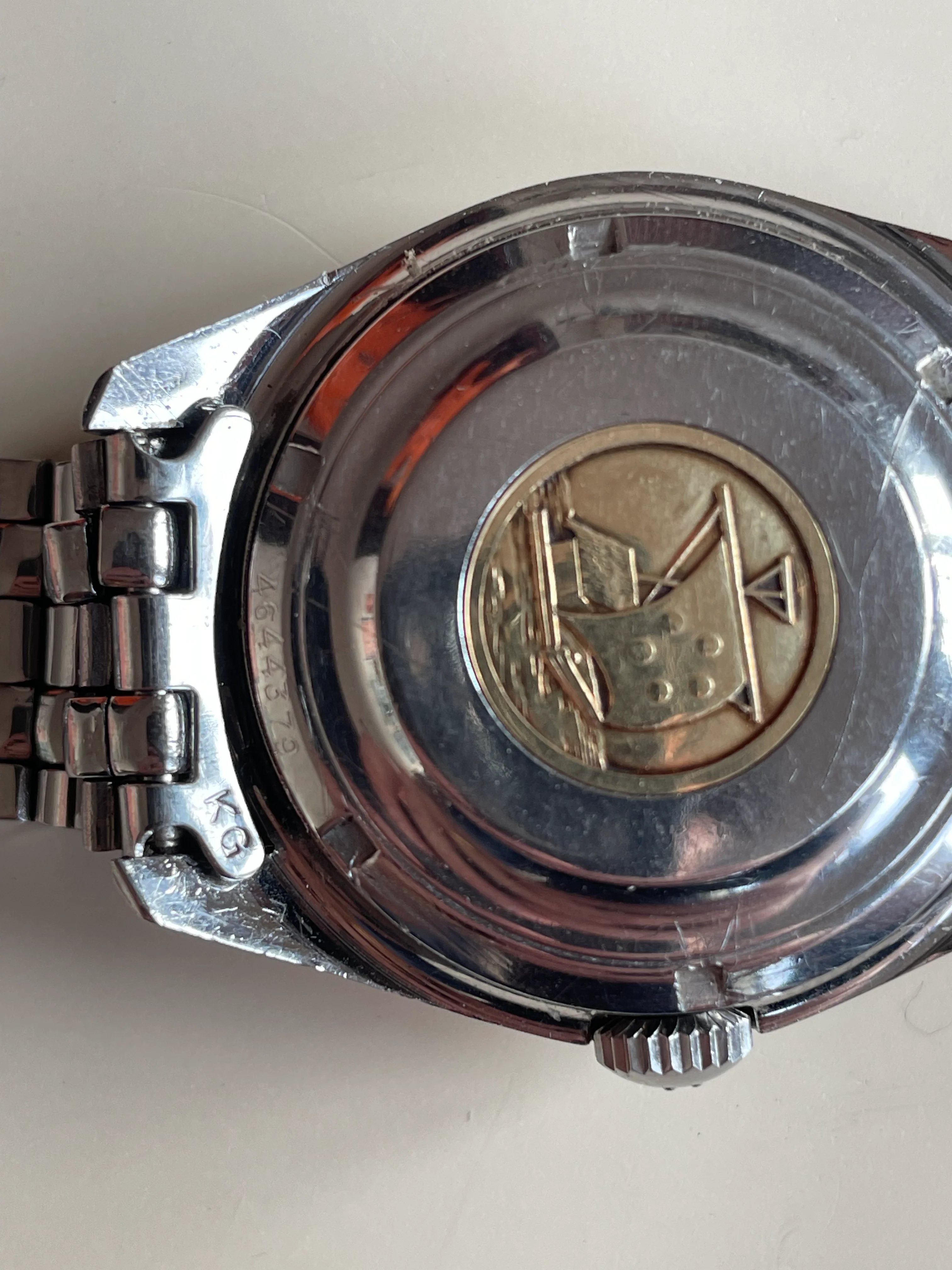

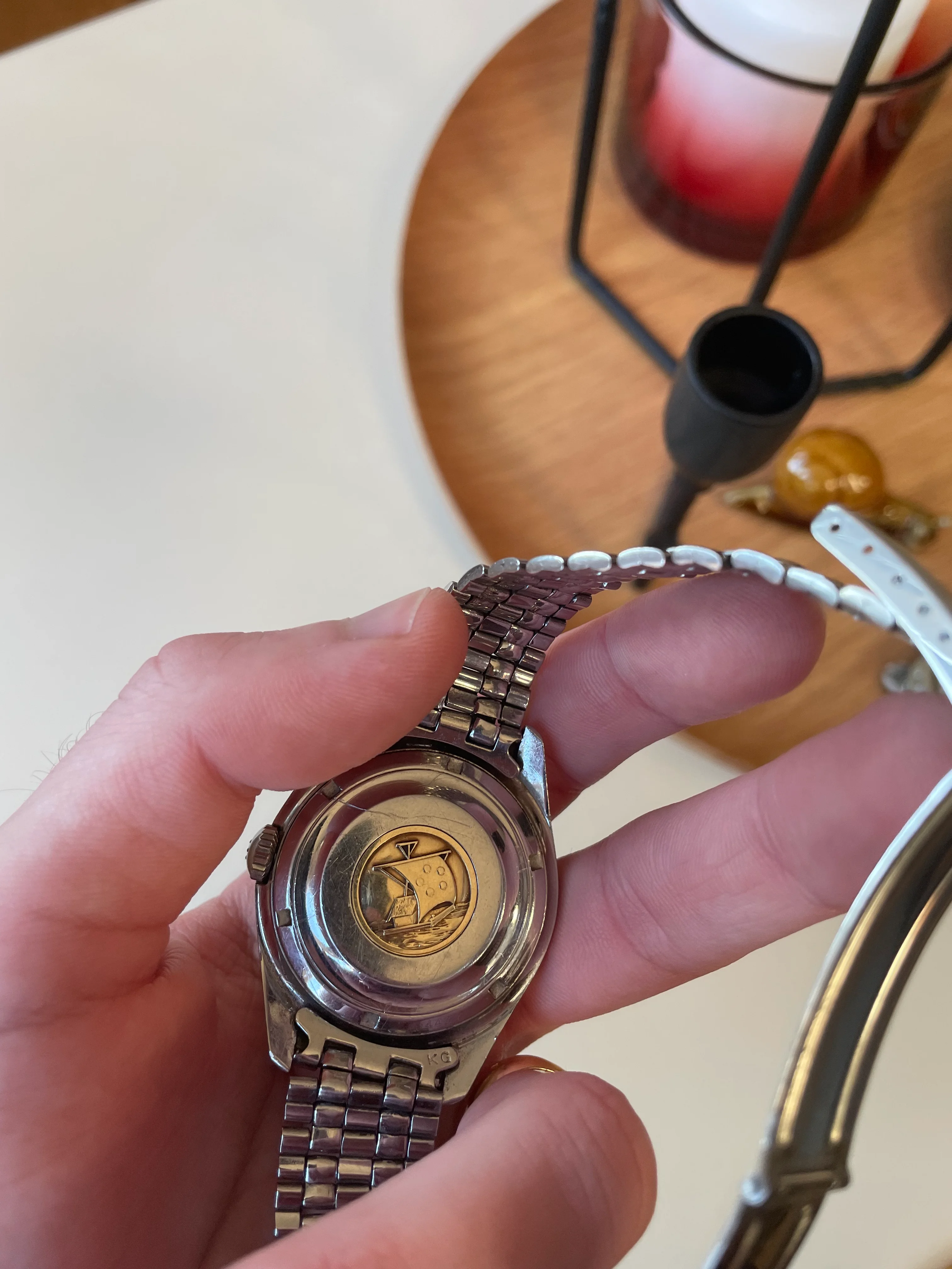

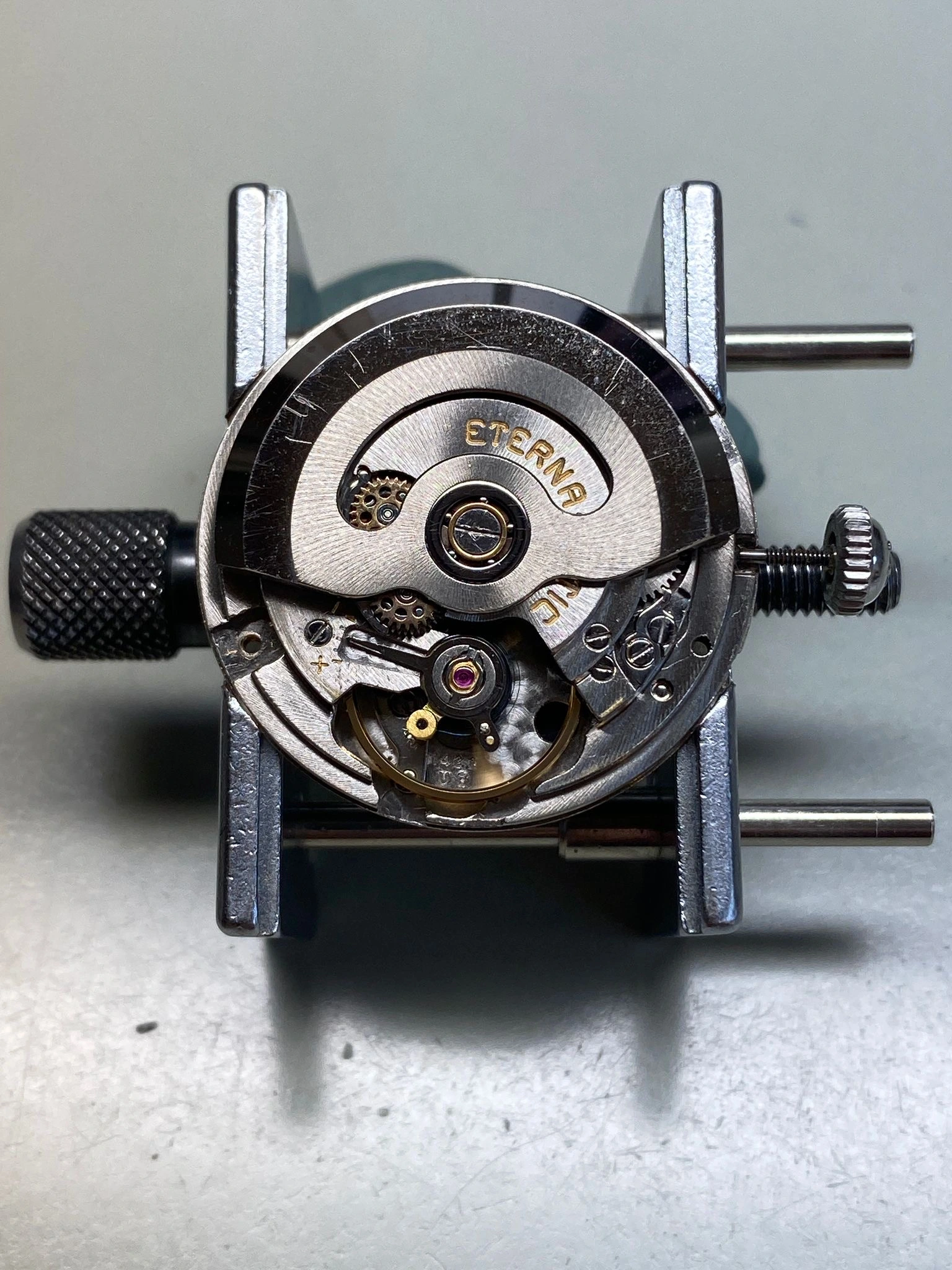

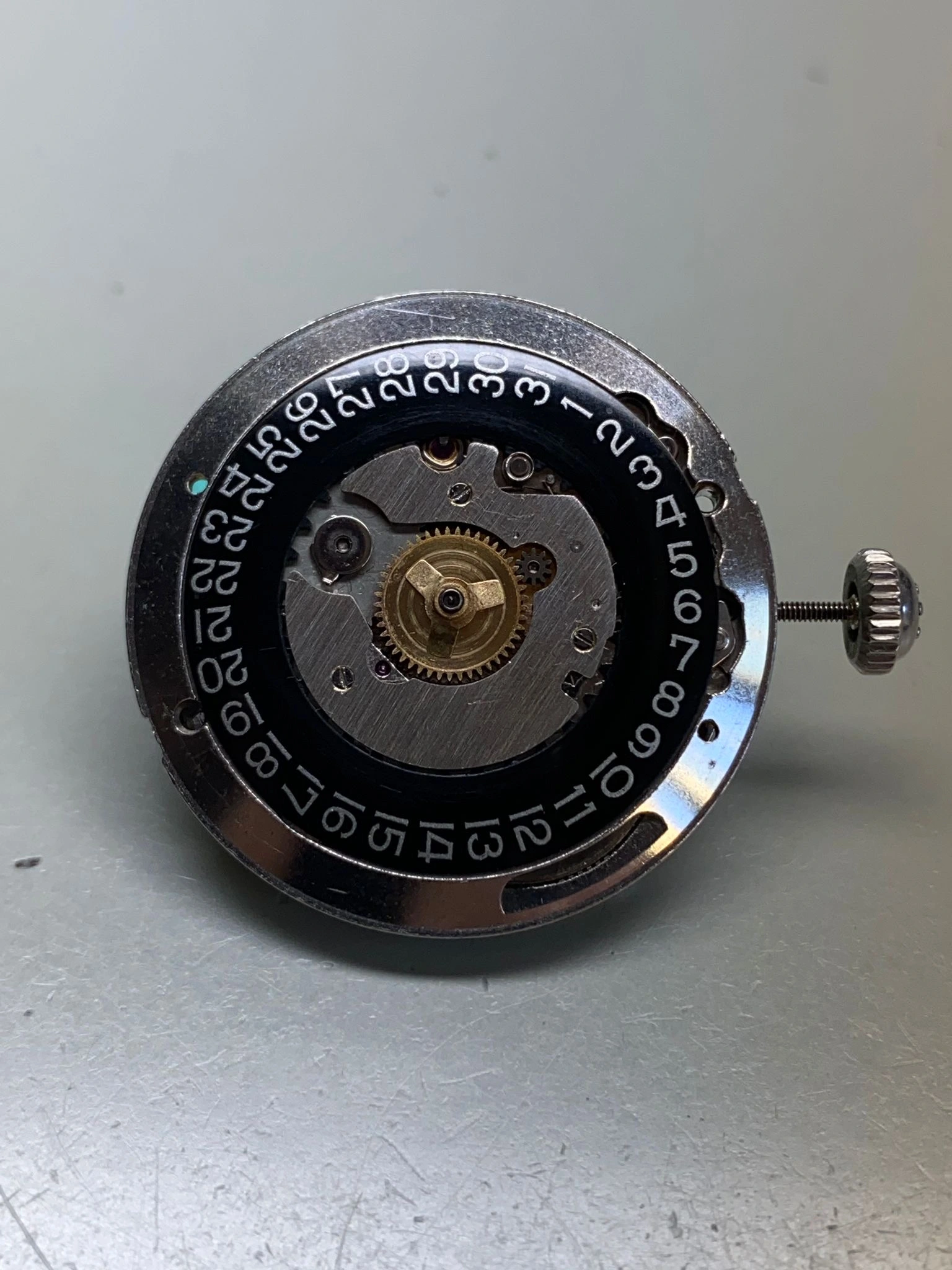

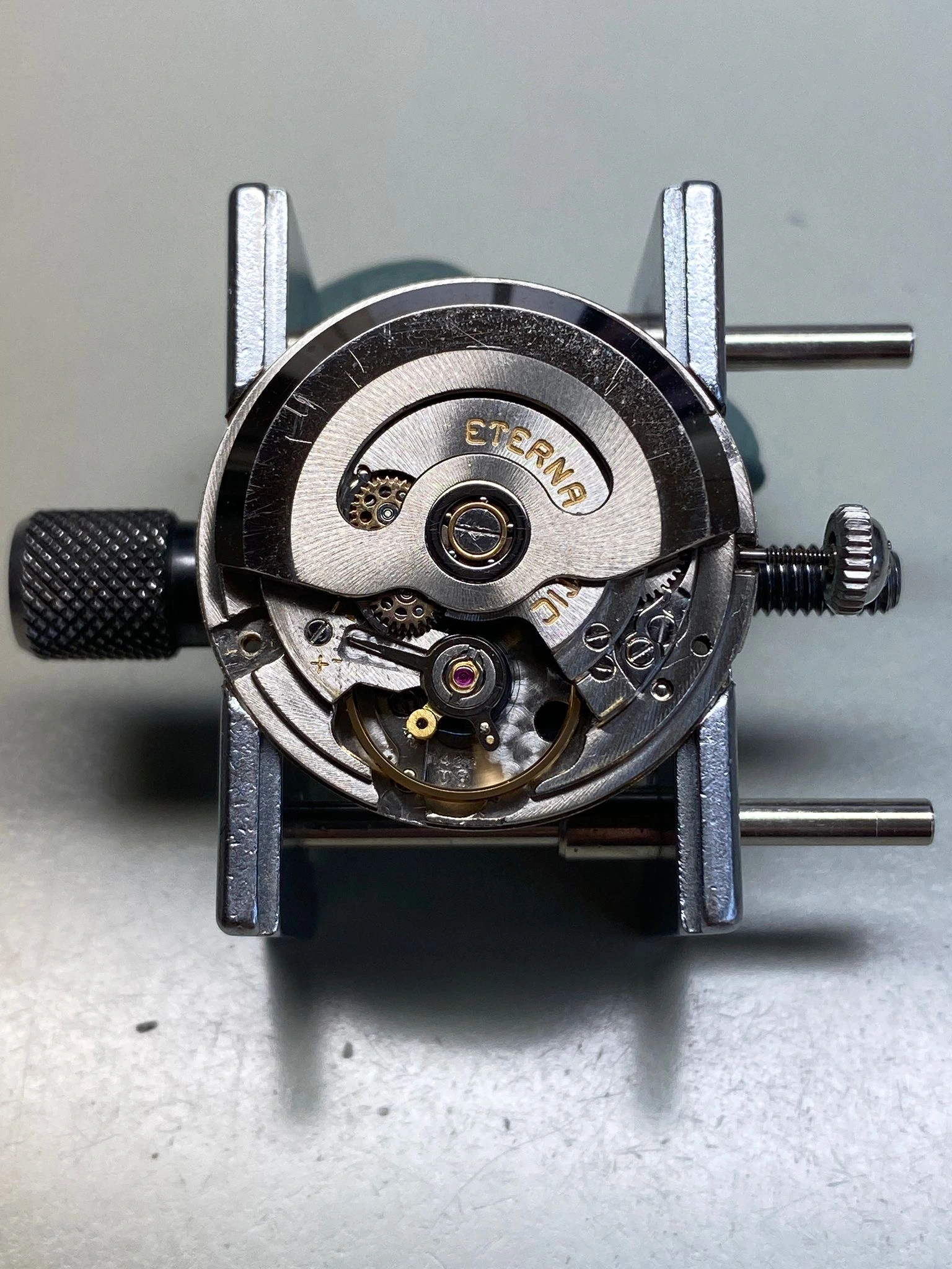

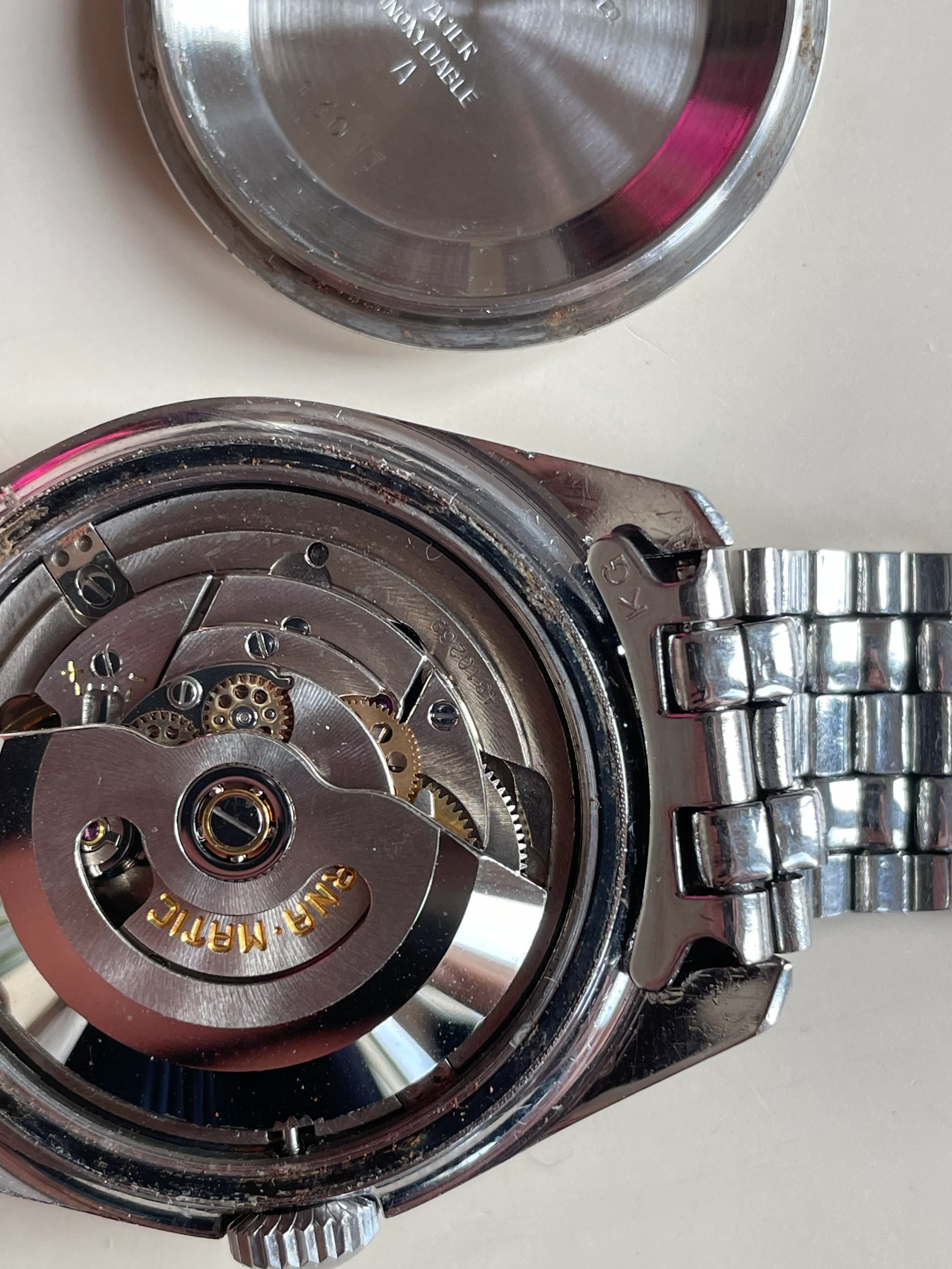

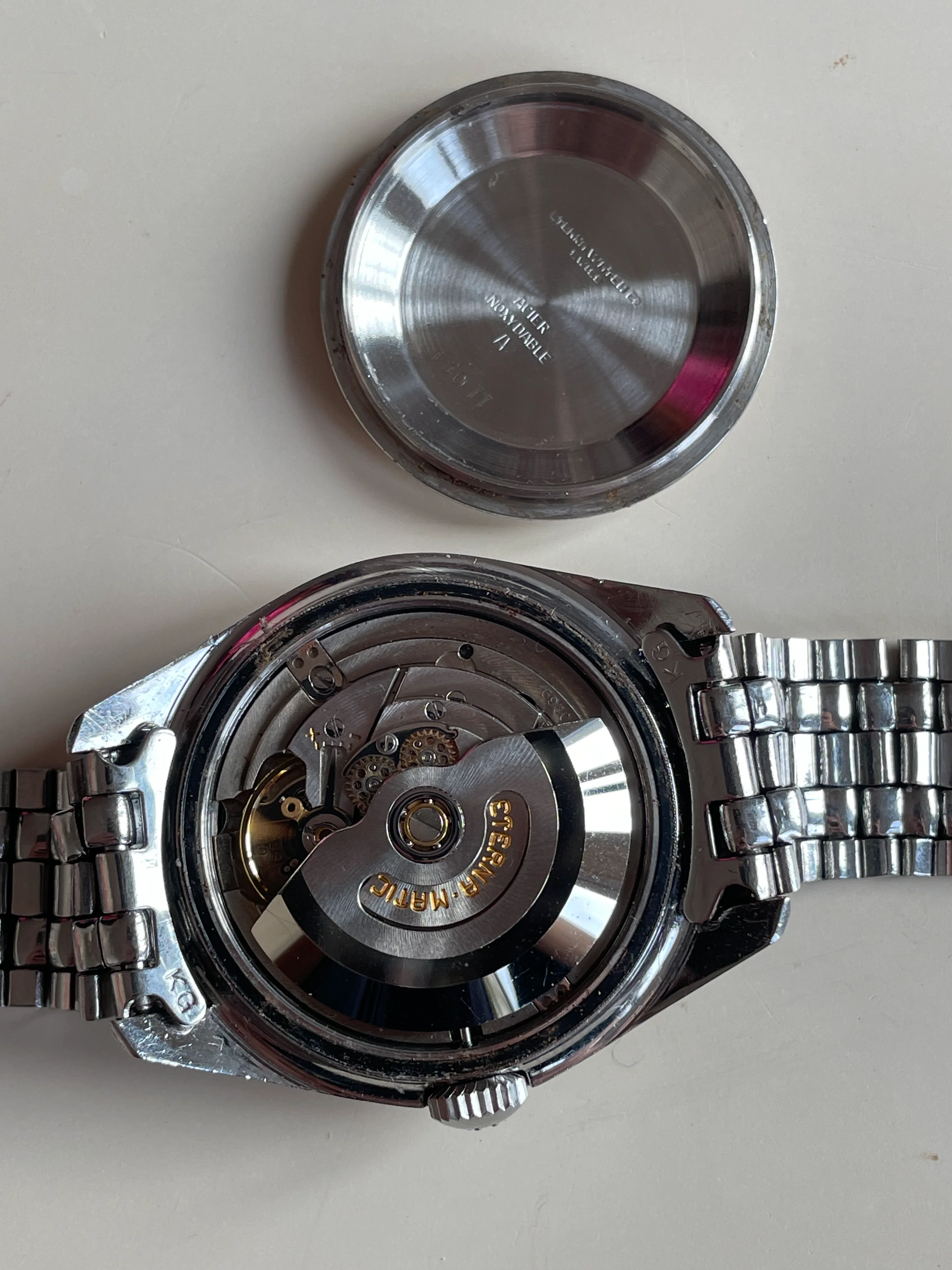

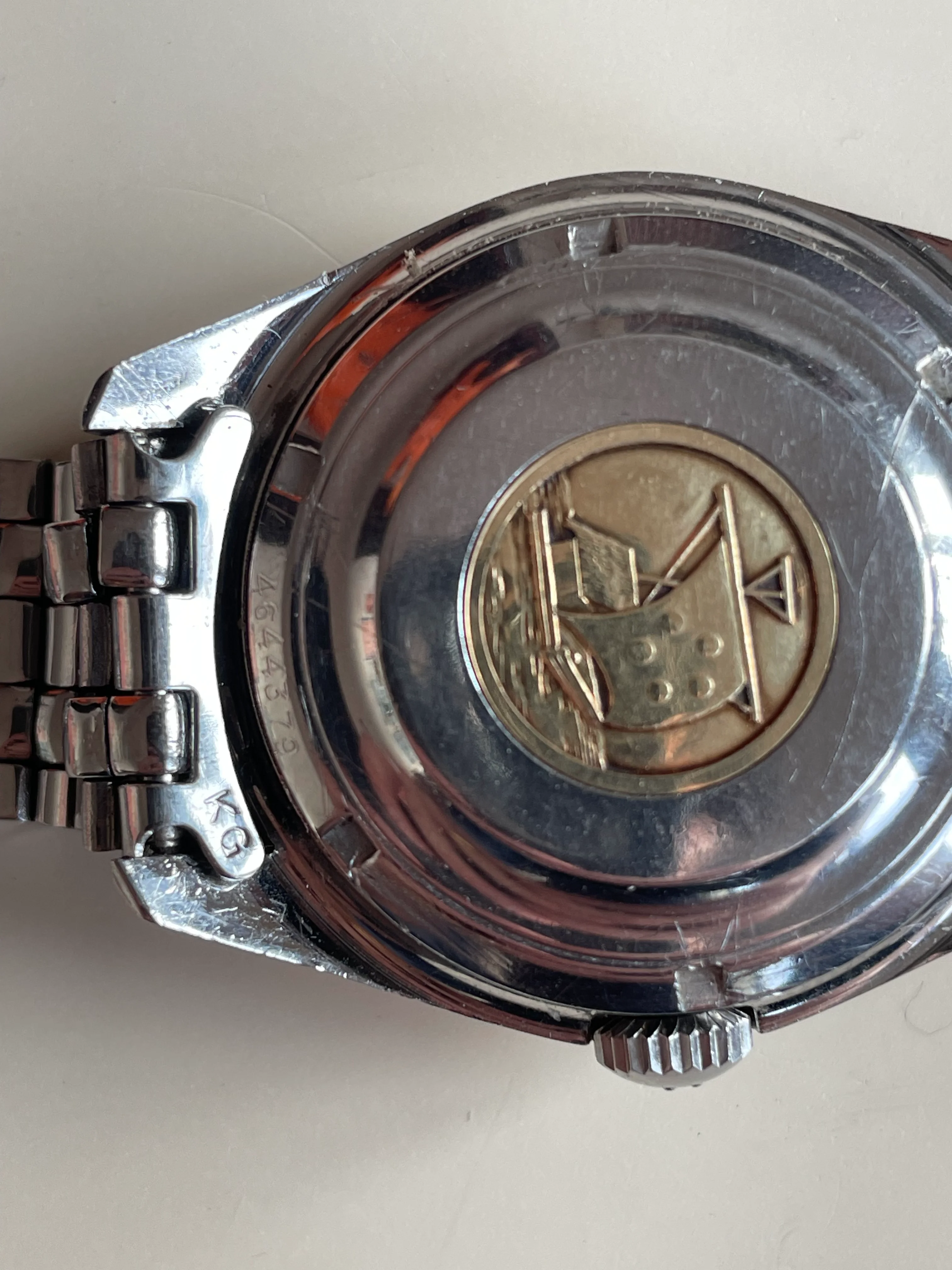

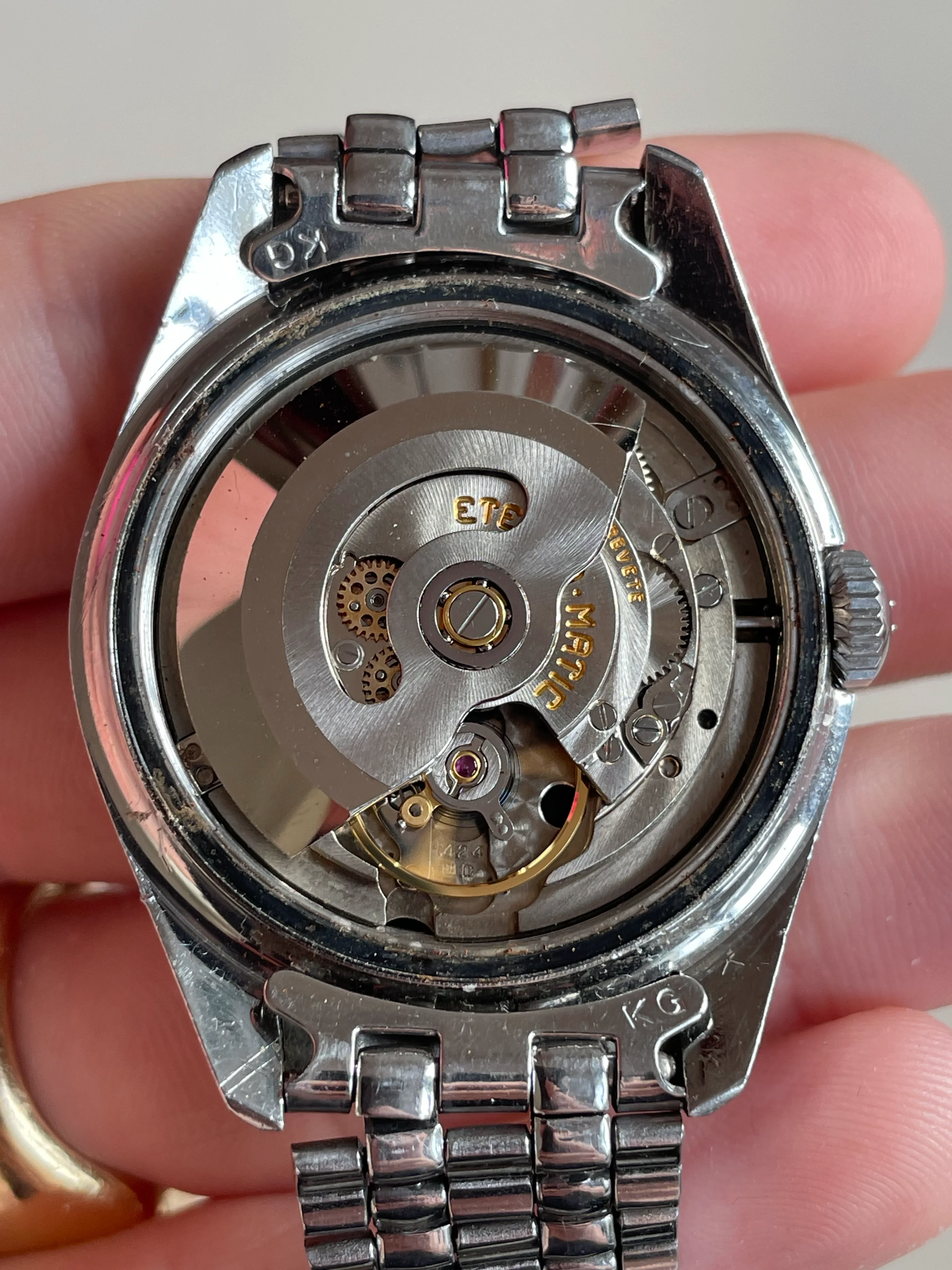

Thanks for your help, here are some pictures with the case and movement serial number.
4,358
12,881
According to the Schild database it was produced in 1963.

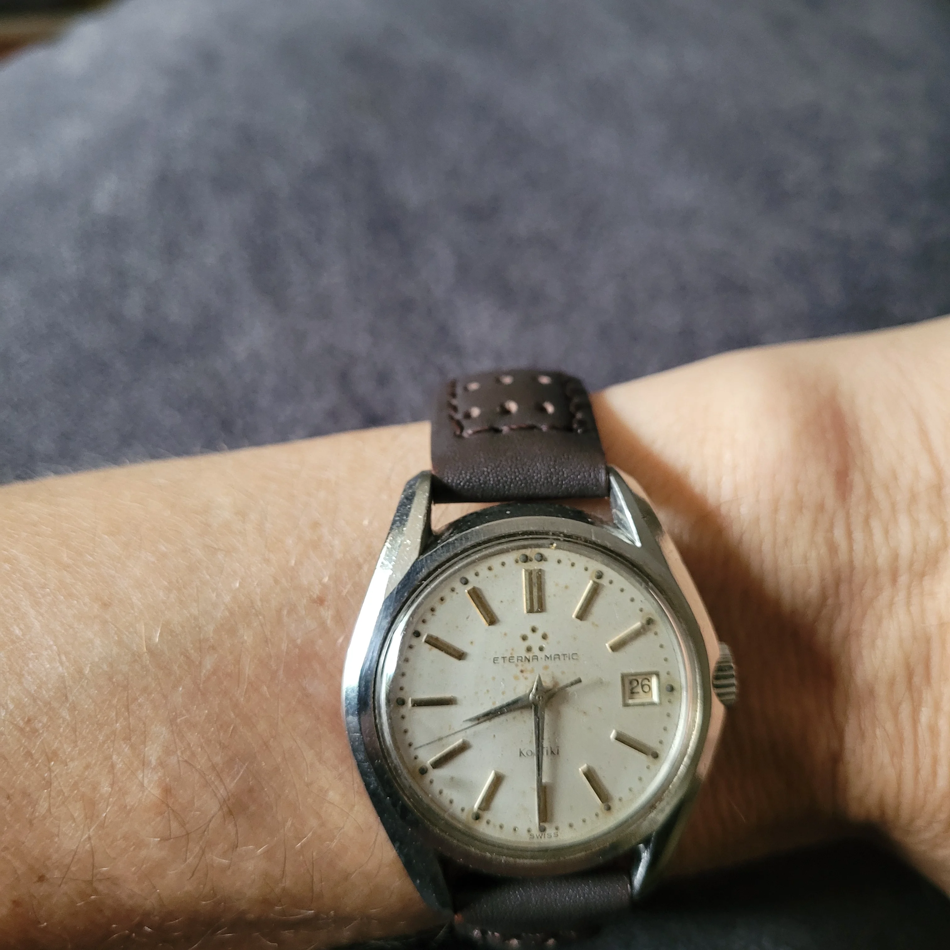

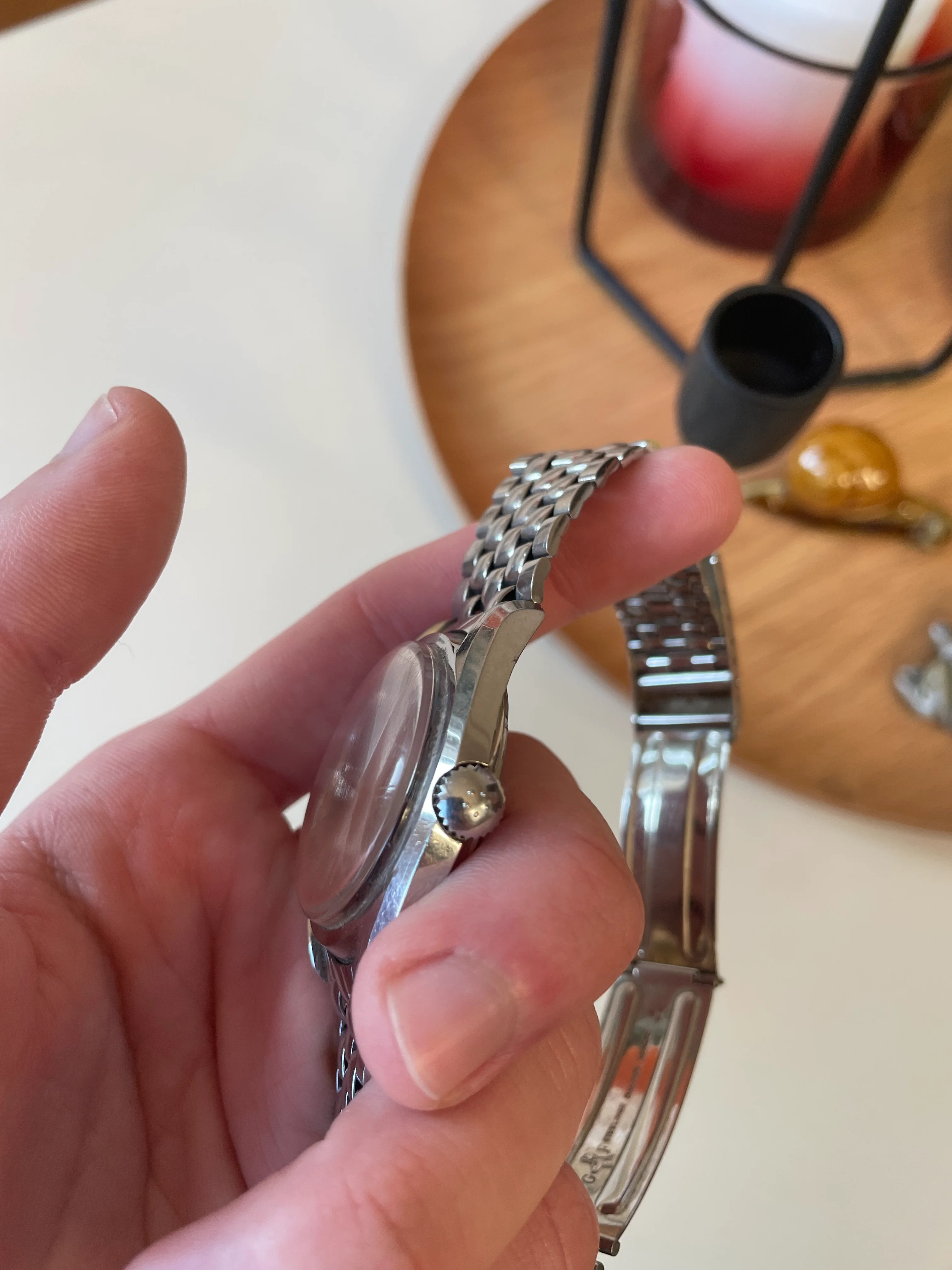

I believe an unmarked crown would be the correct one for this watch. That dial is one I've not seen before.
24,810
55,141
Yes, 1961-63 depending on whether you go by the case or. movement serial.
Yes, I saw that but I am not 100% sure about this database. Thank you very much for your response!
4,358
12,881

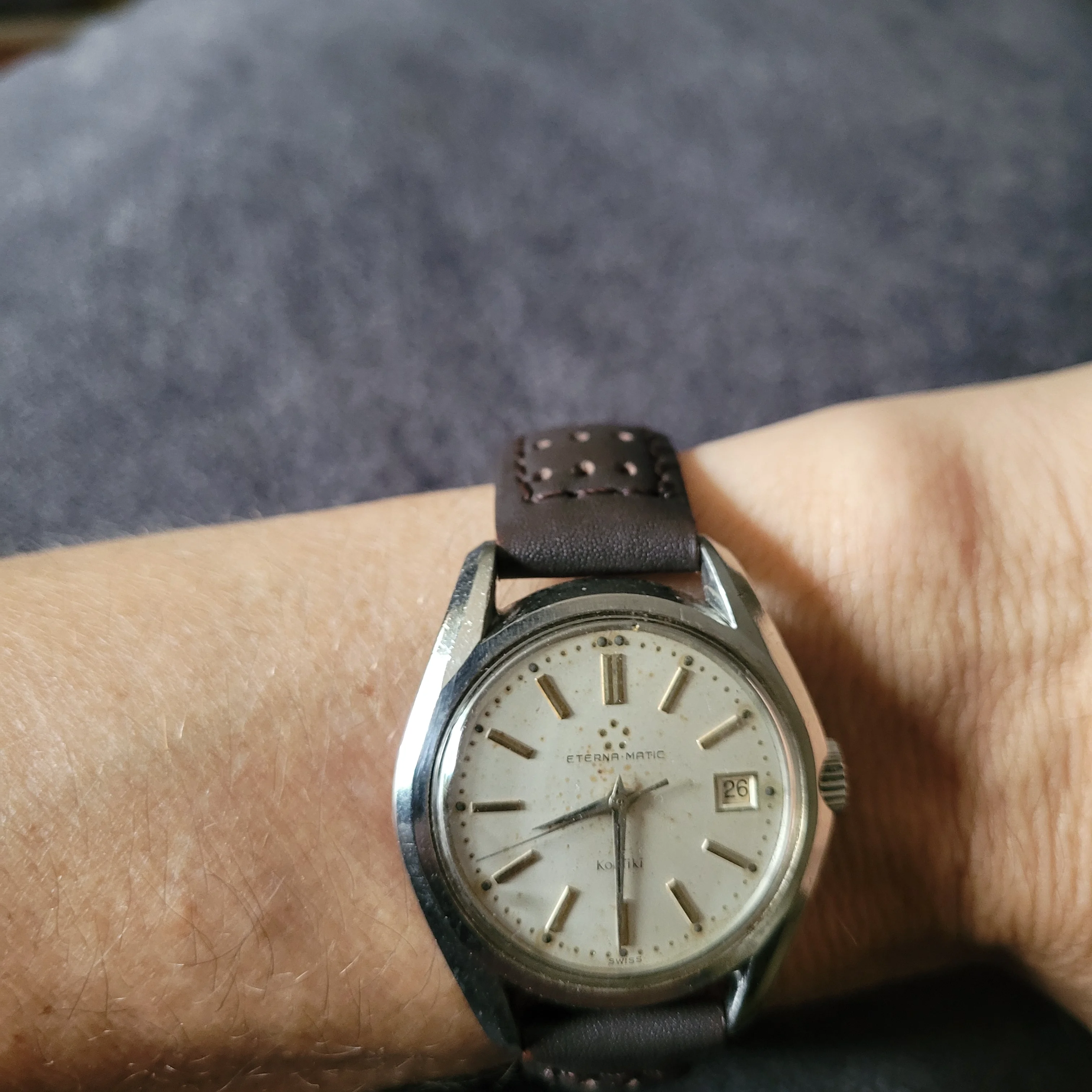

It's probably the most accurate database for Eterna on the internet.

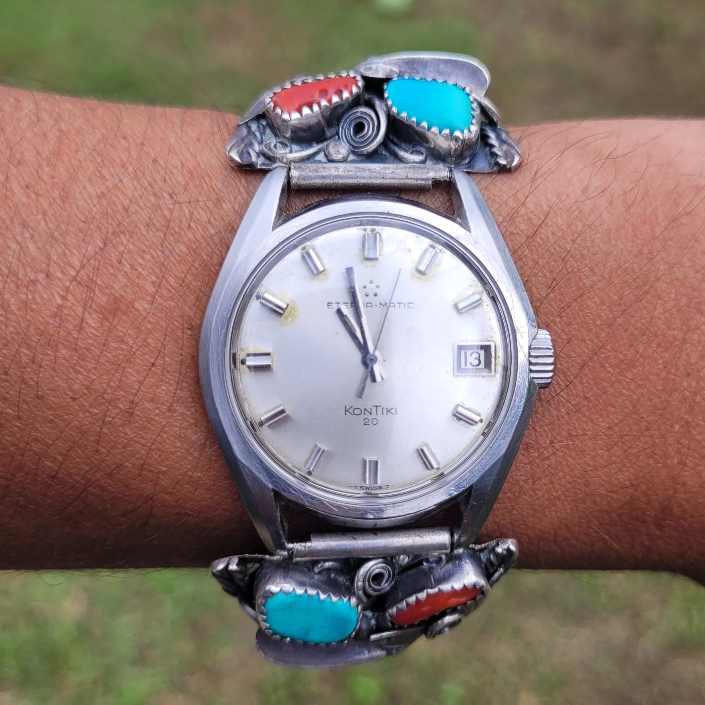

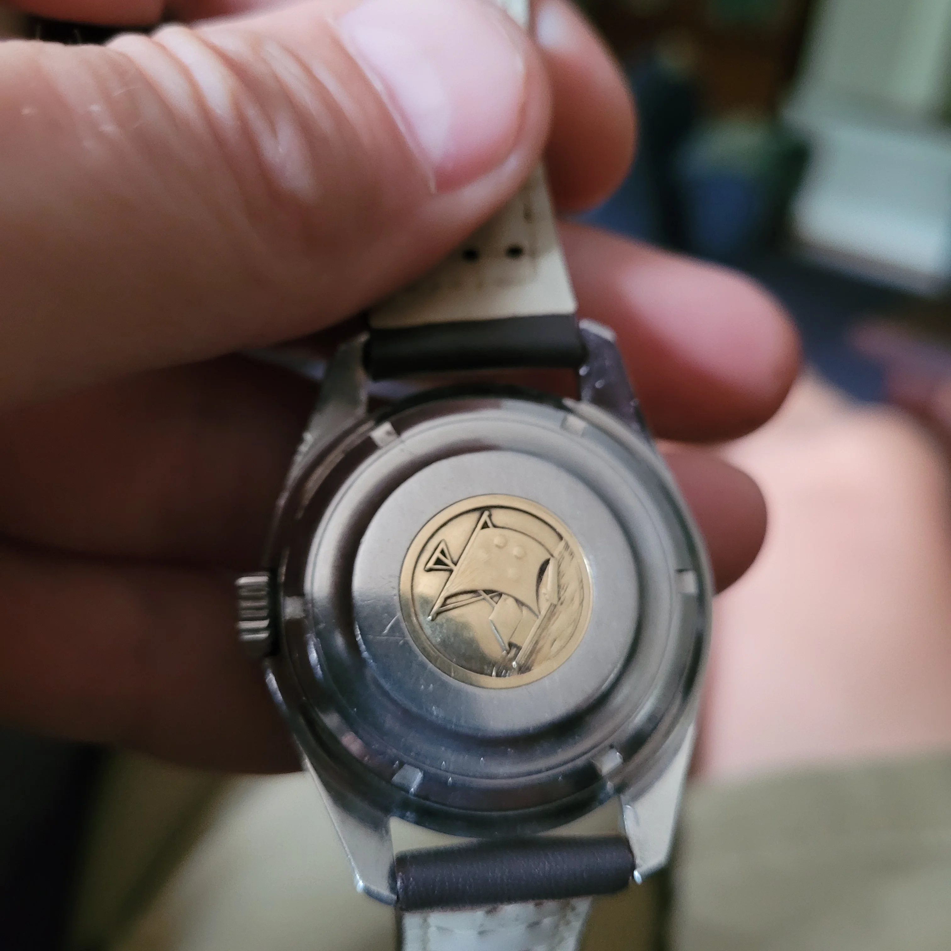

My Kon Tiki is also a 130TT.
