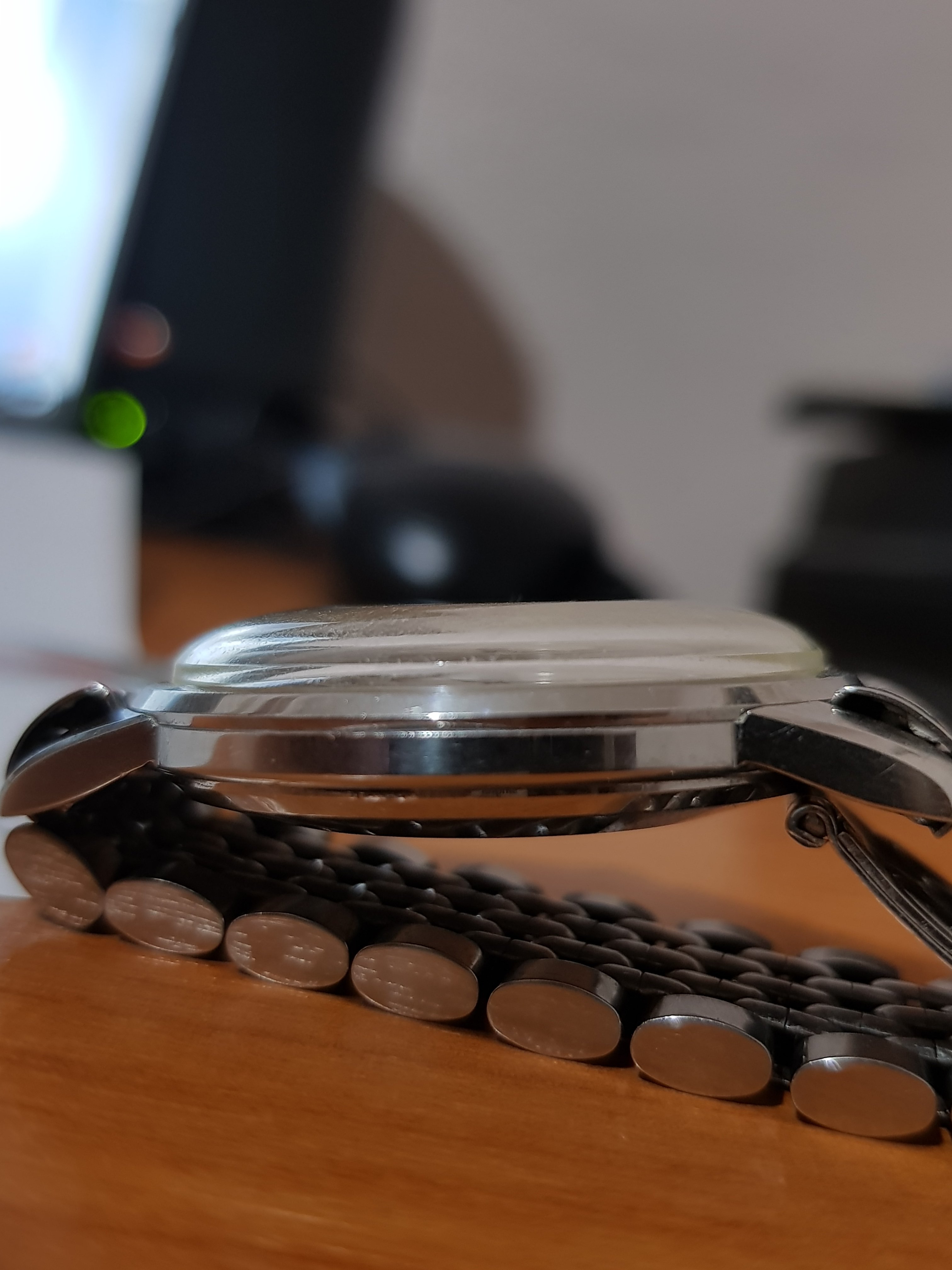

    Hi, anyone here able to point me in the right direction?
    I am searching for a replacement crystal for my vintage omega, Cal. 562, Case 14703. Tried searching on eBay but I am unsure of whats the exact specs. required for my watch. Ofrei didn't seem like they had one that matches the case no. Any help would be appreciated :)

  3. Salibee Nov 14, 2017
    19
    16
    Mine states its a 14703 - 3 case. Don't think its available there..this is how it currently looks like...any other alternatives?

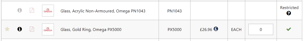

  4. COYI Nov 14, 2017
    496
    723
    Contact an Omega AD and ask them to check on the extranet. Forum member Archer has access to it and is often kind enough to help with this type of enquiry if he reads the post.
    Salibee likes this.
  5. Archer Omega Qualified Watchmaker Nov 14, 2017
    26,442
    65,491
    Crystal for that case is listed as 062PN1062.
    Cheers, Al
    sat968, COYI and Dash1 like this.

  7. Salibee Nov 14, 2017
    19
    16
    Thanks for the help! Unfortunately, there seems to be none online..maybe I'll just have to play the waiting game. :(
