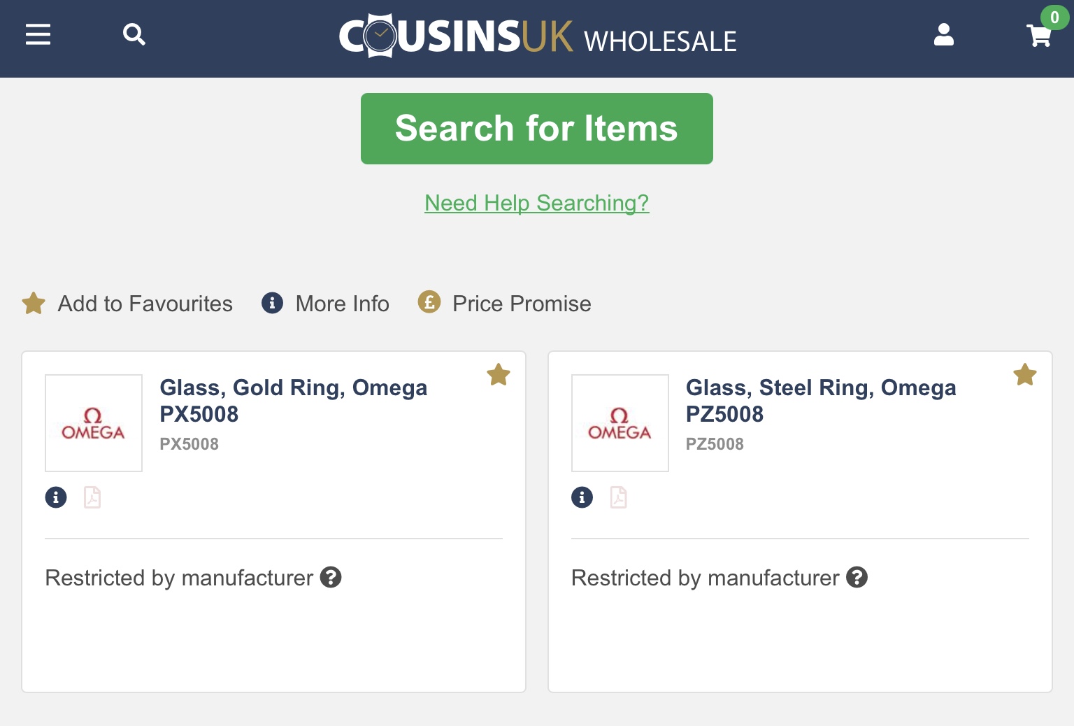

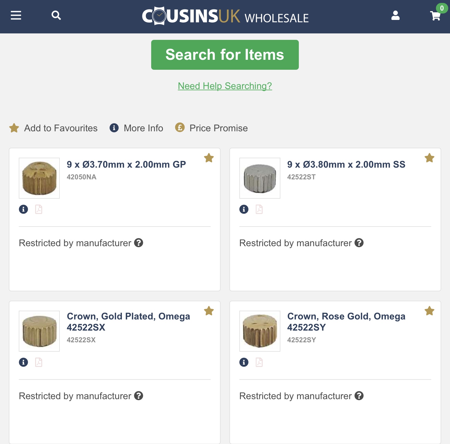

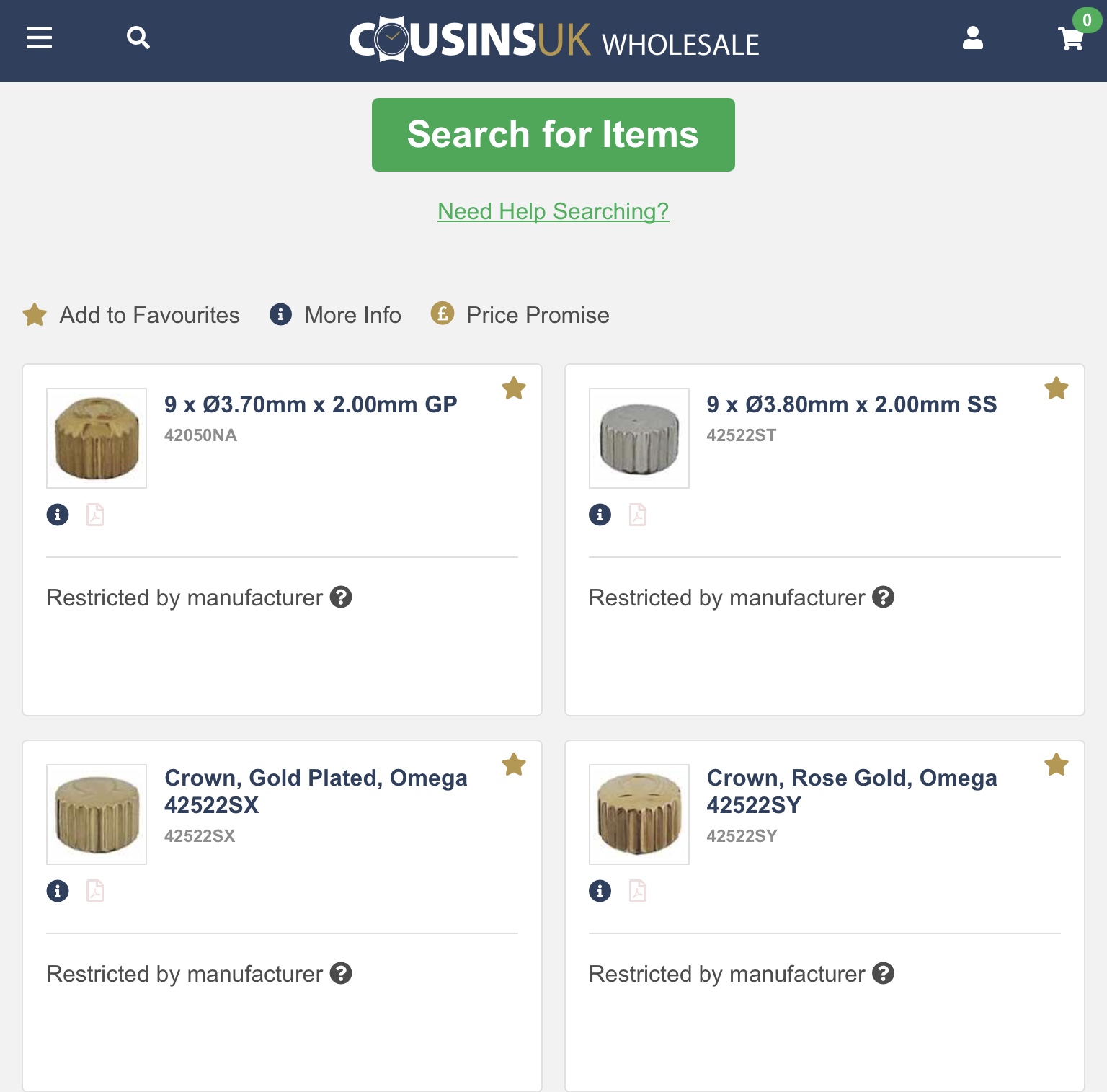

Here are the references that Cousins give.
250
713
If you are looking for the steel crown the part number is: 069ST42522
The crystal with chrome tension ring is: 063PZ5008
266
2,947

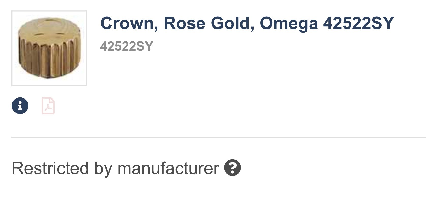

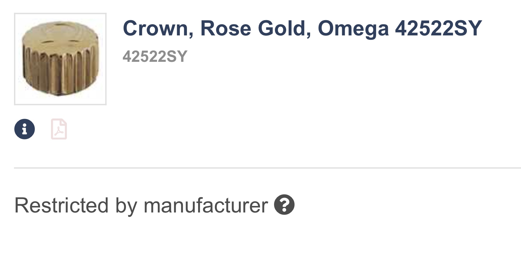

the original style hidden crowns are no longer available.
This is the reference from Cousins for the replacement crown
