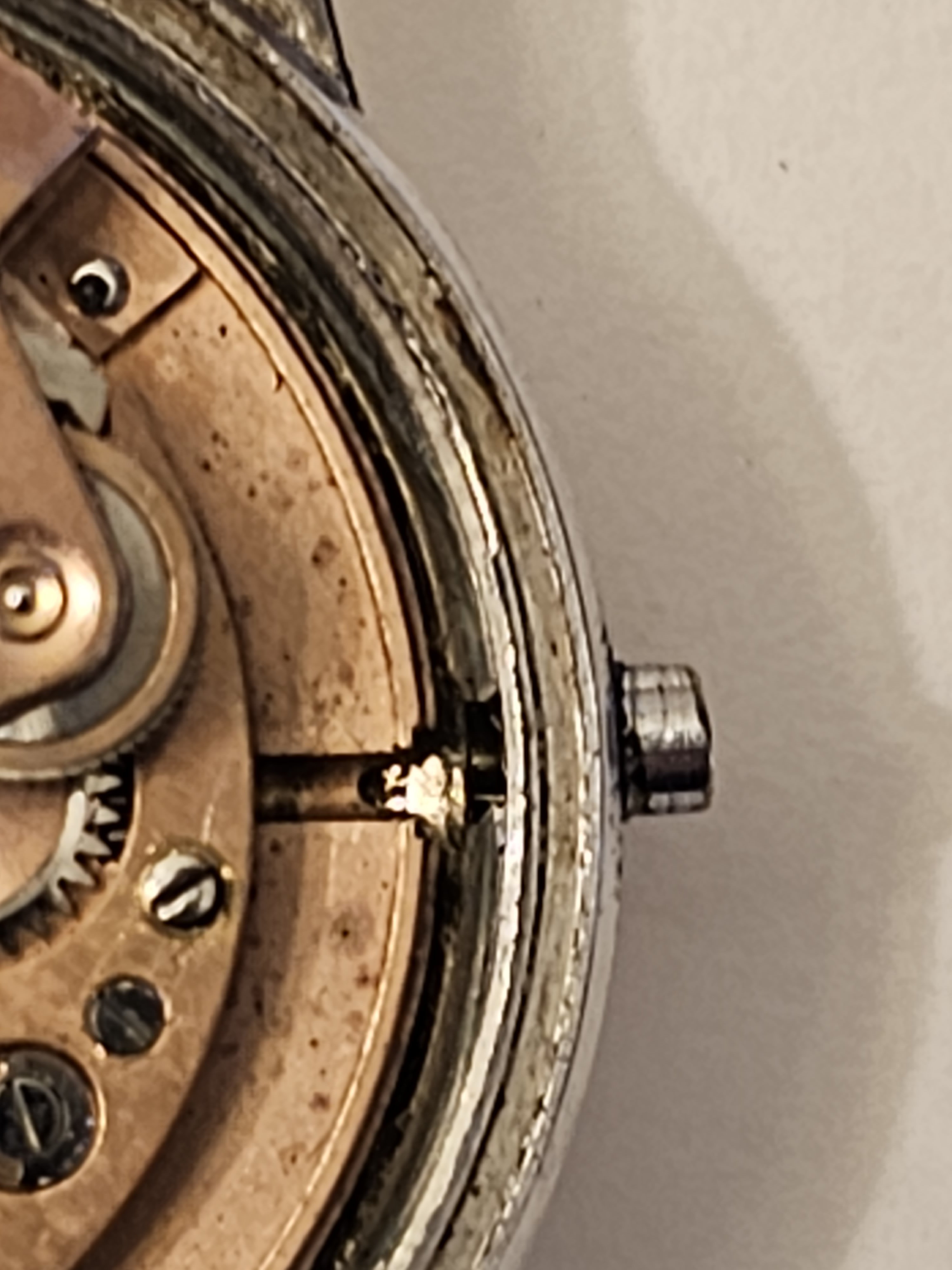

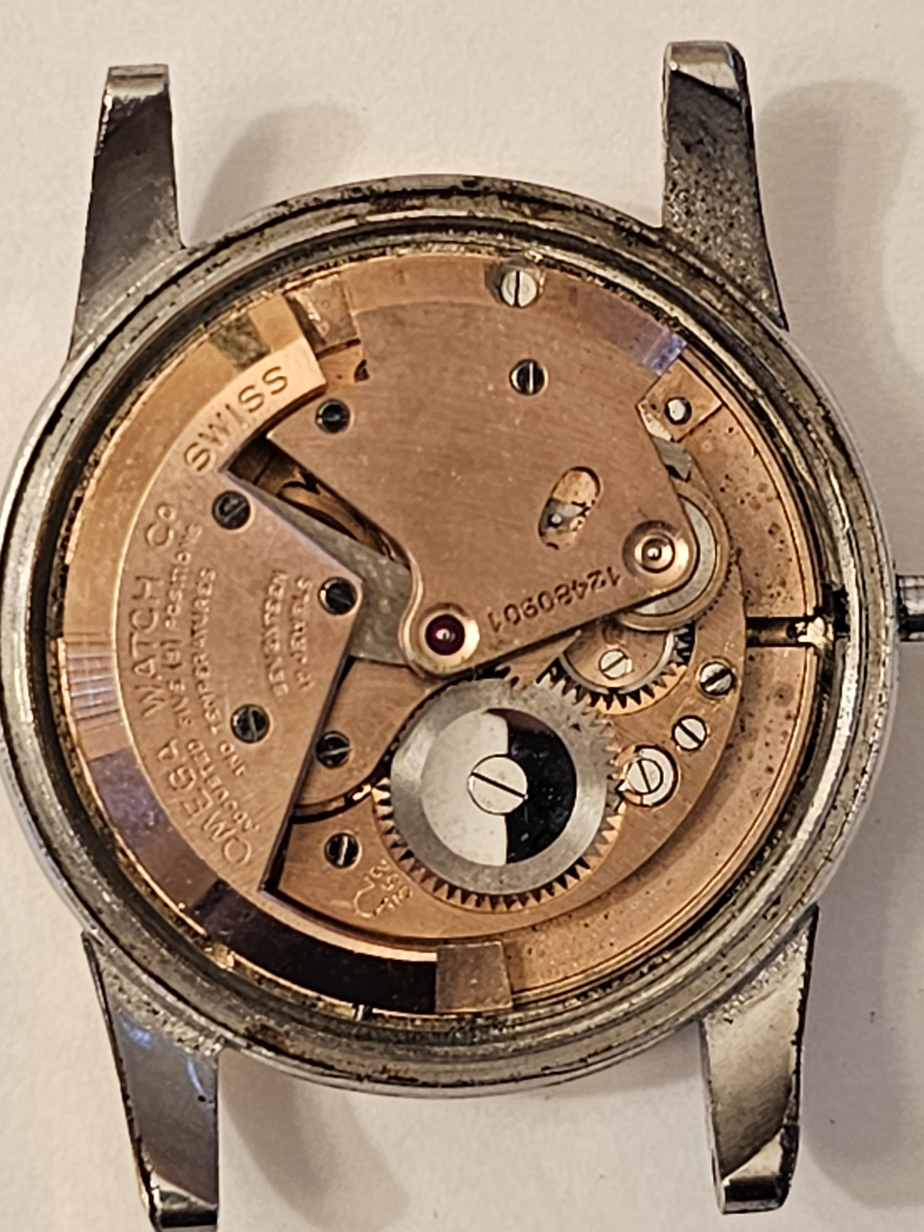

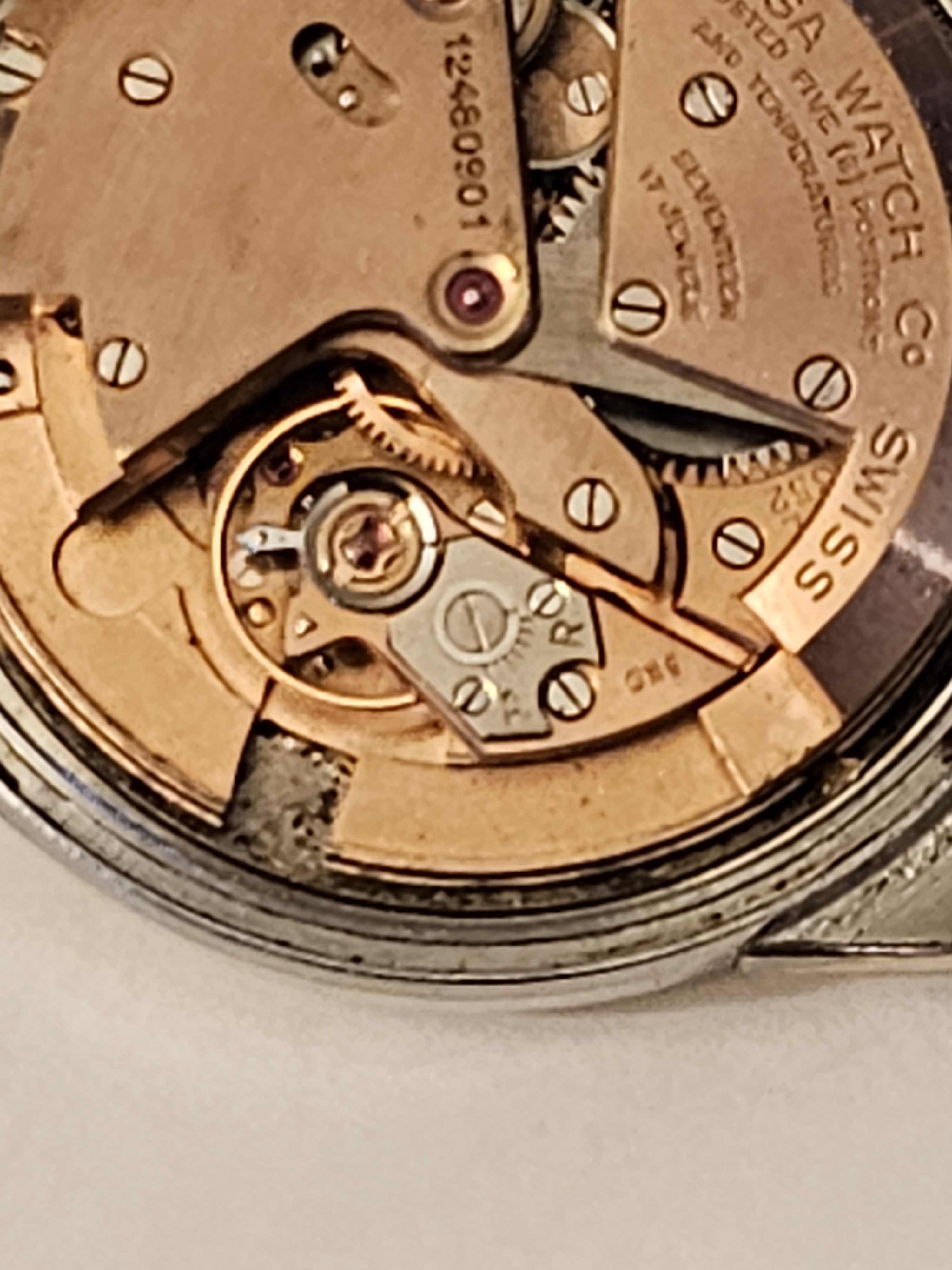

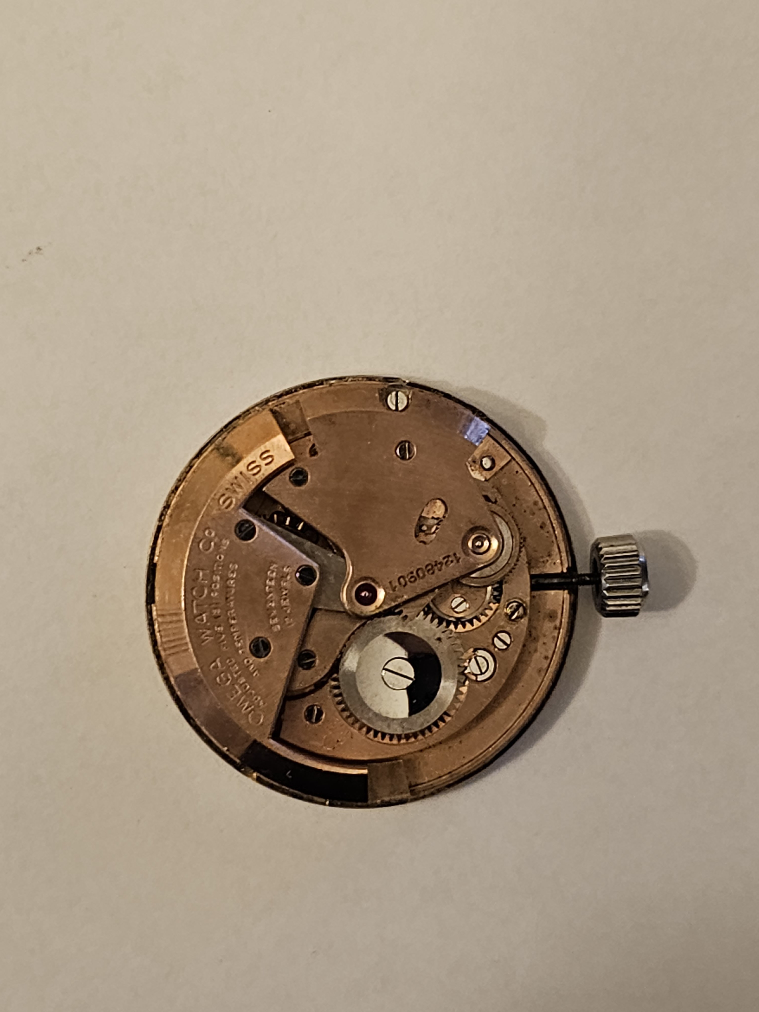

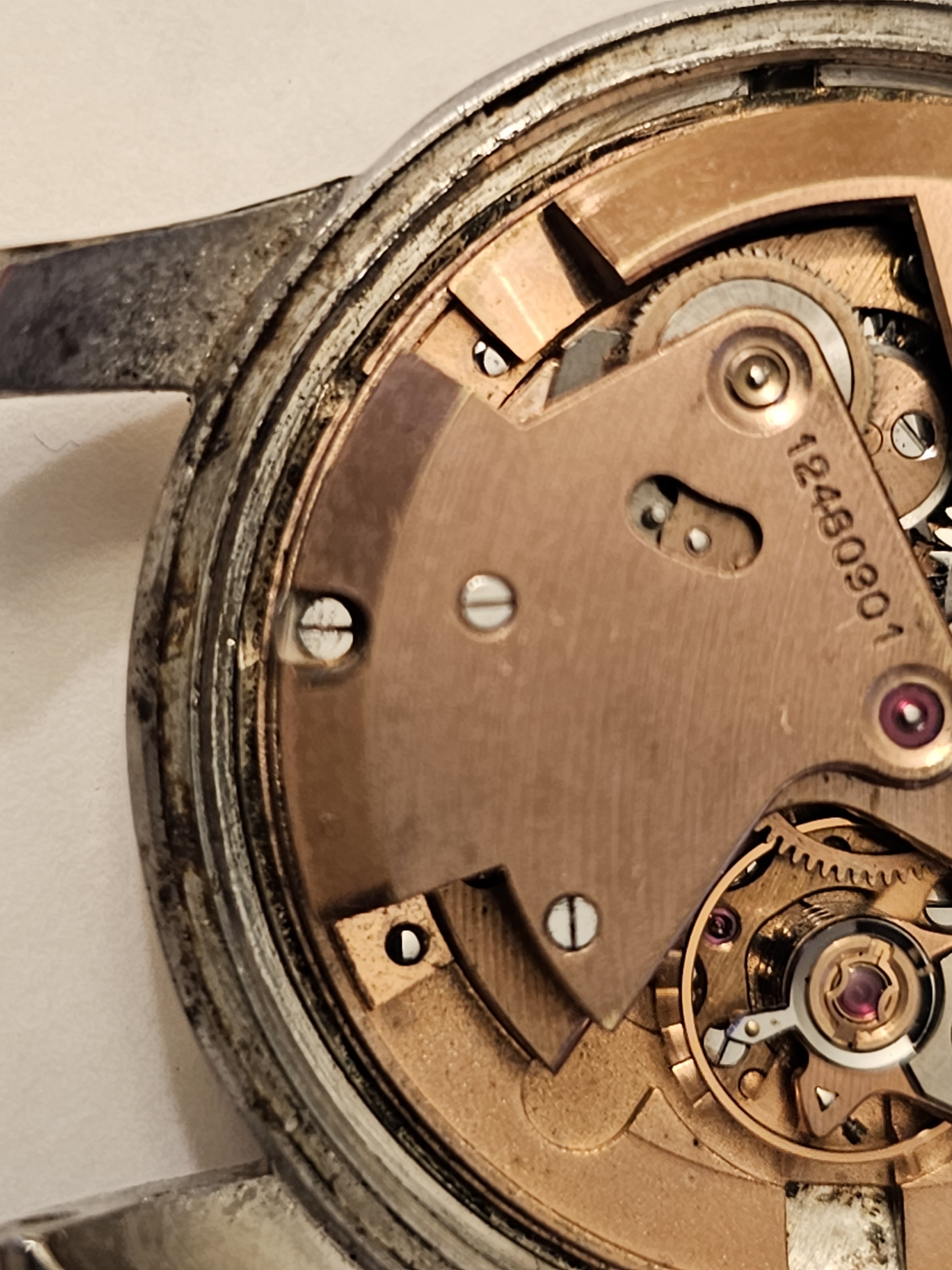

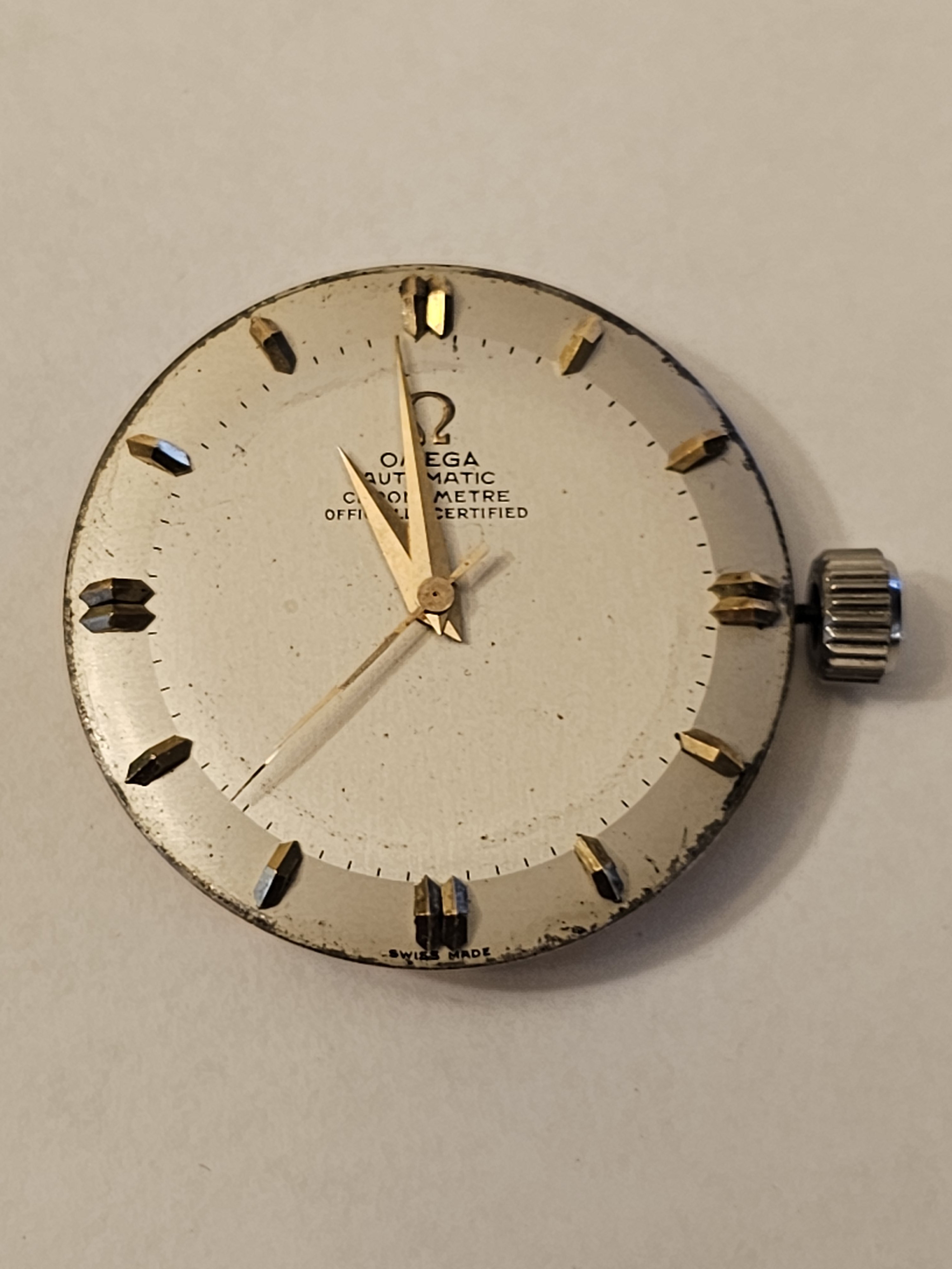

Here are some pictures. It is 1950 cal 352.
Dial and movement not all the way into the case(2577). May need jumbo case(36mm).I think I need 2494, 2657 or 2521.

My guess would be that it came from a melted 14311.

2657 is a small second ref. 2494 is center second but I’m not aware of cal 352 versions without Seamaster writing in them (happy to be proven wrong though).
@X350 XJR s guess might well be a good one I think, but finding a spare case of that reference will be… difficult.
13,677
19,048
Don’t forget all the steel and gold capped versions of the above case references. Omega’s database is far from complete.
