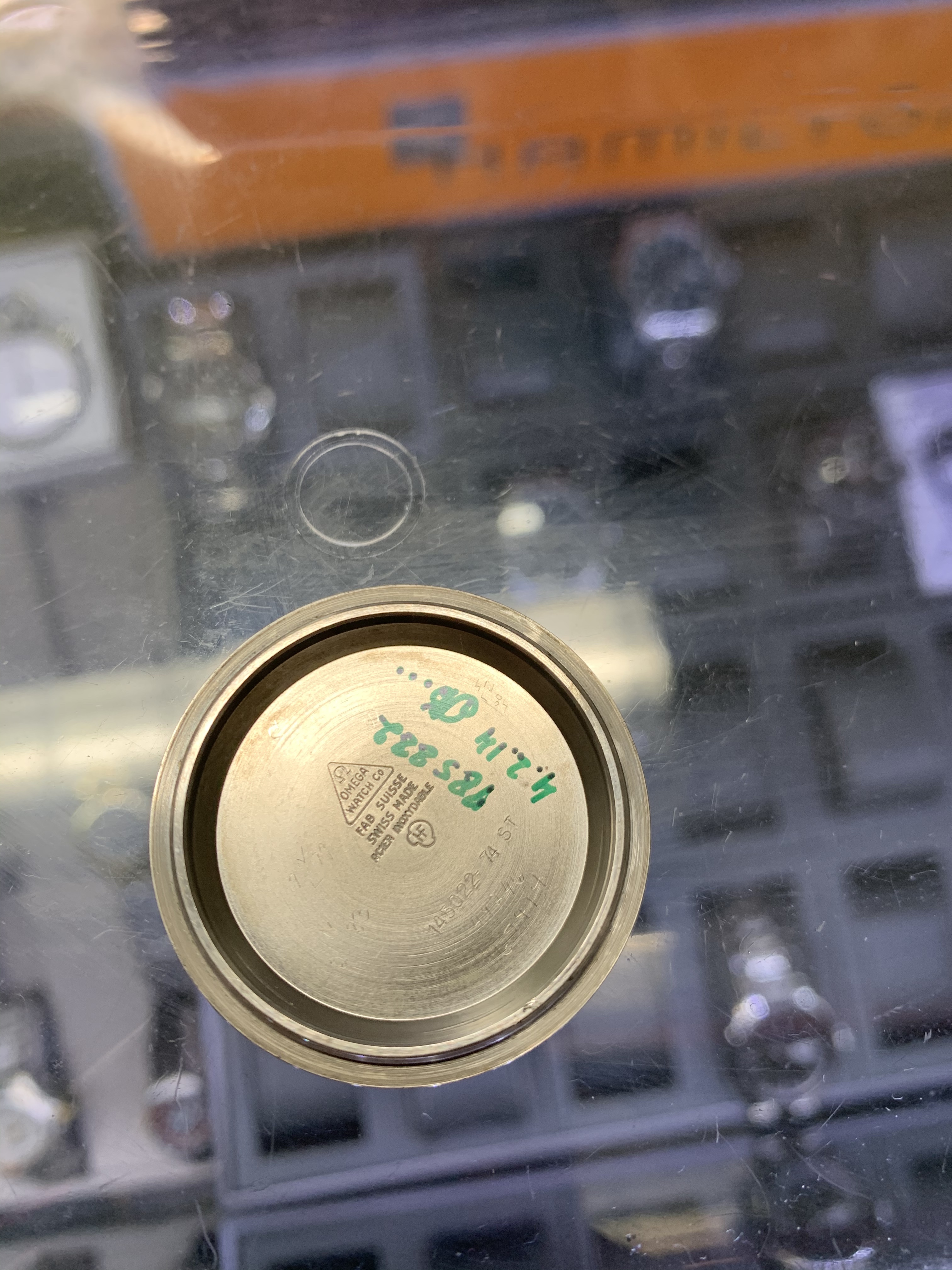

So, update. I got a jeweler to crack the case back and give me the serial #. It is a 145.022 74ST. I went to Omega today and asked them to order the imprint from the archive. They said that at the 2014 service, the records show the option of a redial was presented, but not taken, so the dial currently on it (as pictured) is the dial which was on it when it came in for service in 2014. My parents maintain it was never serviced between purchase in 1974 and this 2014 trip to Omega. The Omega staff further said that this dial IS authentic and an Omega dial, because if it wasn't, then the redial would have been mandatory in 2014, not optional. I broached the subject of Tiffany co-branding, and the first woman didn't think there were co-branded Speedys, which there were. The other guy said perhaps this weird dial, was unique to Tiffany. He actually suggested I ask the forum for help or reddit. So here we are. We have 100% confirmation the watch is authentic. We know it's a 1974 Speedy. The serial # has been logged and we are awaiting the imprint from the archives, but if anyone can help me make sense of this dial, that is going to be the real mystery. As noted the font is off, there is no Omega logo, and it is missing the T Swiss Made T on the bottom. I believe they replaced the hands at the 2014 service so that explains if they aren't era appropriate, but they didn't touch the dial or the bezel. Any help you can offer would be great, I don't know what my next steps are to solve this mystery.
In addition to the green ink, that caseback shows about 3 other sets of marks suggesting several services in its past. I don't agree that the fact they didn't insist on a redial in 2014 somehow confirms it is original. If you send a redialled watch to Omega with a genuine (but repainted) dial they will, if they have one, offer a replacement but wont insist you take it as long as the one on the watch isn't going to compromise the watch with flaking lume etc. I think you have to face the likely reality that this was redialled, the fact it has odd coloured lume with incorrect long plots suggests this also. If there was no service before 2014, what are the other marks...

There you go. It has been serviced at least twice before by the look of it.
