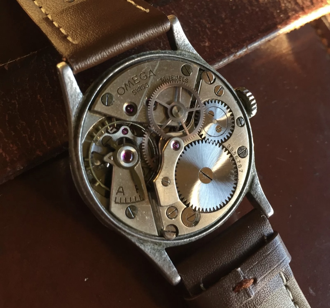

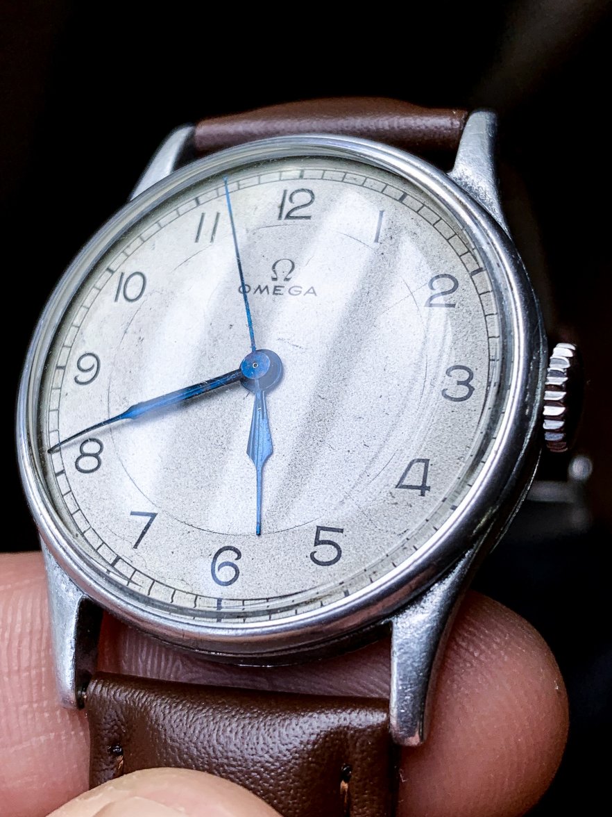

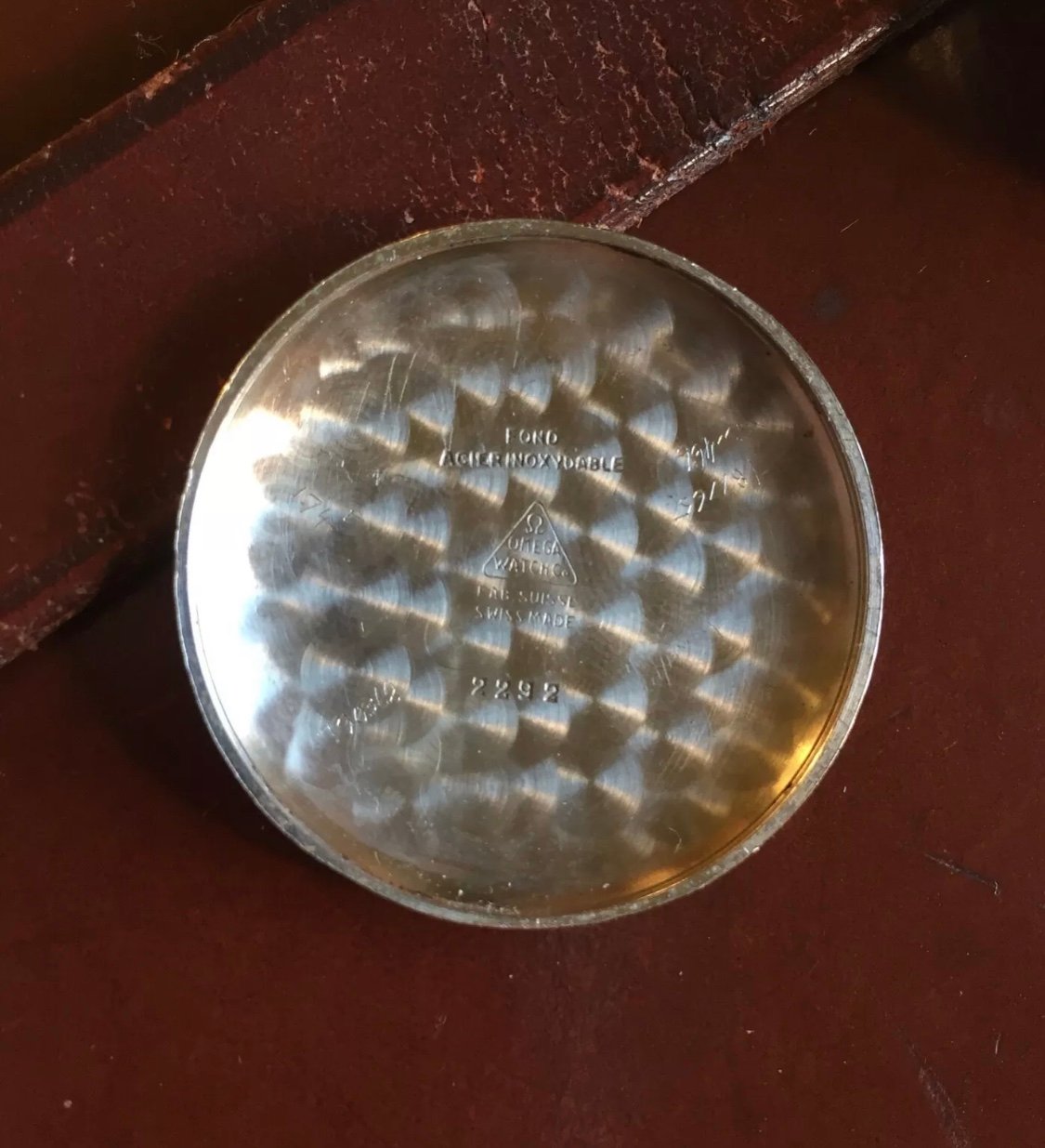

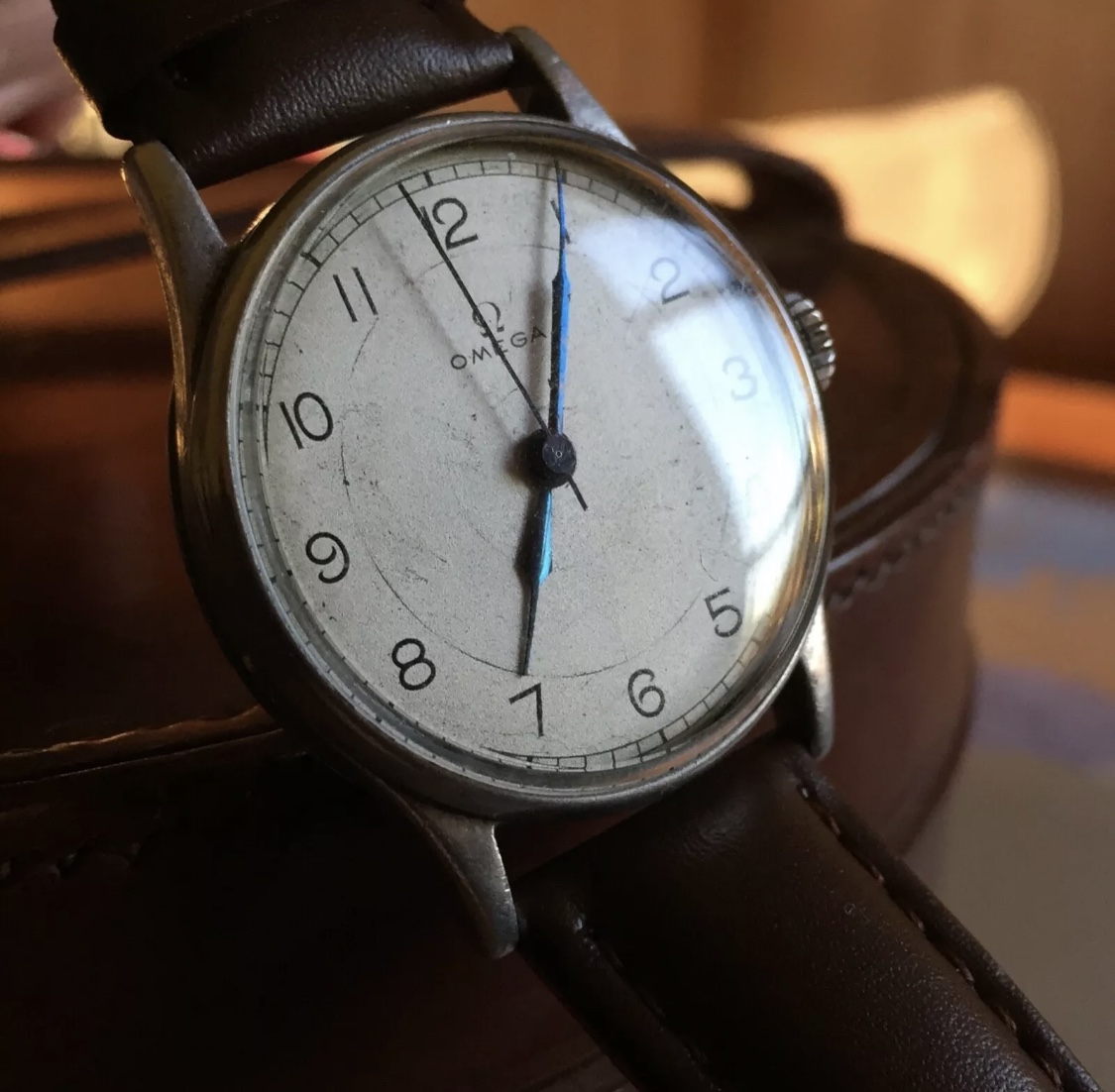

    Hello, I got a hold of an Omega 2292 30t2sc but noticed that the hands are different. Could anyone be able to tell me what this watch might be worth? I think it’s the civilian version from 1939 but I can’t seem to find another one like it with the same hands although the hands do seem to be original.
    Here are some pictures and also here is a link to where I’ve posted it on eBay.

    The hands of yours pics are "plume"; for this model of 30T2 the correct hands are "poires". The plume hands you shown are wider than usuals for 30T2, these are probably for cal 23.4 or 26.5.
    And the wacht is from 1943-1944, no 1939.

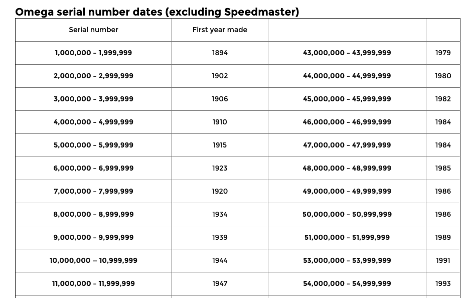

    I am pretty sure it's from 1939 from what I've researched online. the serial number starts with a 9******.
    but thank you for the rest of the info.

    Note that 1939 was the first year. 9,999,999, presumably was 1944ish, if 10,000,000 started that year.

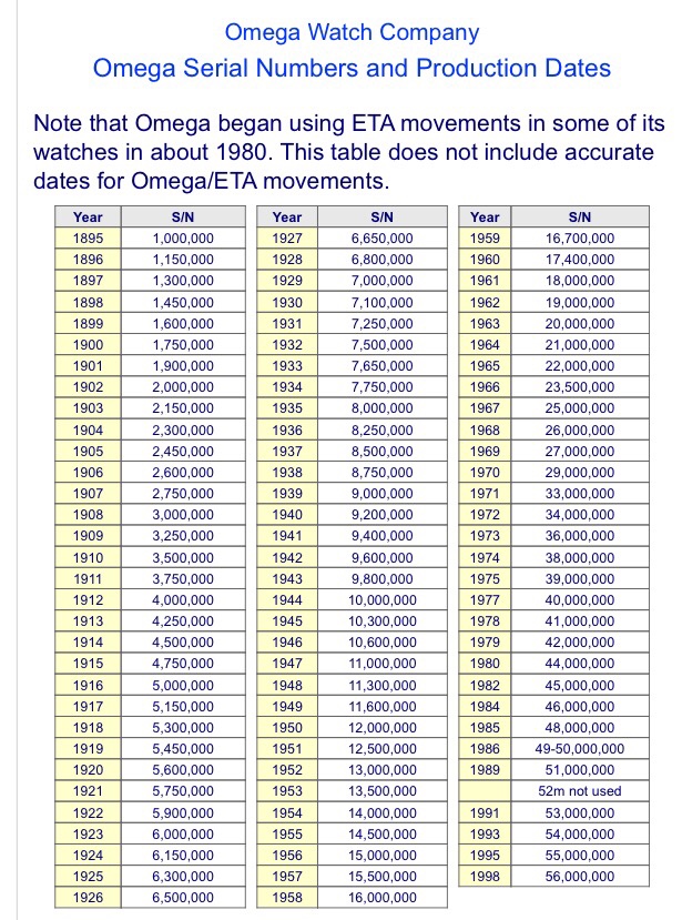

    Excuse Manny but i show a table more clear

    Oh, I see now. Thank you. But I read somewhere that 1939 omega watches did not say Swiss made at the bottom.
