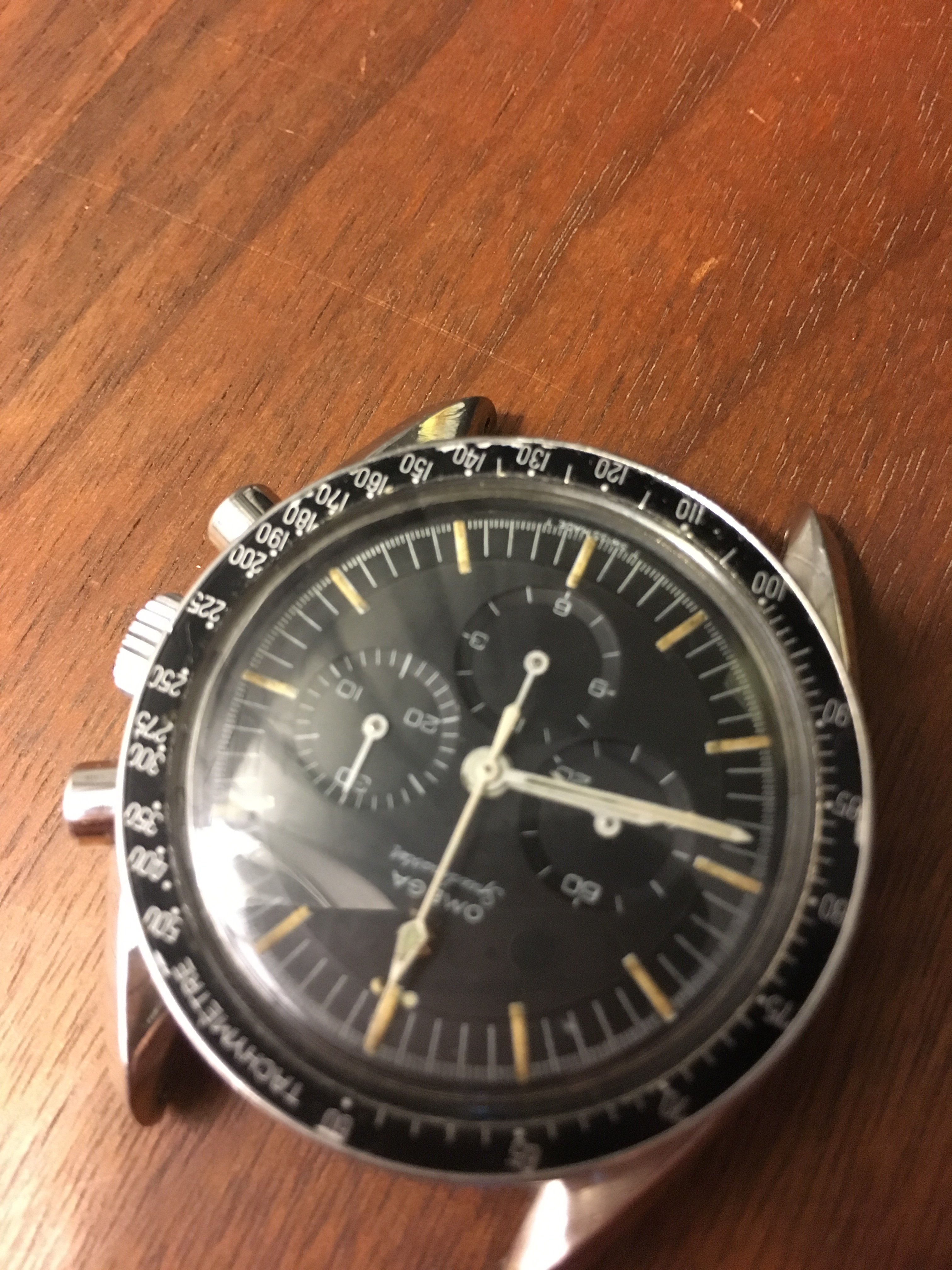

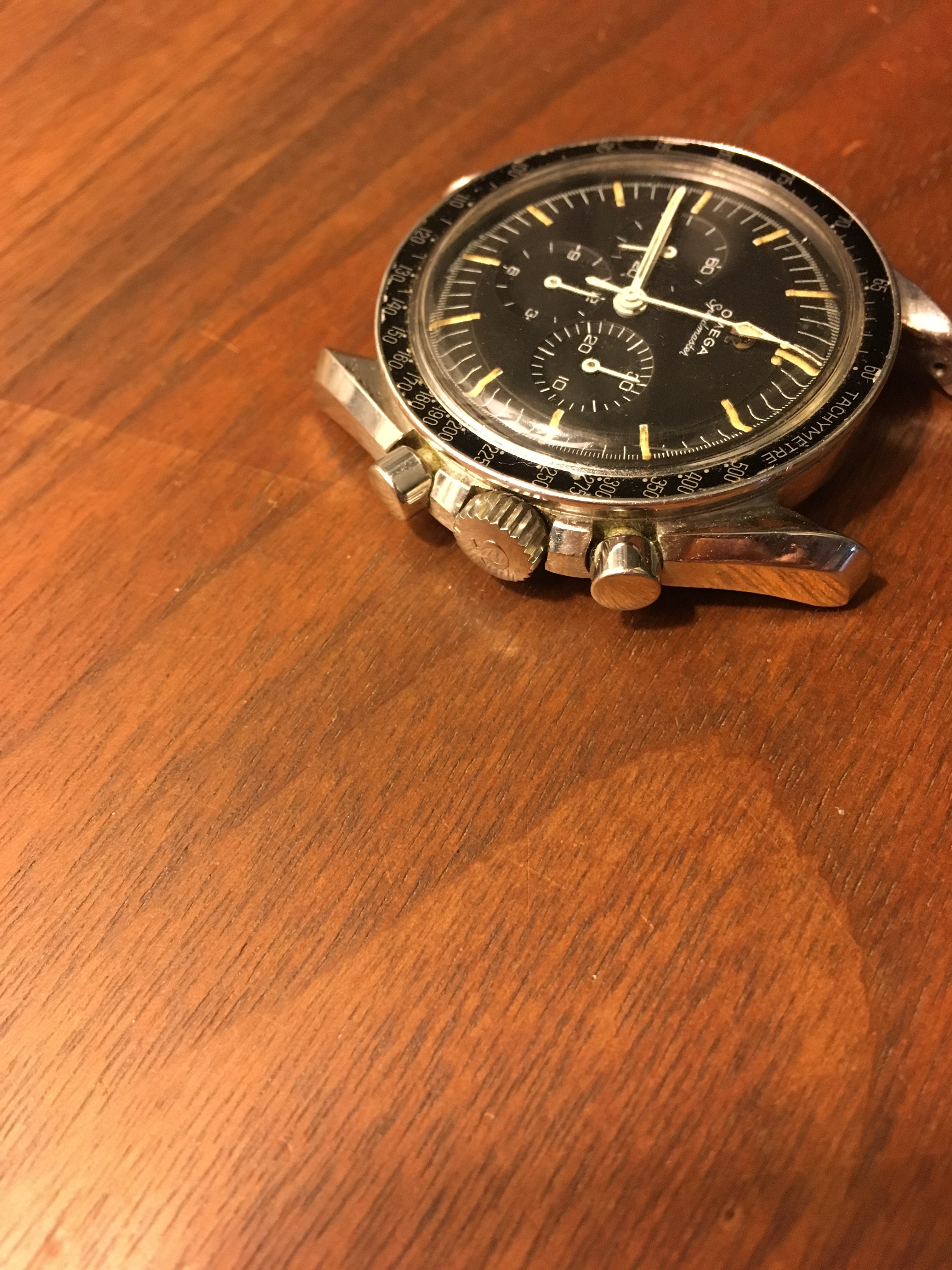

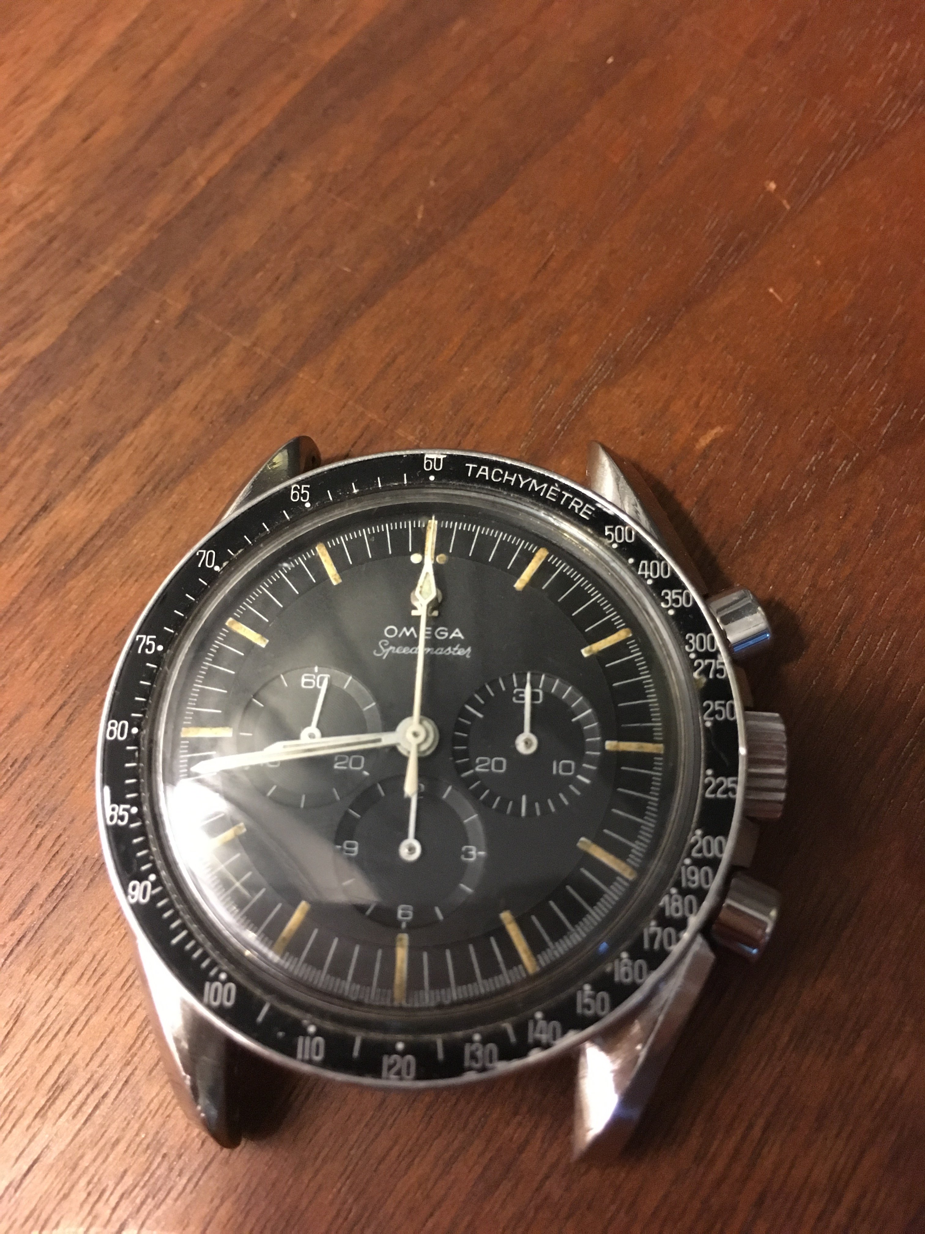

    I recently picked up a very nice condition Speedmaster (i've got a mark ii racing dial from the late 60s, a gold filled seamaster, and a modern SMP -- this is my first original-style Speedie). I'm going to take it to my watchmaker for a service, but I was hoping to understand what model it is. I was pretty sure it's a 105.012, but the speedmaster101 website says pretty unequivocally that this model always has "Professional" on the dial, which this one doesn't. I can't find a watch ref that has:
    - Curved lugs
    - Swiss Made T dial
    - No "Professional" on the dial
    Does anyone have an idea which ref this is? It seems unlikely that a service dial would go back to an older style, since all the watches following had "Professional" on the dial.
    Thanks in advance for any help!
    Phil

  3. omegastar Jan 18, 2017
    1,836
    5,323
    I am no expert, but I think that dial comes from a 105.003.
    Nice dial, anyway,

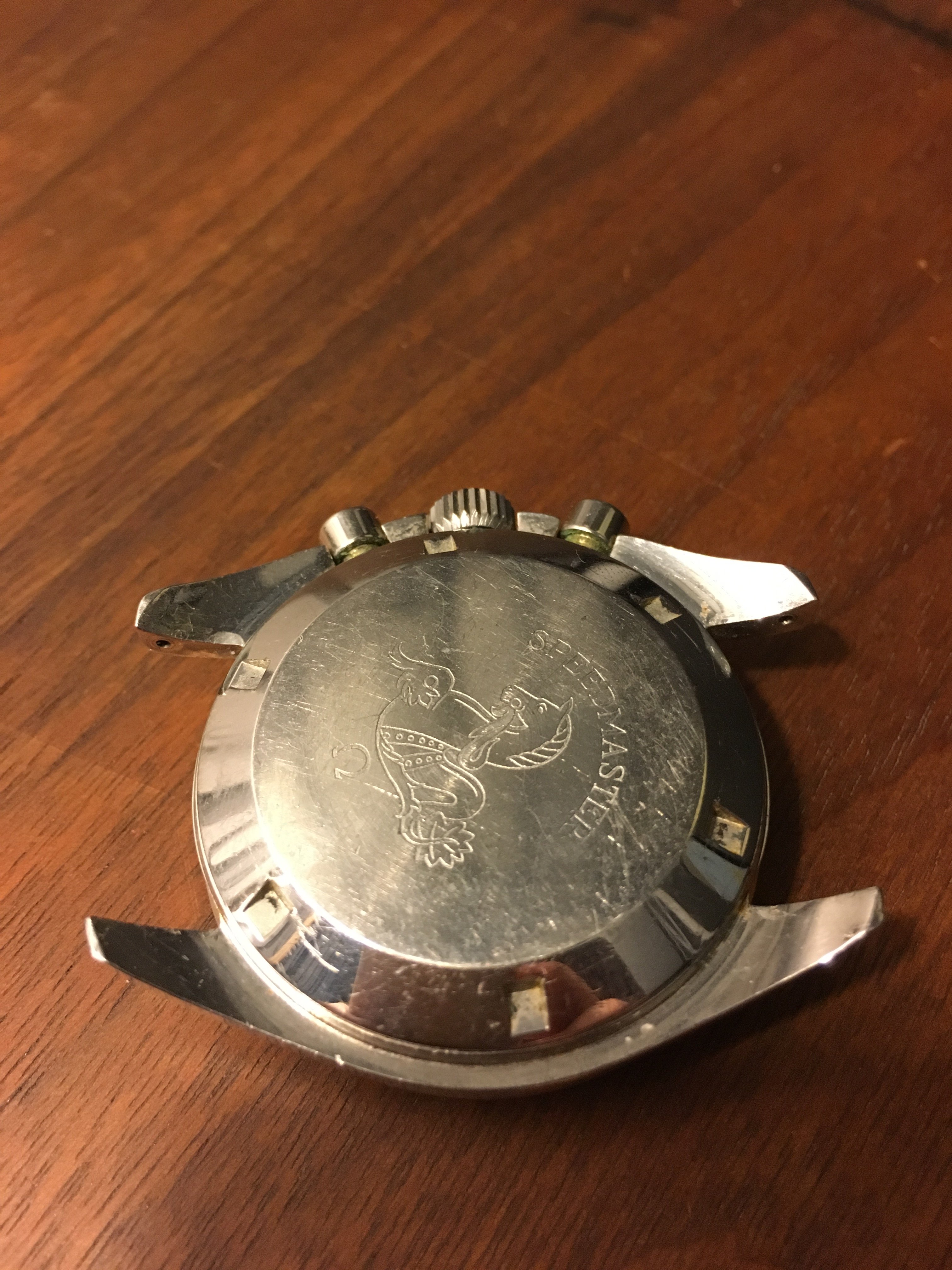

  6. BASE1000 Prolific Speedmaster Hoarder Jan 18, 2017
    443
    816
    Caseback and pushers look rather like a 145.012 than a 105.012 to me. The dial is wrong here, but worth more than a 145.012 dial so it is a good deal you need only to find the correct dial which comes up from time to time.

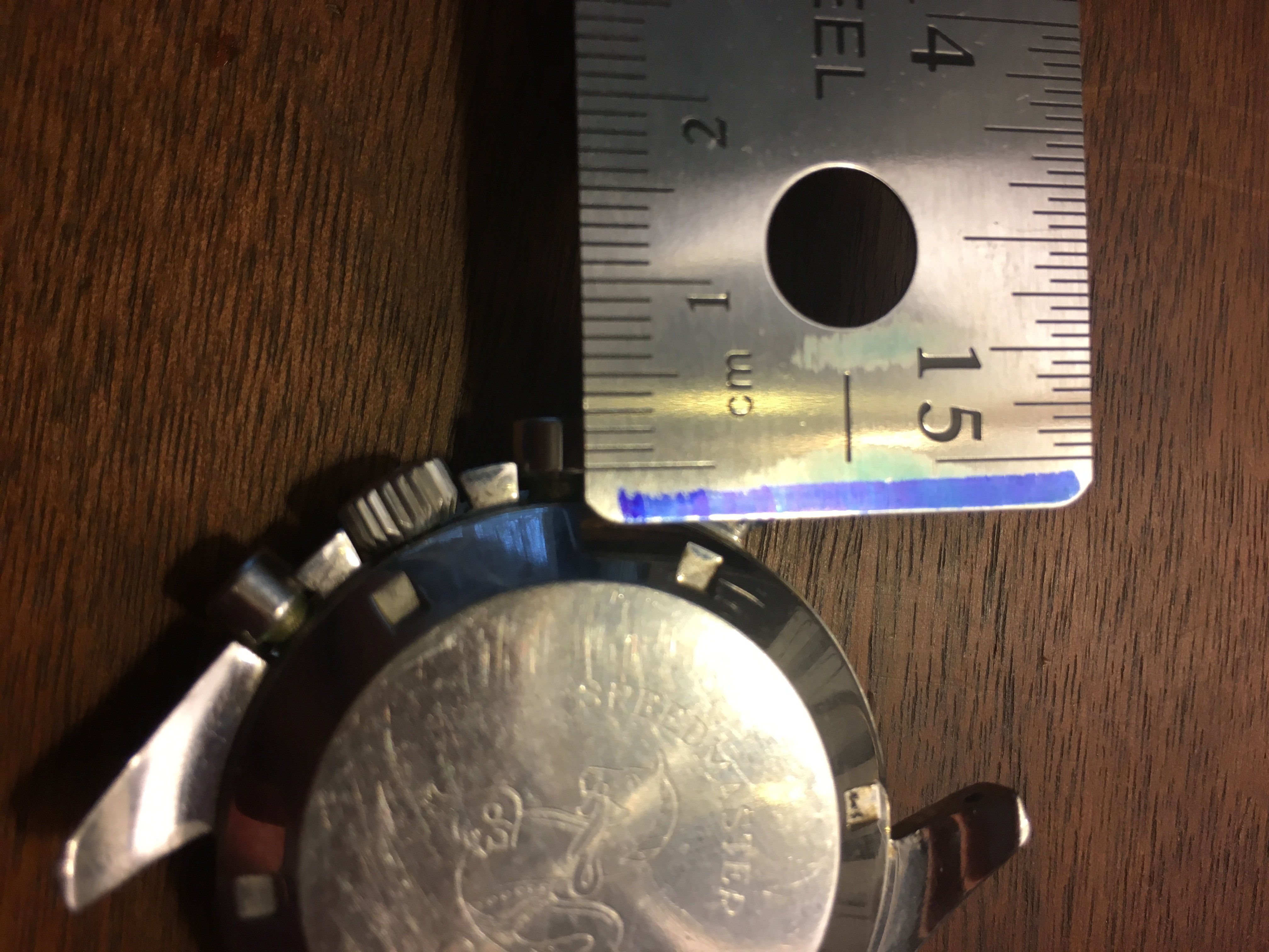

  8. pfibiger Jan 18, 2017
    31
    46
    When measuring a pusher to understand if it it short v. long, is it just the larger part of the pusher, or the whole length to the case itself? It looks like these pushers (the non-stem part of the pusher) is 3mm or less, which is the 'short' pusher. I think.
  9. tempusfugit861 Jan 18, 2017
    199
    353
    None of the current wisdom on 105.012 indicates that the no-pro dial can be correct. It needs further investigation, and finding the correct dial will not be a walk in the park, but the dial included should cover the cost.

  10. Spacefruit Prolific Speedmaster Hoarder Jan 18, 2017
    5,201
    23,016
    Let's see the basics:
    Case reference in the back
    Then
    Serial on the movement.
    My assessment is that's a 105.003 dial. A nice one and worth a lot in today's market.
    What the rest iis, has to be speculation. I have seen watches looking like this that contain an 861 movement. Probably not the case here, but until it's opened we can only guess.
    So my guess is it is a re cased 105.003. Only an extract will tell us.
    Could be a Frank too.
    Get the numbers before we all go mad
    Psych, KstateSkier, pfibiger and 2 others like this.
  11. Davidt Jan 18, 2017
    10,421
    18,126
    Certainly a 105.003 dial, with what looks like a 145.012 case.
    Hopefully the movement number matches one of the above. I'd be very tempted to get an extract to find out what reference is correct for the movement and try to restore to that baseline.

  12. pfibiger Jan 18, 2017
    31
    46
    So I'm back from the watchmaker. The caseback identifies the watch as an 145.012-67. Movement is cal 321. Serial is 2655XXXX.
    The watchmaker suggested keeping the watch as-is because the patina is so nice on the dial, but if I can find a similarly patina'd correct dial and swap it out at a net plus financially, I'd consider that path.
  13. jimmyd13 Jan 18, 2017
    3,156
    7,168
    105.003 recased in the mid-late 60s by some well meaning omega-bod? Only really commenting to see what the answer is when it goes for service.
  14. Spacefruit Prolific Speedmaster Hoarder Jan 18, 2017
    5,201
    23,016
    Well the serial fits late sixties and is higher than any 105.003 I have seen. Fits perfectly to a 145.012
    We need an extract to be sure. Entirely possible an early owner simply preferred the early dial or swapped at service at a time when people did not care as much.
    Or it's a put together with multiple sources. The simple answer would be it's just the dial that's changed.
