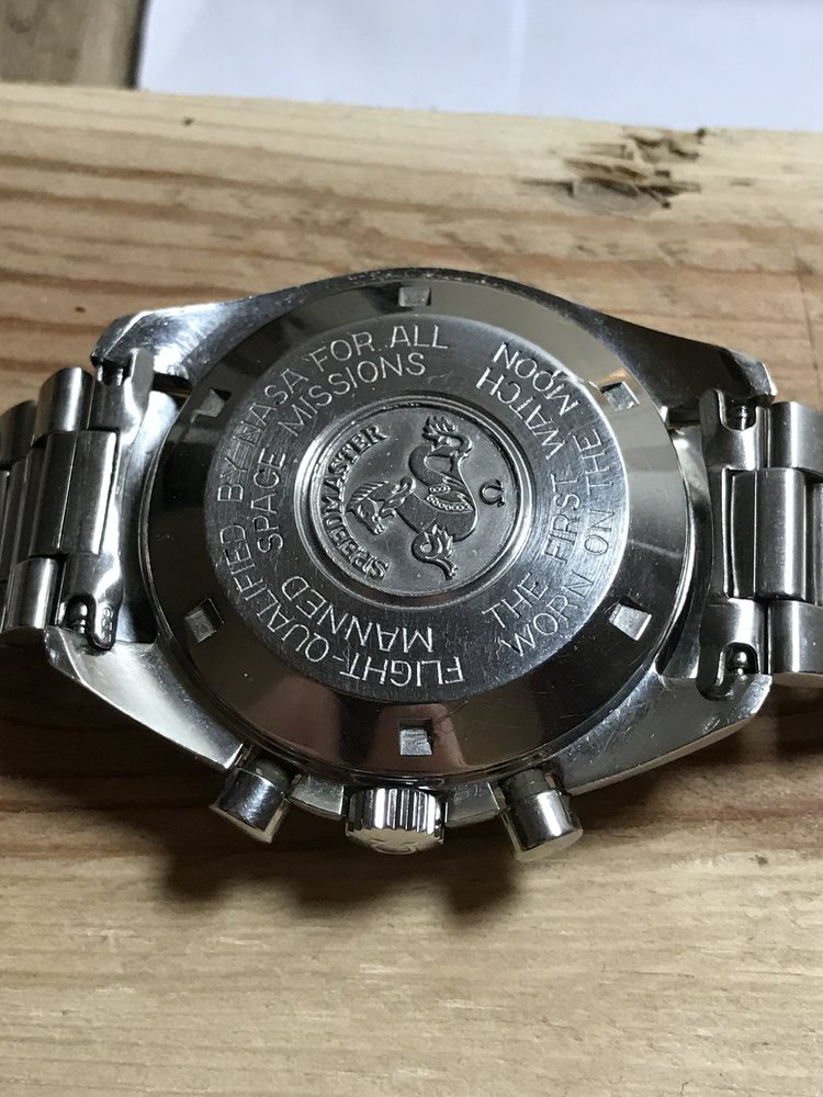

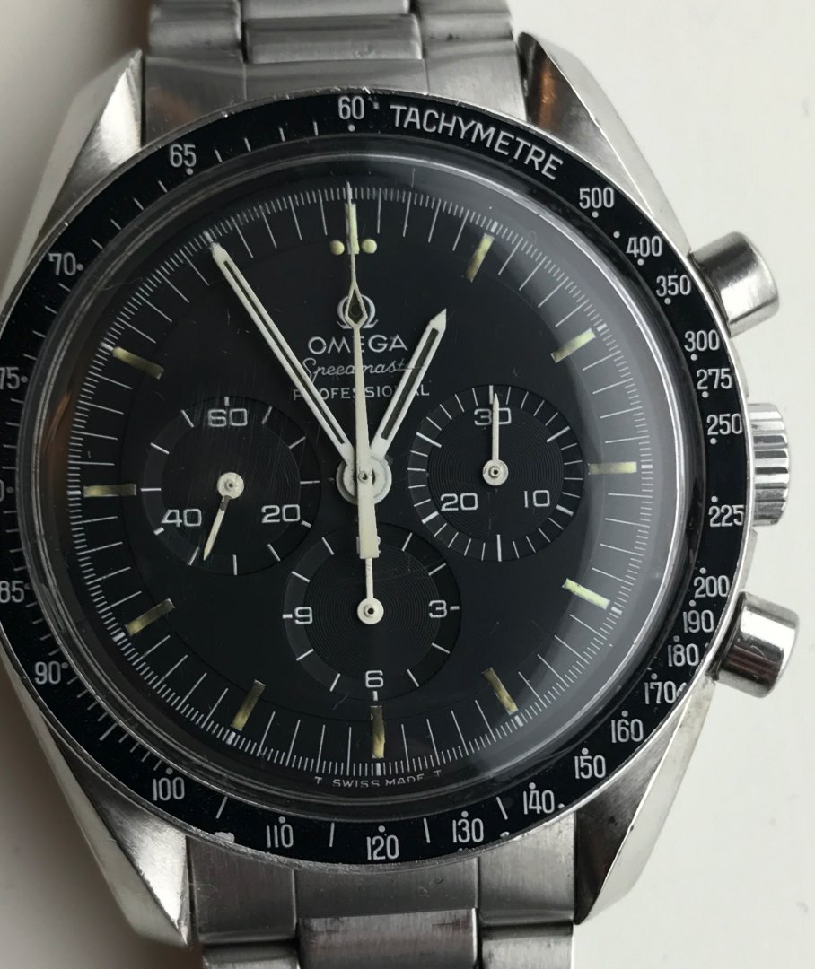

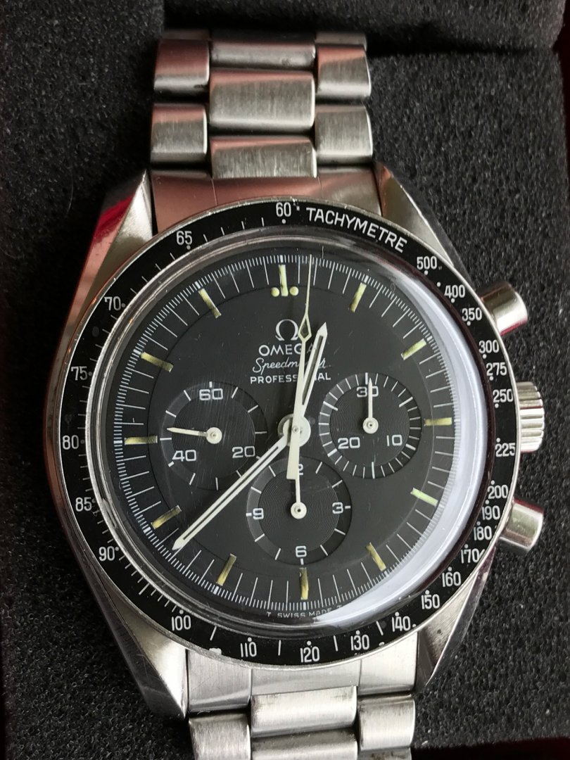

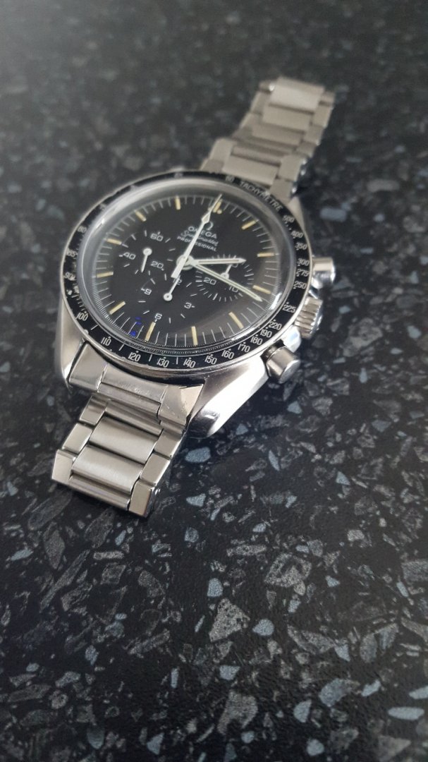

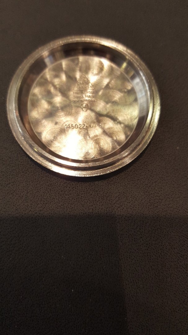

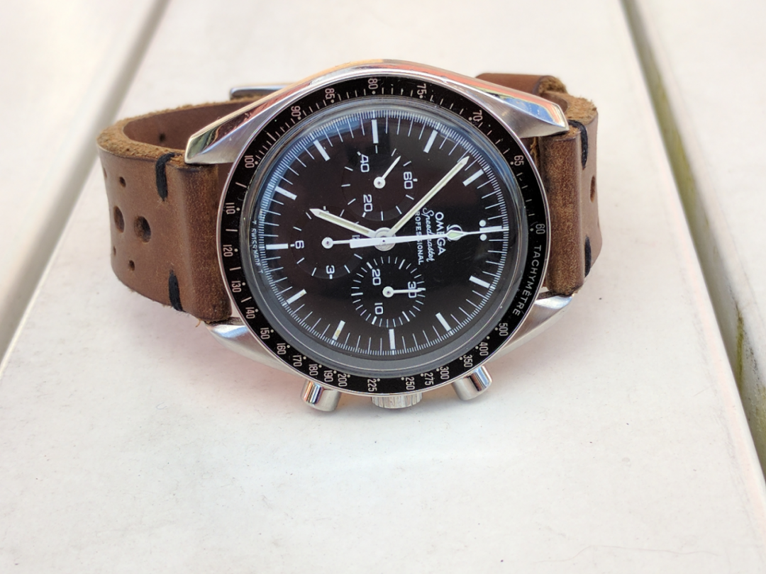

    Hi. I've been wanting to buy a Speedmaster (moonwatch) for some time now. Preferably pre 1996 and with tritium, but I don't have much knowledge about vintage Omegas. So I came here. Pardon my English - I'm Norwegian.
    I came across this 145.022 -74ST caliber 861. It's allegedly recently checked by AD, and the movement is fine. But what about the rest? The asking price is 3.240 USD and the watch comes head only.
    Is this something I should pursue or steer away from? And why? In advance..: Thanks.
    (I've asked for more pictures, and I'll post them here if and when I get them).
    43132_ba36657d214cfba92e07da59d069ab13.png 43133_a1e5811172bd7d3a0ce2332dc816eb83.png 43191_c1c50bc13a65f59715b69b4b4f80454d.jpeg 43192_c57f4c67a322d9cc66eca0191d25dade.jpeg
    Thank you for your time.
    tyrantlizardrex likes this.
  2. kreyke May 24, 2017
    626
    838
    Google speedmaster101. That website has a lot of info on pre1980s speedmaster. And a price guide as well.
    The lume on your example looks like it has been cleaned off.
    arvidrattlaas likes this.
  3. joso May 24, 2017
    213
    308
    And bezel looks like modern replacement..
    jimmyd13, cpl, Foo2rama and 1 other person like this.
  4. tyrantlizardrex May 24, 2017
    8,881
    27,410
    Edited May 24, 2017

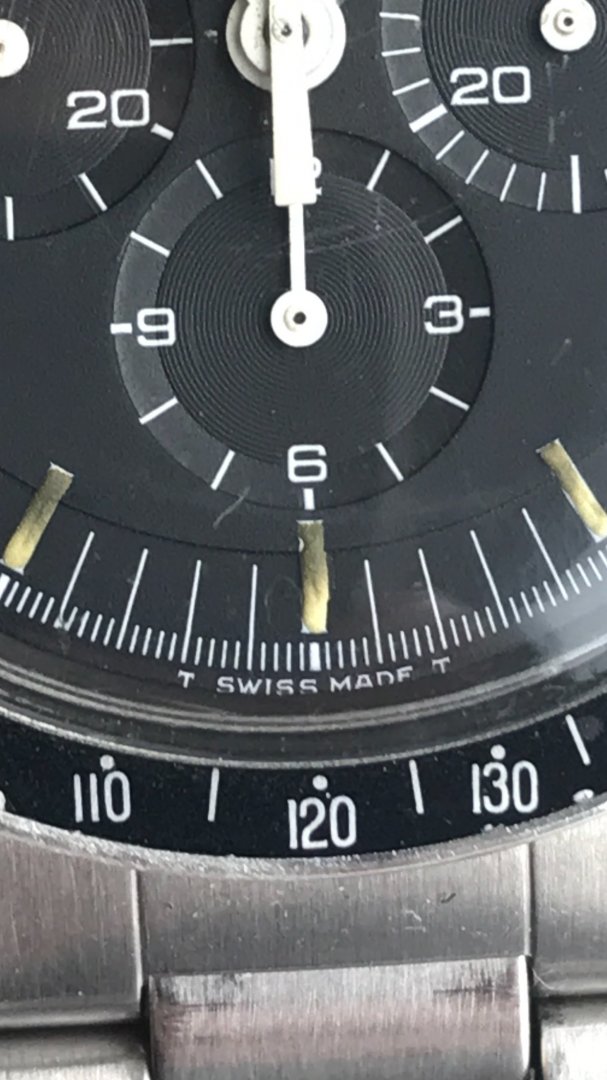

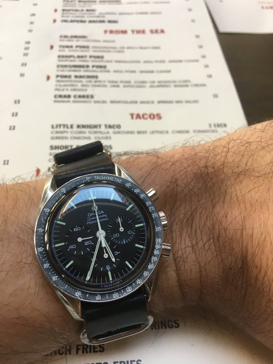

  5. Foo2rama Keeps his worms in a ball instead of a can. May 24, 2017
    17,105
    25,350
    Seems a bit high with the wrong modern bezel replacement. Dial is correct for a -74 and is an easy to ID dial.
    Lume seems off
    Correct bezel and dial for a 145.022-74. Notice the S in the Speedmaster logo does not drop to the level of the p. In domed dials only -74 and some -76 had that. For the bezel look at the dot near the 70 and the tachymeter font.
  6. sky21 May 24, 2017
    1,187
    1,854
    The sweep second chrono hand is a modern luminova replacement as well if that is a concern for you.
    arvidrattlaas and Foo2rama like this.
  7. arvidrattlaas May 25, 2017
    143
    785
    Thanks everyone. I appreciate it. I think I'll let this one pass.
  8. noiseboyuk May 25, 2017
    414
    884
    Unfortunately, it looks like it has too many replacement parts to be a viable purchase for the selling price.
  9. rcs914 May 25, 2017
    2,502
    3,593
    It would only be MAYBE worth that price if it came with a documented recent service. And that's still pushing it given the replacement parts, and that all the lume has been scrapped off the plots. I think a fair price on that would be closer to $1K less
    gdupree, arvidrattlaas and yuralagun like this.
  10. kreyke May 25, 2017
    626
    838
    Without the lume plots, it's really unattractive. I personally feel that ageing lume plots are one of the biggest attraction for vintage watches.

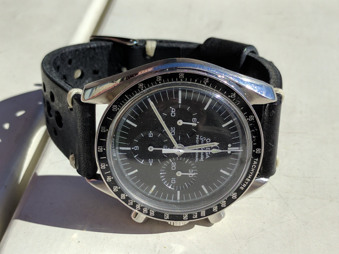

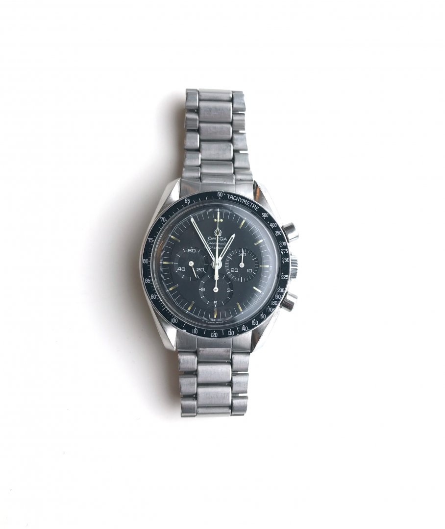

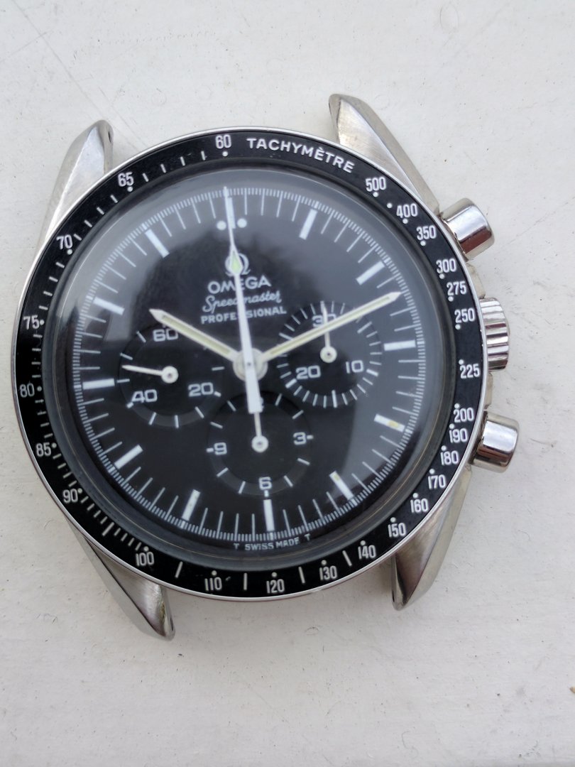

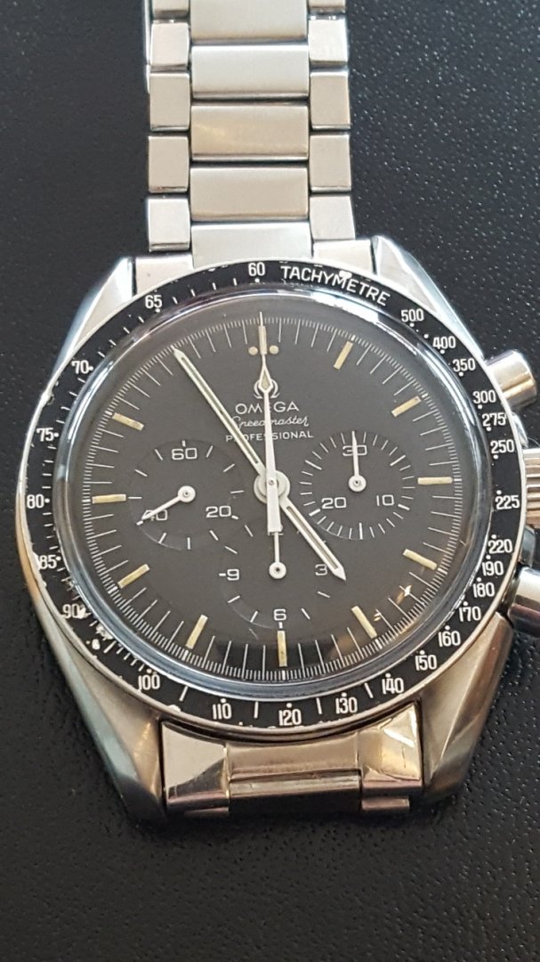

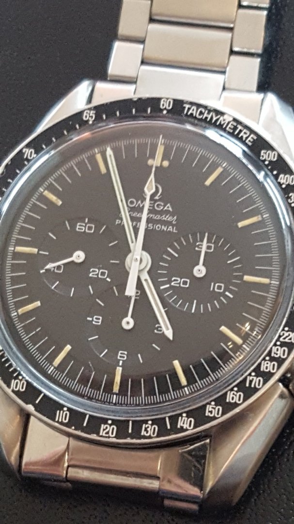

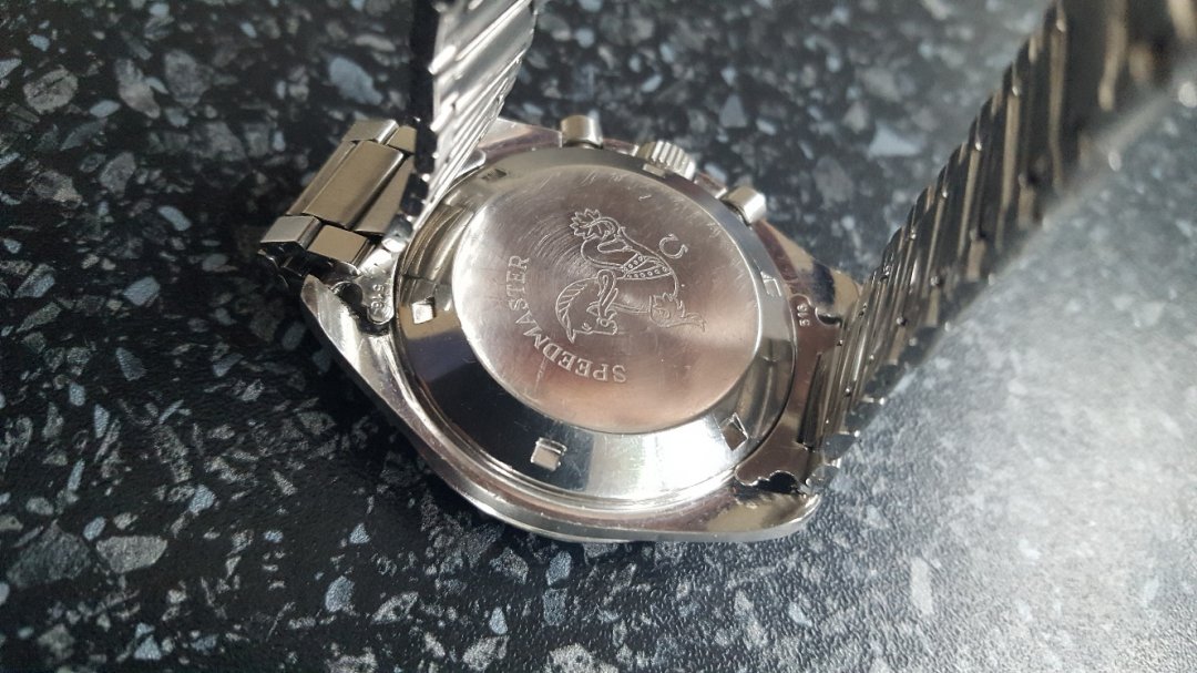

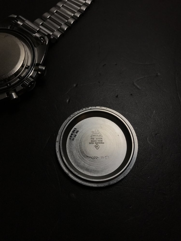

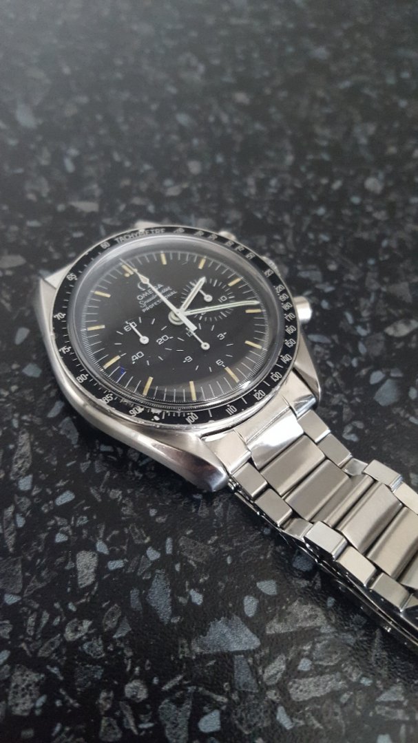

    Hi again everyone. I have come across another watch and would appreciate your comments on this offer:
    145.022 -71
    Price: 5000 USD
    Pictures:
    44252_b8a2db1e4ad15dd25d4b53e742e722f4.jpg 44254_6a94ad9820673da4ad3b7a9739cbd1e7.jpg 44255_49e2adce28e67d1fff55116cd1cff8f0.jpg 44251_45f9d2f5ebc474cae78314f7ec63442e.jpg
    The seller states that this 145.022 -71 has the correct dot next to ninety bezel, stepped dial and original hands. No replacement parts that he knows of. Original 1171 bracelet in good condition. Serviced in 2016. No B/P, but an additional leather strap is included.
    He states that the price (5000 USD) is based on similar objects on Chrono24.

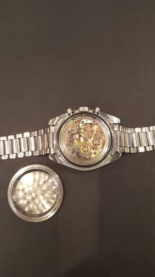

    I think the case looks sharp. But what about the rest? I obviously have to get pictures of the movement and case back, and I'll post them here when/if I get them.
    I'm no expert, but I think the price is a bit high.
    Do you guys have any comments on this offer?
  12. Foo2rama Keeps his worms in a ball instead of a can. Jun 1, 2017
    17,105
    25,350
    R3D9 and BenBagbag like this.
  13. BenBagbag Jun 1, 2017
    2,820
    8,983
    +1 This is not in collector's condition and you are paying collector's price for the piece.
  14. Foo2rama Keeps his worms in a ball instead of a can. Jun 2, 2017
    17,105
    25,350
    I'm thinking it's just below good with @$800 for the bracelet.
    Remember Speedmaster101 is head only no bracelet.
    BenBagbag likes this.
  15. arvidrattlaas Jun 2, 2017
    143
    785
    Thanks for the advice.
    Additional pictures: 44309_866e743ede1797af3770aecd0fe9fd4f.jpg View attachment 398050 44311_c3432dbdd5e4553f64997b147f87fb4b.jpg
    What do you guys think?
    Condition good + 800 for the bracelet = 4300 usd? Fair price?
    Edited Jun 2, 2017
  16. Nathan1967 Jun 2, 2017
    1,413
    2,836
    Have a look in the sales section here, our leading Speedmaster expert Spacefruit has a very nice Pre Moon Speedmaster for sale for a little more. If you have the money consider buying that one.
    All the best
    Nathan
    R3D9, arvidrattlaas and shishy like this.
  17. Foo2rama Keeps his worms in a ball instead of a can. Jun 2, 2017
    17,105
    25,350
    It's your money and you have to look at the hour marker at 4 o clock and the missing paint on the seconds sub dial hand.

    A wise member told me once "better to pay slightly more for the right example than pay less for the wrong one"

    An additional photo now showing all of the hour markers:
