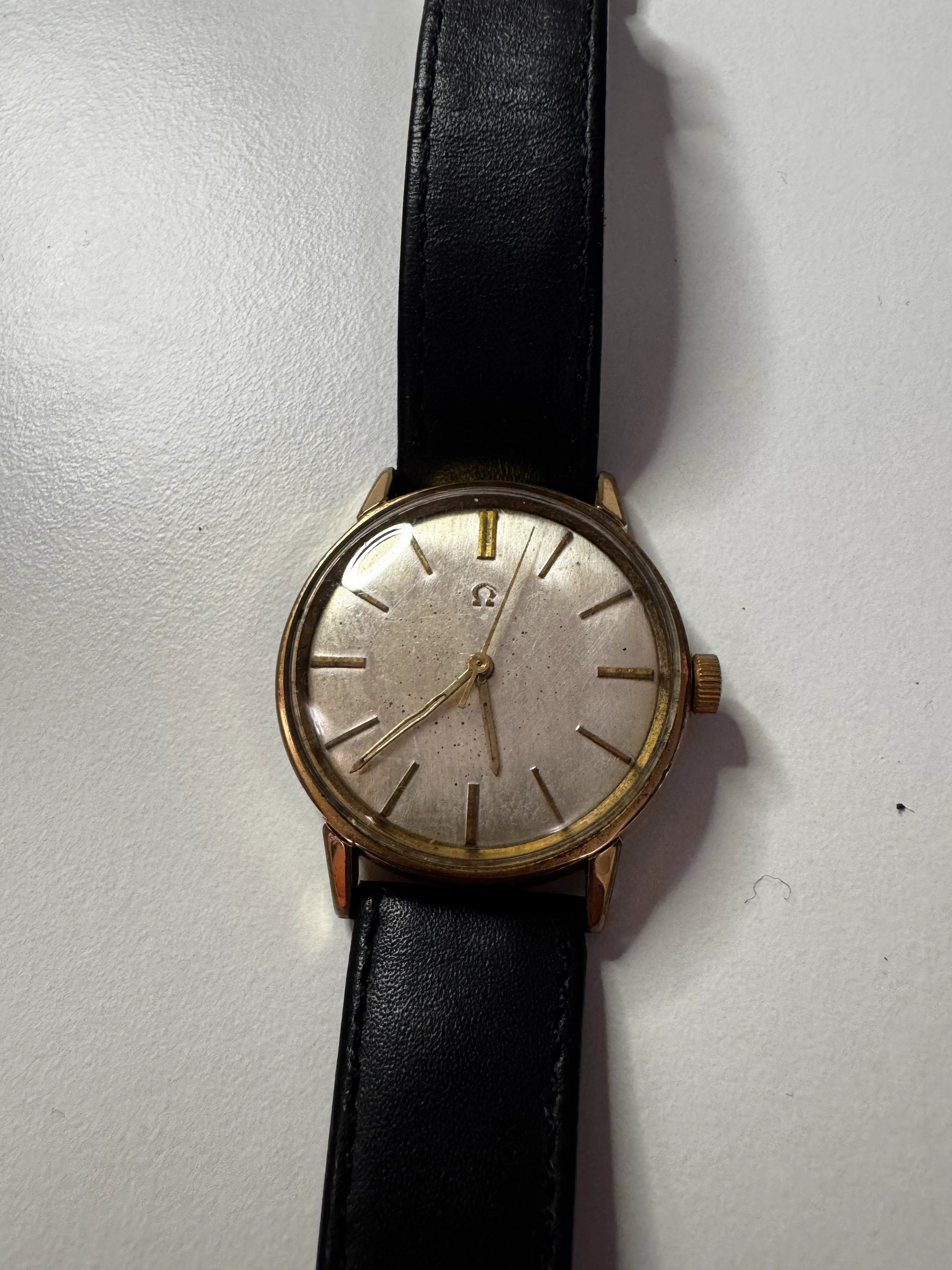

I purchased in my early days (15y ago) an Omega watch and only now came to appreciate watchmaking and wanted to put it back in a great shape.
The watch is likely a ref 135.011 (caliber 601), here are a few pictures:
The watch is not working anymore, and it seems like it has been redialed.
I'm a bit in a pickle now, I have quite some watchmaking tools and saw a couple of videos that make me feel confident about working on it myself.
Furthermore, the value of the watch (especially in these conditions) will not justify a hefty servicing price.
On the other hand, I'm pretty sure it might turn into a disaster.
The watch was bought for cheap and holds no sentimental value.

To be frank, the watch is not in good condition. The dial has been harshly cleaned, the hands are bent and the case is terrible with loss of gold plate in several places. I would not advocate spending a penny on this watch and would say it’s a perfect example to tinker on yourself

thanks, that was my plan and it's good to see it wasn't a crazy idea.

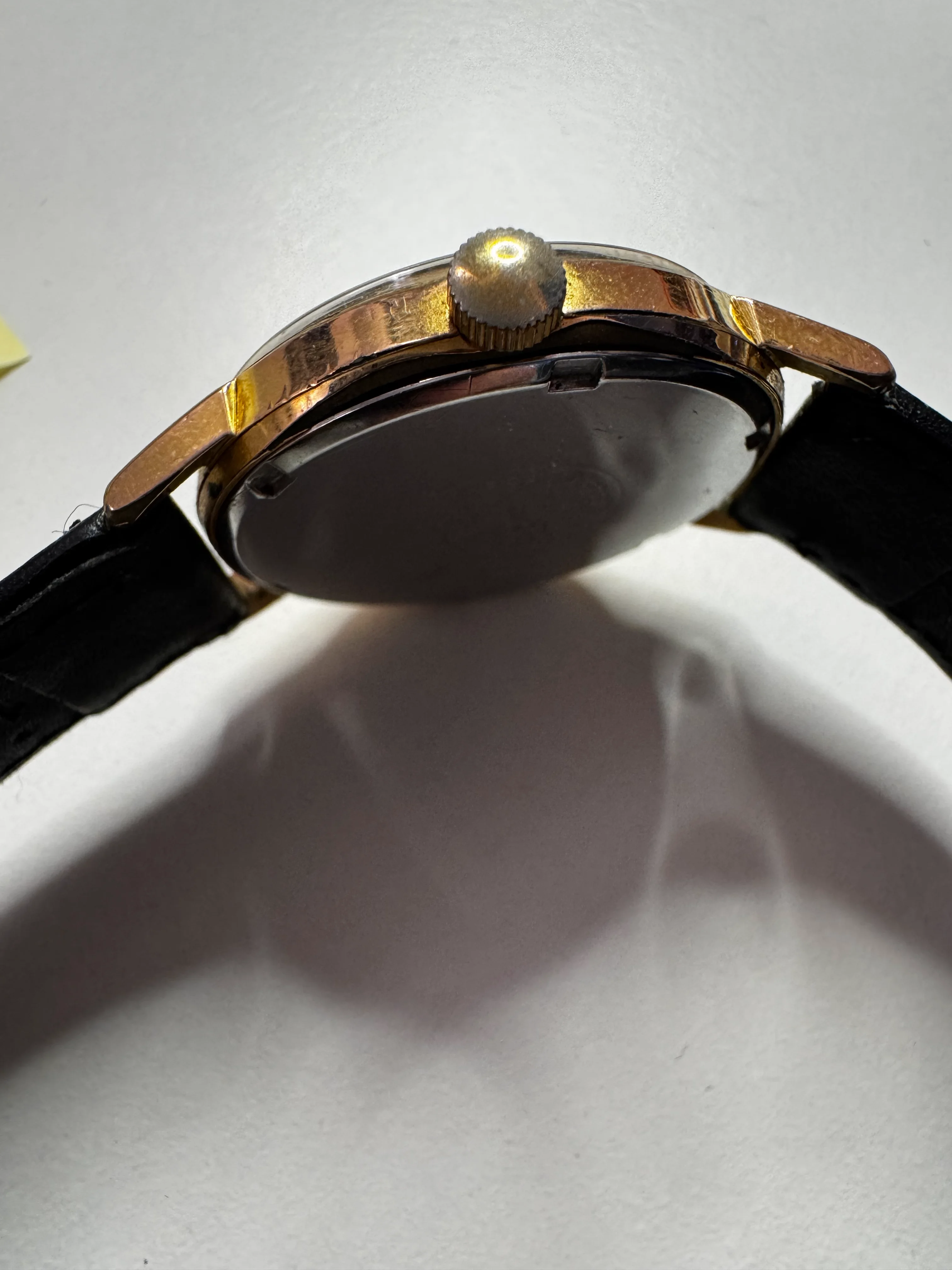

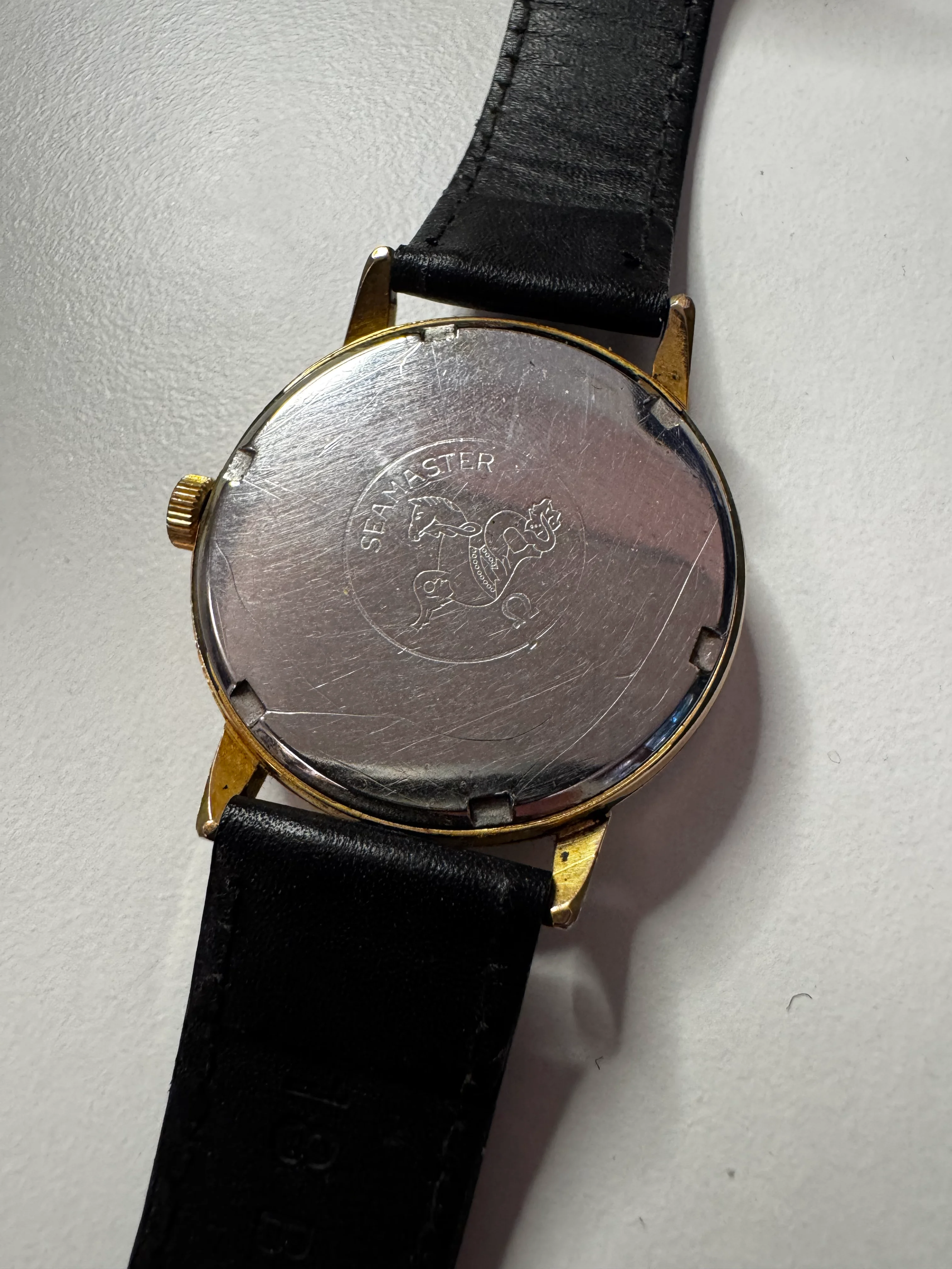

Side note: That is a front-loader 😀 Make sure you're aware of that!
1,204
1,248
Is it not? It looks like it has clamps pulling it to the back of the case? Am I mistaken?
1,204
1,248
Ah, I looked closer/zoomed in, it looks like the clamps might be under a 'tab' so it could be removed from the back. If so, disregard the above.
I'm a little sensitive to paying attention to those, the previous watchmaker of my 601 tried to remove a frontloader from the back, and severely damaged the dial.
2,686
4,271
You need a special tool to open the watch through the crystal. Often there will be a number on the back of the case.
I looked at the OP photos again to look for that number and see this is not a front loader. (others are answering at the same time.)
I think what Erich is noting is that the dial is larger than the back opening. So the movement only comes out the front. There is a tension ring under the crystal which holds the dial in place. Sometimes the whole bezel assembly has to be removed. The clamps often come loose or are lost so this adds extra securing.

Ah, so this IS a frontloader? My 601 (which is similar), you have to pull the bezel, not the crystal to get the movement out through the front, so there isn't really a 'tool' for it. I saw the tabs and suspected on the dial, but wasn't sure (since obviously there is no clear scale).

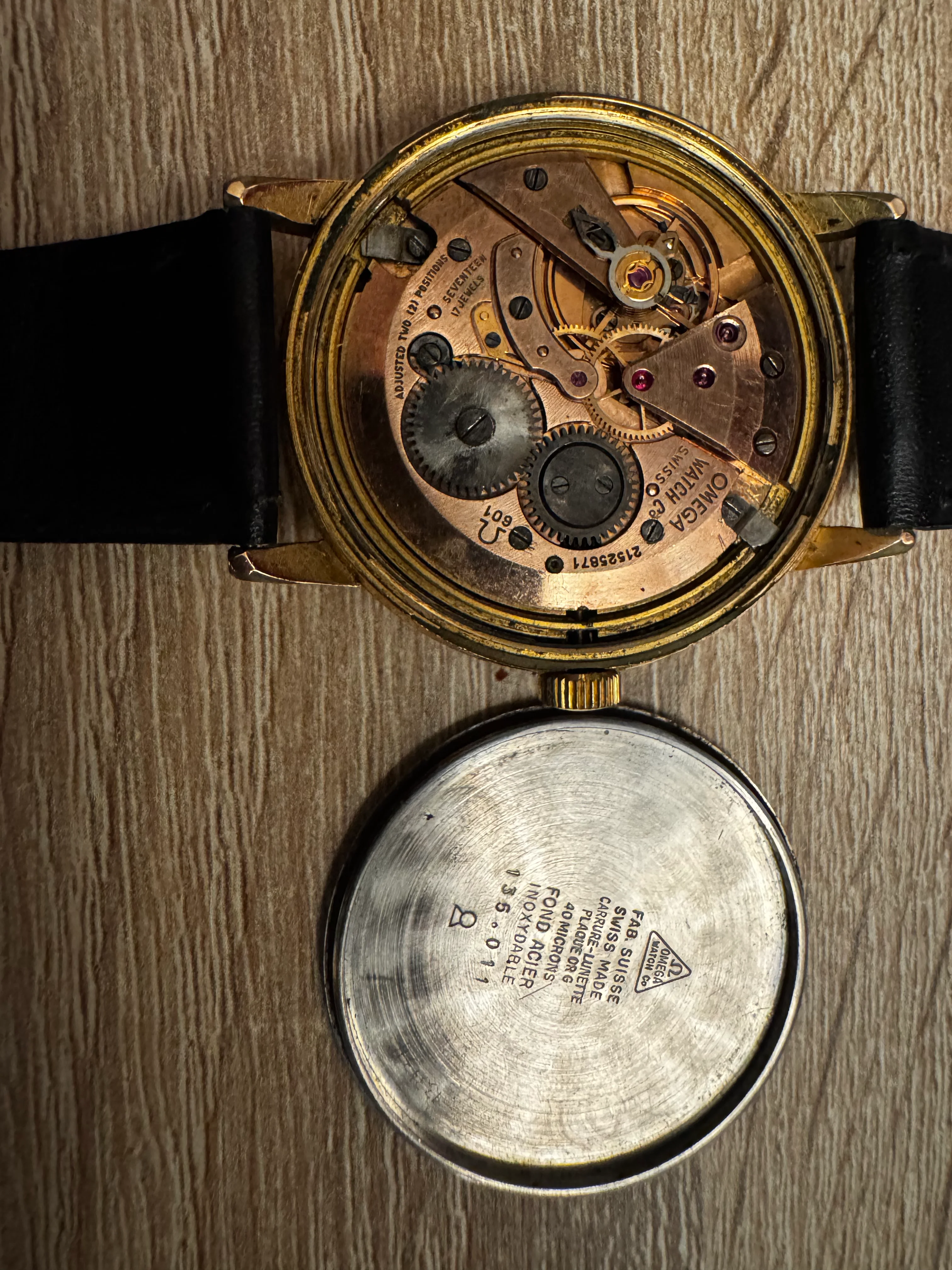

so the adventure begins, I found a few things that might need attention on the watch.
while waiting for some parts, I practiced a bit removing different components and a couple of things stood out, the most notable being the escape wheel stuck.
I checked and it seems the bottom pivot is gone, I'm wondering where one can find good genuine spare parts (or equivalent)? probably a noob question - apologies if that is the case
1,204
1,248
601 parts are all over ebay, one of the easier movements to get stuff for.
4
thanks - I saw a few but I'm from switzerland, and deliveries are quite complicated. I'll check for deliveries to italy, I'm there often.
