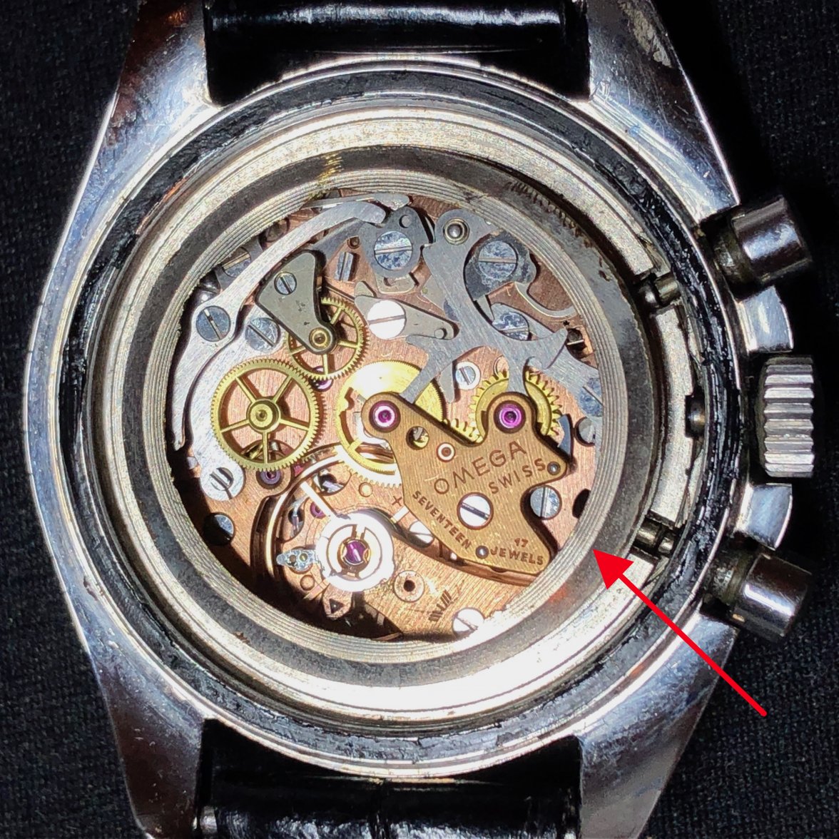

    We are talking about a SpM 145.022-69 with a DON bezel from 1970 (Serial 2911...) offered by a local pawn shop.
    IMHO, there are PROs (DON bezel) and CONs (condition) - I do have a talented watchmaker tough who could fix various damages... So my three main questions would be:
    1. I am confused about the caliber case - my other 145.022-69 (DNN) does not have this "inner ring" with a kind of thread (marked on pic below). What is the function of this ring? AND, are the damages visible on the ring a major problem?
    2. Any other inconsistencies you might have spotted?
    3. Would you buy it for € 4000 (4500 USD)?

    I think this ring is some kind of replacement for dust cover.
    Watch looks nice and price is fair.
    DON is also in fair condition..

    Chocolate dialed 69er with a decent don for $4.5k ... better hope its still there ...
    Edit : VAP @ $4.5k, thats what...the bezel and the midcase (if unpolished)?

    In addition to a "fabricobbled" replacement spacer that is used in place of the anti-magnetic cover, the balance cock is missing the fine regulator.
    Given that level of butchery, I have reservations regarding the condition of the movement that would give me pause...
    Cheers, Al

    I tend to second Al here. A chocolate dial remains attractive till you eventually realize it's been glued to the movement by the master butchmaker who cared of the watch :whistling:

    something tells me you'll be into it for A LOT more after all the work that is needed to repair it, as long as you're willing to to take that risk, proceed. personally, I'd pass, but that's because I don't particularly fancy chocolate dials, and I like examples that don't come day 1 with so many issues.

    Even without the movement issues I'd want to see a better picture of that dial before I advocate skipping merrily back to the shop, cash in hand.
