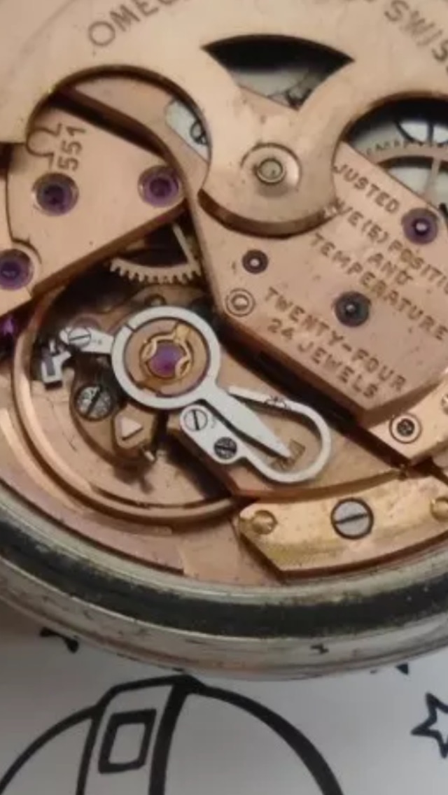

Hello all and good morning,

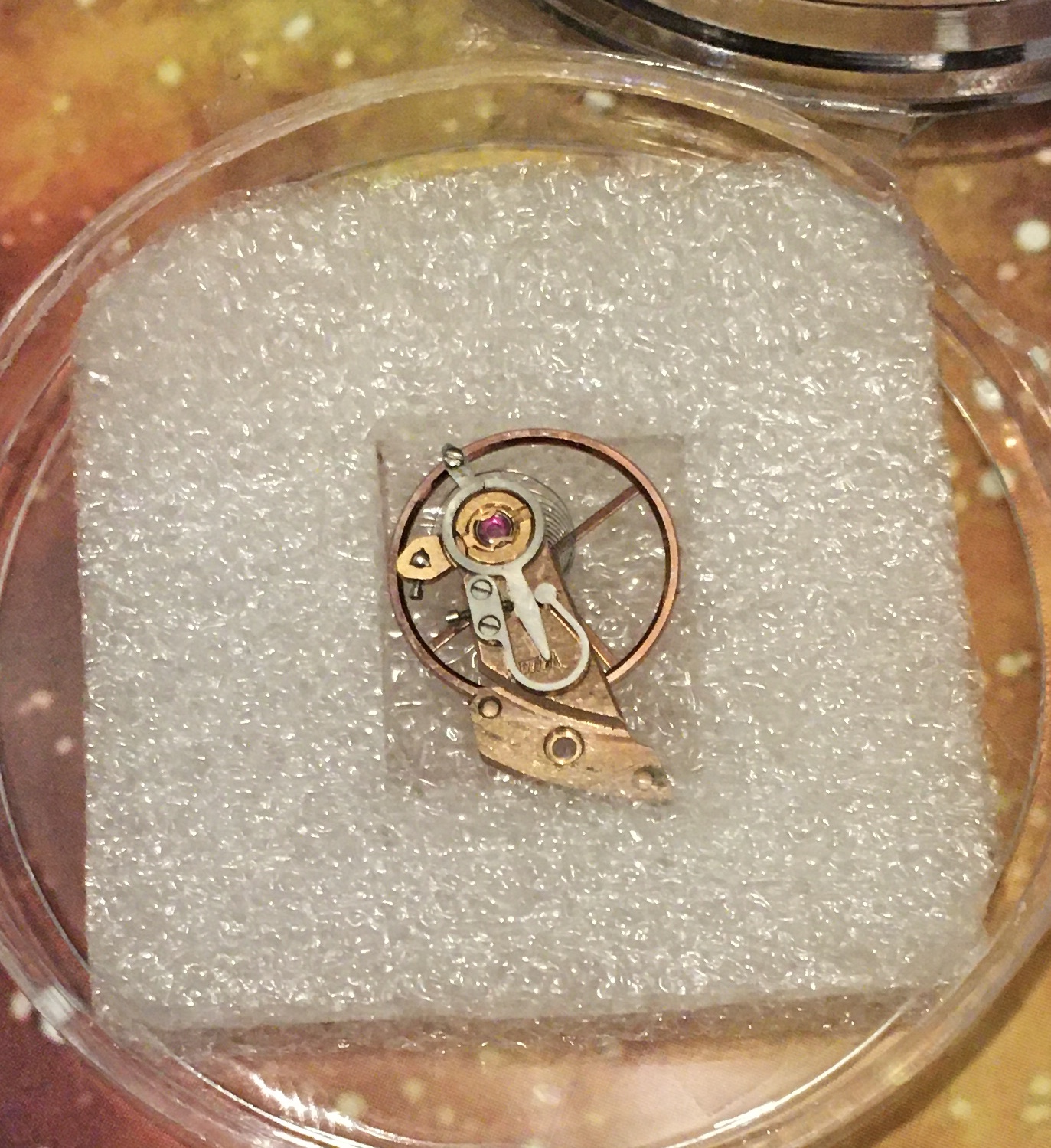

So, I have a lovely Omega Constellation rail dial that I got a good deal on BUT it needs a new regulator screw (the screw you turn to adjust it, as the one on the current balance is broken off and stuck in place. I came to the conclusion that finding the replacement screw and removing the stripped one would be difficult so I thought I could just replace the whole swan neck part of the balance wheel. Is this easy to do?
Most importantly, I have found many complete balances for sale but all of the swan necks have a ball on the end of the curved neck.... however, multiple people on ebay have told me of the following :

However the swan neck portion on my 551 is definitely different than some of those movements as it does not have the "ball" on the end of the curved neck. Is this truly interchangeable despite looking different? I am skeptical and have included pics. Any help would be appreciated, including advice as to whether this would just be a simple cheap repair for a watch maker and I should just leave it to them.

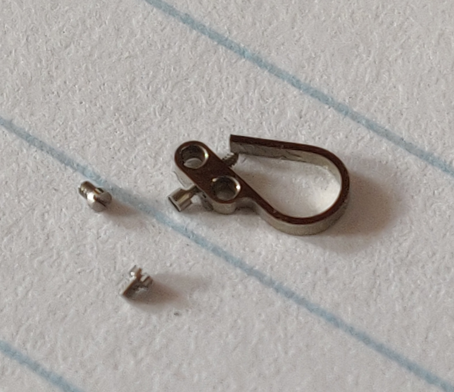

Here it is
It is from a 551 in 19 mil serial # and the adjusting screw is moving smoothly .
You can have it free but you have to pay for postage from Canada .
"all family 550 560 and 750 have the same balance wheel.
All you need to change is the adjusting spring for the regulator. This really has nothing to do with the balance itself. The second photo you show is of the entire balance cock with the balance installed on it, and you don't need to buy all that to solve this problem.
Note that the flat style without the ball is the only one Omega still sells, and if Omega were repairing this, that is what they would install on your watch. From a functional standpoint, it makes no difference if it has the ball or not.

The part arrived today in the mail. Again, I can’t thank you enough. I’ll see you when I eventually do my road trip to Alaska!
