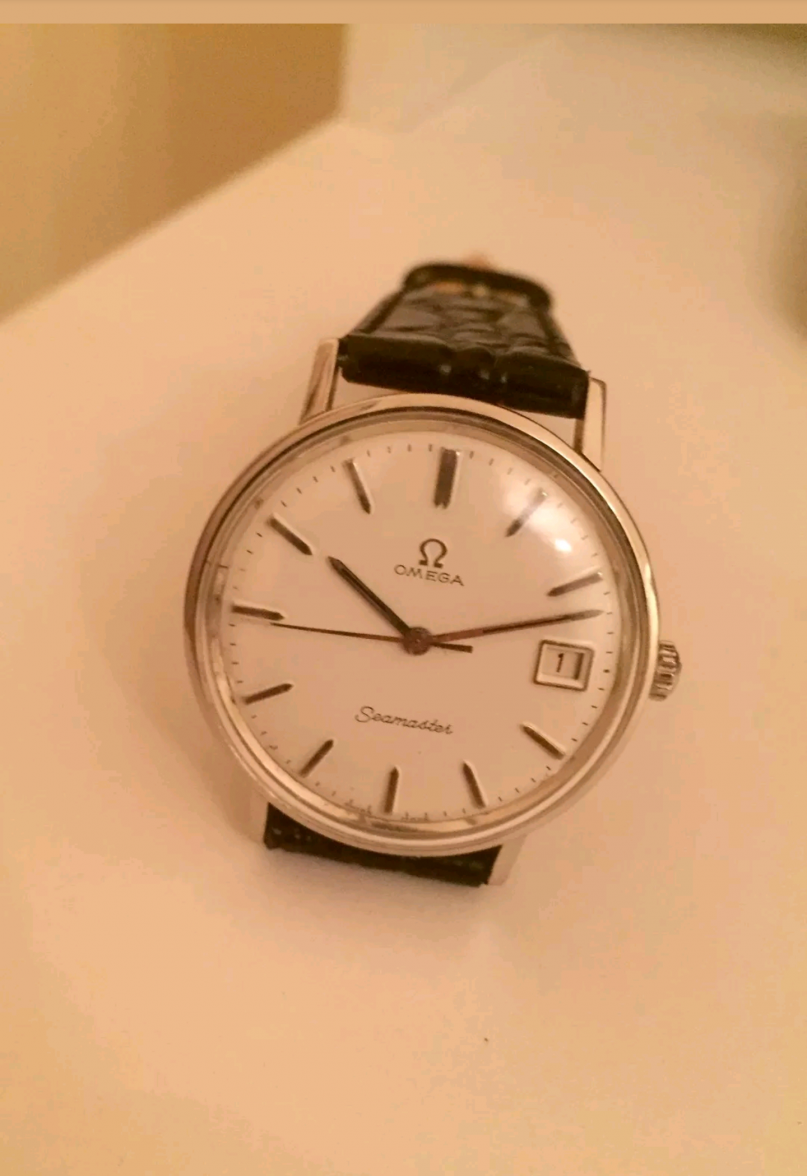

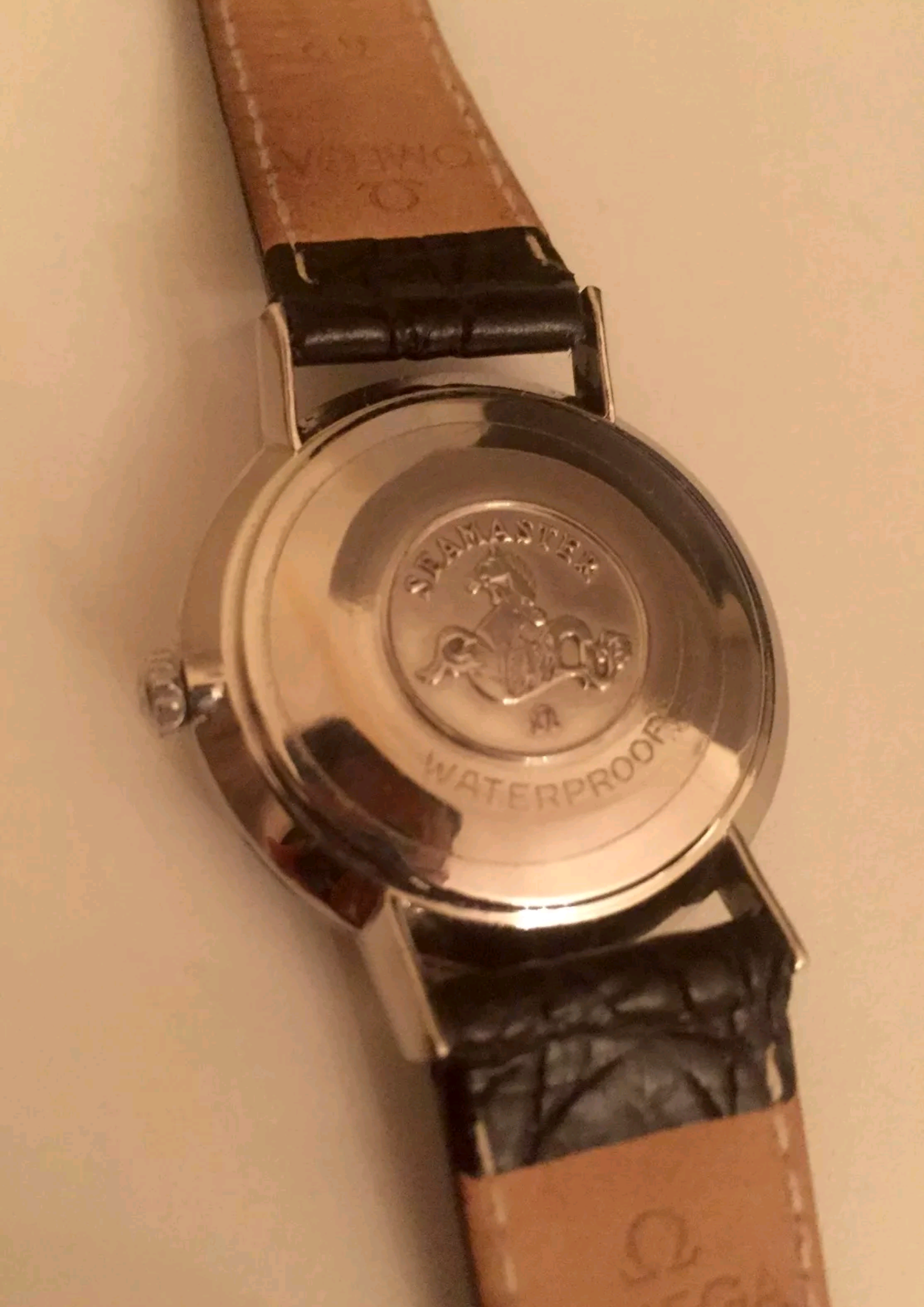

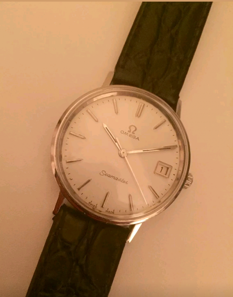

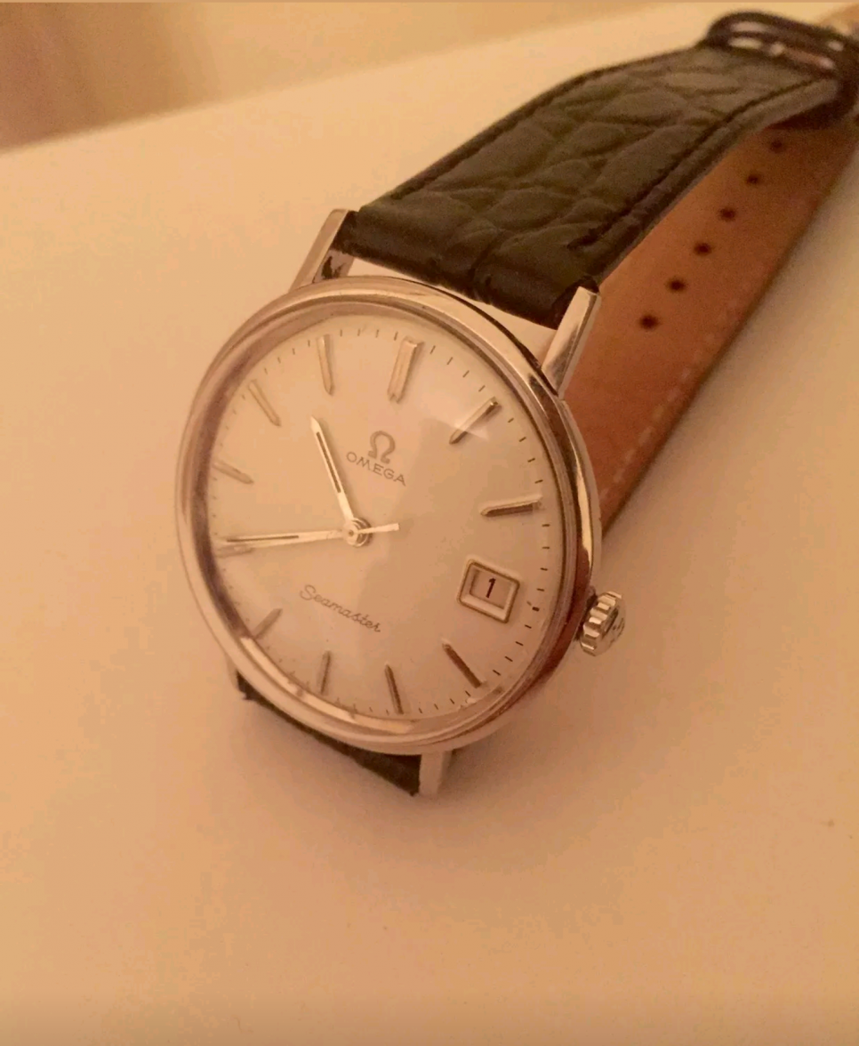

    Hi everyone,
    Im looking to buy my very first omega and this forum has been helping me tons (huge thanks!). I saw this seamaster vintage, cal.610 on eBay and would like your thoughts on it, i find it really beautiful and it looks relatively genuine to my untrained eye ( i note there is no "antimagnetic" across :D)
    However the seller hasn't posted any pictures of the movement and description says everything (dial, crown, movement) is original.
    Would really appreciate any feedback/comments if something looks odd on the dial or case from these pictures
    Thank you!!

    This movement is not easy for inexperienced people (such as myself) to remove as it comes out of the front of the case, so the absence of a movement photo is not necessarily a red flag. There's nothing obviously wrong and the dial looks ok to me, though the photos aren't as sharp as one would like. Probably taken in low light with a not terribly good camera. Overall I quite like it.
    EDITED TO ADD: I've just looked at the blowup of the first photo and the "Swiss Made" at the bottom looks a bit clumsy. Hmm....

    Yes, and the minute markers look painted on the sides. I think it is a redial.

    That is quite a beautiful watch and I am curious as to your intentions.
    If you want a nice vintage-style watch to wear, find out the service history. If no luck, assume the worst and figure in a hundred or two for a good service.
    If you are looking for a collectible, I am concerned that the dial has been repainted ("SWISS MADE" should be closer together and centered overall, not by word), the minute markers have issues (off-centered and close to the bezel at 6, much more distant at 12) .
    If you are looking for a nice daily driver, get a verifiable service history, see the movement or anticipate the worst.
    If you are looking for a collectible, this one seems to have issues in my humble opinion (imho).
    Attached cal. 610 photo shows the traditional swiss made, the issue I speak of.

    Yups. Minute markers and swiss made look off. Shame, because the Omega and Seamaster look okay. Must have been a sloppy clean-up job that resulted in damaging the markers.
