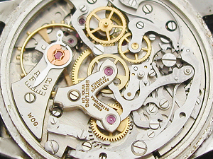

    hi,
    [​IMG]
    I found a navitimer 806 (1964) with this movement: rhodium plated, unusual signature, unusual balance cock.
    any thoughts?
    thank you all - h.u.

    Never seen something like this before...
  3. nicolas07 May 31, 2015
    197
    238
    Never saw something like this before indeed.
    As you said, balance cock is unusual...
    What bother me the most is also the missing import code: should be WOG for such period, stamped on the balance bridge
  4. marturx May 31, 2015
    2,266
    4,214
    What does it say under the balance? Venus 170?
  5. nicolas07 May 31, 2015
    197
    238
    Should be 178 if correct...
  6. _Dracha_ May 31, 2015
    49
    98
    strange ,
    I cant read what it says 170 or 175 or 178 ?
    also all Breitling movement mainplates (from that period) were signed with 'TJ' below the 17x model marker
    but I have never seen a rodium plated venus movement in a Navitimer , I am certain movement was replaced
    Edited May 31, 2015

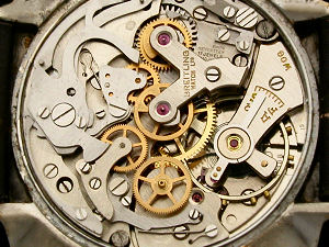

  7. _Dracha_ May 31, 2015
    49
    98

    Are you sure it isn't the reflection? I've had quite a bit of fun photographing watch movements and making the parts look like different colors.
  9. _Dracha_ Jun 1, 2015
    49
    98
    Hi Eric
    the normal colour is 'copper' , looking at the yellow paint on the 'Breitling LTD' there does not seem to be much colour shift ?
    and you'd be hard pressed to change a movement colour from 'copper' to 'rhodium' ? also the seller describes it as rhodium so I doubt very much its really another colour :)

  10. Eric_navi Jun 1, 2015
    234
    1,517
    Ah, yes, 100% correct... never seen this on a Navitimer.
    Here are some movements with similar engravings and Rhodium. None of these are Venus 178, and not commenting on the "correctness" of these pieces, but figured I would post them for comment. The first one is marked Venus 175 and comes from a Chronomat ref 808, appears to be the same bridge. the others are Top TIme
    http://www.farfo.com/menswatches/Page3/breitling_geneve_chronomat_808_217012.html
    http://www.farfo.com/menswatches/Page1/breitling_top-time_vintage_square_chronograph.html
    http://www.actimepieces.co.uk/watches-for-sale/stock-watches/wwom003/

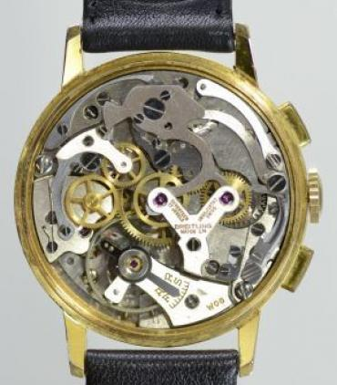

  11. minutenrohr Jun 1, 2015
    1,884
    23,461
    Thank you all. i´m sure its a 178. And i don´t like the big/golden Breitling signature. The auction is mine, but i don´t want to fool anyone or use this forum to announce the auction. i´m only curious, what kind of mariage (?) this could be. I bought that navitimer last week from a friend and can return or swap it at any time. As mentioned in the auction text its from 1964 and the lugs are a bit polished, but the face is nice...

  13. _Dracha_ Jun 1, 2015
    49
    98
    balance cock sig is correct , even for a navitimer from certain years, Breitling used various signature designs and this is one of them
    but the rhodium plating isnt correct for a navitimer
    have you been able to decipher which model number is on the mainplate (170,175 or 178) and is there a 'TJ' below it ?
  14. minutenrohr Jun 1, 2015
    1,884
    23,461
    ...i hope this is better to look on:
    [​IMG]
