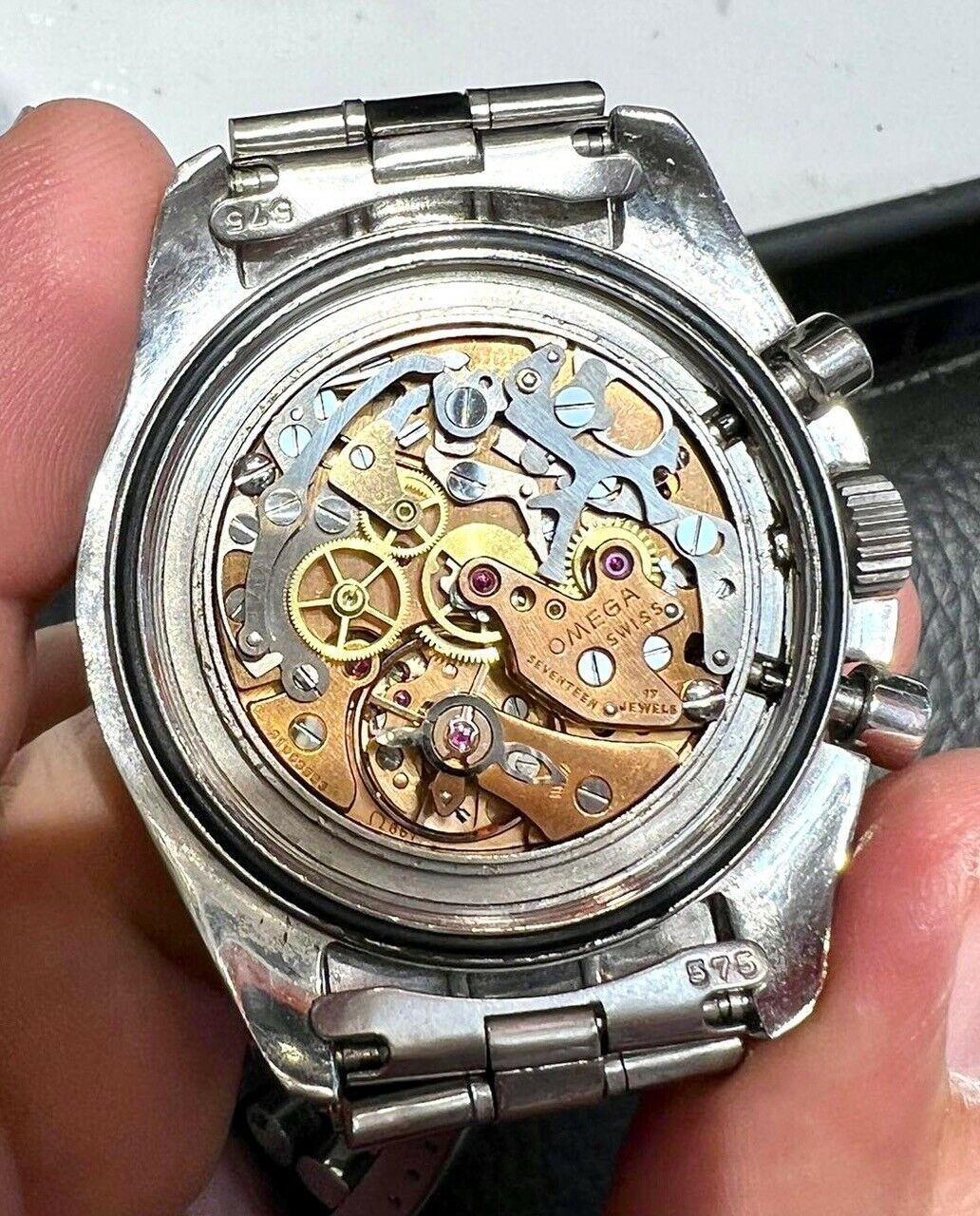

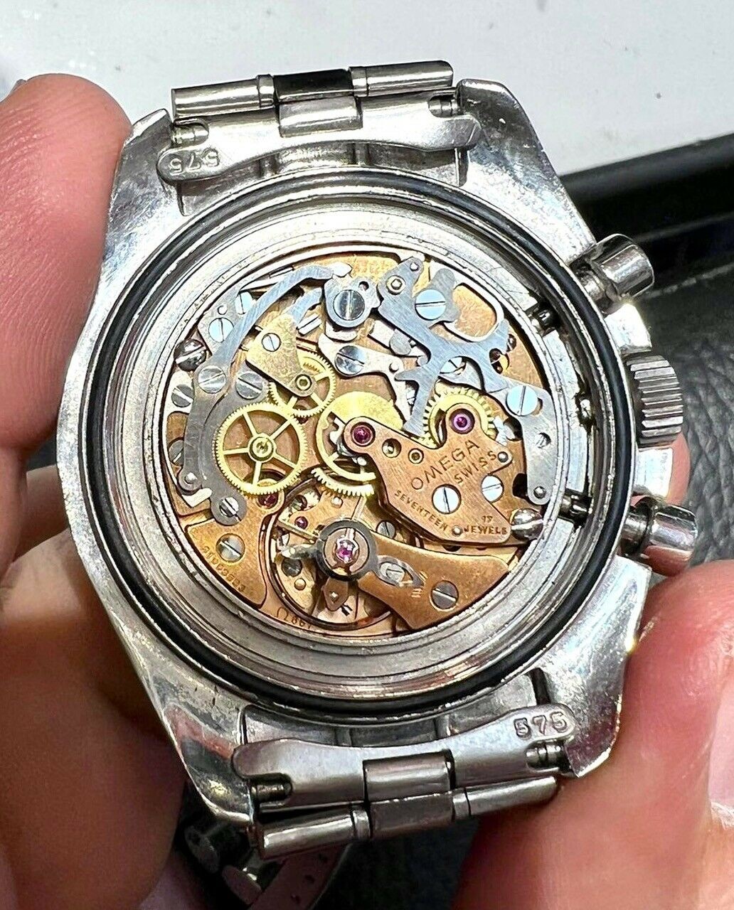

Hi all,
This was sent to me by the seller, serial number 310xxxxx.
The original lume is definitely gone from dial, and yes I think the hands are newer, they definitely have "glow" but not tritium.
Is it possible the original owner wanted to clean up the watch ? , Maybe done in mid 2000 before these watches started going up in value?
I don't have a picture of the back of the case cover, but I plan to open it up and have a look.
Would a 145.022.69 ST have a 1972 or 1973 manufacturers date and a pre-moon back ?
348
306
according to the serial number, it was produced at the end of 1971 and it is consistent with a premoon model
