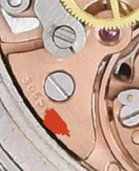

Unless I am blind...
I did this also, starting with 26.. .... and it said 1968 August and like yours, 321 movement.
I'll try to see the watchmaker today and confirm and serial number. I sure appreciate all the input.
Steve
10,804
16,814

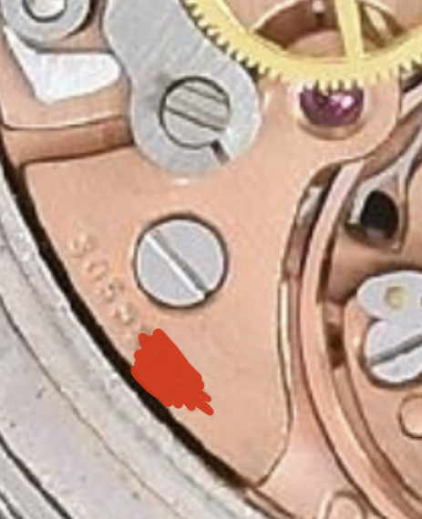

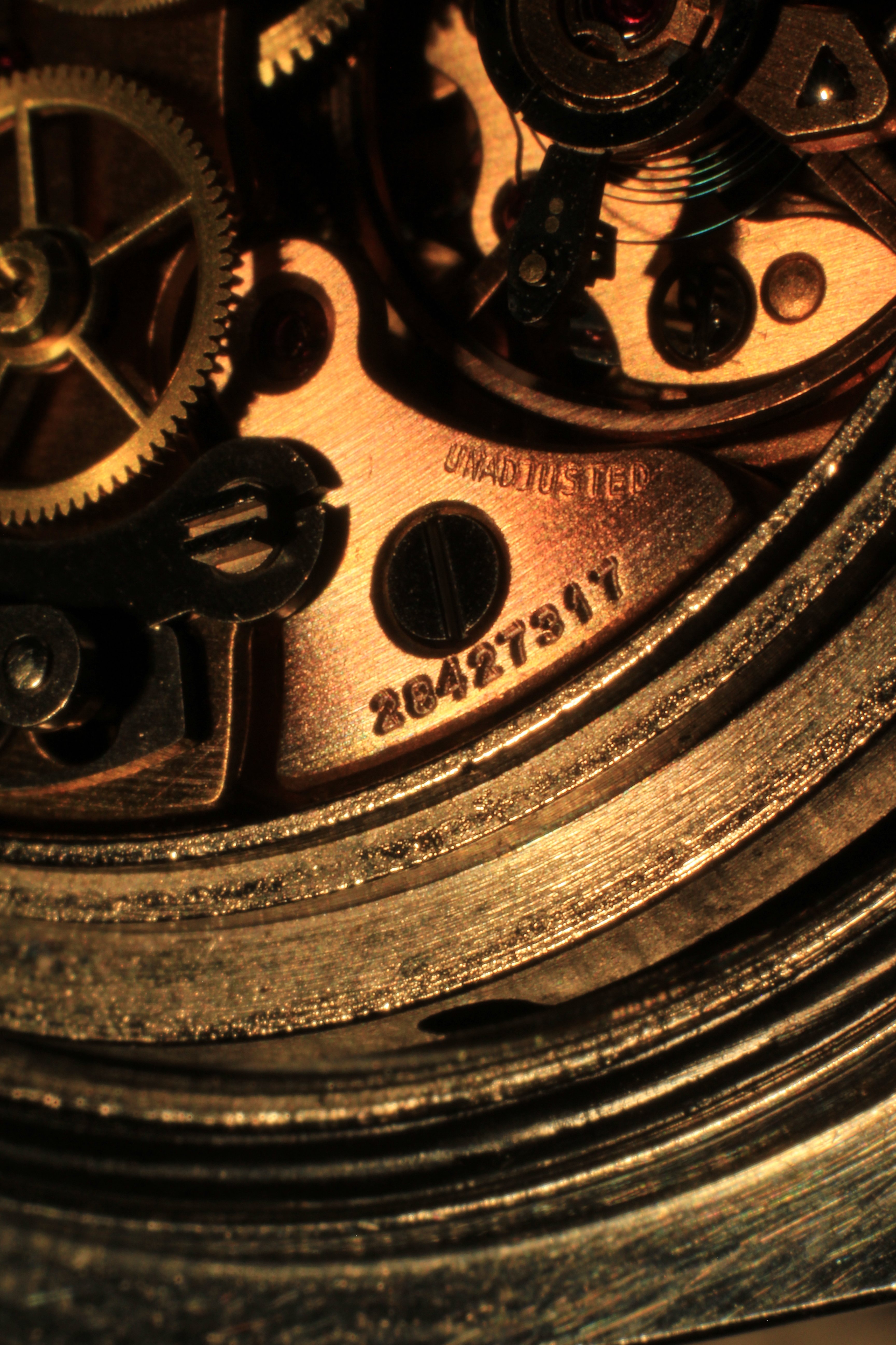

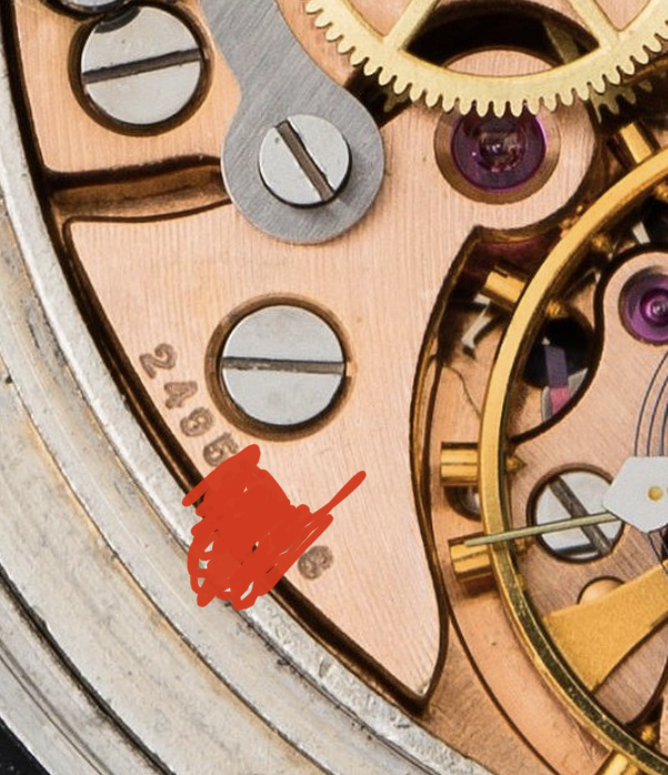

Omega serial stamping can be very deceptive. It’ll likely be 28m, the 8s often look weird. It can’t be any earlier than 26.55m as otherwise it couldn’t be a 861 and it shouldn’t be 26m on a -69 unless it’s had a bridge or movement swap. If it’s not 28m then something is wrong.
316
278

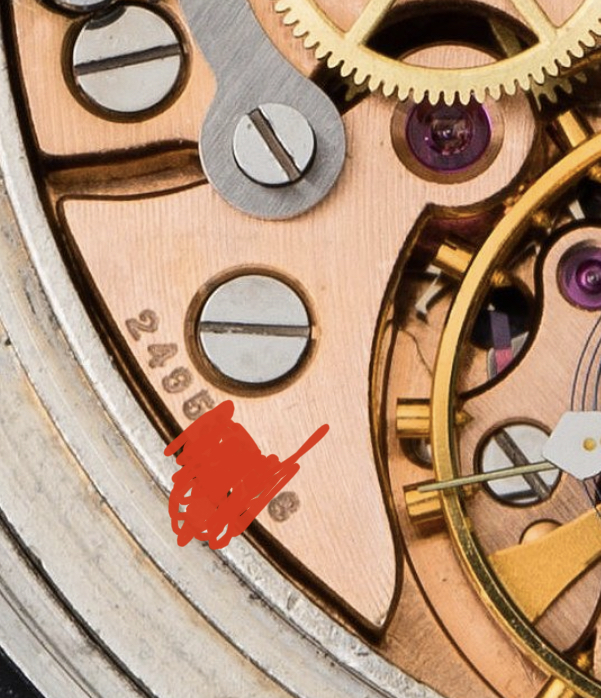

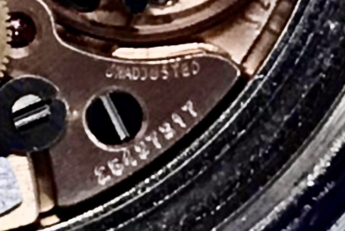

I think you need to look at it with a loupe or get a better picture with multiple light sources to remove shadows. I would bet that it is a 8 on there.
The shape of part (can’t remember the name) is a 861 part an not a 321 part. So it would be extremely odd if it would be a “5” on there. Notice how the 861 is softer in its shape and the 321 a bit sharper.
861:
321:
521
410
never say never with the 60's omega parts bin manufacturing line, but 28m makes the most sense.

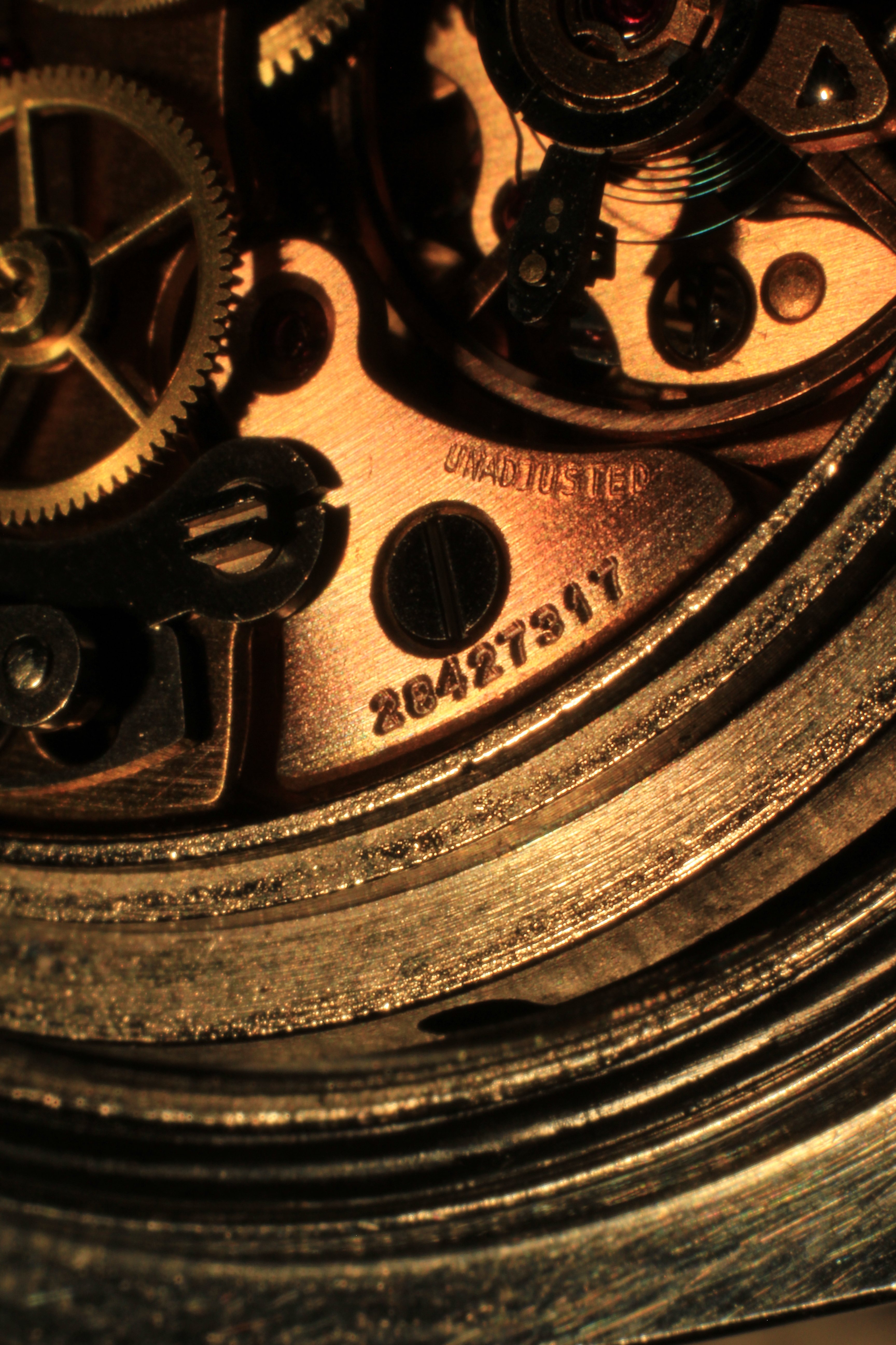

chicken dinner winner!! gotta be a 28

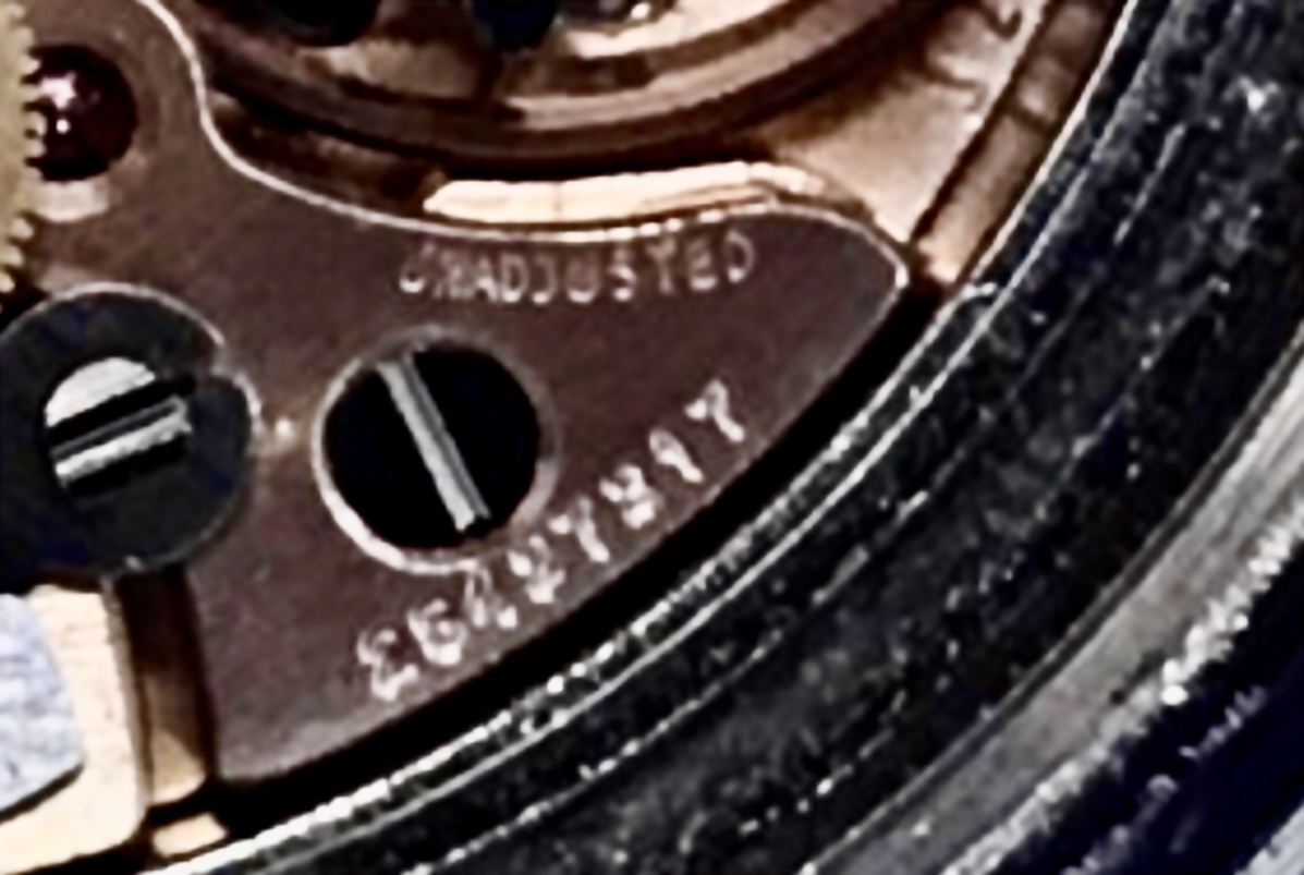

Crazy how the ‘8’ looks like a ‘5’ in the other pics 😵‍💫
...my guess would be that it says 28427... From experiences with serial numbers it is sometimes hard to tell difference between "6" and "8".
2,519
17,845
My attempt to milk the image
I originally thought it was an 8 too. Now, I think it’s a 5
2,012
3,409
It must be the shadow. Or smoke and mirrors 😉
