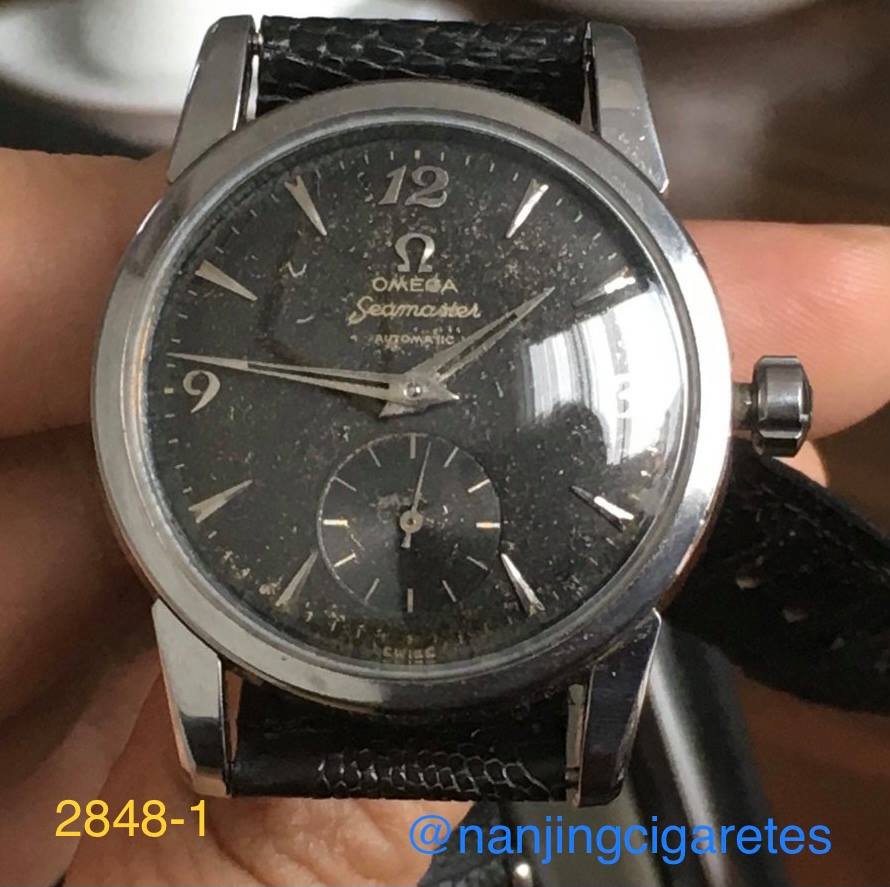

My new omega ref.2848-1 with original black sub-second dial.
1,024
4,126
Hello all omegaforums’ members.
I want to share another watch in my collection.

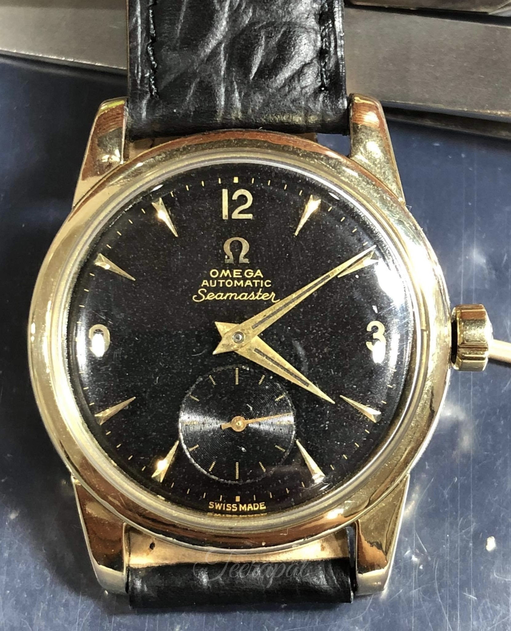

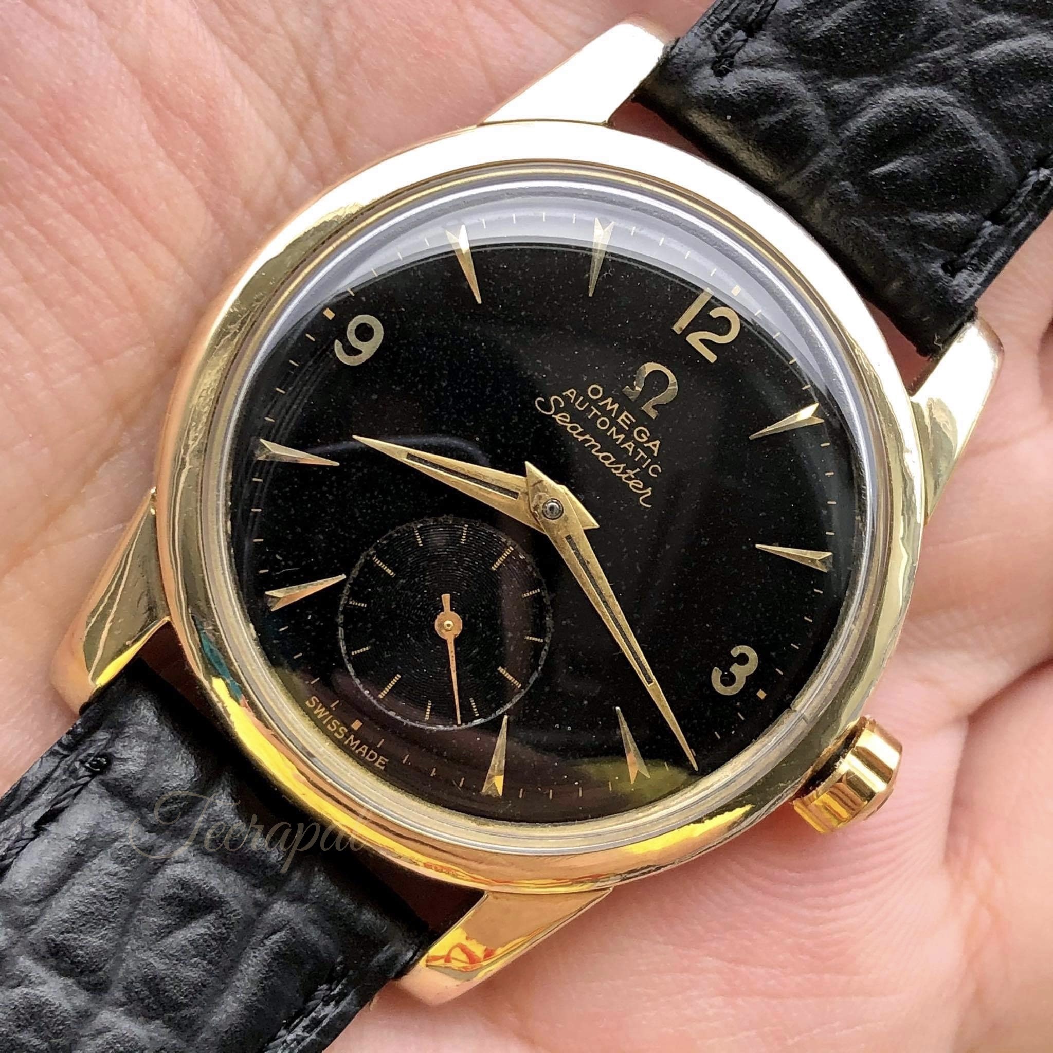

It was Omega seamaster ref.2848-1 with uncommon original black dial, serial no. 14,66x,xxx (around 1955) and powered by caliber 491.
In my opinion,

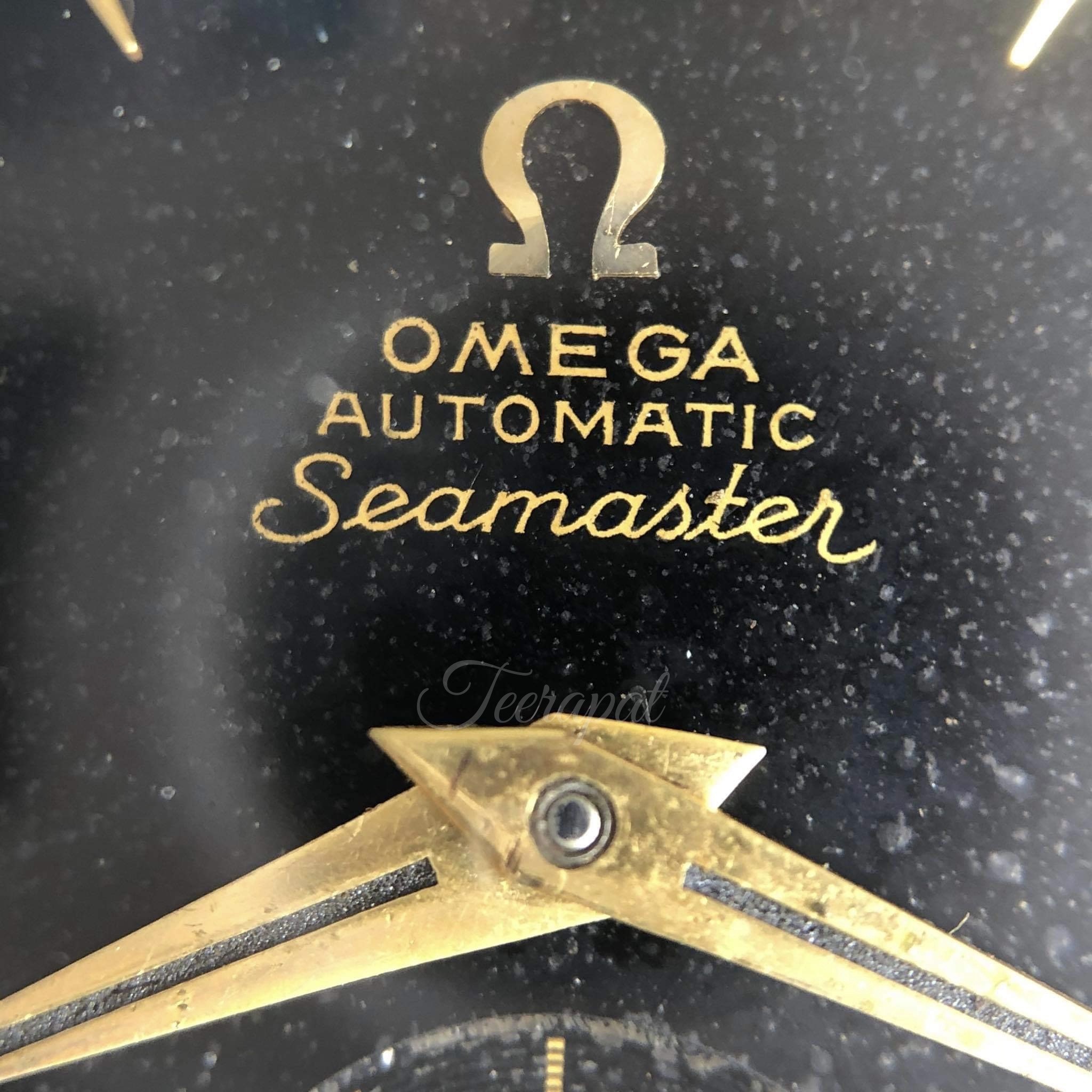

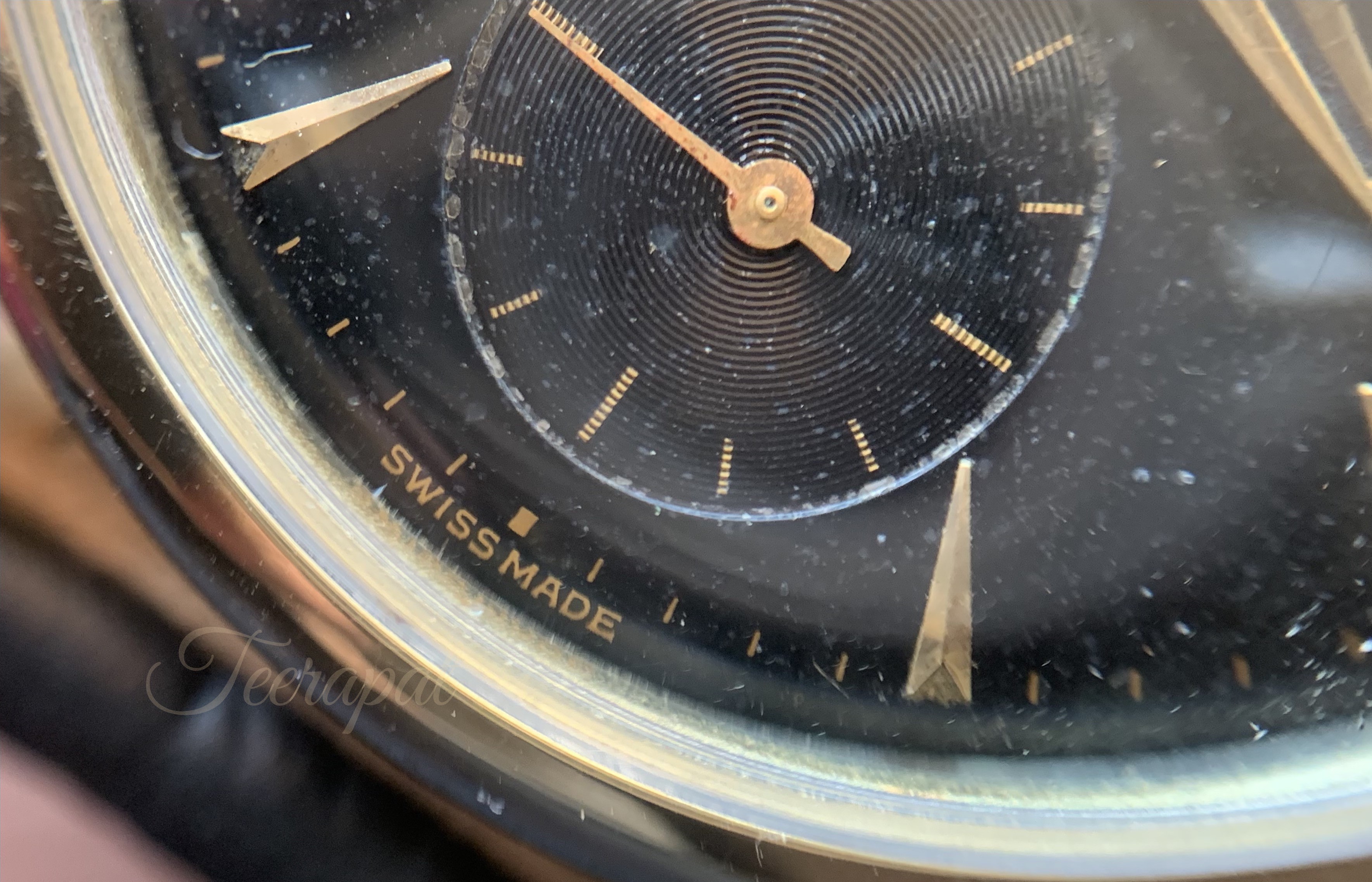

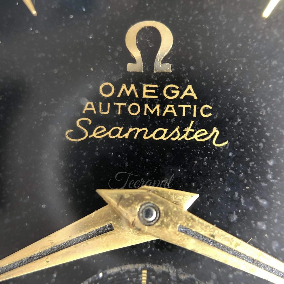

- The dial was original with patina spots spreading around this dial
- The font of “OMEGA , AUTOMATIC, Seamaster,” was correct and original
- The hours markers were original with mixing with “Arabic number at 6/9/12 o’clock"
- The luminous in hour-markers was intact and original
- The hands were original

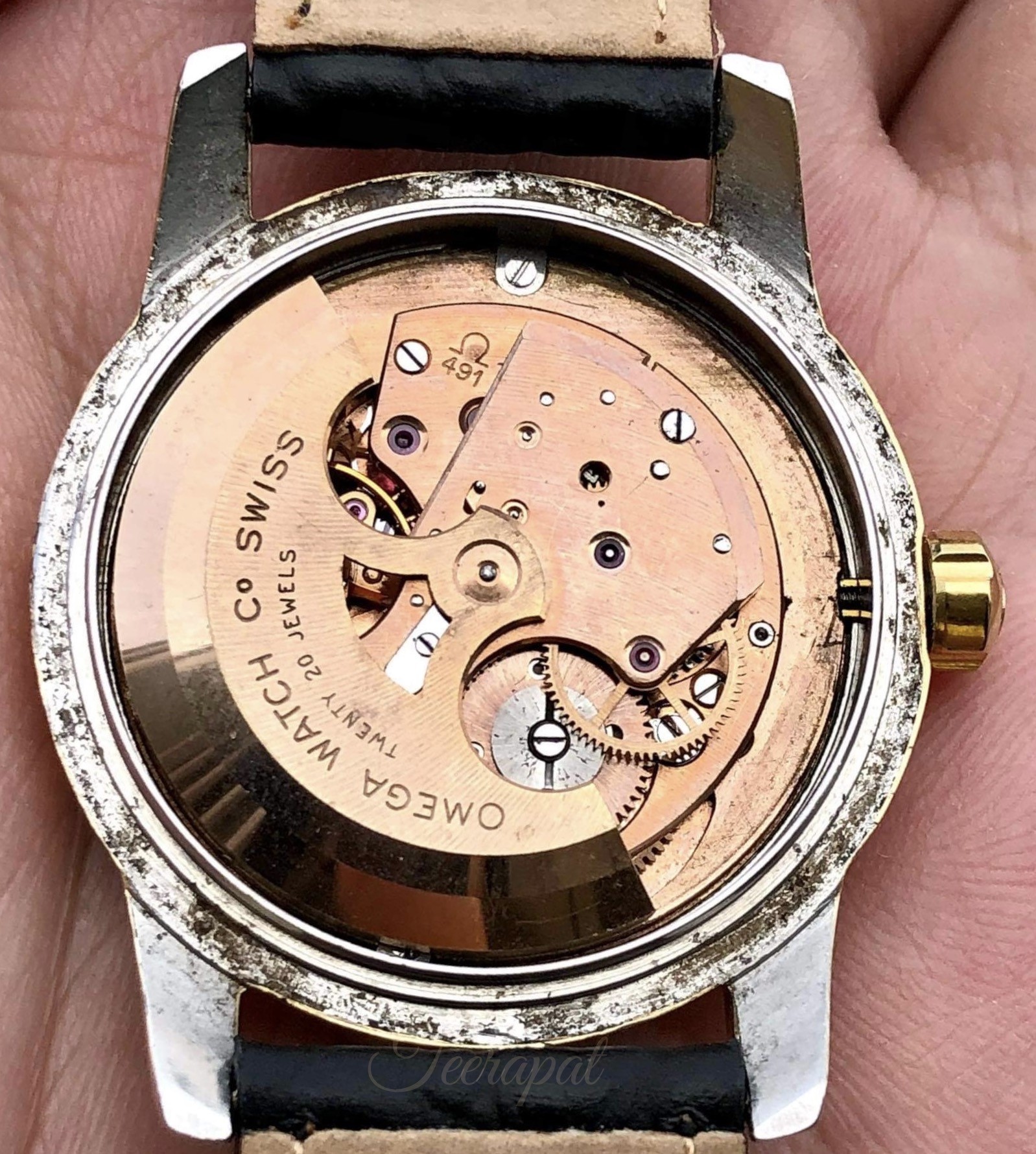

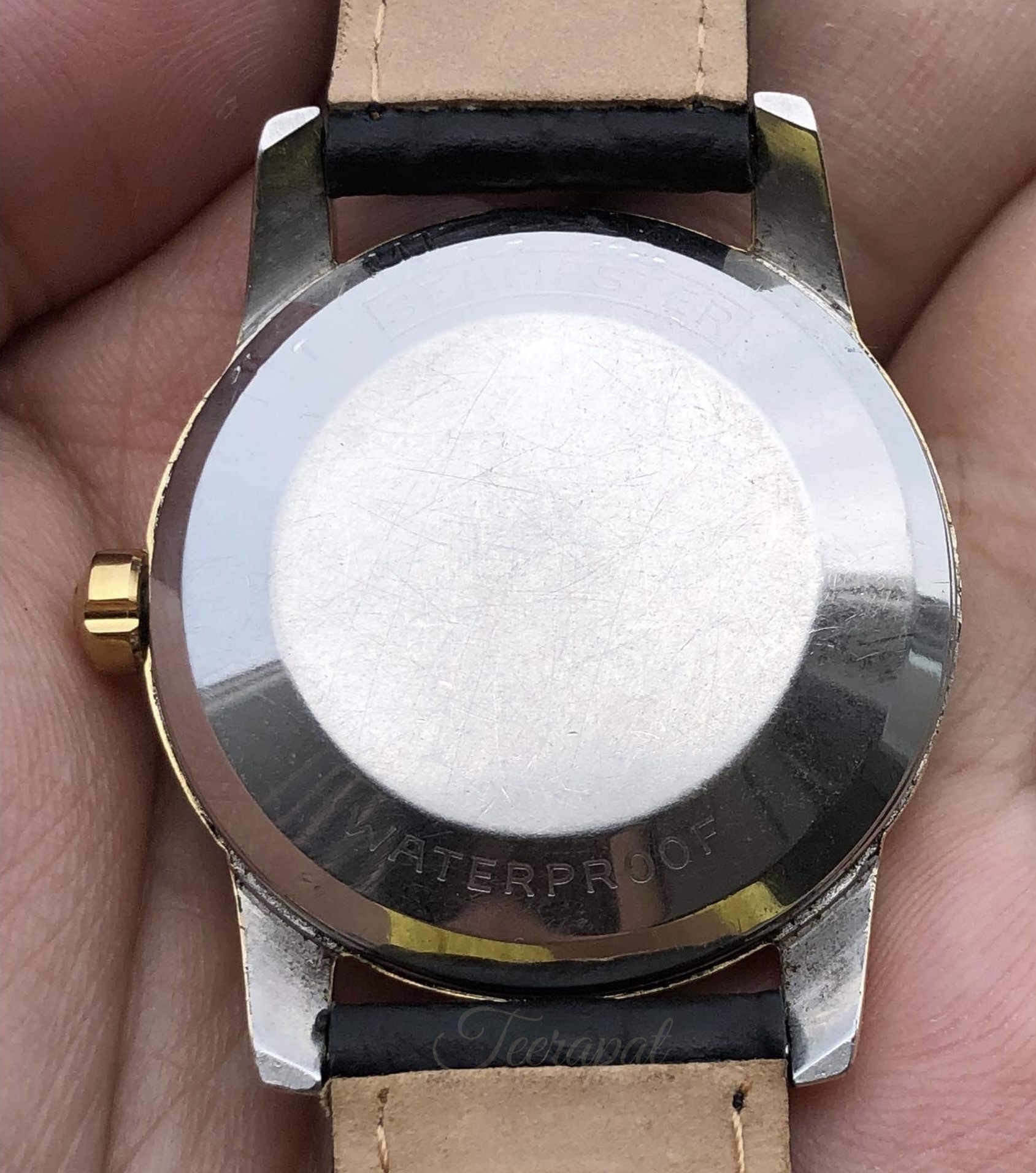

- The caseback was original (I discovered only clear caseback with “seamaster” and “waterproof” in ref.2848)
- Movement caliber is 491 with serial number 14,66x,xxx dating this watch to 1955.
(The correct caliber for ref.2848 can be both 490 and 491)

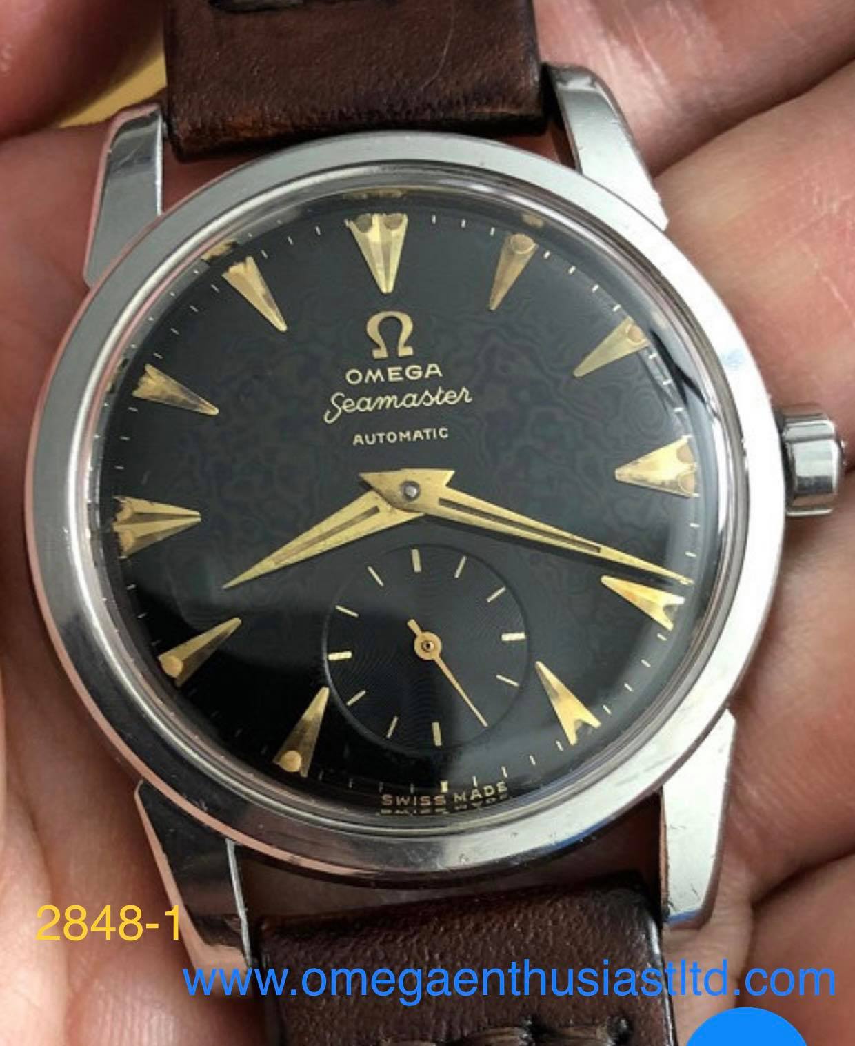

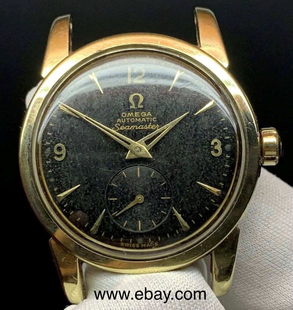

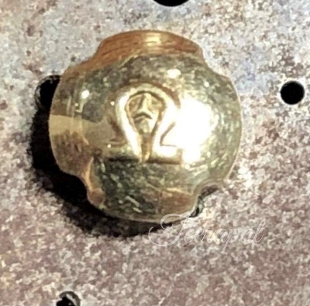

I noticed later that the crown of my watch maybe aftermarket so I changed it into this original “naiad clover crown”. From my research this “naiad crown” can be original used in caliber 491 too. I found the naiad crown used in reference 2848-1 too (https://www.ebay.com/itm/362728931605)
From my research, we use same case/movement among ref. 2848 and 2846-2848, it can be used interchangeable.
Nevertheless I believe that in ref.2848 alone (not 2846-2848), I found only 2848-1 and only sub-second version, while in ref.2846-2848 we can found both center-second (more common) and sub-second.
I gather all of ref.2848-1 (also 2846-2848) with original black with sub-second together.
The one from eBay doesn’t sell yet, maybe someone can buy it. Haha.
Finally, in ref.2848 we can found “seamaster” below “automatic” ,and vise versa. Both of this version can be correct.

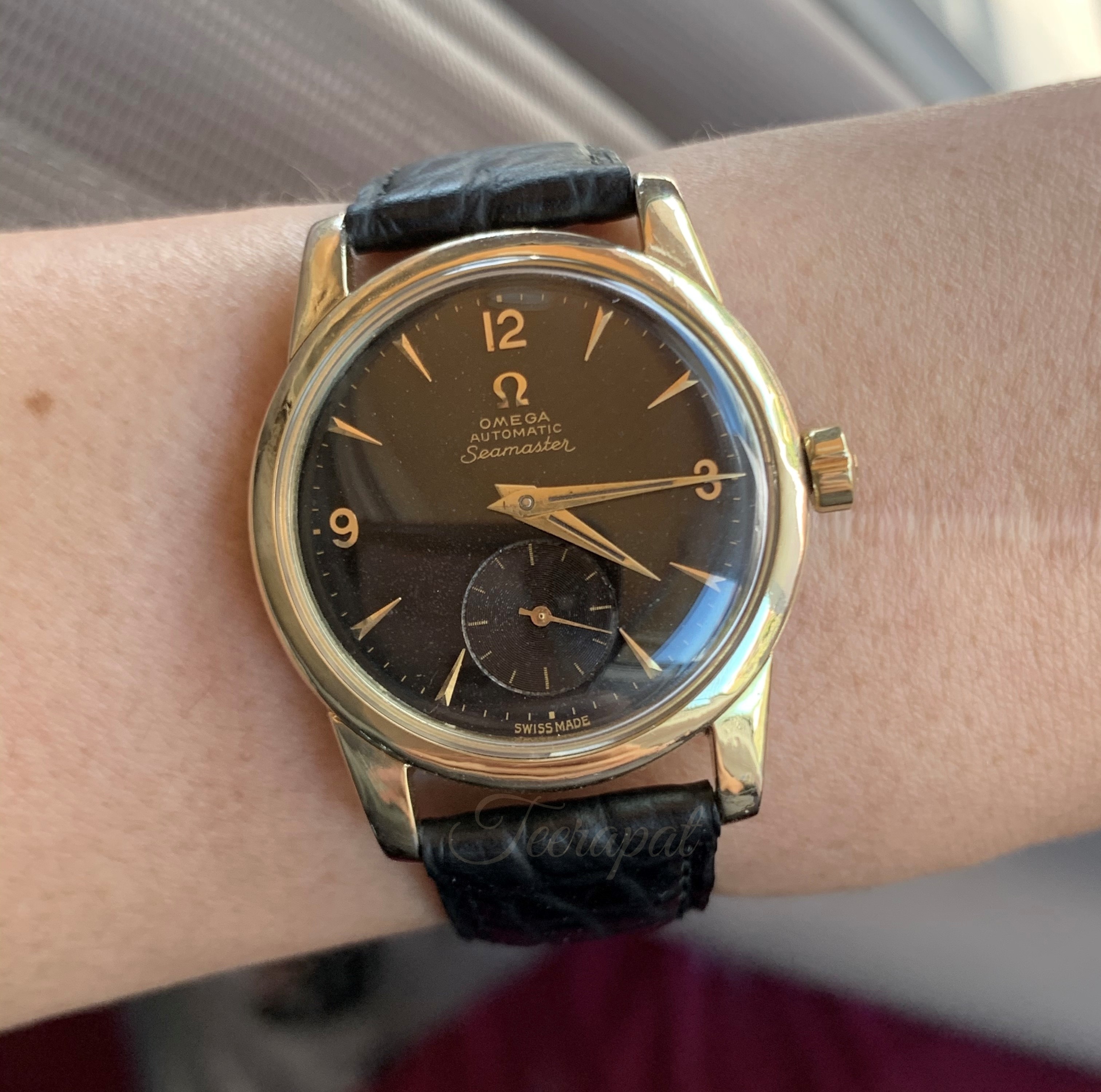

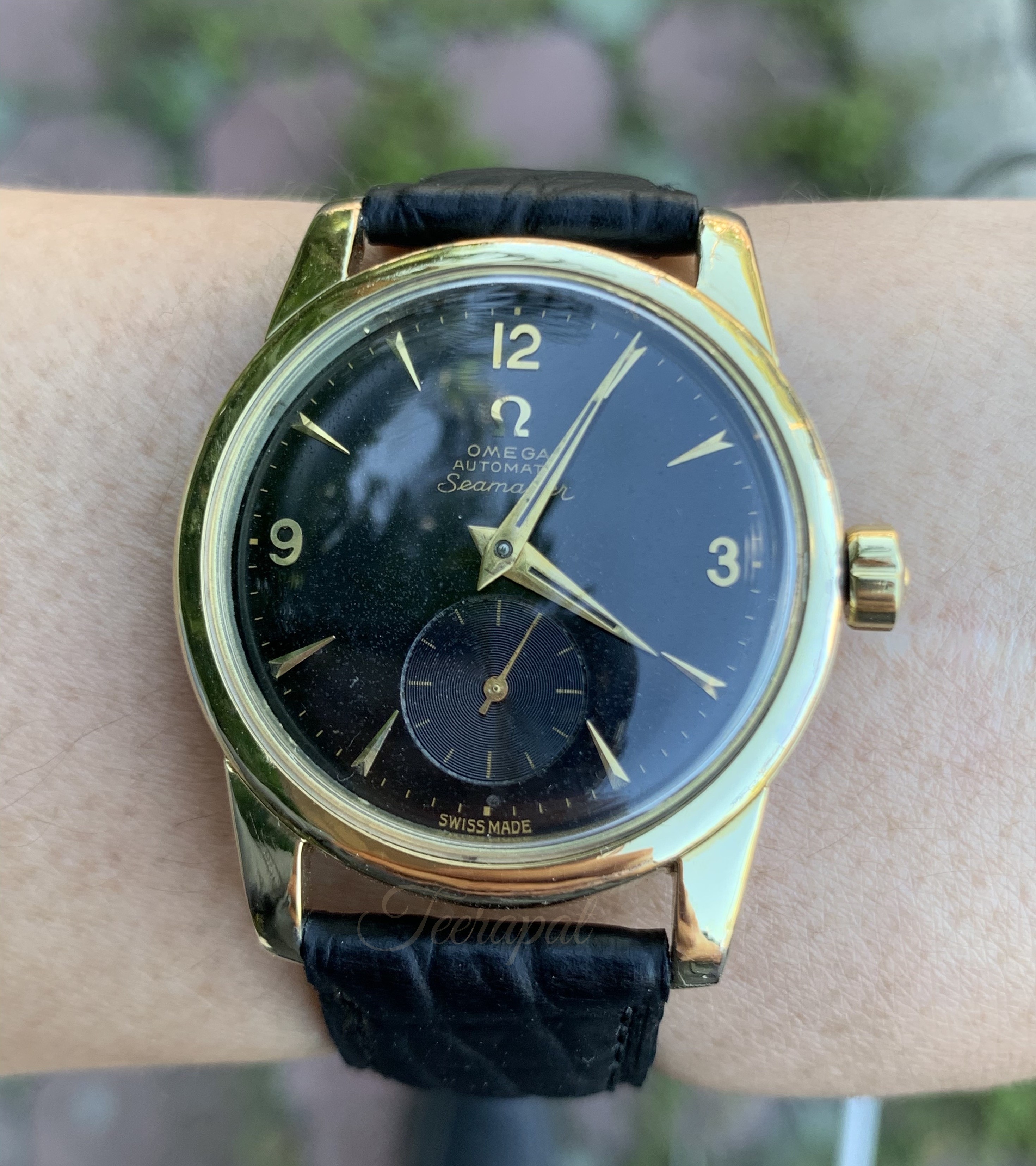

My wrist shot:
