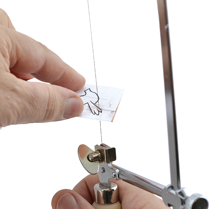

If I had to cut a spring bar out (a very rare thing actually - maybe do this once every 2 years or so), I would use a screw slot file that allows me a lot more control than something like a Dremel would. If something is a bit off with a file, I'll know it before it's too late and the damage has been done. A slow and steady approach is common in this profession, so I would rather take an extra few minutes to do it by hand, than try to get it done quickly with a cheap power tool and risk damage.
