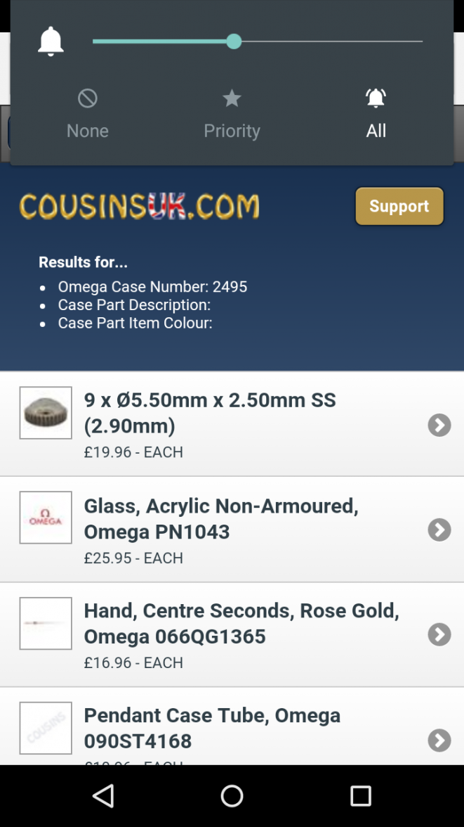

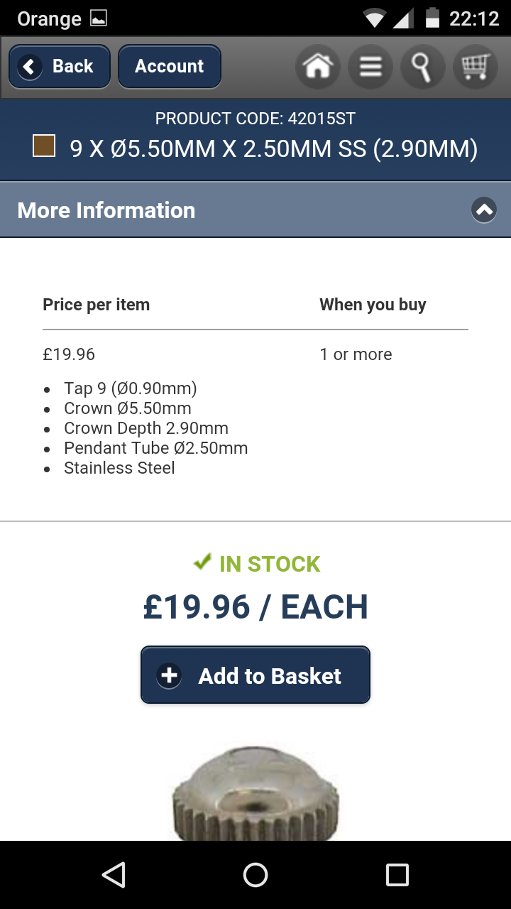

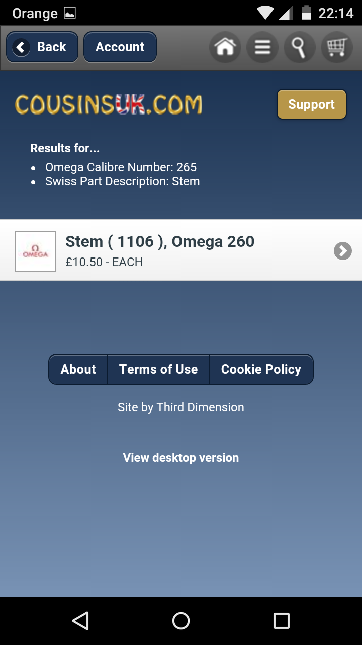

  7. ChrisN Jan 11, 2016
    2,218
    4,756
    Cousins list a SS crown for a 2495 case. I'd check it's the correct one first but that is an Omega part number.
    Here are the details. It should be possible to confirm these dimensions. I wouldn't pay too much heed to the picture as they are often generic.
    You'd usually get a new stem (based on the calibre) as well because you cut these to length. You may be lucky that the previous stem works but I wouldn't guarantee it.
    Hope this helps, Chris.
    Kuki likes this.
