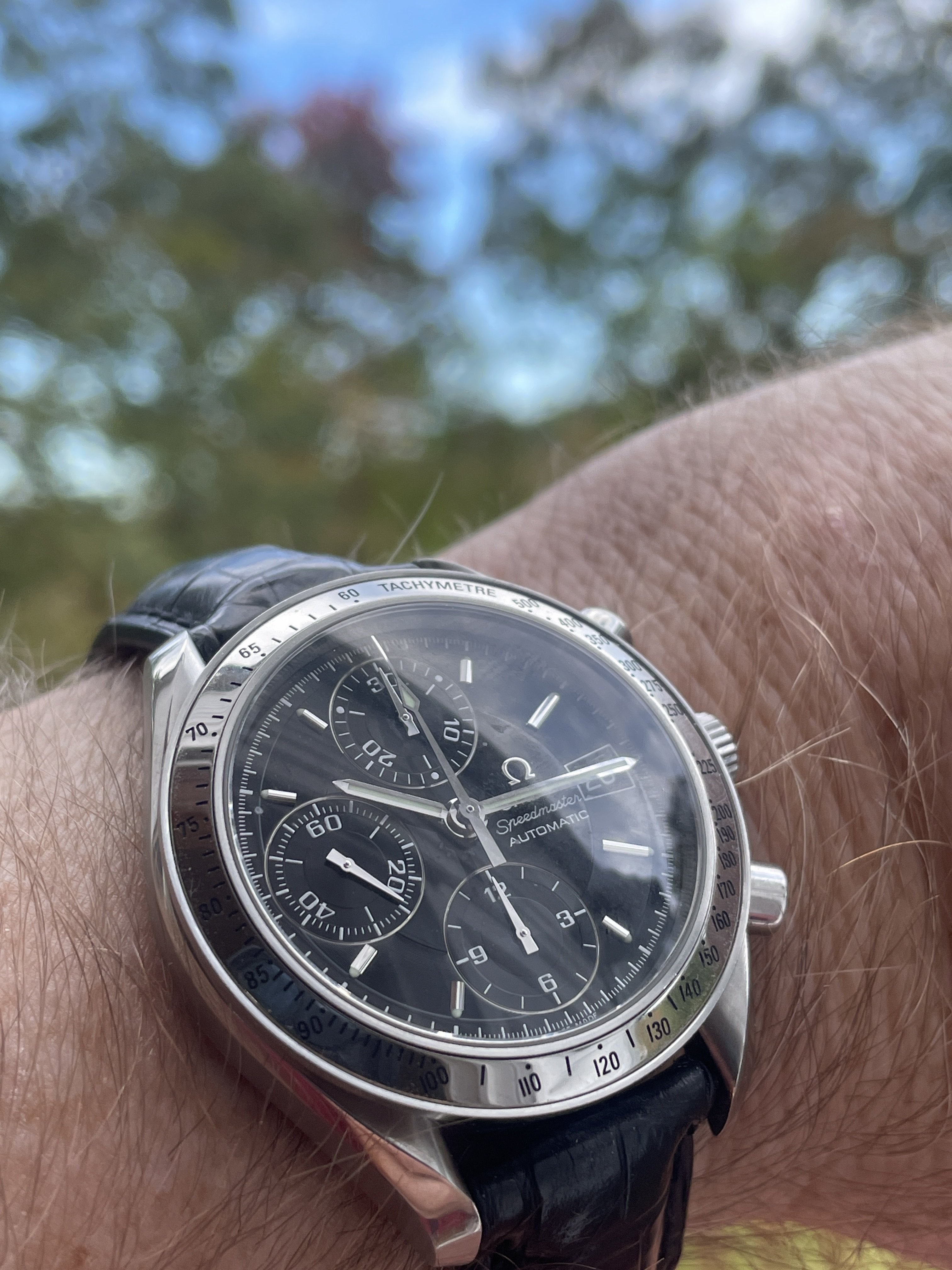

Hello everyone.
After years of wanting one I was finally able to afford this little speedmaster!
It carries a valjoux 7750 (Omega 1152).
The perceived quality is very good (a little surprised by the bracelet at first) but I find it even more beautiful in real than in the photos!
The only downside may be the hardness of the push buttons and the crown.
Make way for photos!

Hello everyone.

Good choice welcome to the mundane speedy club. Was yours recently serviced? I don’t find the crown hard to turn more like hard to grasp. I usually use my shirt or some type of cloth. My pushers don’t seem that stiff but I guess it comes down to what you are comparing it to. Sometimes right after service things are a bit stiff. Anyway I always like mine just put it on leather a couple weeks ago to change things up. Wear it in good health.

Beautiful with the leather srap too ! I bought the watch totally serviced to a professional. Yes thats right it seems to be easier with a tissue to turn the crown.
