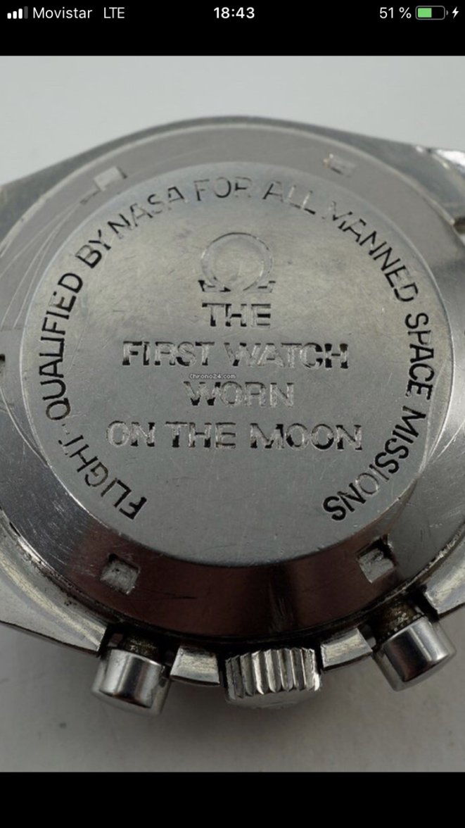

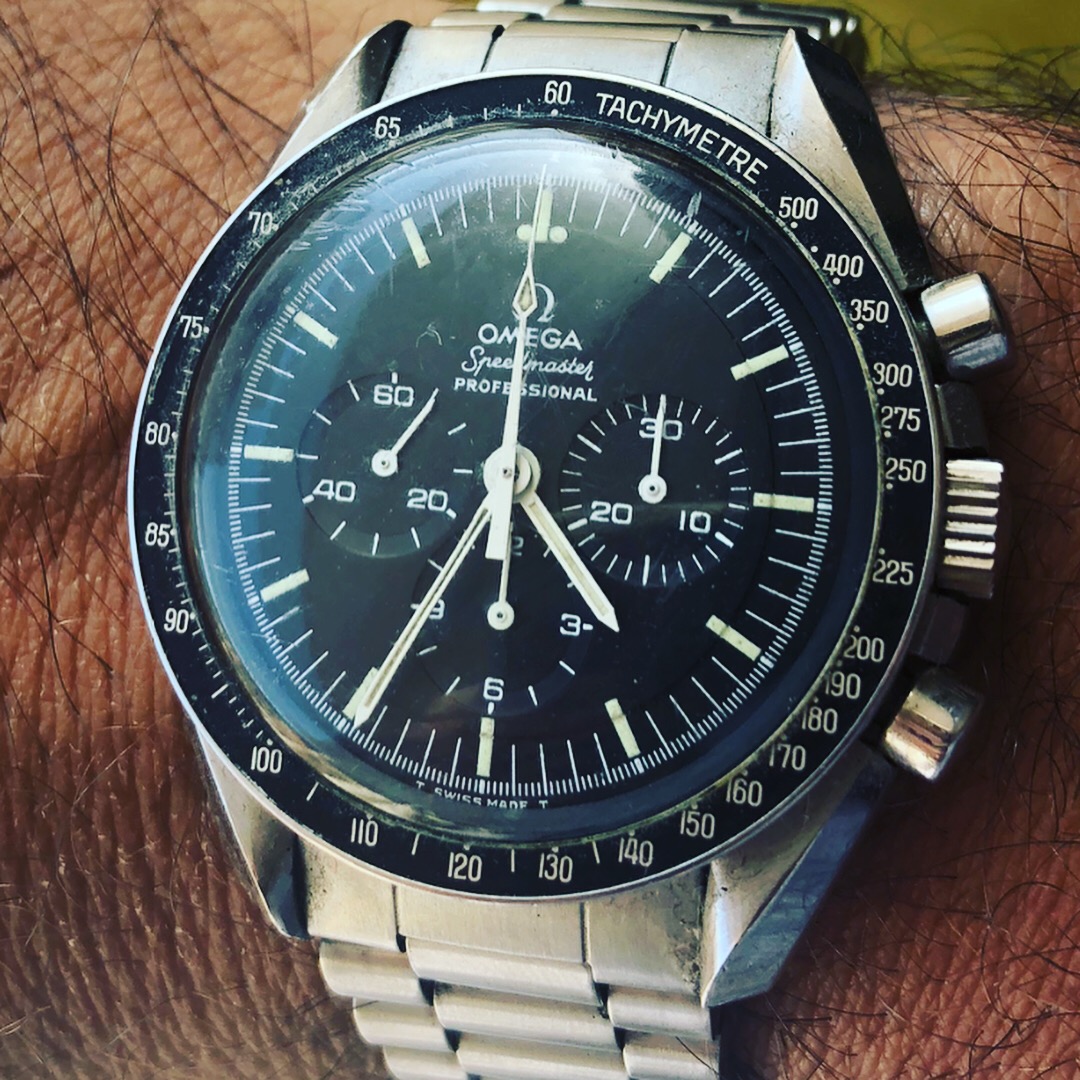

Hello! I have this Speedy that belonged to my father, it is a living inheritance, because luckily he is healthy, and now he is on a transatlantic cruise.
When I was a boy he used it because they had given it to him, then it went into the drawer of oblivion, and when he saw it by chance he gave it to me.
Could you help me to know the year and reference?
from what I investigated, it is 145022-71, it is correct

That looks like a 145.022 -69 “Flight Qualified” SW 👍

Great condition it's in! The case looks very sharp and I assume the bezel just needs some cleaning?
Anyway, for the exact year you can order an Omega Extract of the Archives (120 CHF) or fill in the serial at ilovemyspeedmaster.com or other sites. That will give you an approximate production year. You will have to open the caseback (by a proper watchmaker) to find out the serial.
The model itself is a -69 (step dial, straight writing).

Looks like a lovely -69 Straight Writing. If it’s been in a drawer for years a good clean and service is in order. The crystal should polish up well and it looks like some of the marks on the bezel might be dirt. General advice for vintage is to fully service the movement and clean the case but don’t polish it

How do you differentiate -69 from -71?
It really depends on the production age of the -69 but in your case, it’s the caseback. The text font as well as shape/location of the notches in the case back show it’s an original vs service caseback. The wear is commensurate with age, so that further tells me it’s original to the watch, which helps conclude yours is a -69.

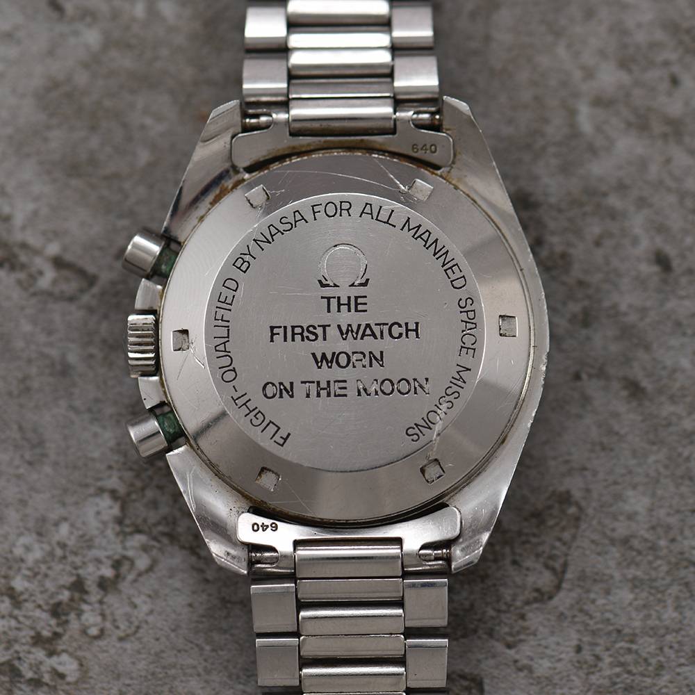

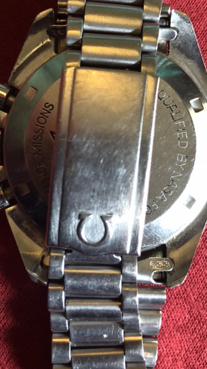

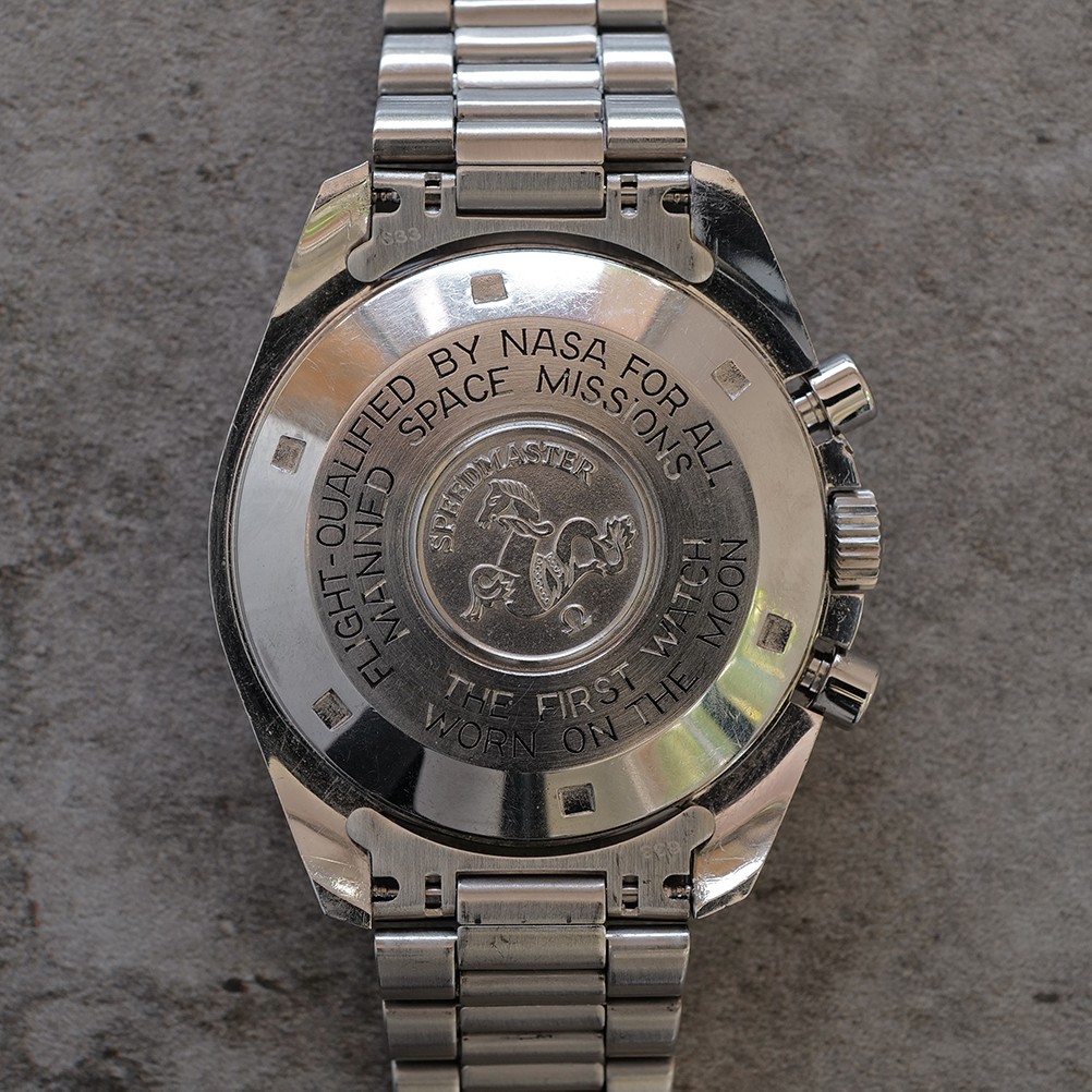

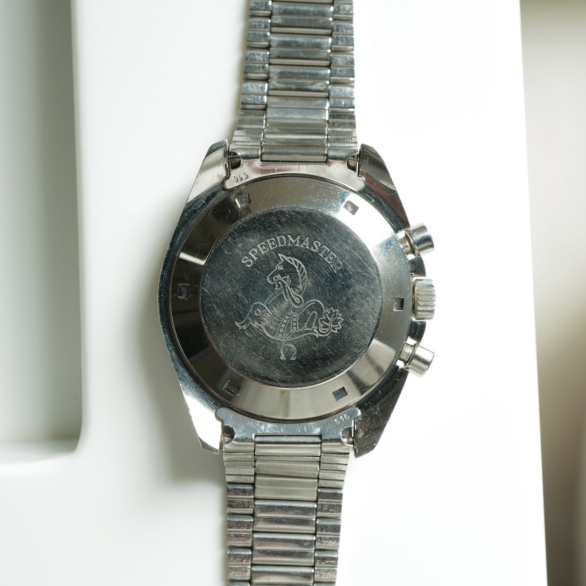

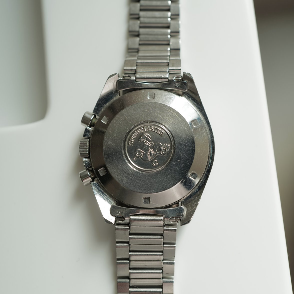

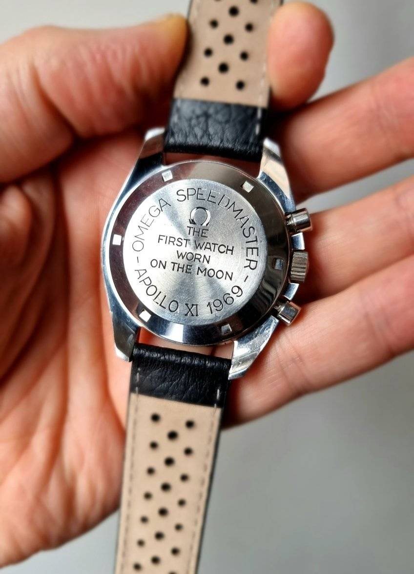

The caseback of a -71 will primarily look like this
With the rare exception of the “No NASA” caseback
A Pre Moon -69 caseback will look like this
There is a rarer Apollo Straight Writing caseback
And your Straight Writing with “Flight Qualified”
Depending on the production age, there are other tells but as I said, yours came down to the caseback.

This looks like a great living inheritance. Very nice.
We are going primarily by the case-back and your claims that it is a one-owner watch that hasn't been tampered with, but this involves the implicit assumption that the case-back and everything else is original to the watch. For example, we can't rule out the possibility that the -69 SW case-back has been added to a -71 watch. I know, I know ... your father says that nothing has ever been replaced. But if I had a nickel for every time I've heard that ...
If you have it opened and look at the inside of the case-back and the serial number of the movement, no guesswork will be required.

To give an example for the caseback, I once bought a -68 with a straight writing caseback. In that instance I had seen the serial number and dial and was aware it was a -68. Thankfully I managed to find someone else with the reverse problem and swapped for a pre-moon -68 back.
In your case although it’s highly likely to all be correct, it could be a mid to late -69 or -71 as they shared a dial and bezel. The serial will tell for sure. You could confirm if you have it serviced. Don’t try and remove the caseback yourself if you’re unsure how to do so as you risk putting some horrible scratches on it.

Great watch… congratulations.
From the pictures it does seem that someone tried to open the case back, and damaged it to an extent.
Not sure if that is recent or not, but if it is recent, I would definitely not trust that person to service the watch.
Good luck finding a good watchmaker!
