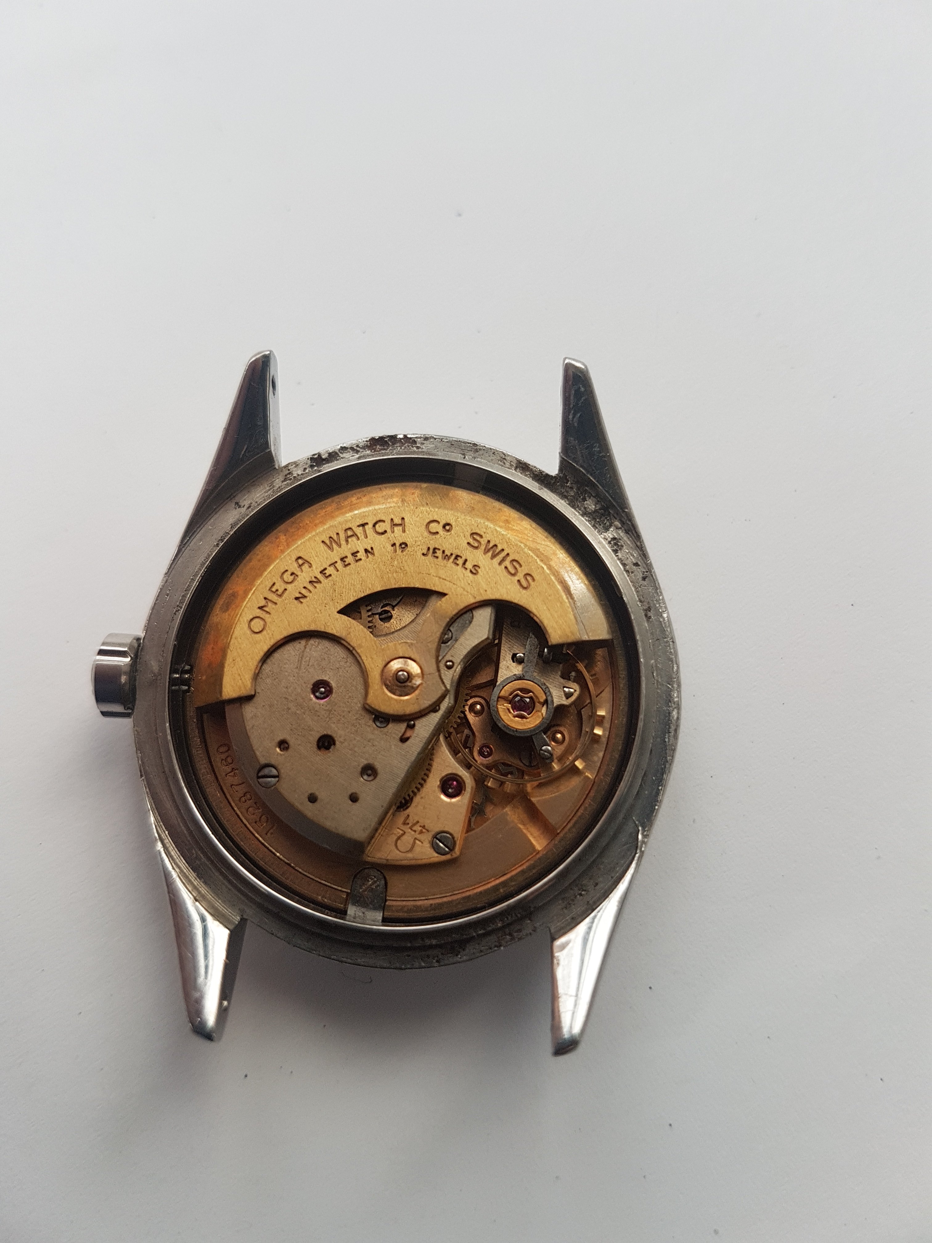

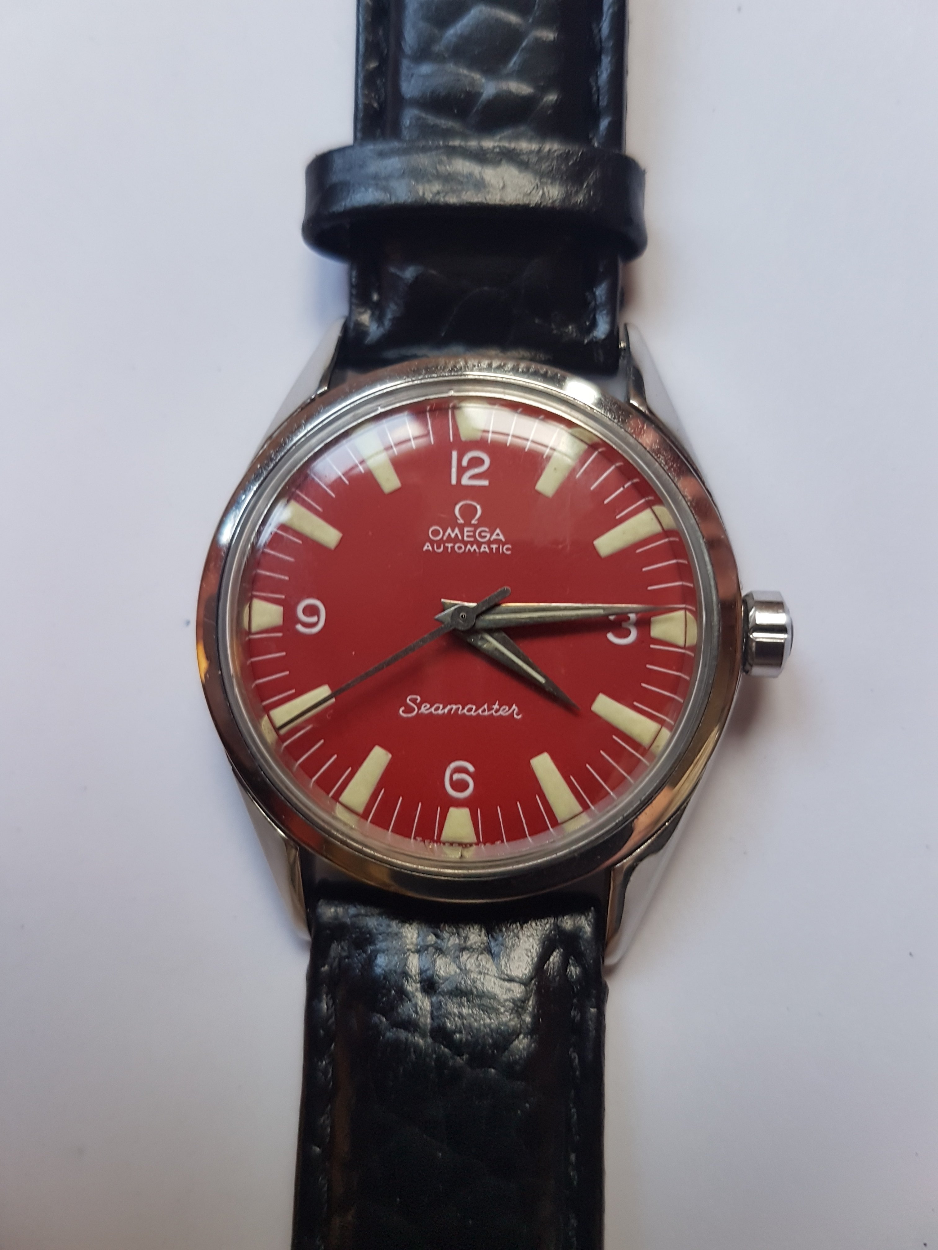

  1. Xyzzy May 26, 2019
    9
    I purchased this Seamaster about 15 years ago, basically because i liked the look. I posted some pictures today on the Facebook group trying to find out a little more about it and the general feeling is that its not a genuine watch. Itd a Cal 471 and serial number in 1956, just wondered if anyone here could provide some guidance?
    Thanks in advance
    Rob.

  2. X350 XJR Vintage Omega Aficionado May 26, 2019
    12,620
    29,918
    Your watch is perfectly genuine, however the dial has been refinished in a style which never appeared on this model.
    You bought it because you liked it, so wear it and enjoy.

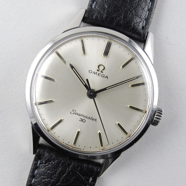

  3. JwRosenthal May 26, 2019
    14,932
    40,297
    Yeah, the dial is what is referred to as a fantasy dial- it was never issued by Omega and is a modern contrivance. There are sellers in the east that take original Omegas and redo the dials like this. They are all over eBay. They look cool, but if you are a nut for originality then you wouldn’t want one. Your watch would have looked like this from the factory-
    As you have been enjoying it, continue to enjoy it. If you want a completely original Omega, then hang around and welcome to the conversation.

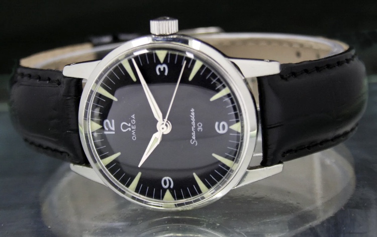

  16. JwRosenthal May 27, 2019
    14,932
    40,297
    And apparently there is real money to be made here:
    https://rover.ebay.com/rover/0/0/0?mpre=https://www.ebay.com/ulk/itm/192929501308
    Pics and description for posterity- listing is at $999 USD. They do say the dial has been repainted so they aren’t fraudulent on that.

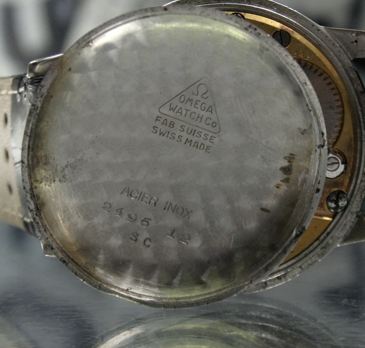

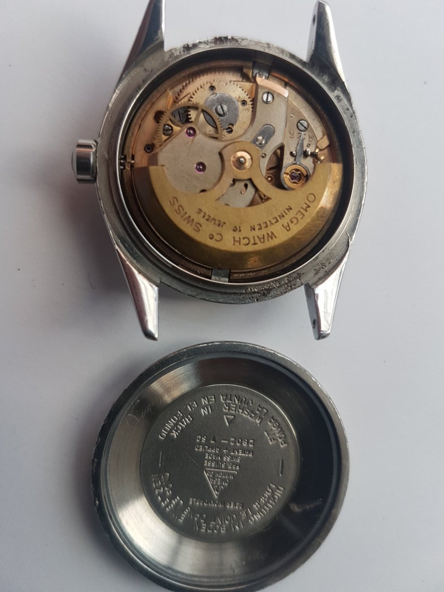

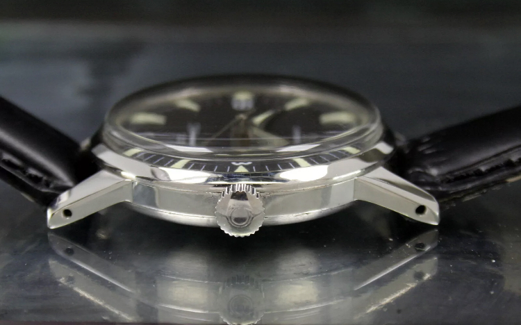

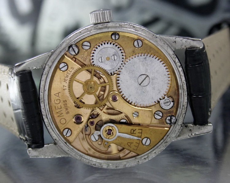

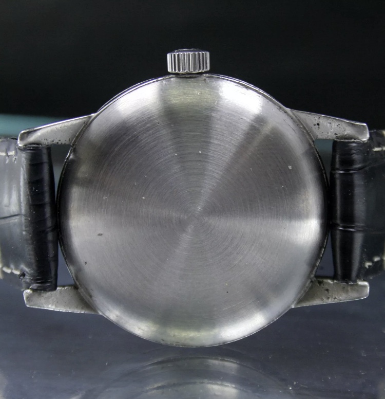

    “All of our vintage pre - owned watches are authentic watches that have been restored, polished and serviced to perfection by our master watch technicians.Each of these items is a "One of A kind" product that has been verified to be an original vintage of its brand. All of our items are in immaculate condition, a classic watch to be loved and passed down. Our team has sold thousands of timepieces worldwide. Buy with confidence”
    1D595318-1889-47E1-8931-A383033DDFE5.jpeg 1D50D940-4AEB-42AF-A75D-60011BD18B43.jpeg ADEA028D-BB20-4AA2-9DF5-C35D90220245.jpeg BF95F393-DAEA-405C-BC87-124BCF14D758.jpeg 2DB18889-F578-40C9-935E-0EE1E6517331.jpeg 6BB13971-71E4-46D5-9512-AB1754404BB5.jpeg

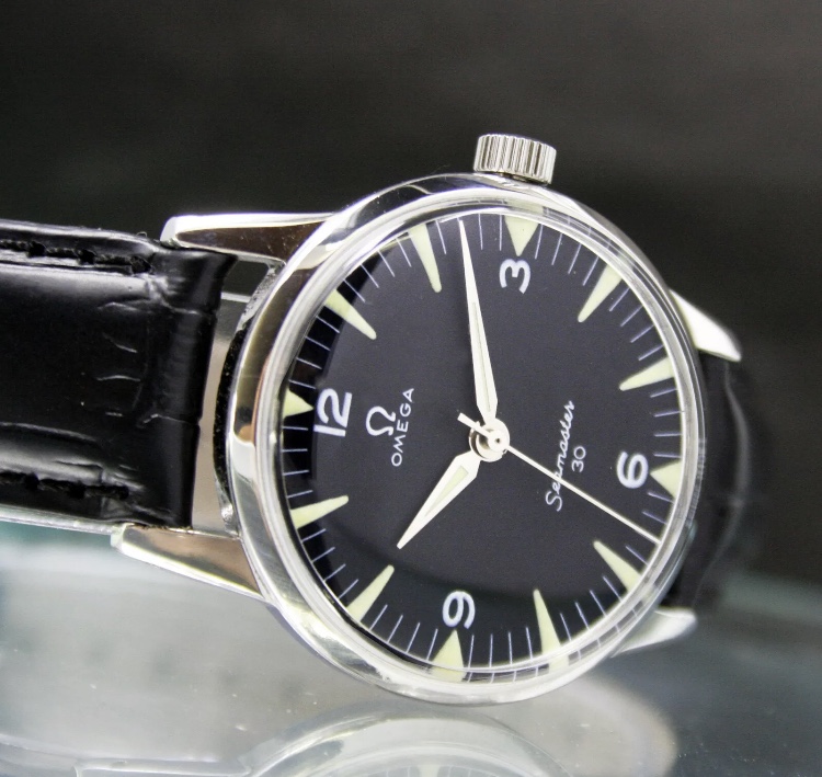

  19. JwRosenthal May 27, 2019
    14,932
    40,297

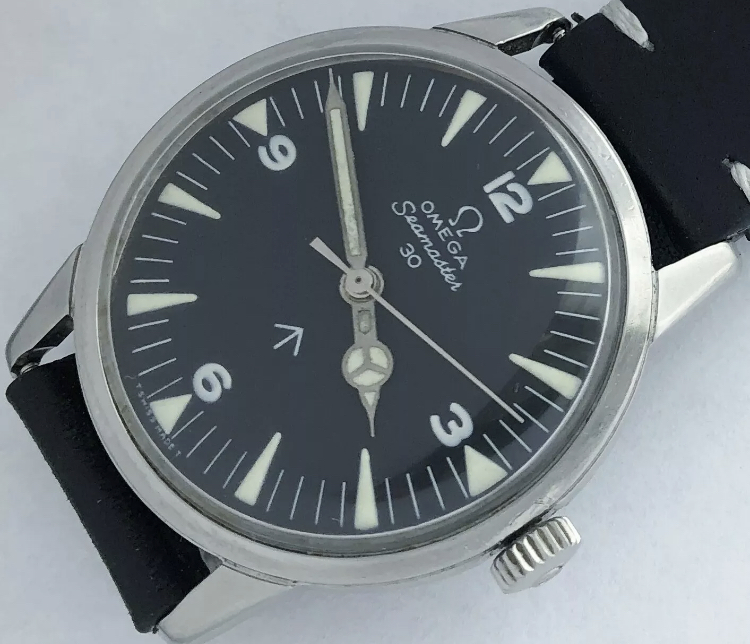

    For posterity, also post a pic of the watch you link so when the eBay link disappears the thread is still relevant- this is the one you linked:
    And this is what it looked like originally
    It seems they are trying to mimick the Ranchero look, not really that close but in spirit at least. There are some seriously good copies of the Ranchero out there, some that have fooled forum members -many threads on OF that will occupy hours of reading but it’s an intersting read.
    Like you I can understand trying to do a really good copy of rare watches to get real money, but it’s these lower end models that I find intersting as they are aren’t highly profitable...but I guess I’d tou sell them en mass and the cost of labor is cheap, there is profit to be made.
    This reminds me a lot of the Tudor Red Ranger lore- I own one (and my watchmaker has verified that it is a Tudor dial, it is a Tudor case, it is a tudor movement, hands and lume are era correct, fonts all match etc). Many say the watch never existed and it was a contrivance to make money...but when the “fakes” were coming out, an actual Tudor Prince was only worth about $250..why would someone go to all that trouble for a $250 watch?!!
    Xyzzy likes this.
